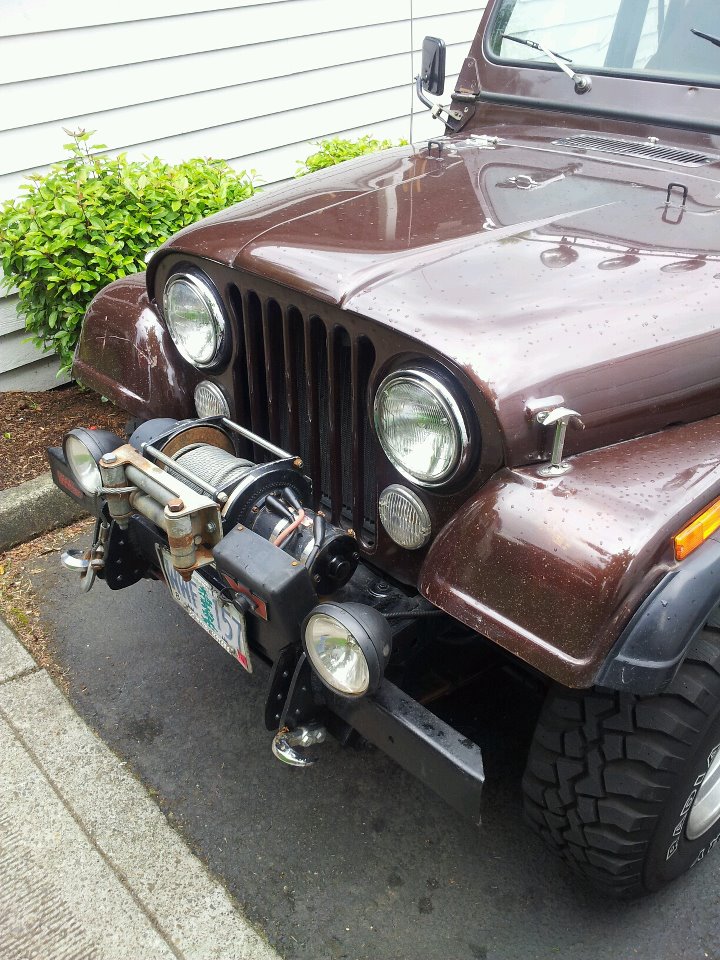

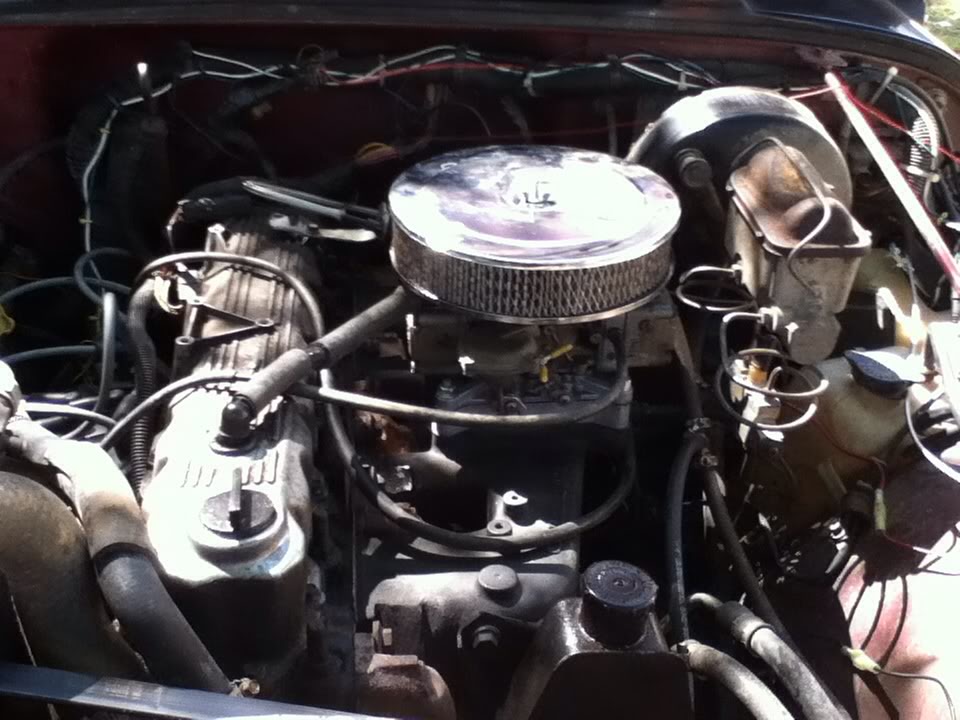

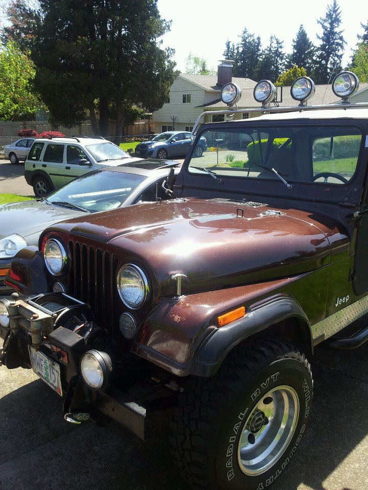

Here are a few pictures, note this is before the work I am planning including a candy red paint, black steel corner and side panel covers and accessories, and a hard top and doors I am shopping for.

the coolest look when you open the hood is a four barrel carb. you can get holley or edelbrock, for the main big names. they will bolt right on to a cliford or offenhauser intake because those intakes are made for four barrel carbs. if you use a weber, you will have to use an adapter to make it fit since it is a two barrel. then you can move onto getting a header too, which really adds to the wow factor when the hood is popped open
holley four barrel
weber 32/36 two barrel
holley two barrel
weber 34/34 two barrel
motorcraft 2150 on offenhauser intake with adapter
you want performance, reliability, and looks. gas mileage will always be worse with a two barrel then a four barrel and power will be less. reliability wise, all ran. performance wise, the holleys, 2 and 4 barrels were the most fun.
I don't necessarily agree with Superj..... My advice is do your own research. Economy, power etc are based on many factors such as CFM's required, delivery method, progressive vs. synchronized fueling and can vary greatly based on the model carb applied. I'm a Weber fan , probably own and used every model in some way. Their two barrels operate on a very different principal that Hollys or Carters let's say. Go to the "inline sixes.com" web site. They describe these differences very well and will answer your earlier questions about HEI (however they call it "DUI", which is the same for the most part). Be an informed consumer Brother.......
