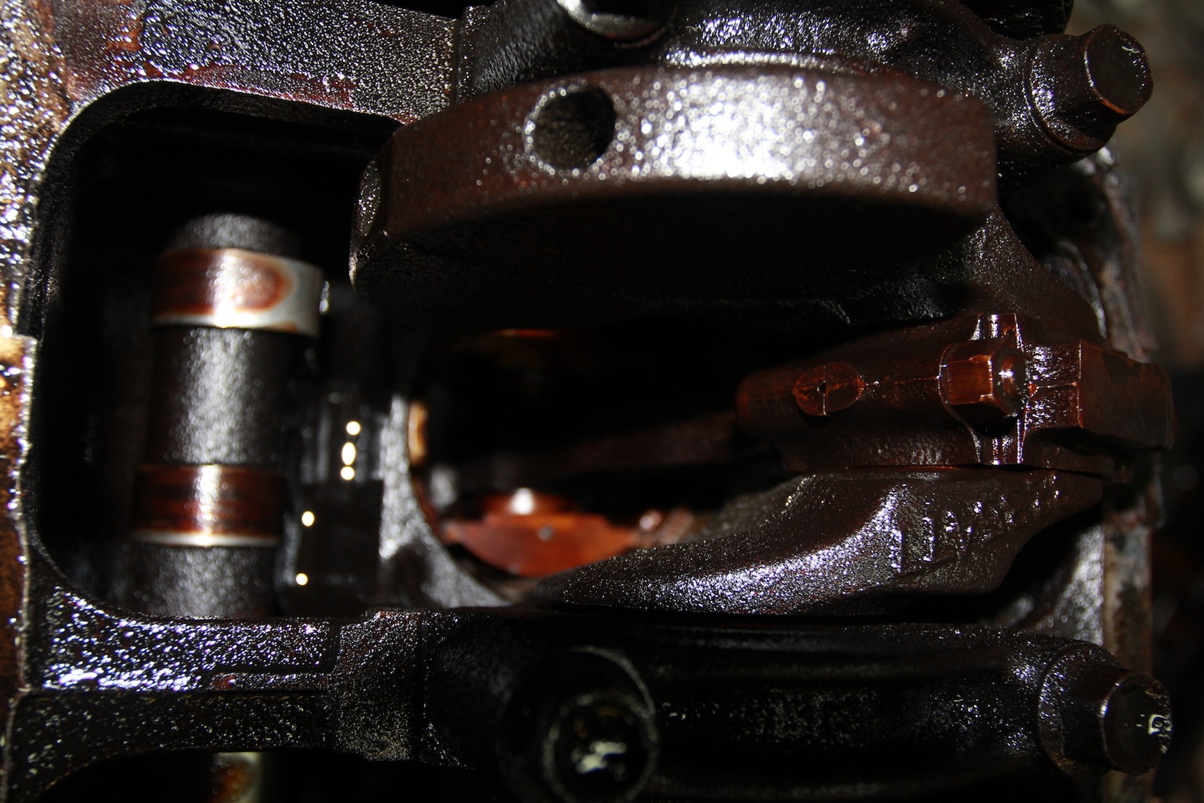

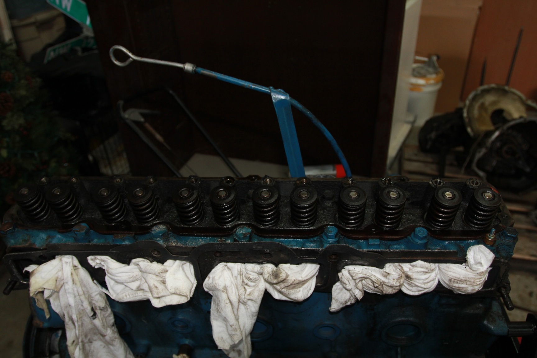

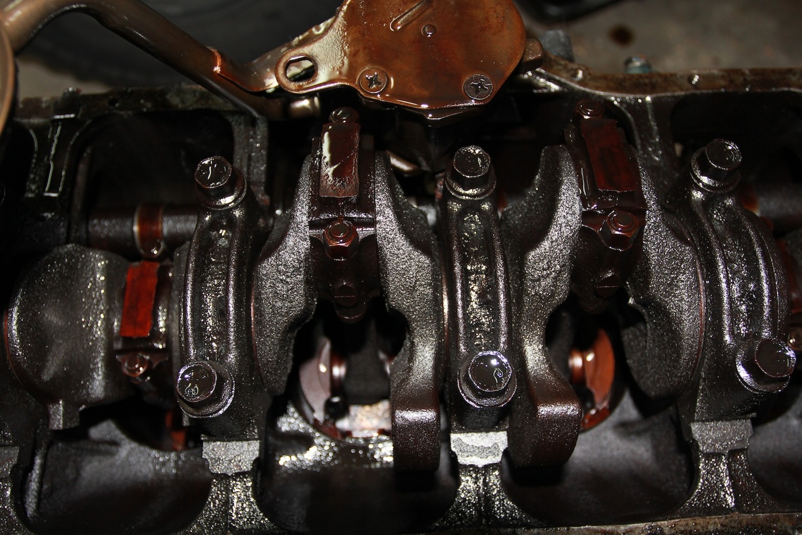

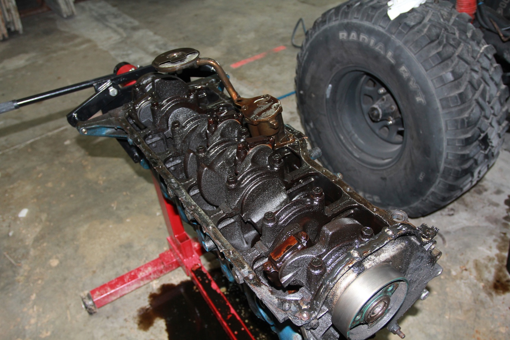

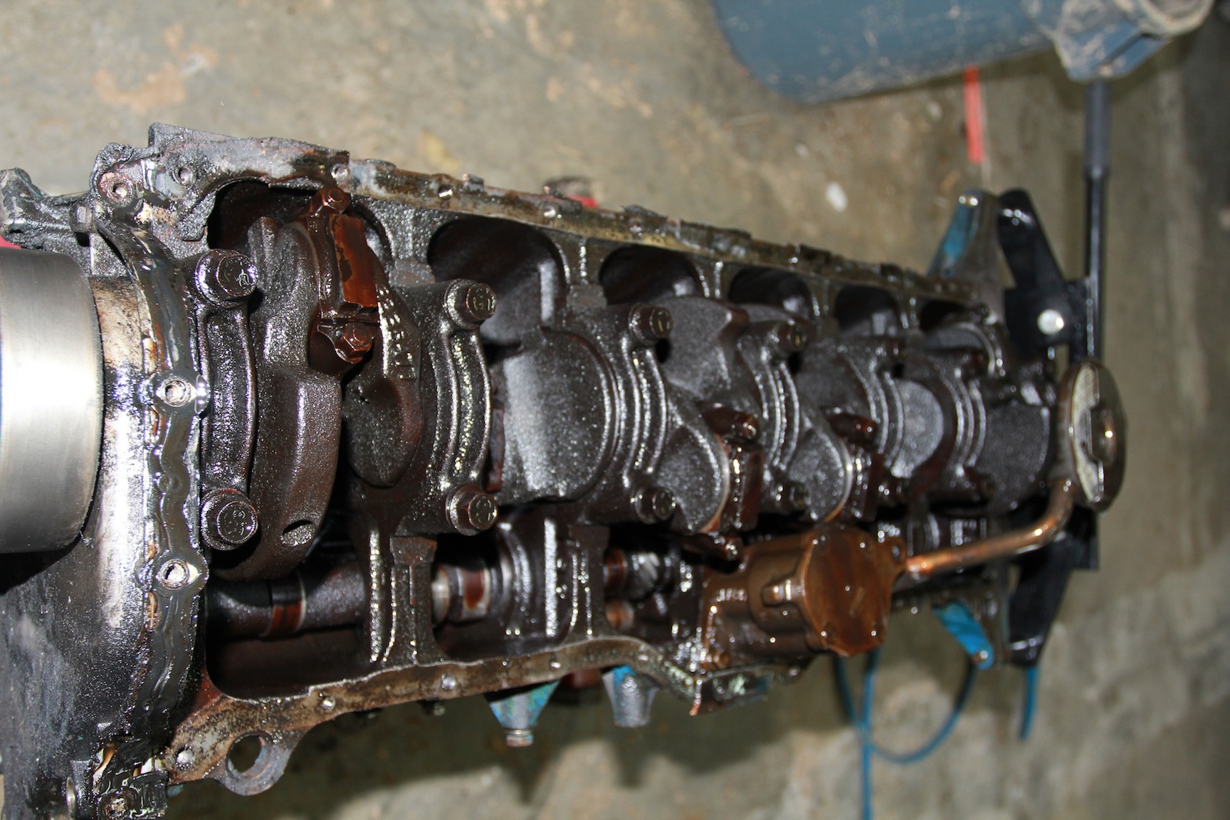

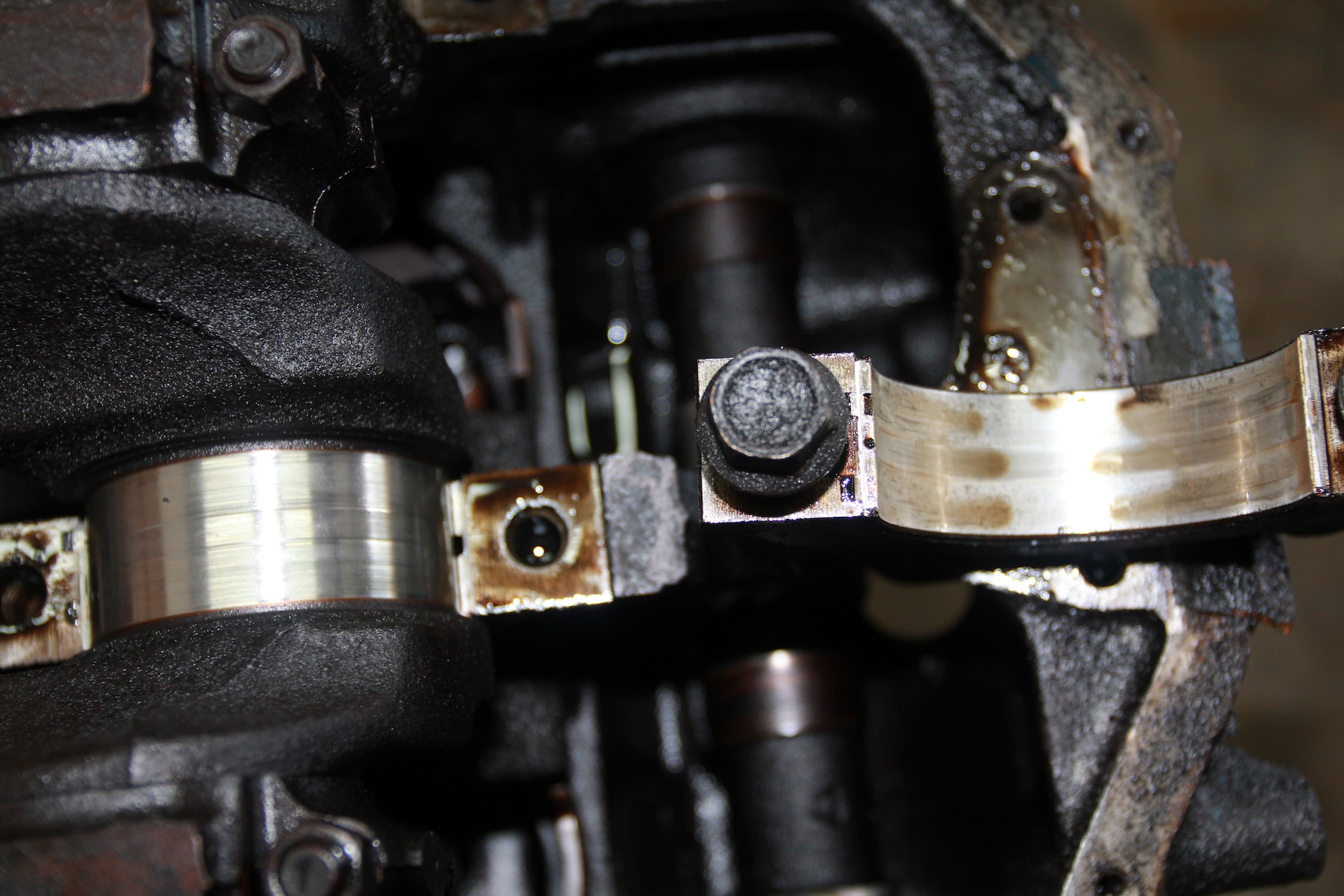

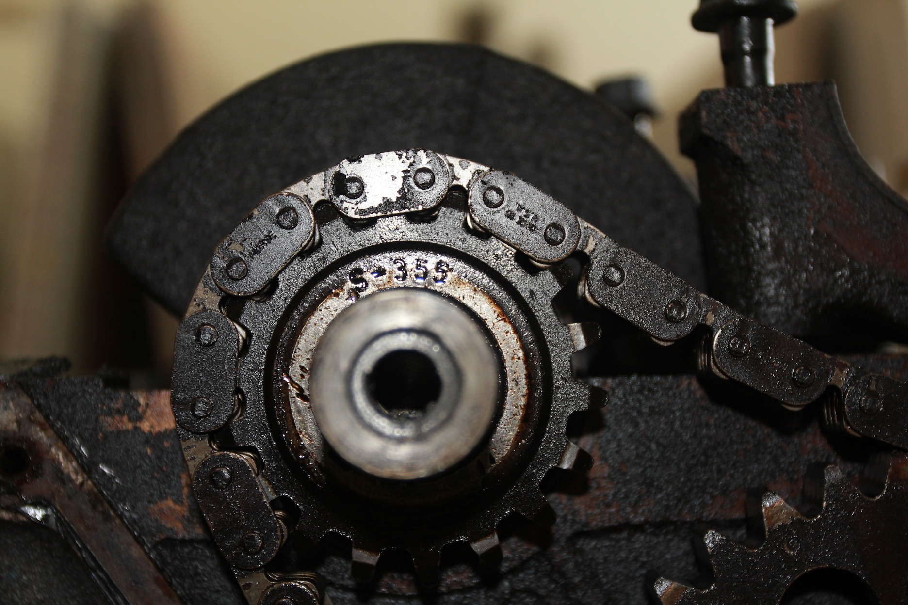

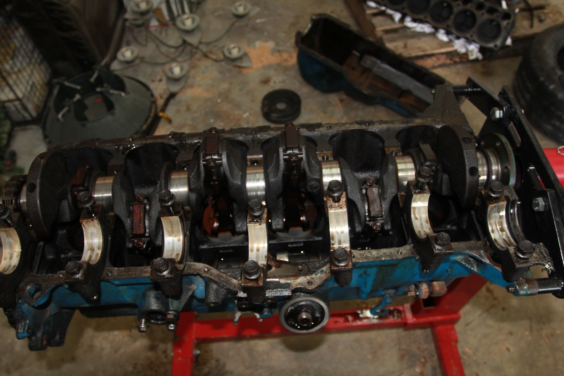

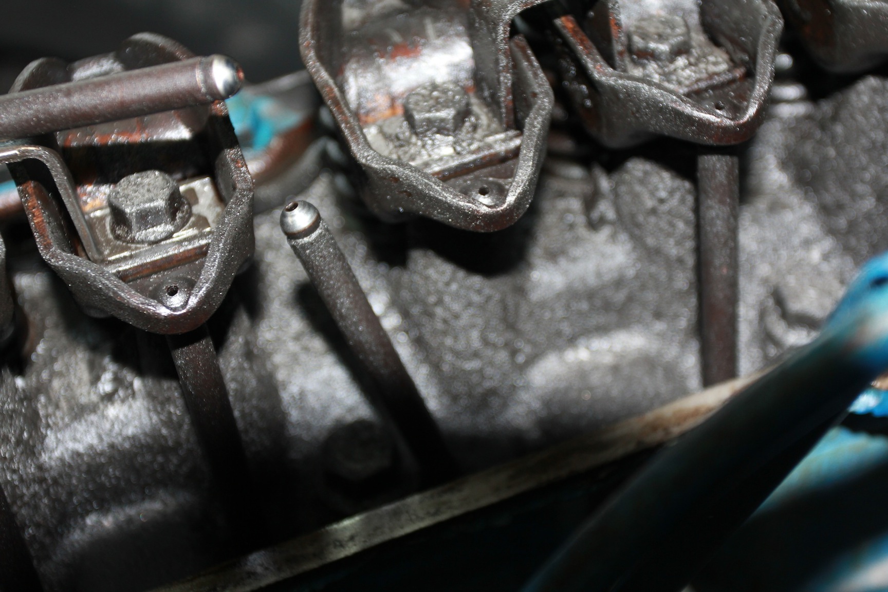

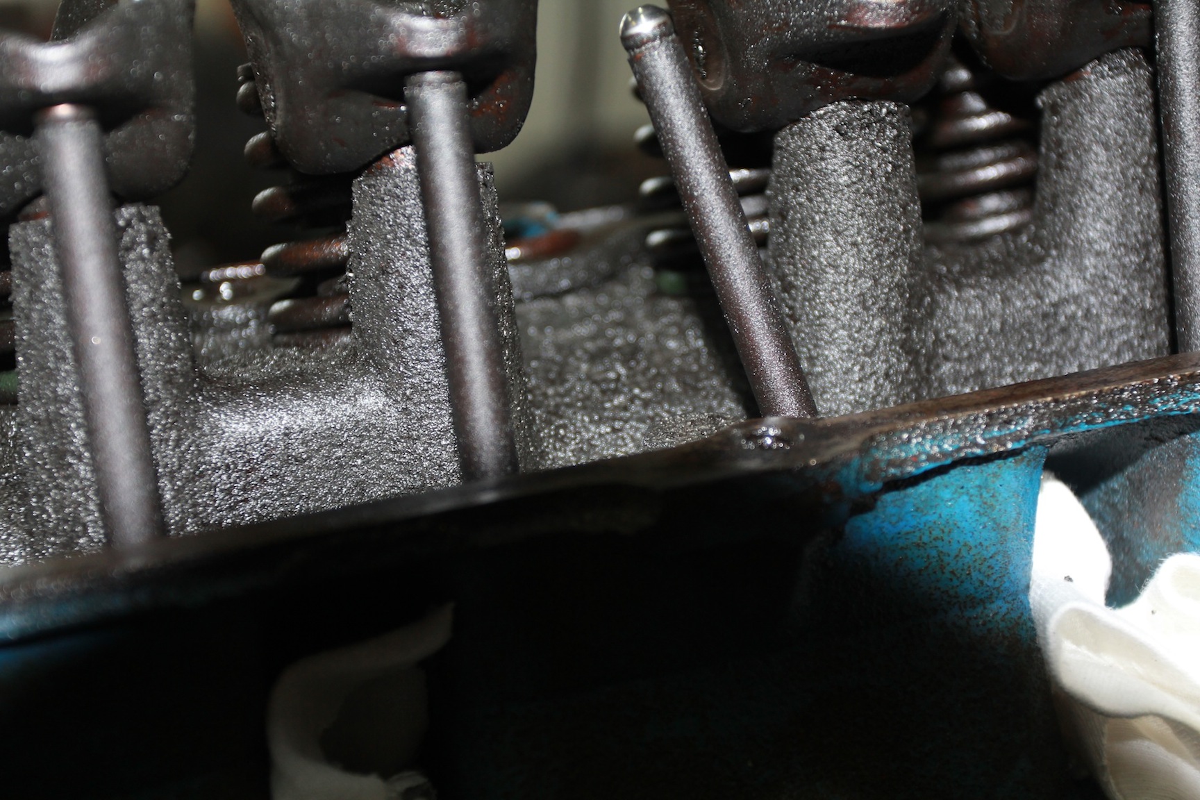

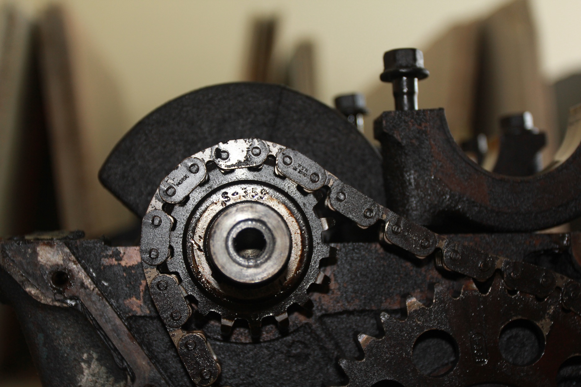

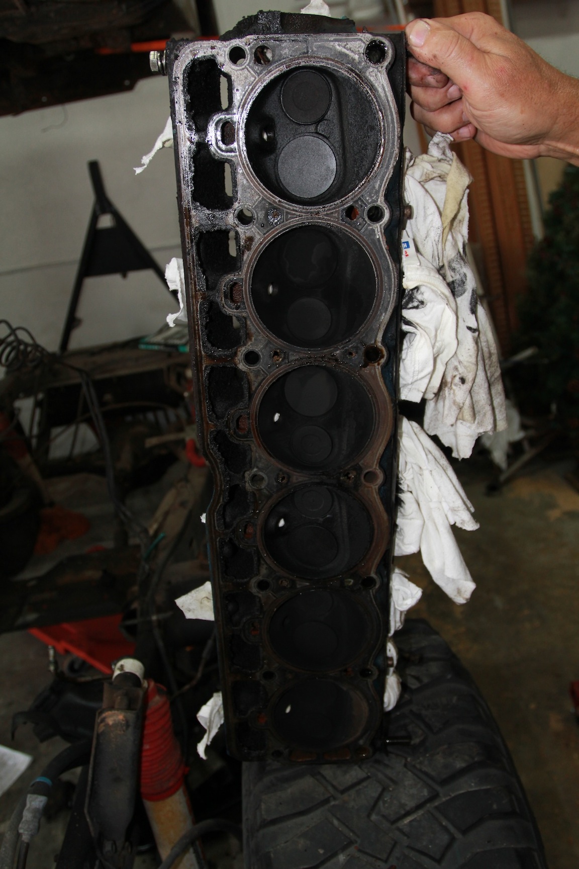

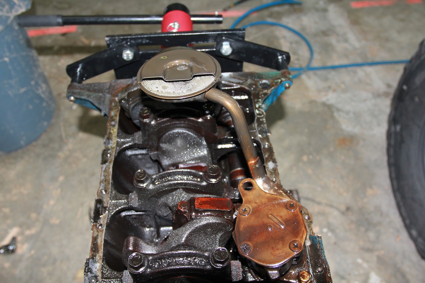

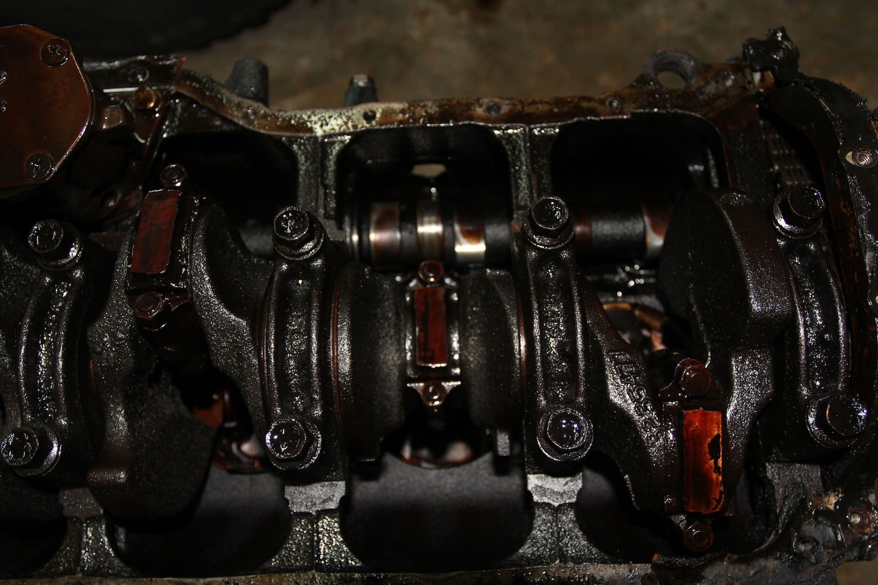

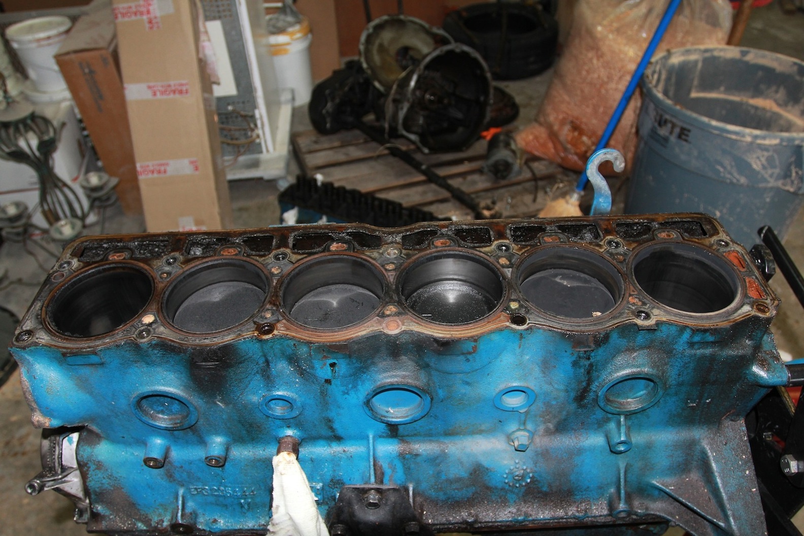

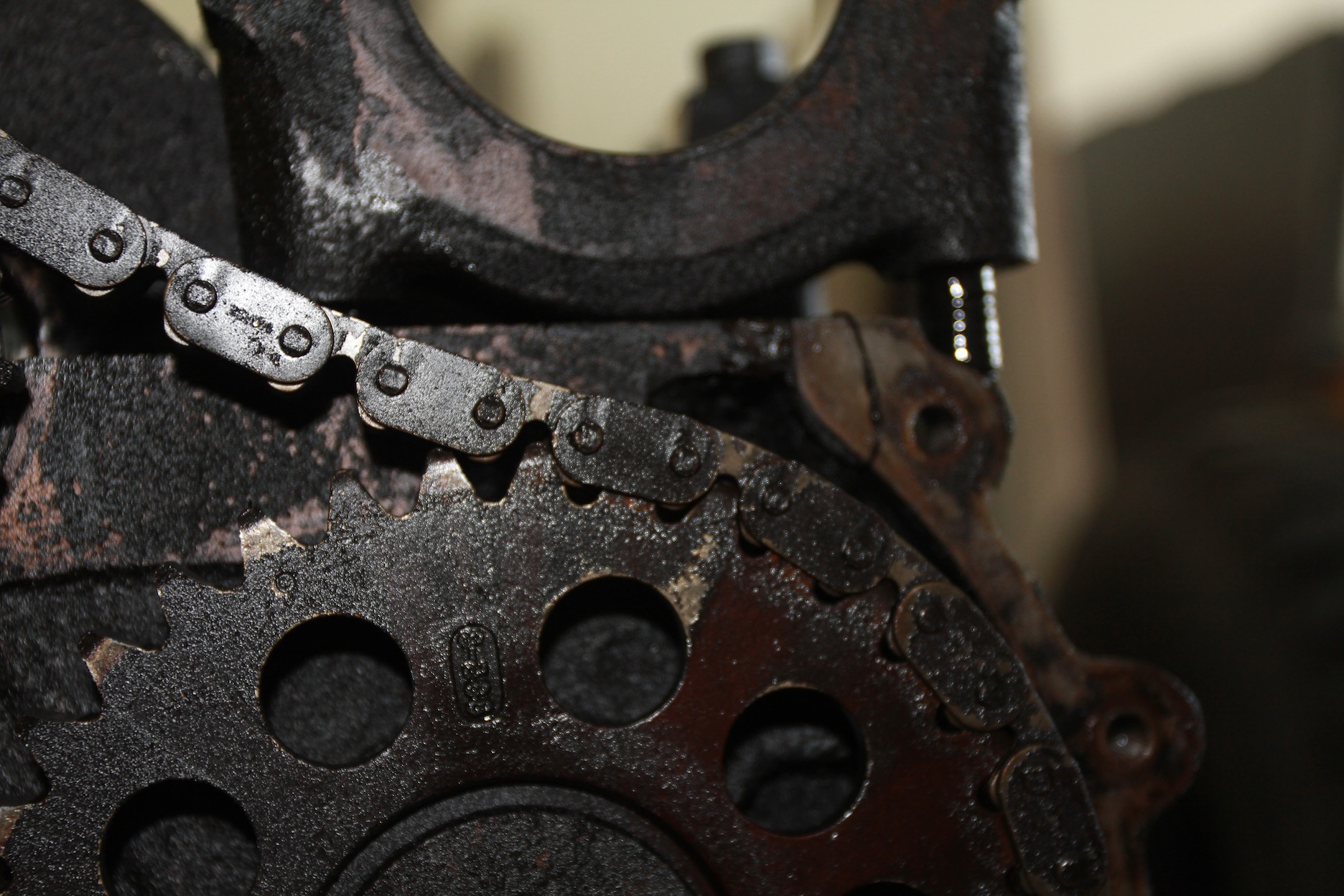

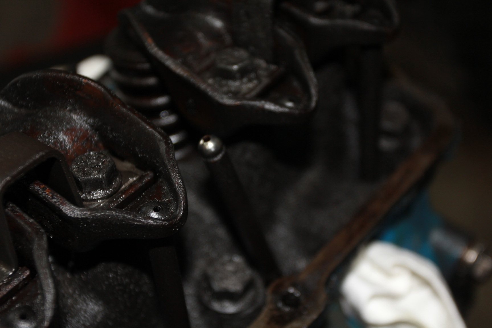

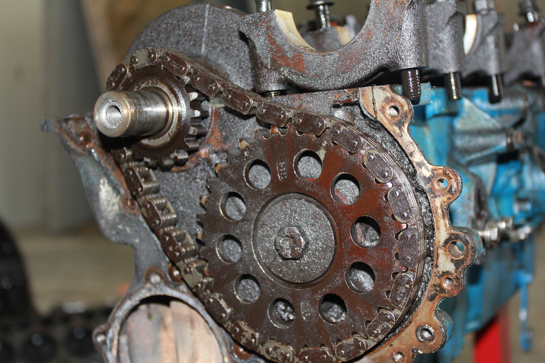

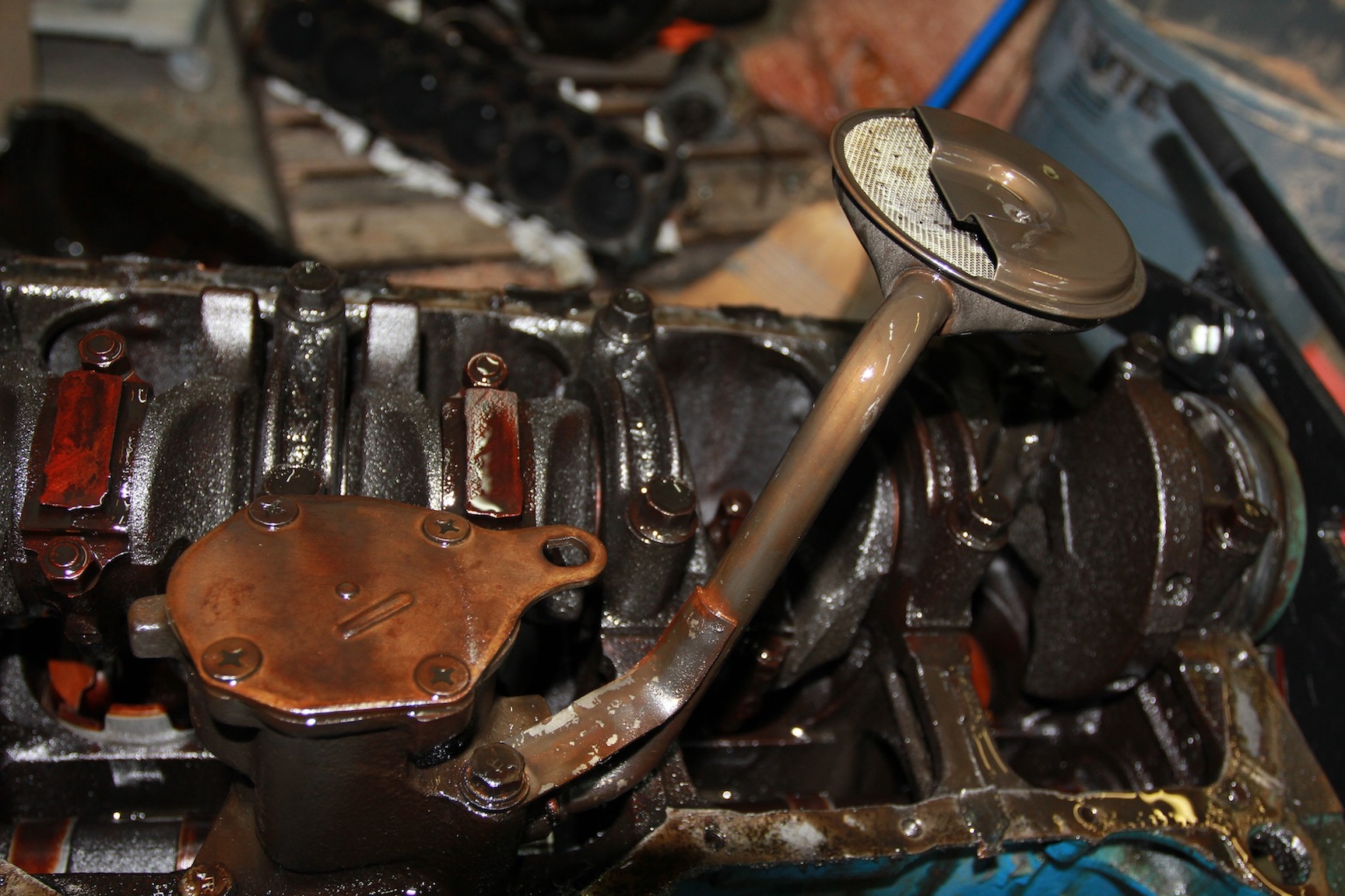

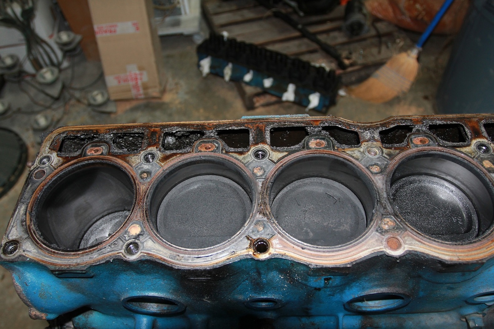

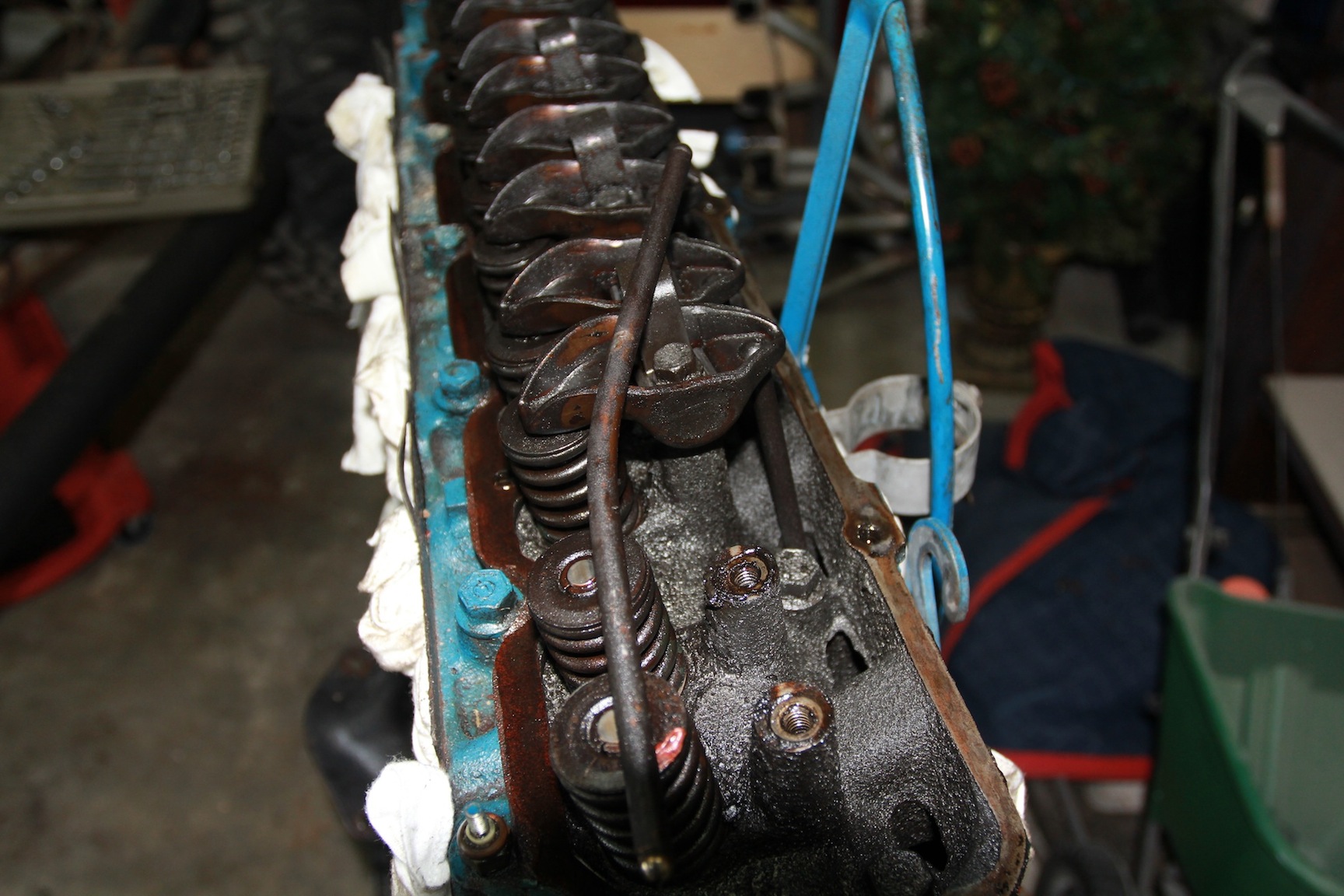

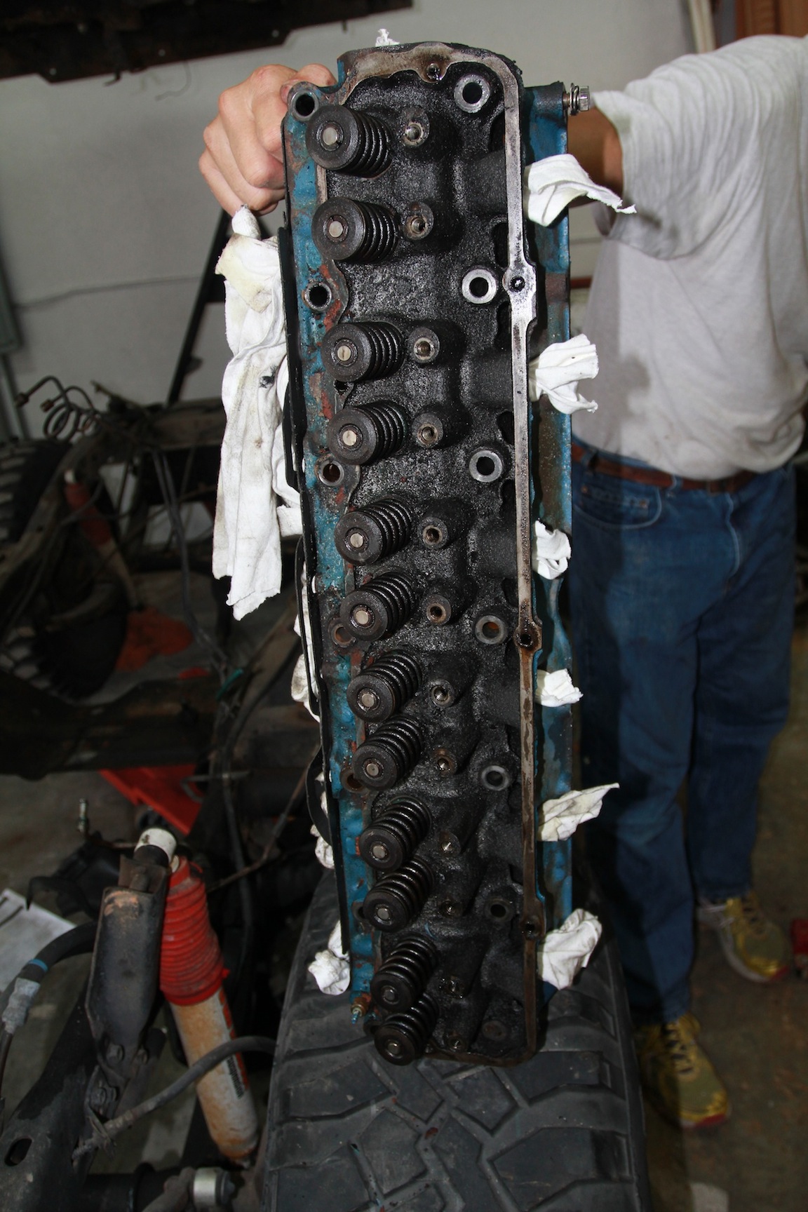

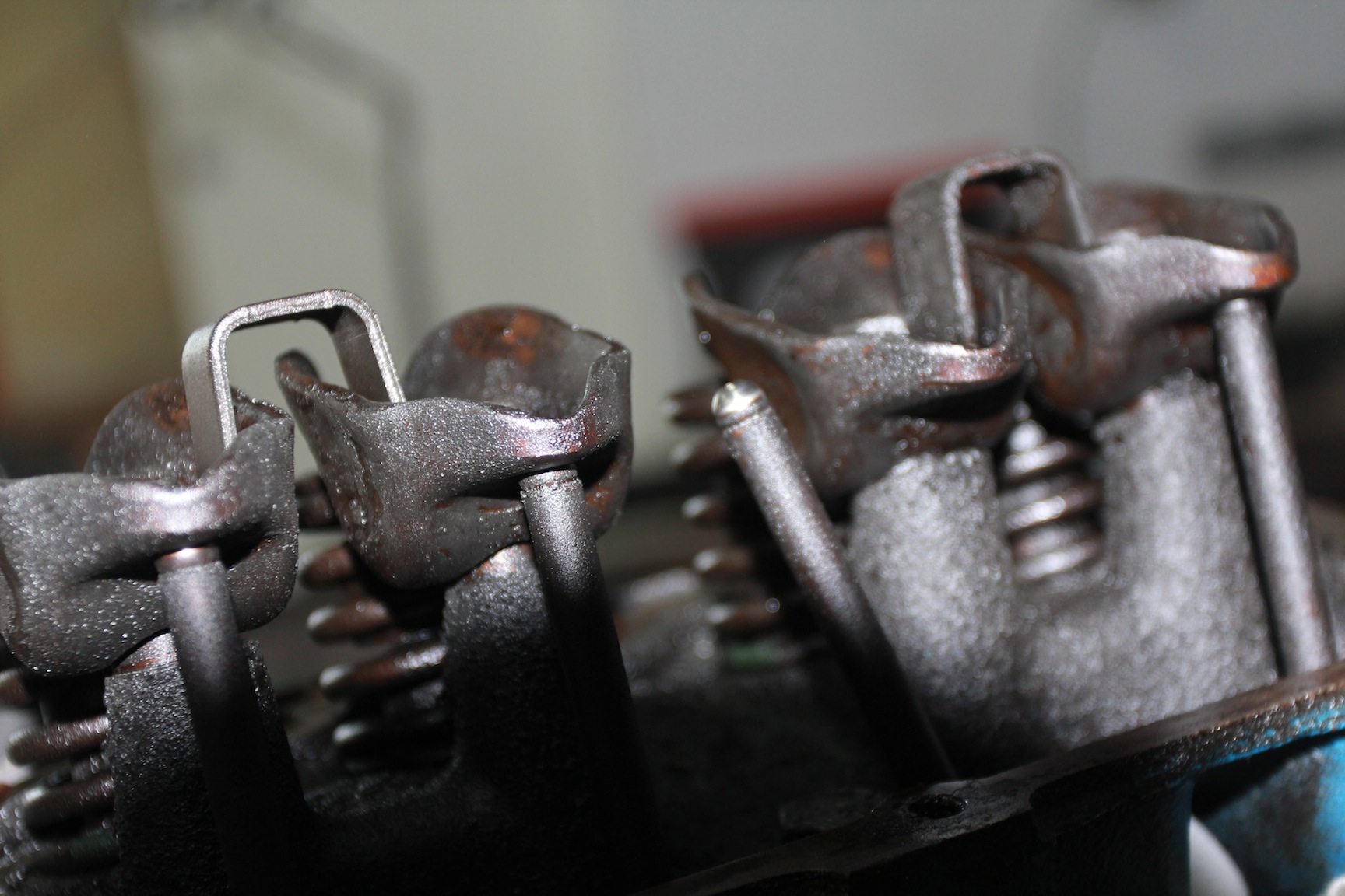

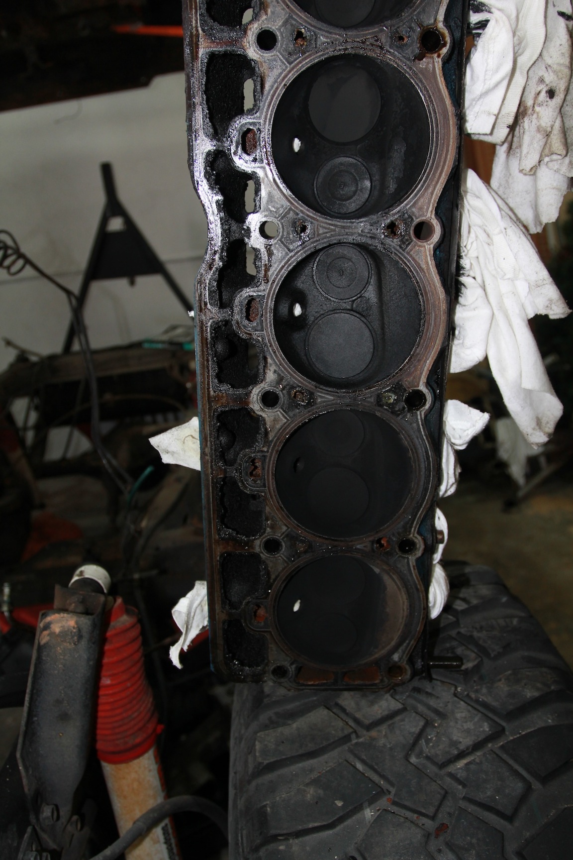

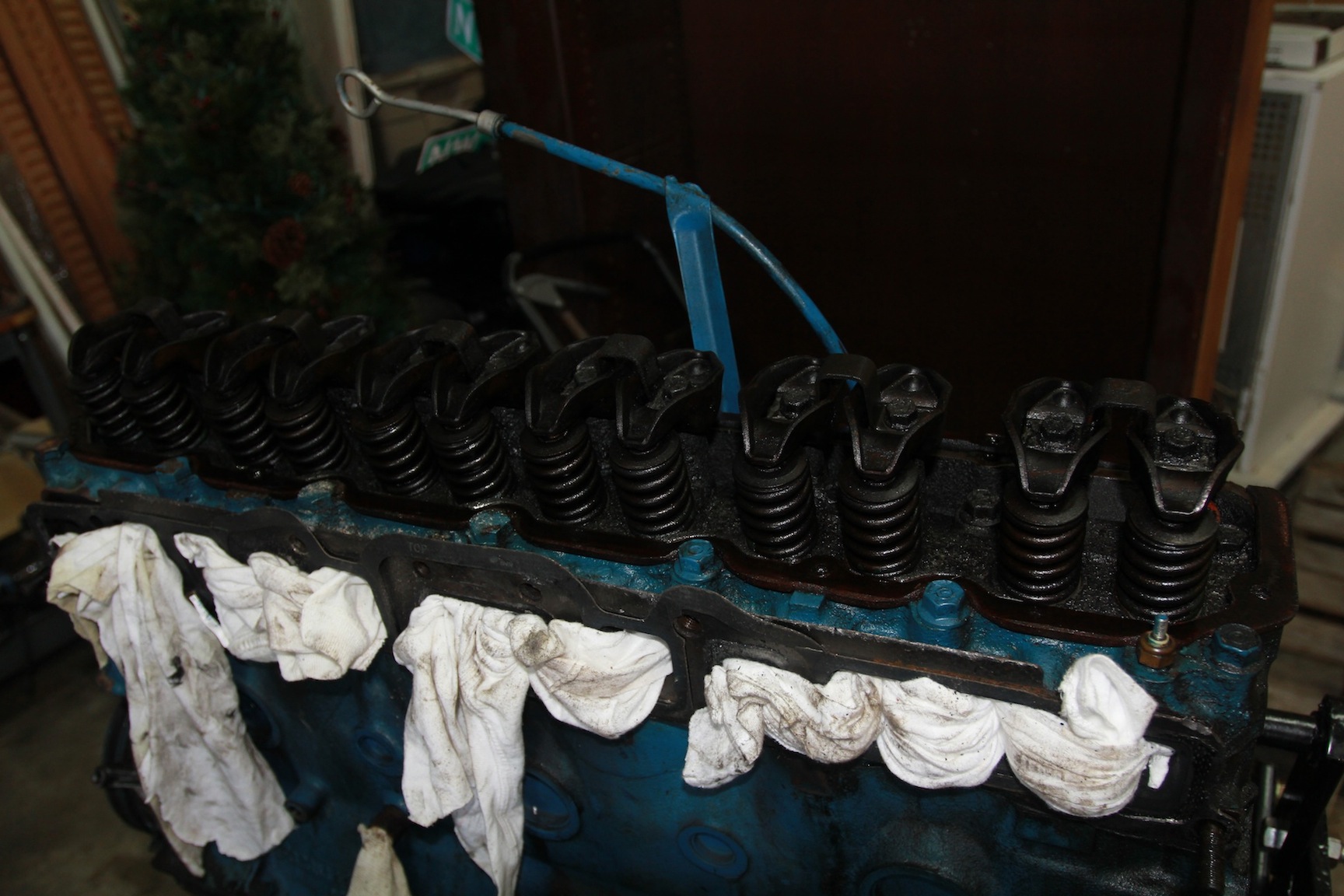

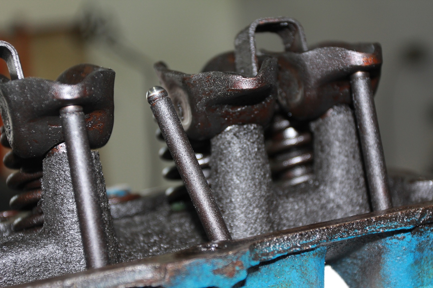

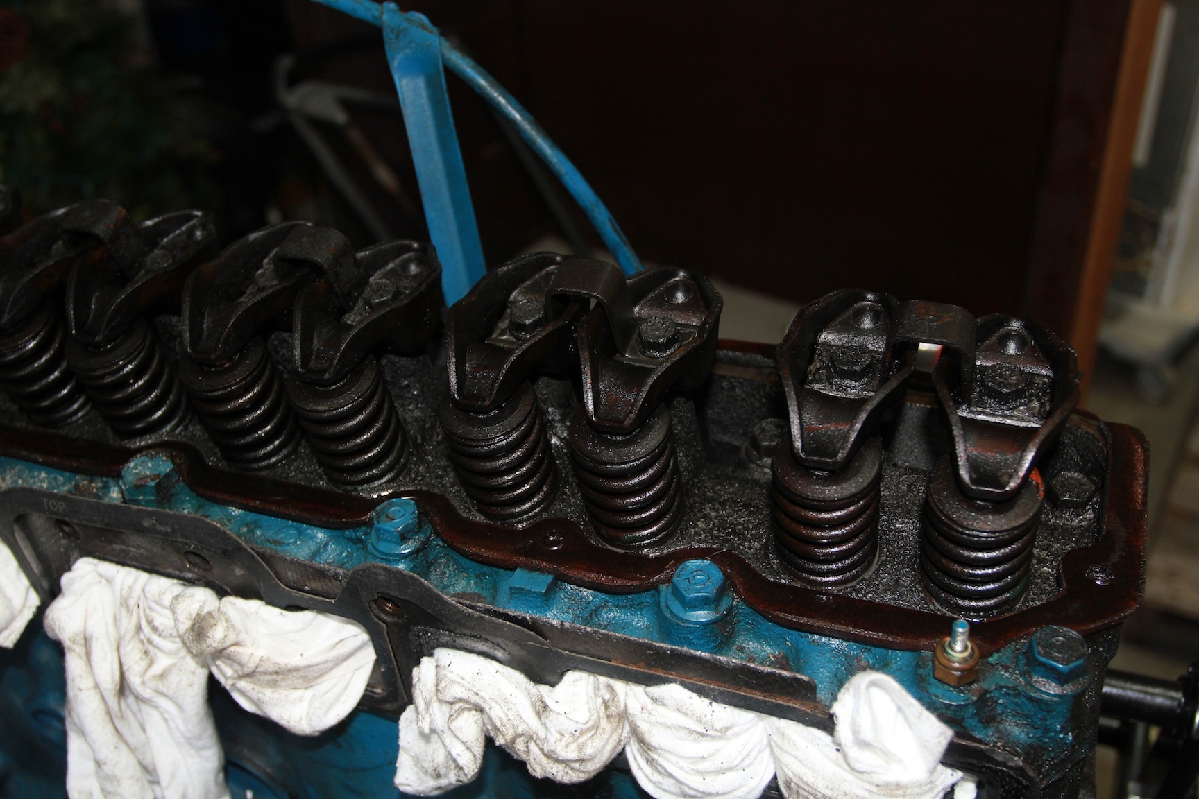

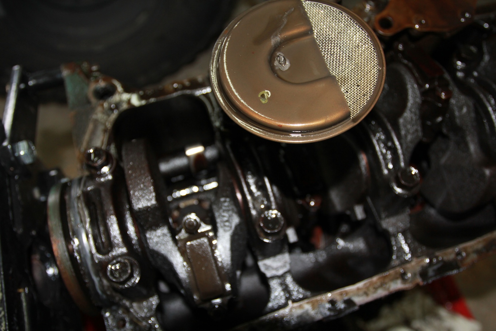

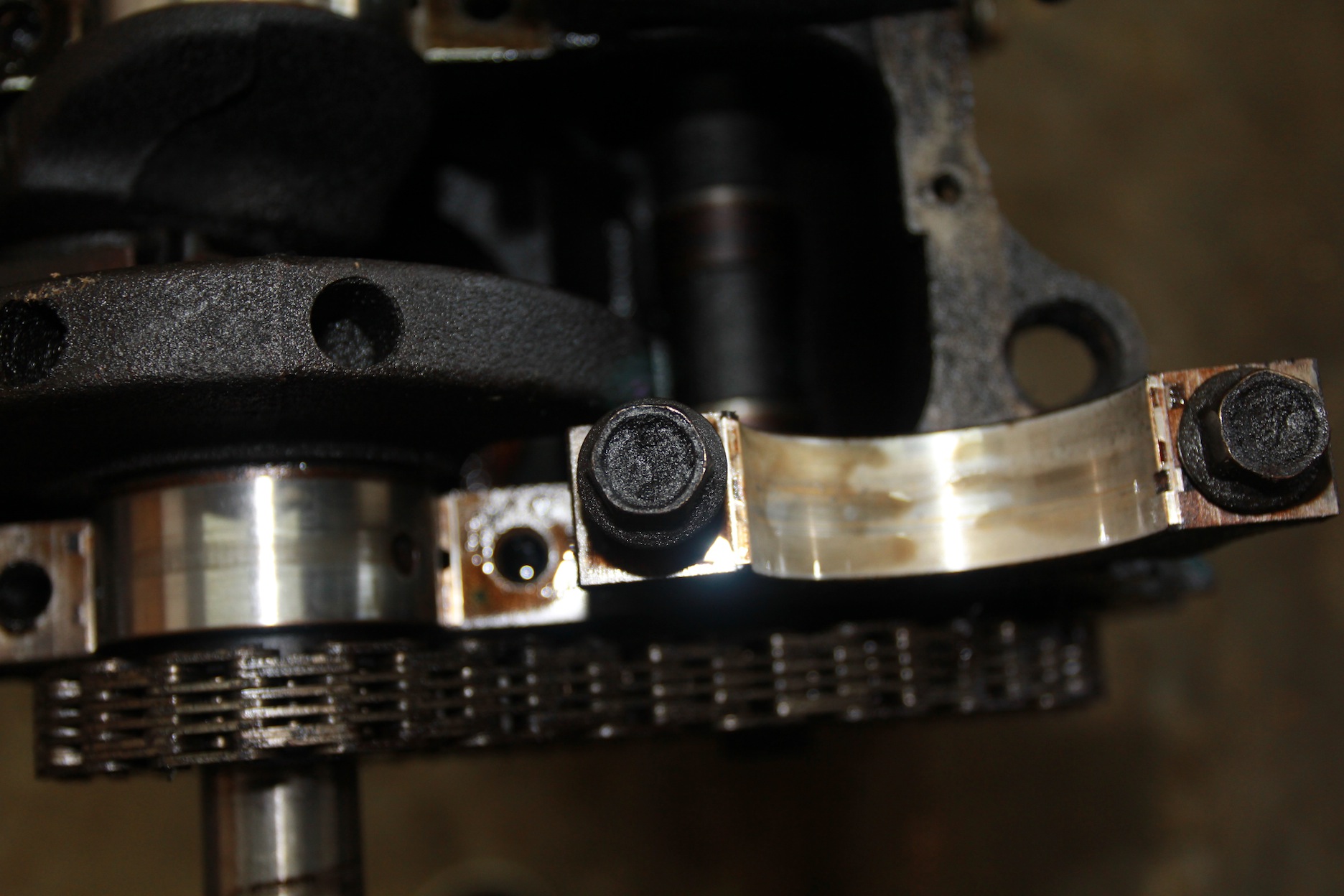

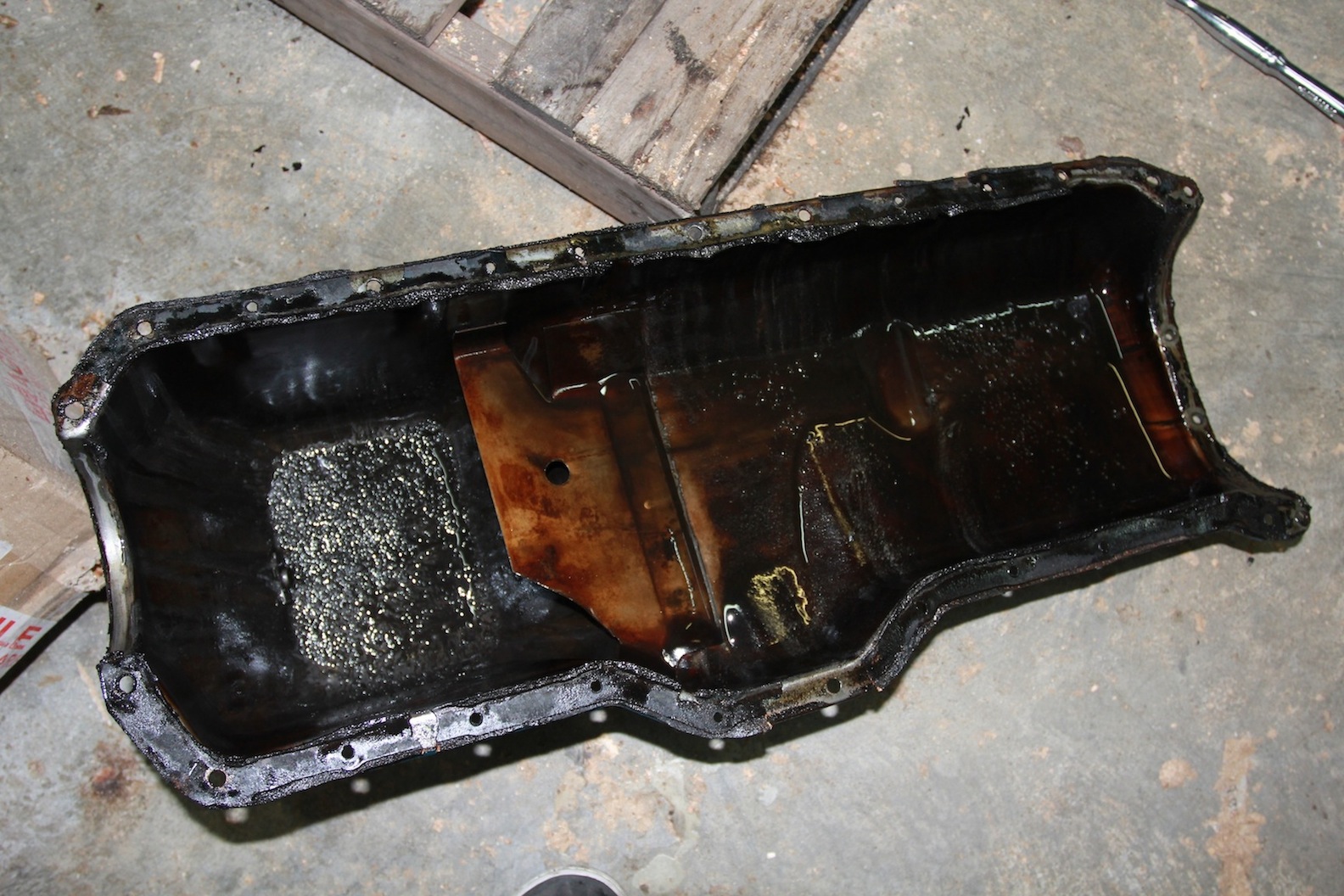

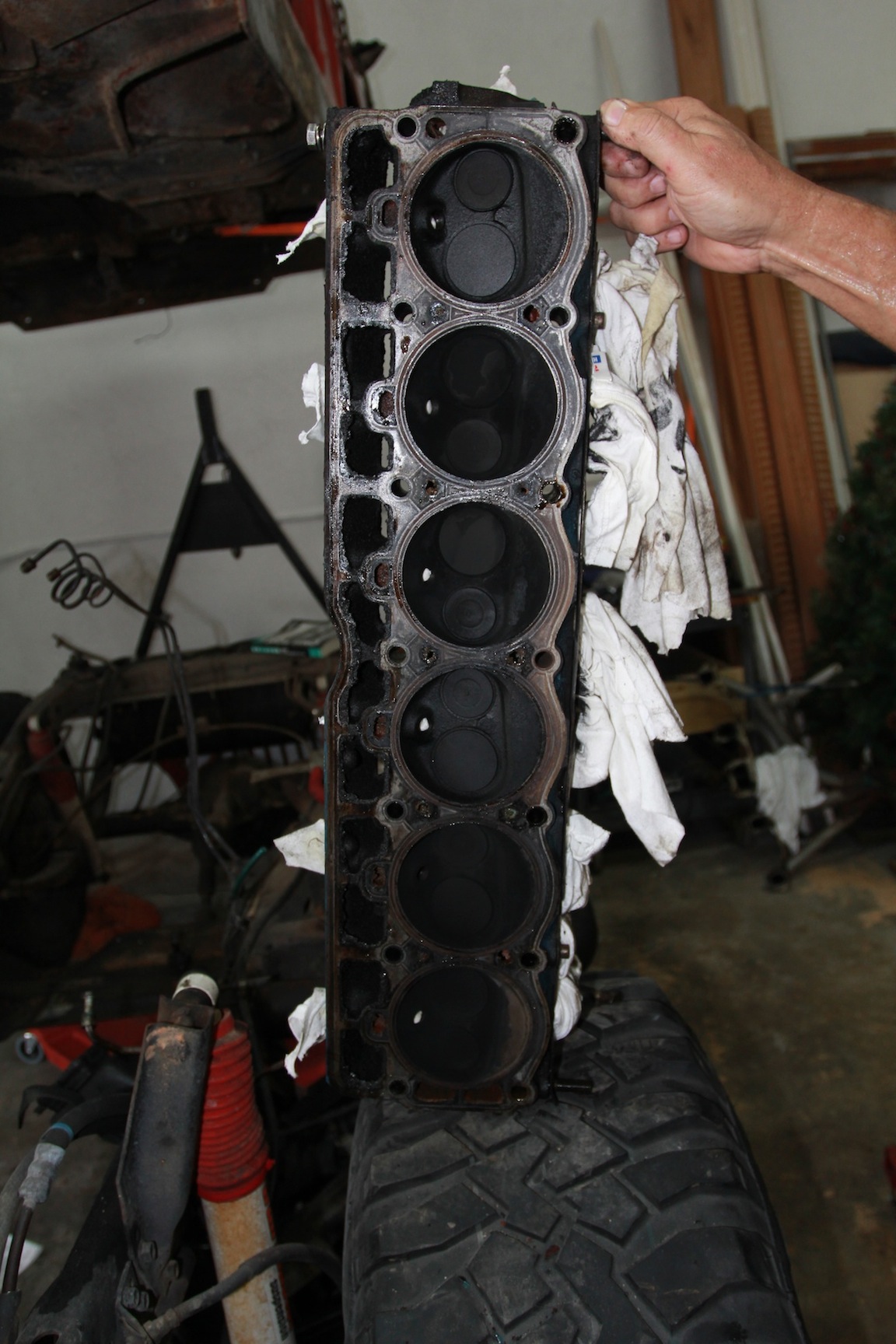

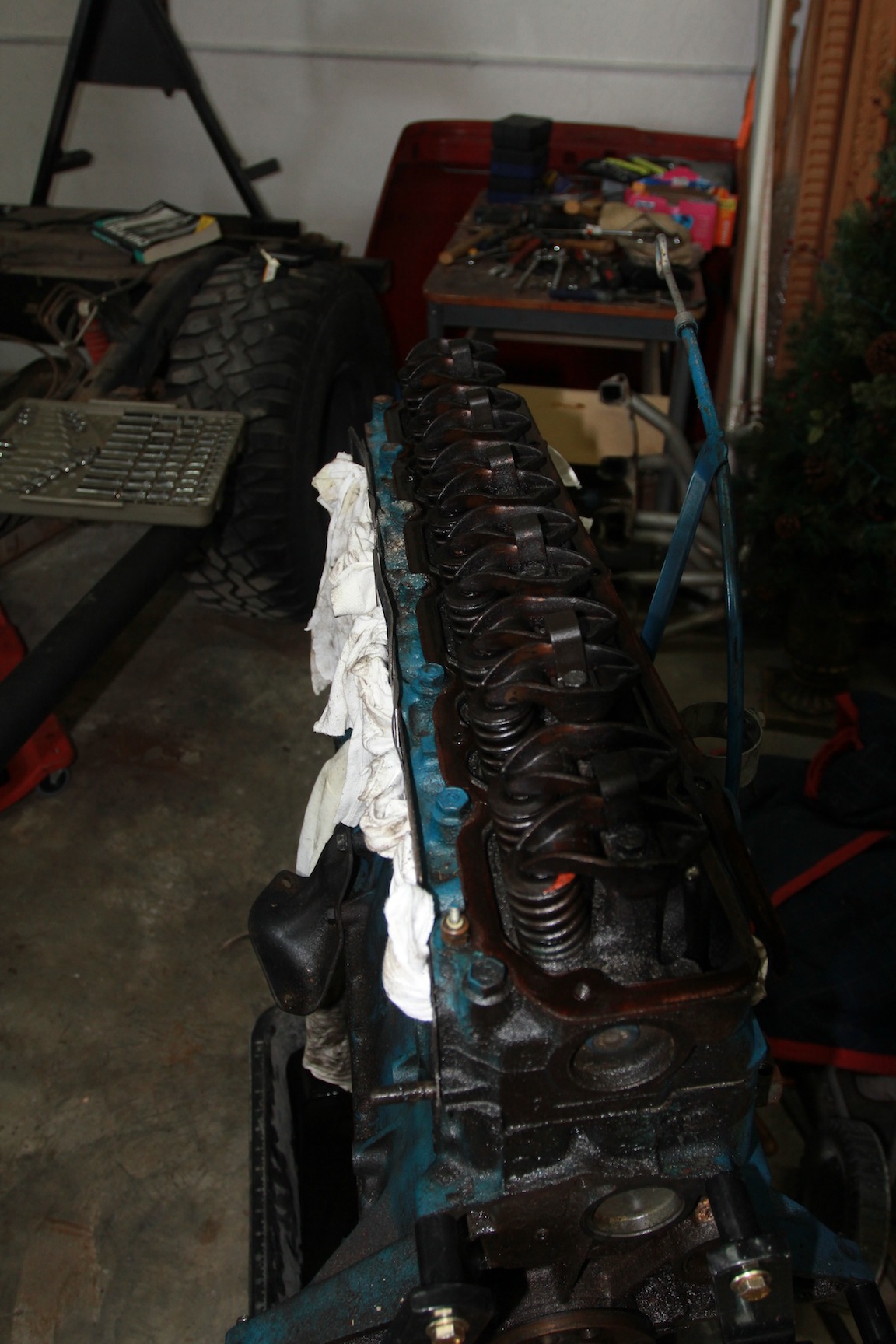

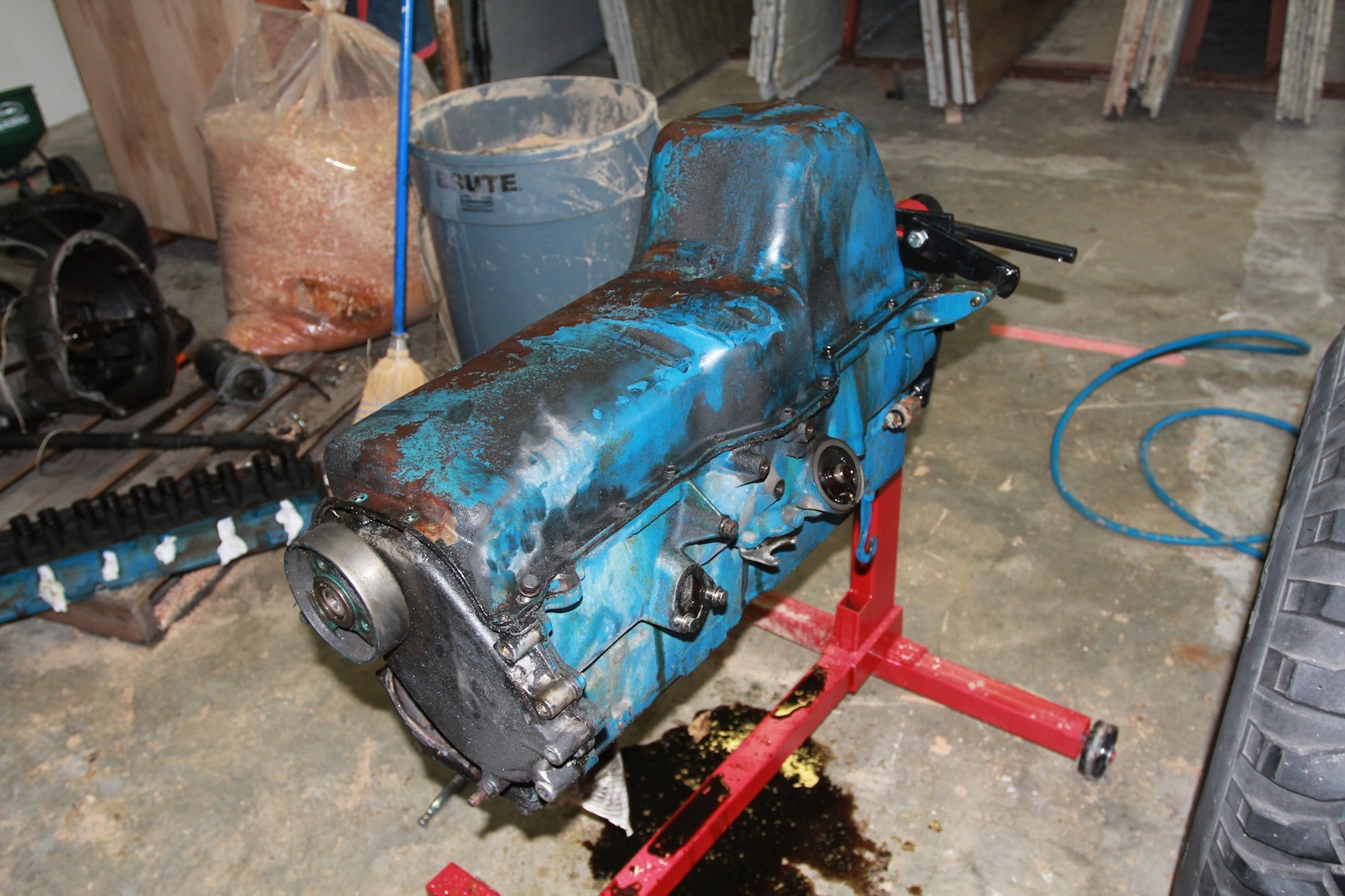

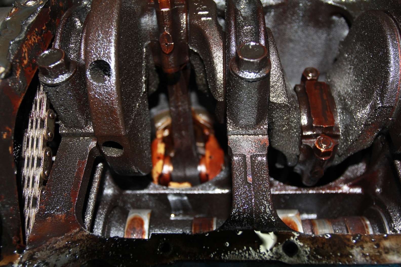

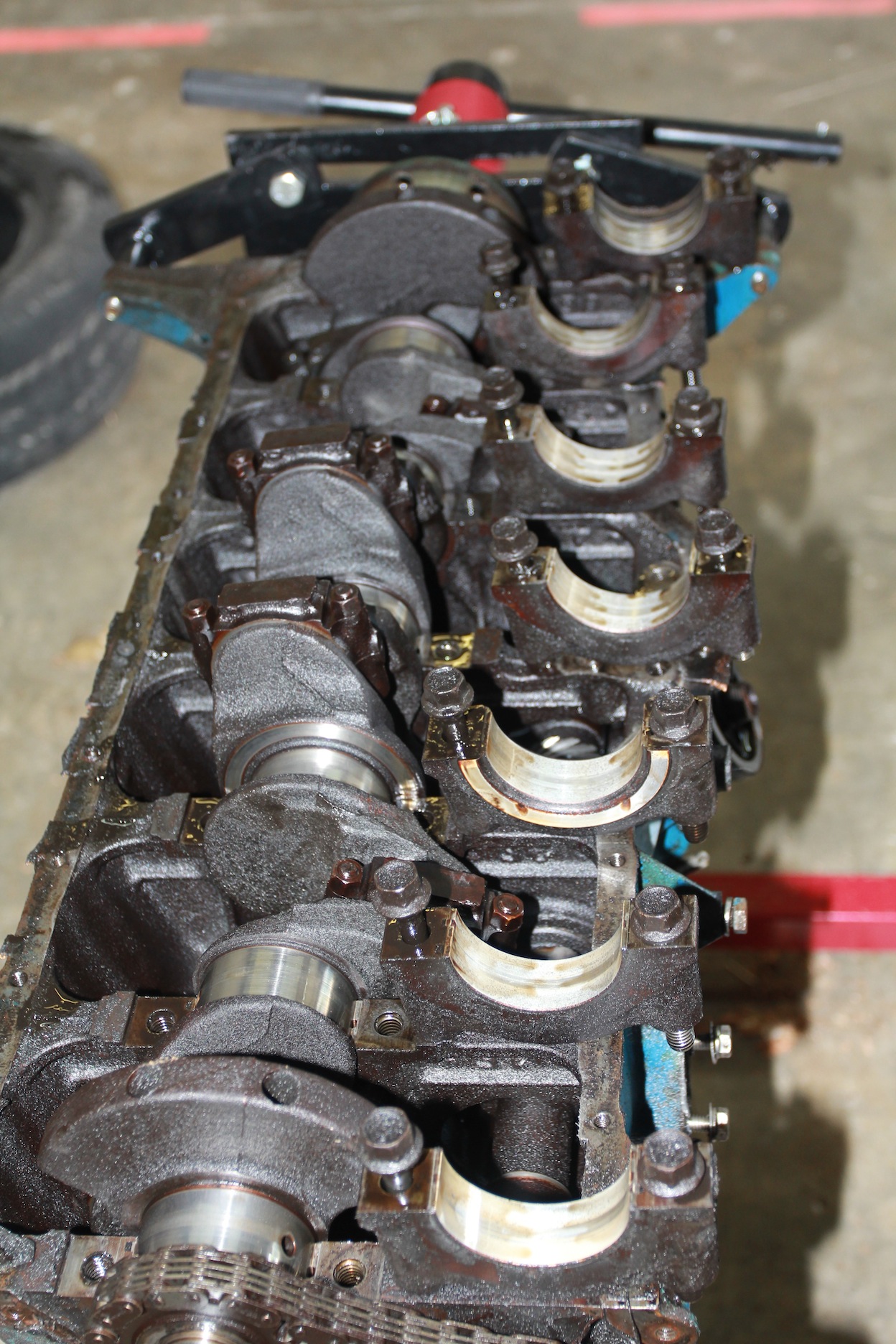

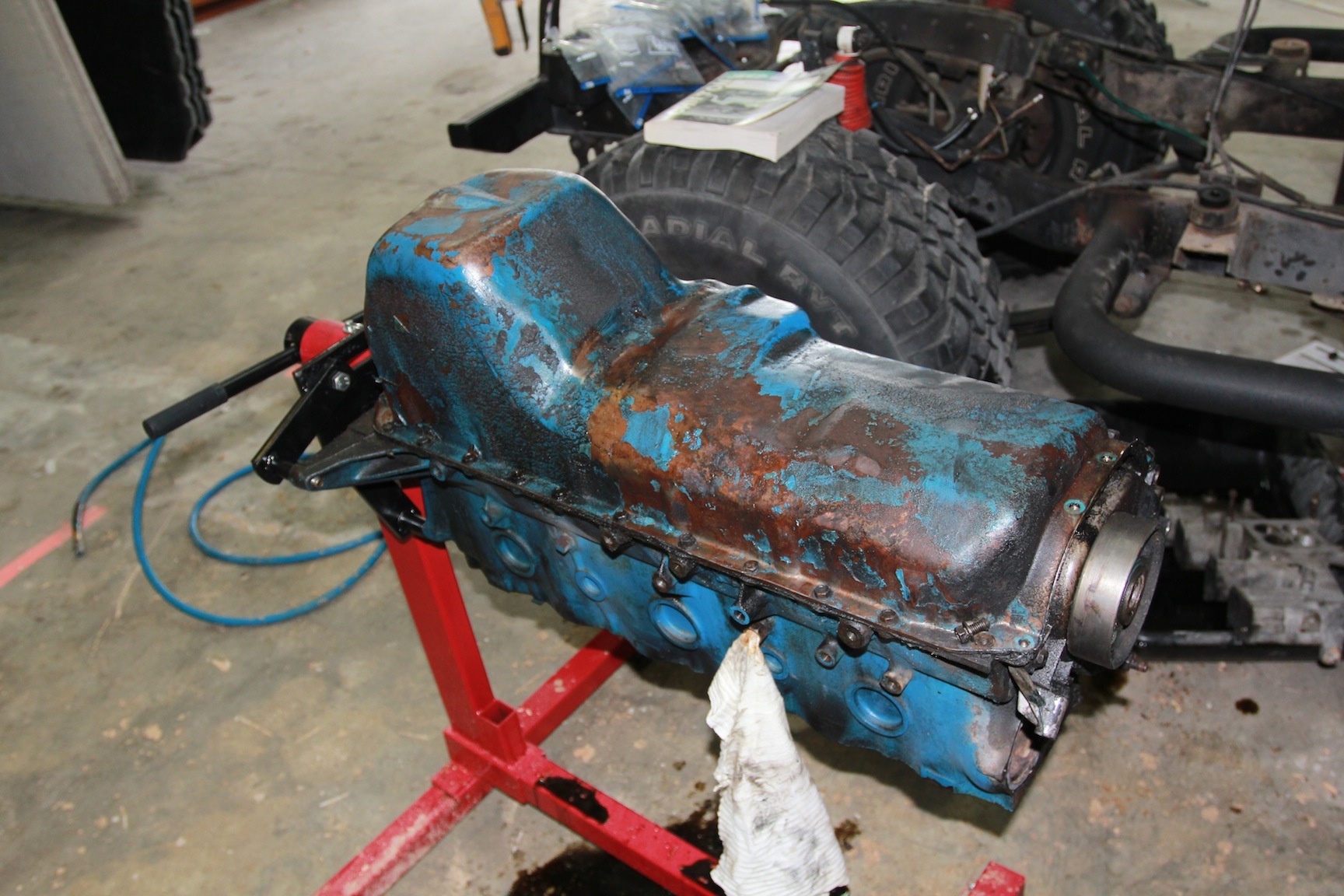

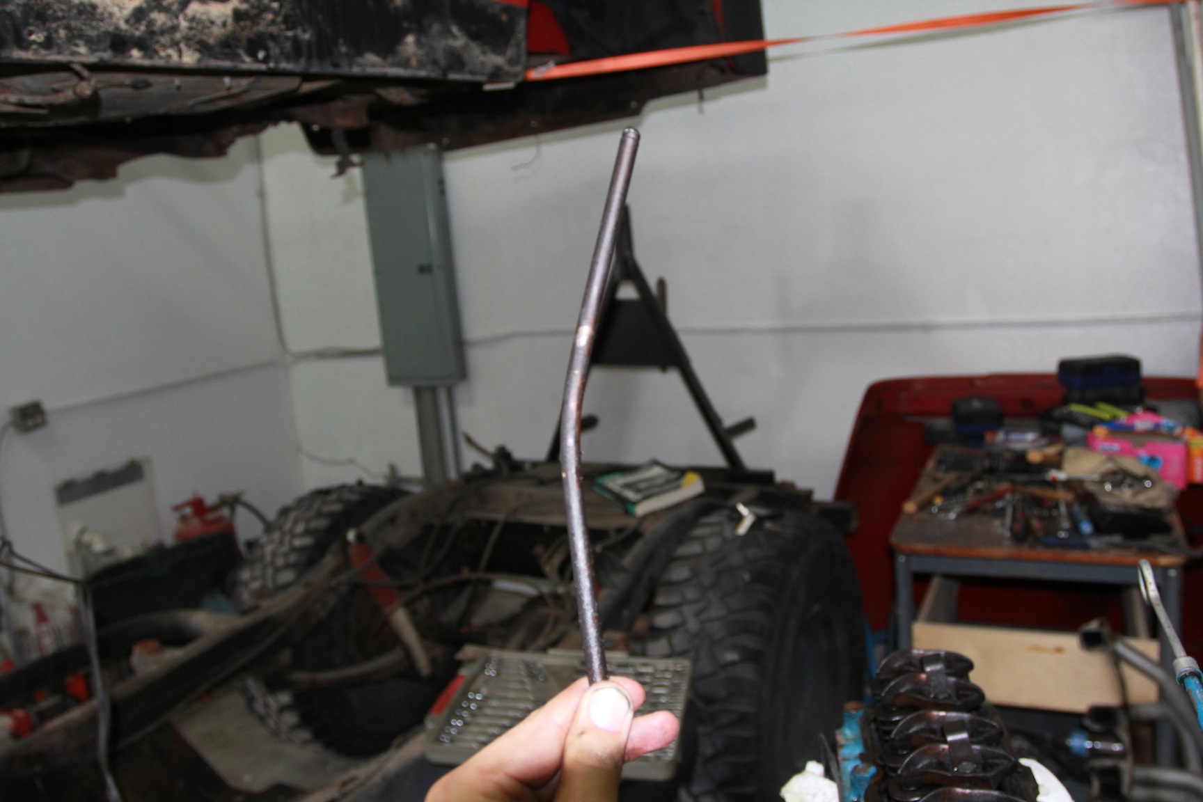

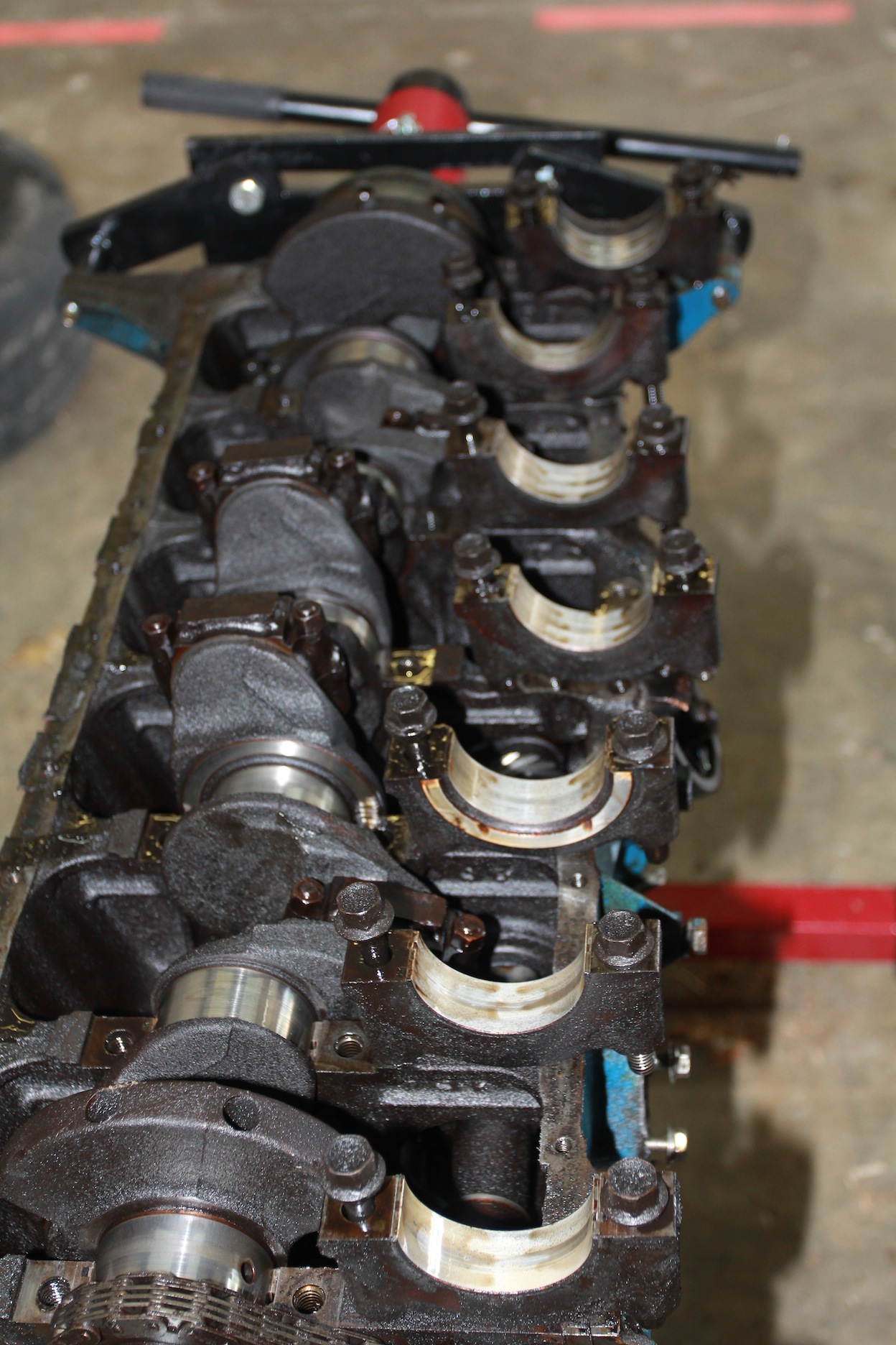

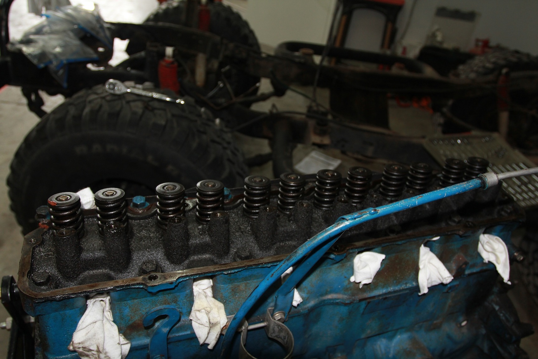

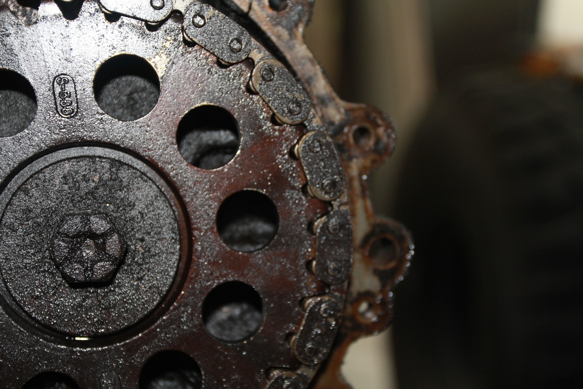

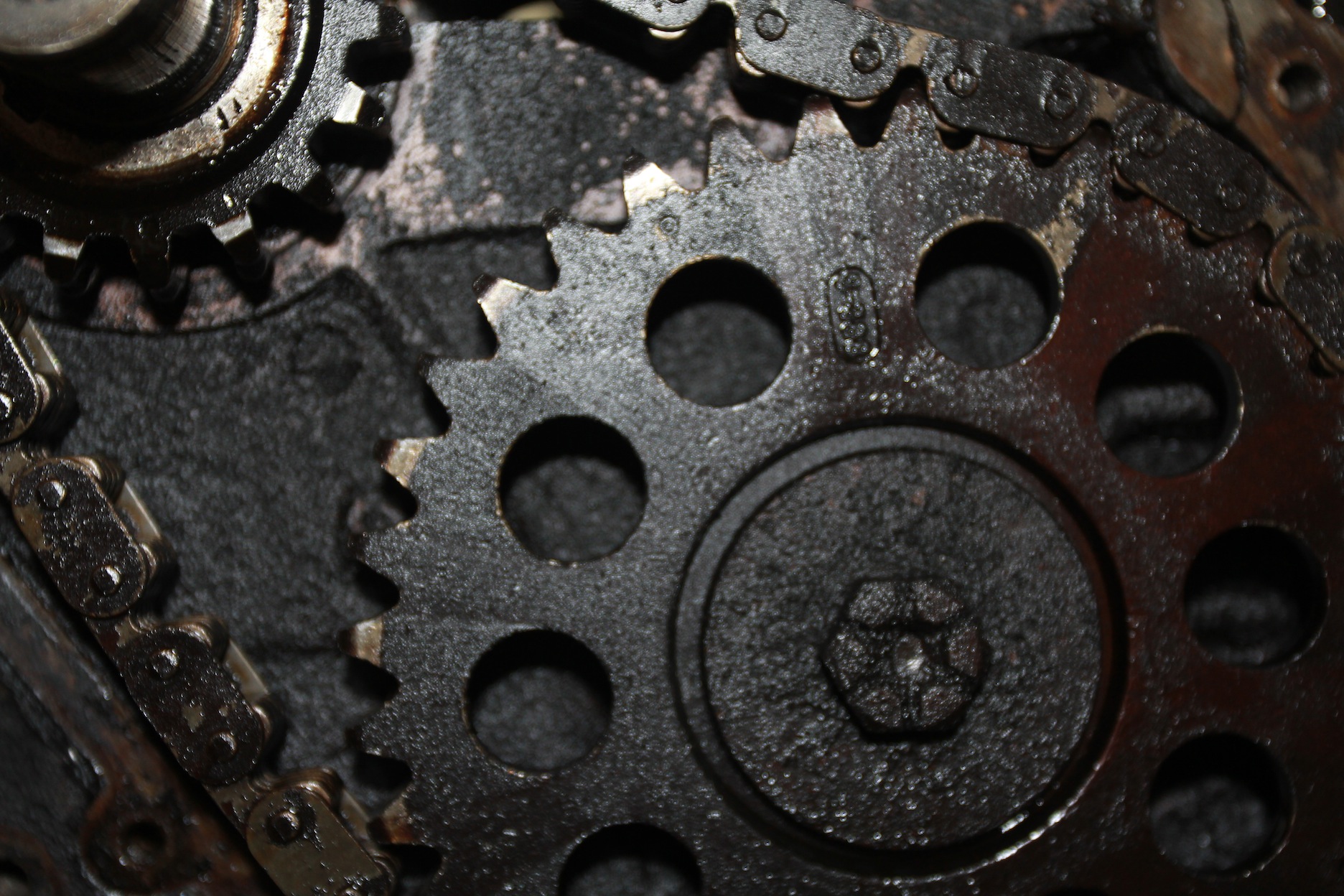

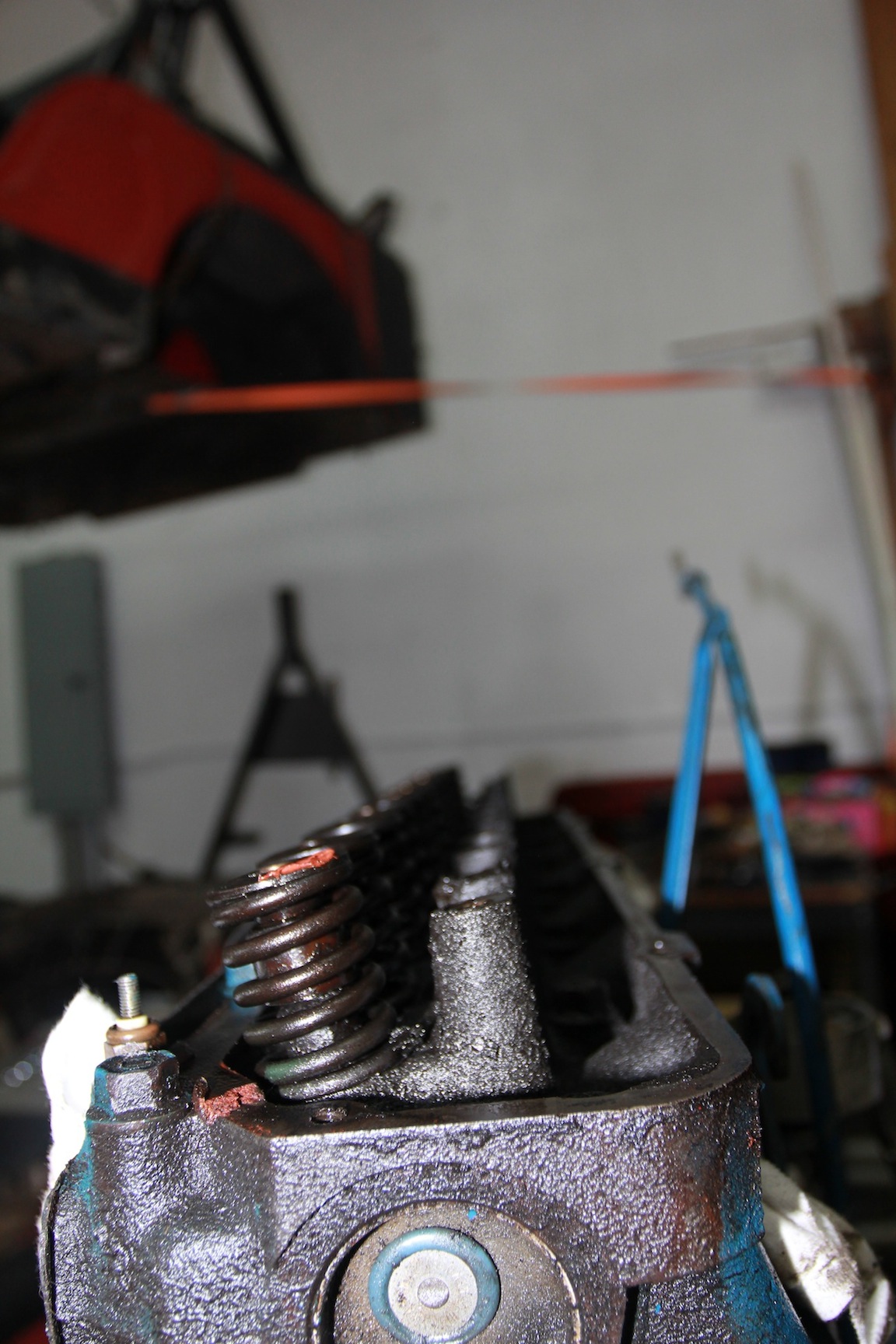

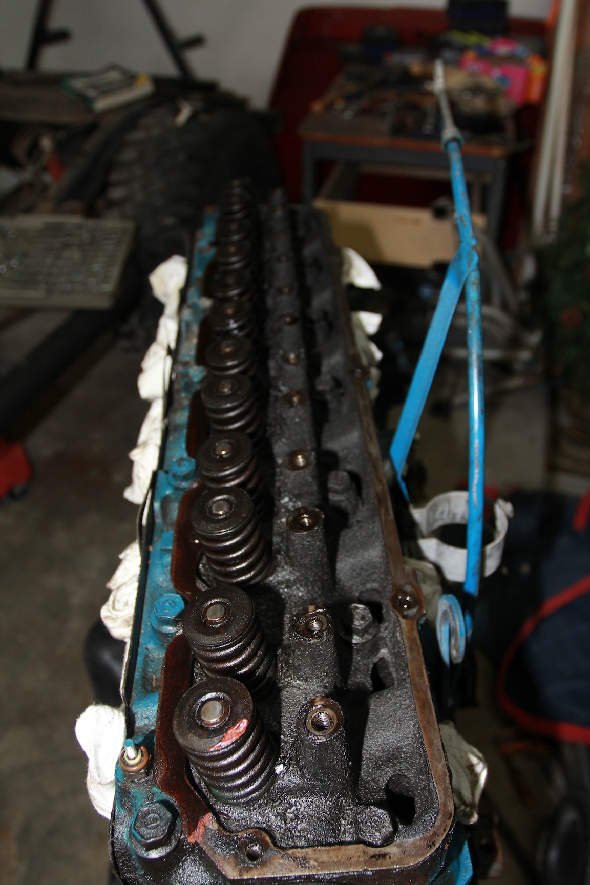

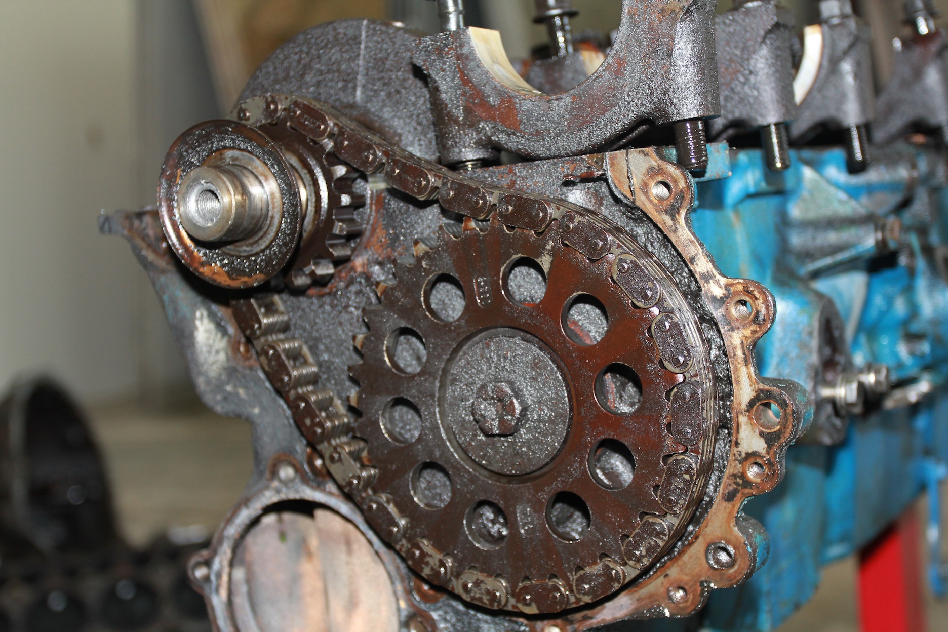

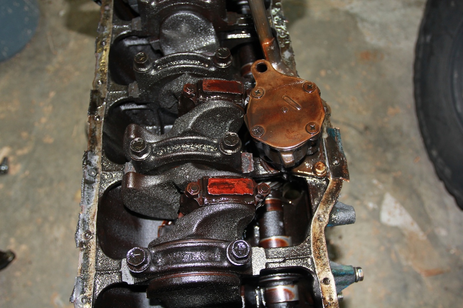

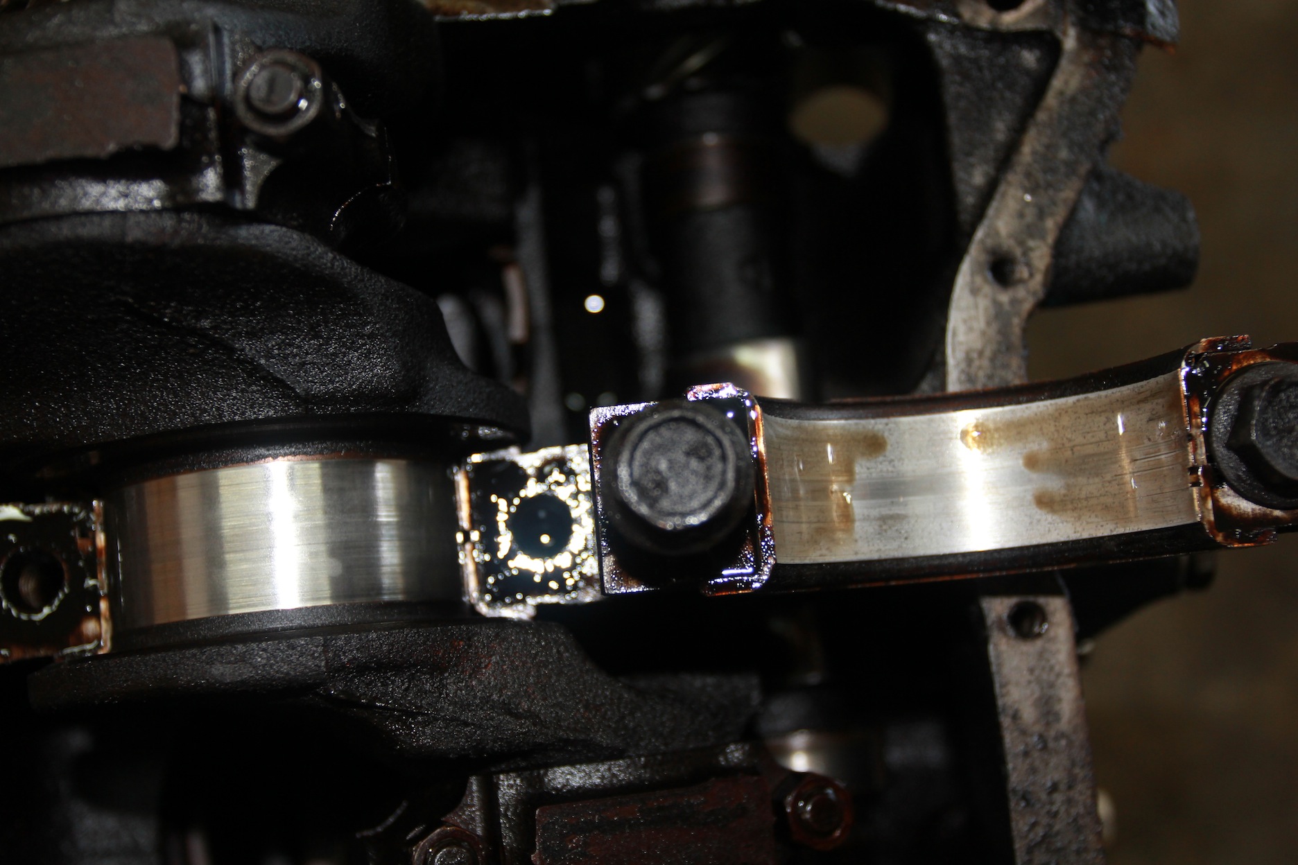

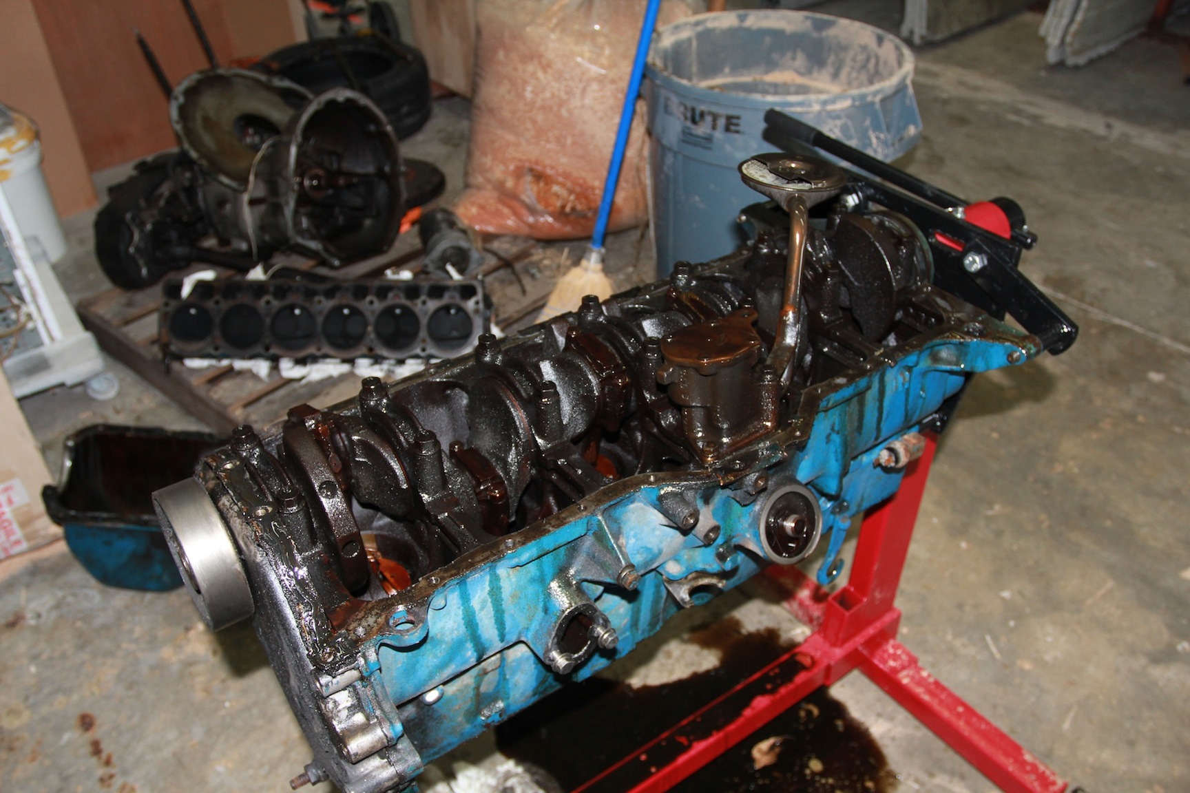

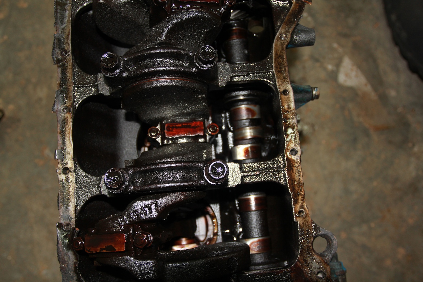

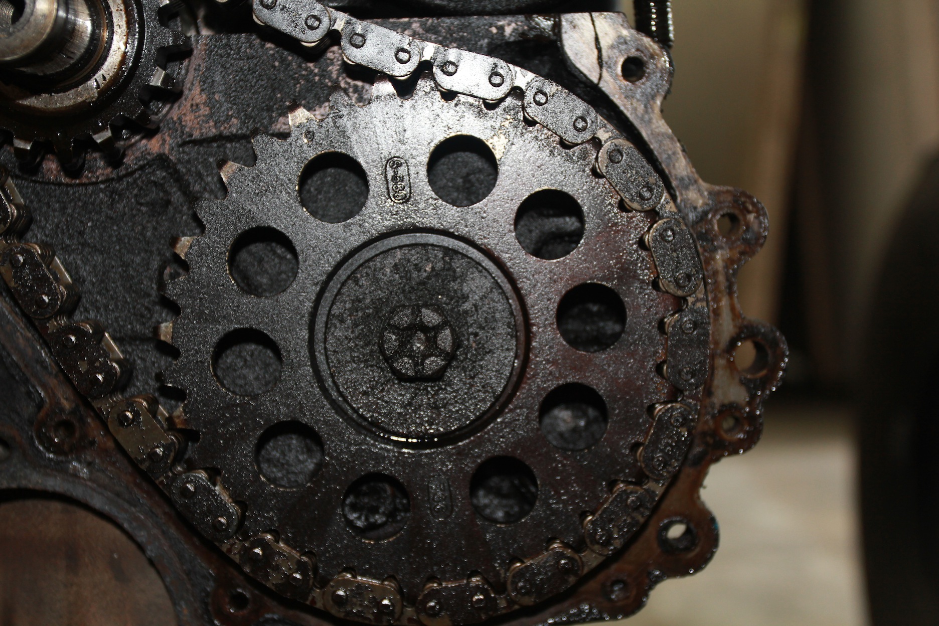

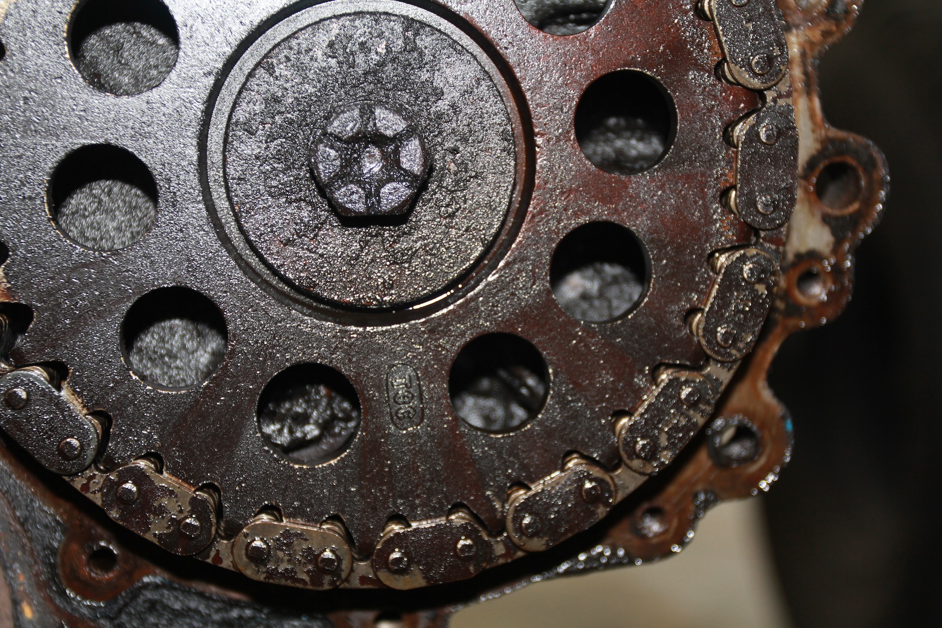

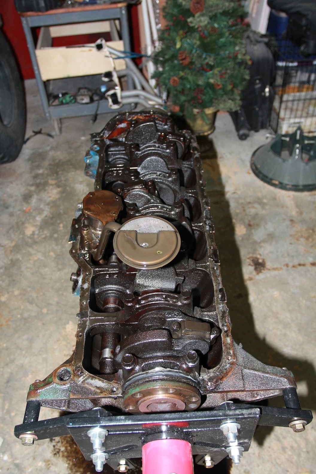

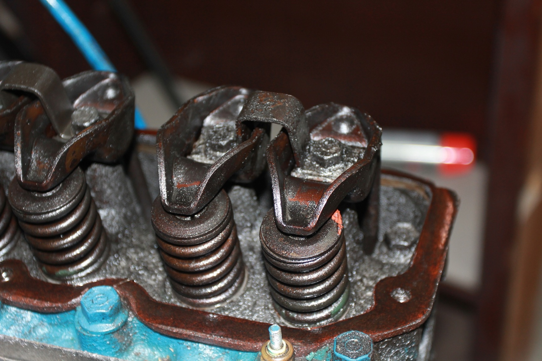

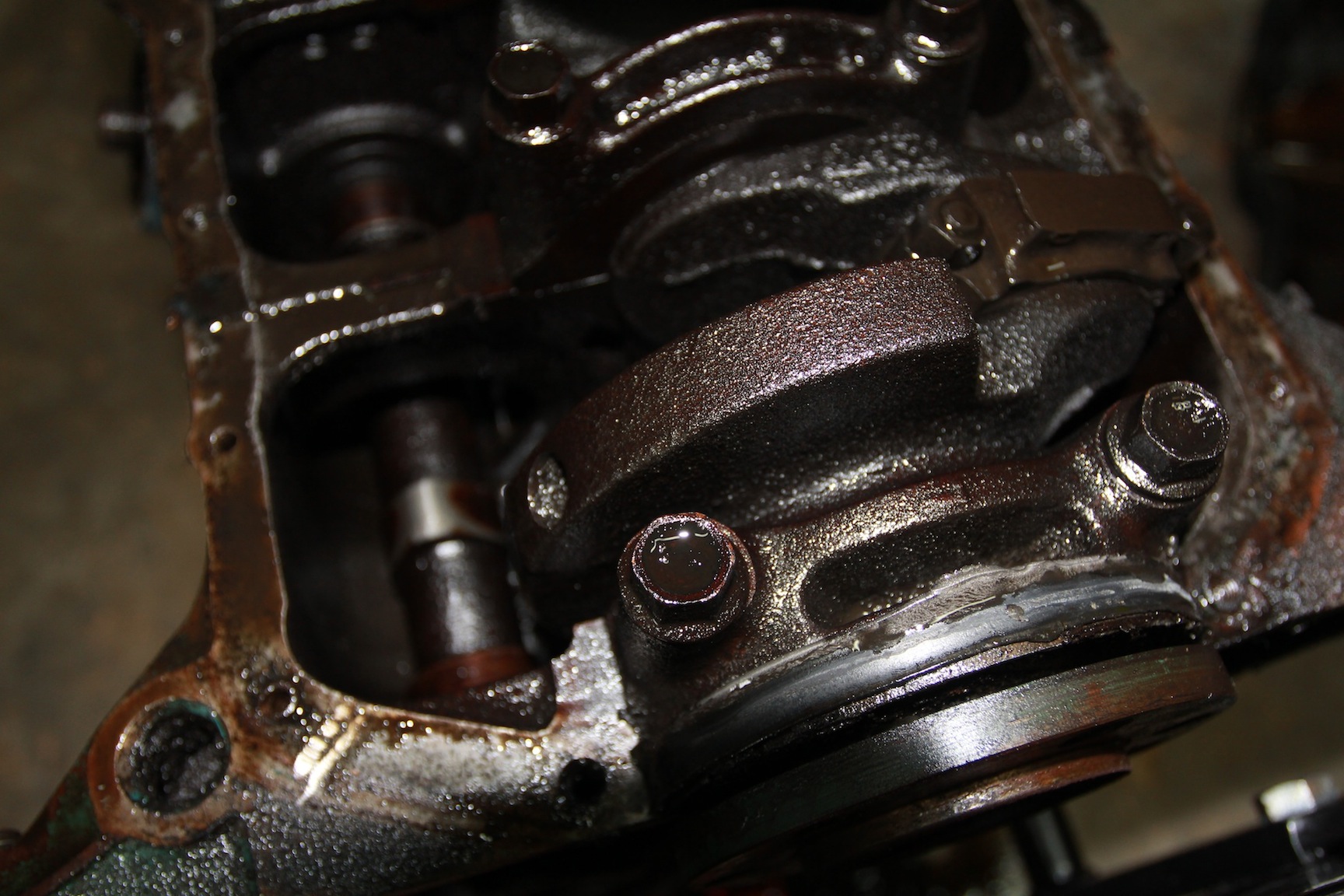

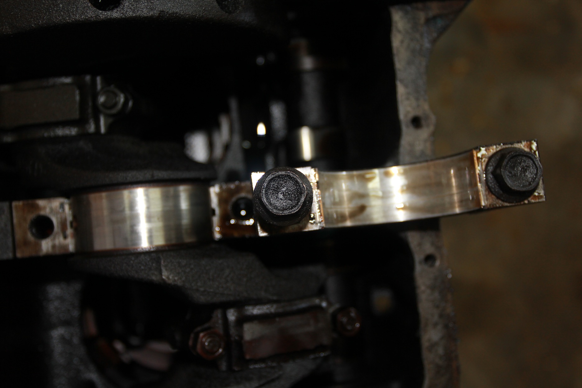

Today was Day 7, I had the engine up on the stand, I removed the valve cover, the push rods, exposed the piston heads, and removed the oil pan to reveal the cam shaft and pistons underneath. Now when i bought the jeep there was an odd clanking noise and the engine wasnt running smoothly. Today I luckly found out the problem, not only did they not put the correct starter which ate up the starter and the flywheel, but two of the push rods were not even connected to the valves and one of the rods was completely bent. Here are some pictures to show that and of the entire days progress.

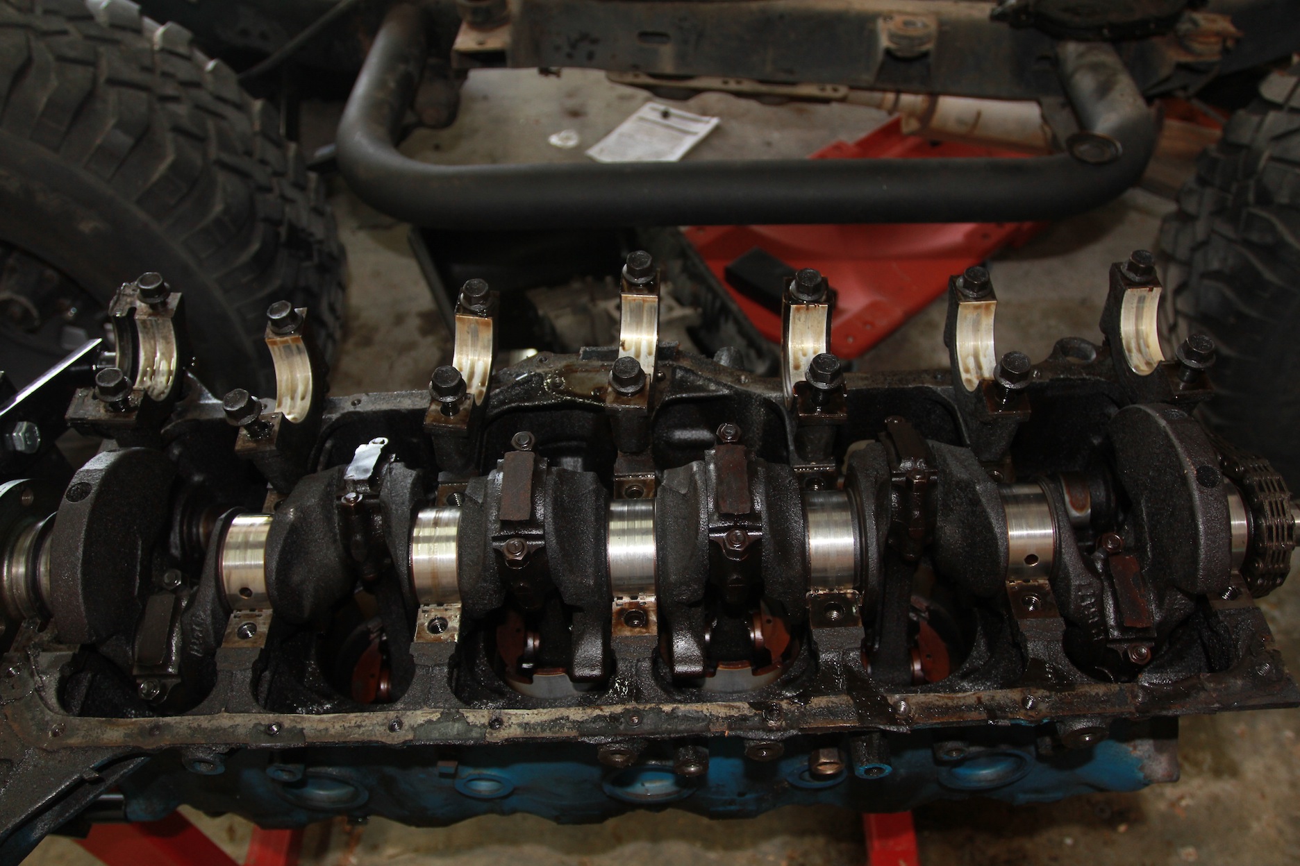

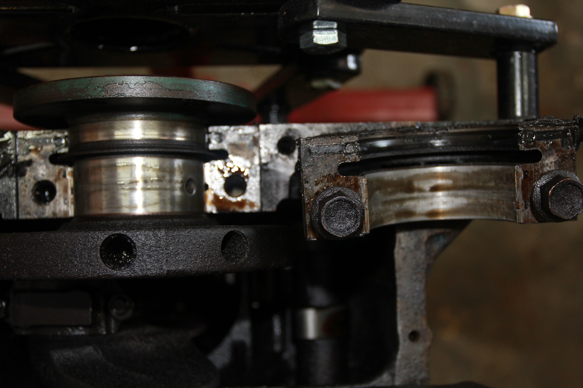

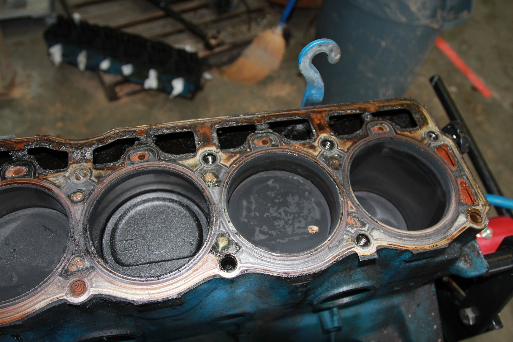

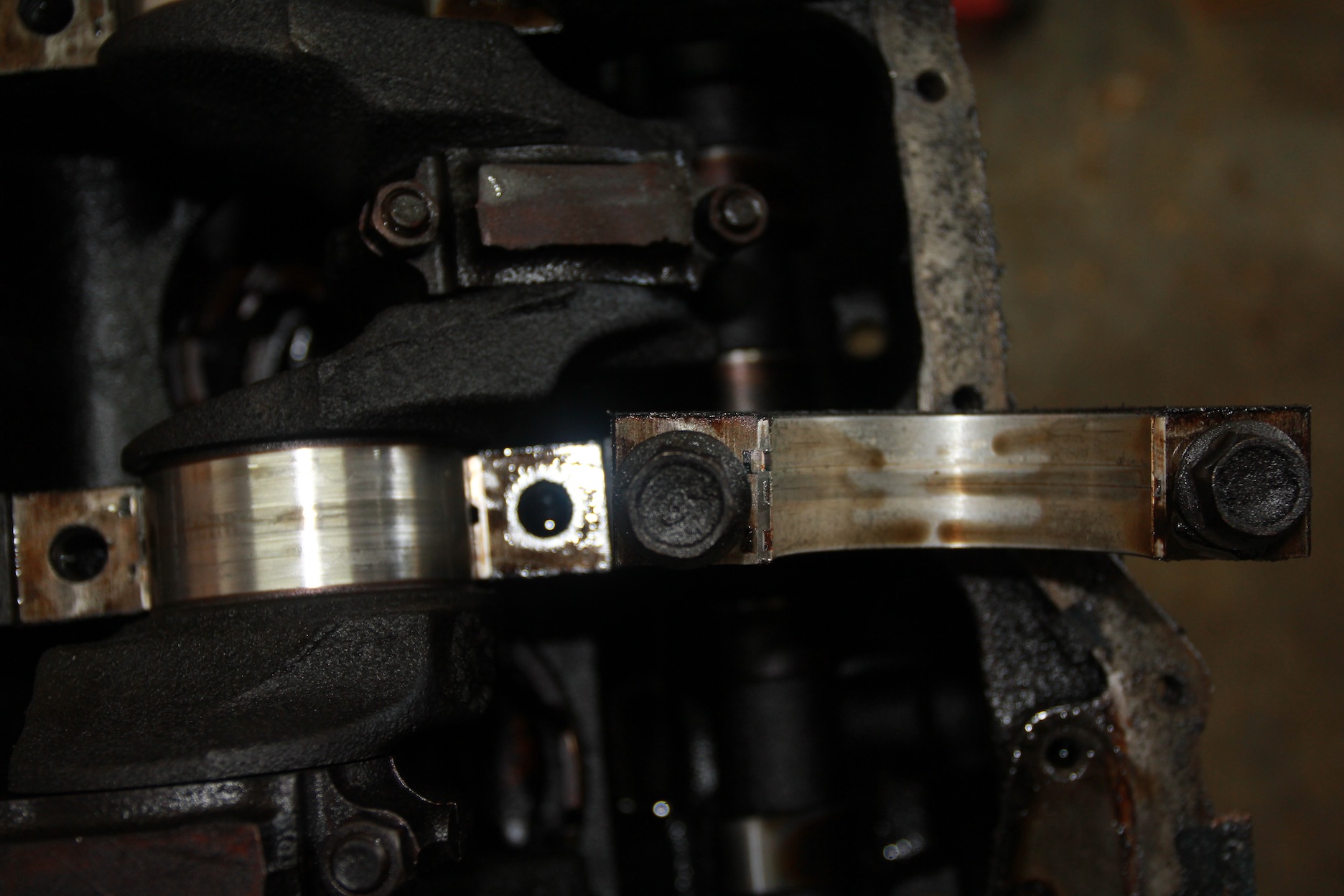

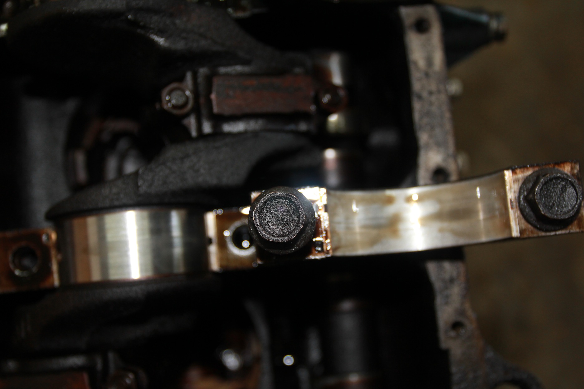

Hey everyone, here are photos from day 8, i got the shafts out and the pistons and I am now ready to send off the block to be machined, sadly I wont be able to be take pictures while it gets machined so thats one process i wont have documented. I found one more small issue today that could of been adding to the problems. it seemed that on the piston spacing rings that go inbetween the shaft and the piston instead of it being a complete circle one of the halfs of the circle folded into the other one and they were overlapped and started to break down and thin out. I have some pictures of the overlap to show what im talking about.
