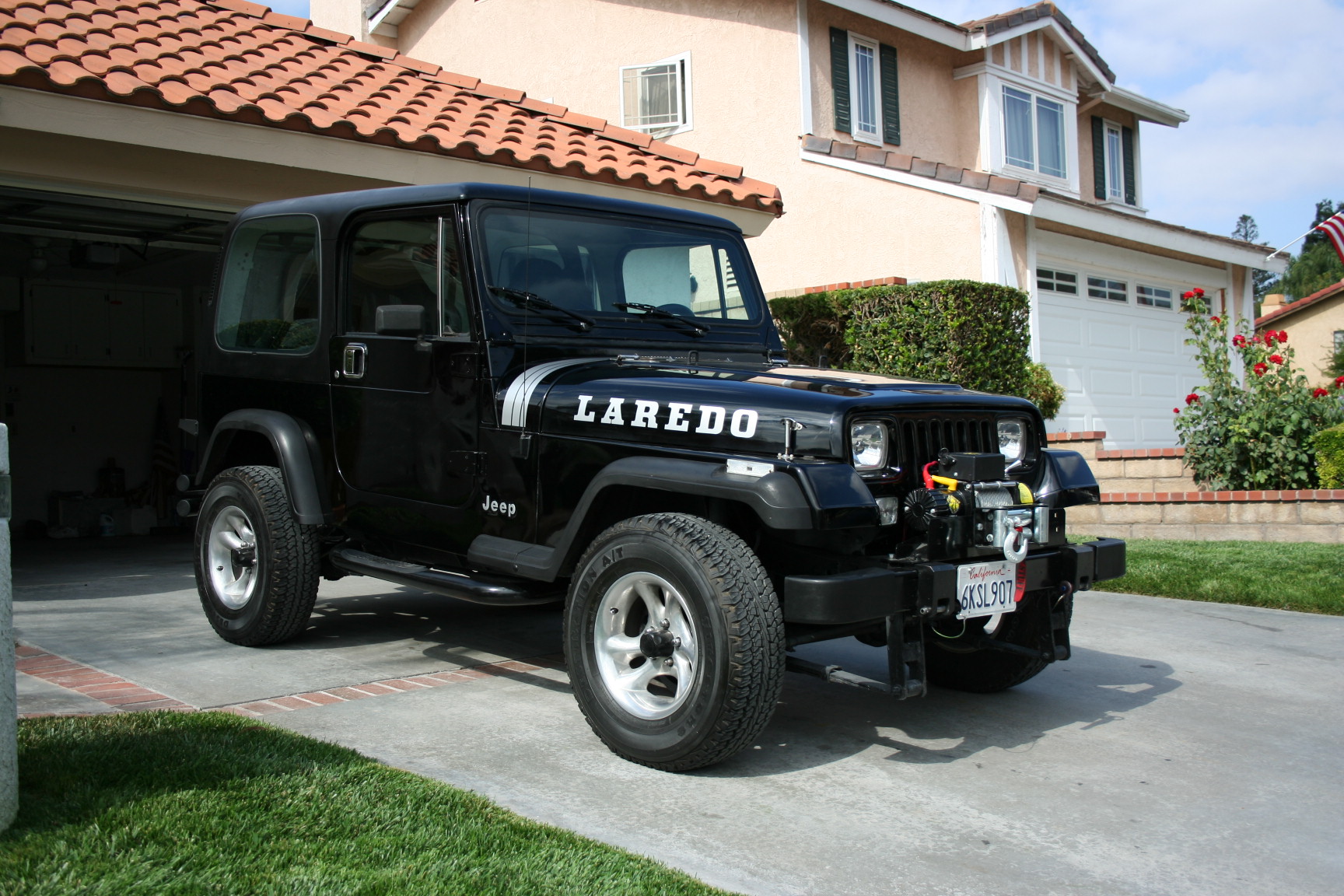

The 87-90 4.2 Yj's utilize 2 sensors to control fuel flow on the (yes POS carter carb). The o2 sensor and the temp sensor located on the intake just in front of the carb . I have replaced both due to problems with my 87.Living in Calif limits what we can do here.
I just finished a complete reconditionin and paint and am now thinking of selling it and going TJ.
