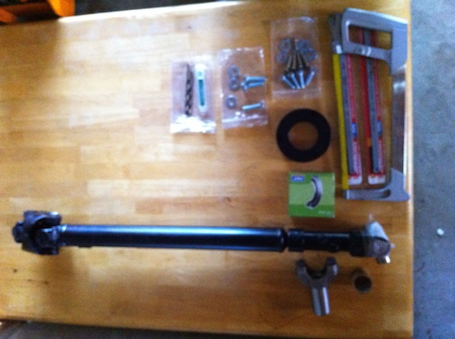

Here's the Iron Rock Off-road Slip Yoke Eliminator and driveshaft. It is the front driveshaft out of a XJ with the AW4 automatic and NP231 TC. New u-joints (3).
What I learned was the 3 bolts holding the cone on the end of the NP231 is NOT symmetrical (not an equilateral triangle - 60*). It only goes on one way so don't be too fast to dismiss it as not drilled properly.

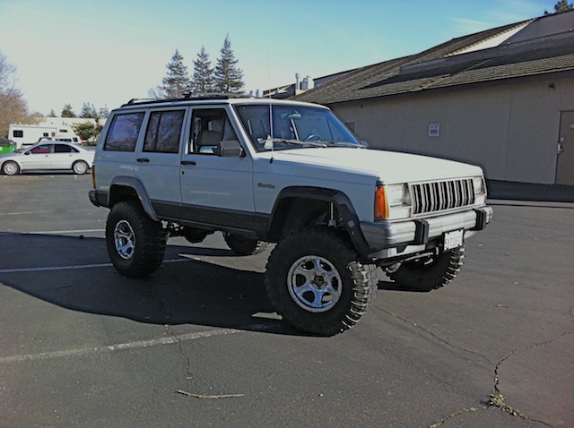

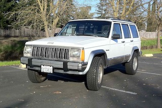

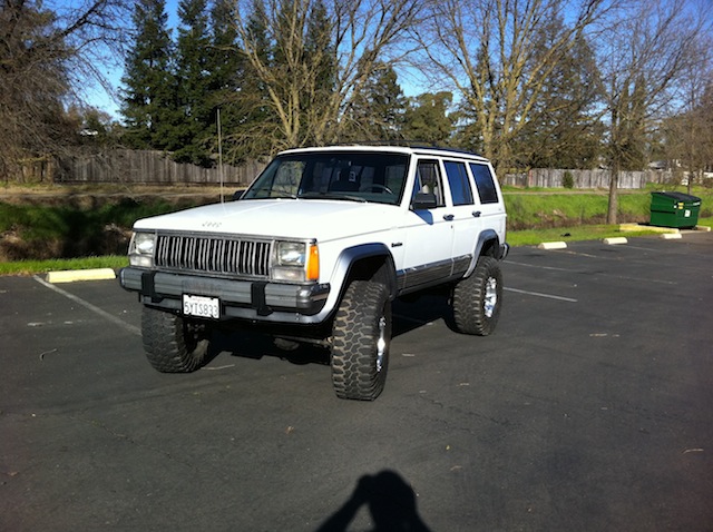

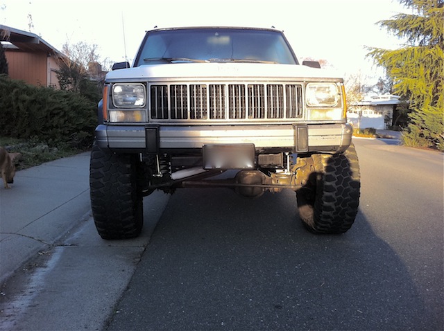

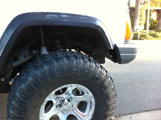

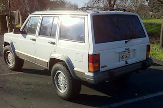

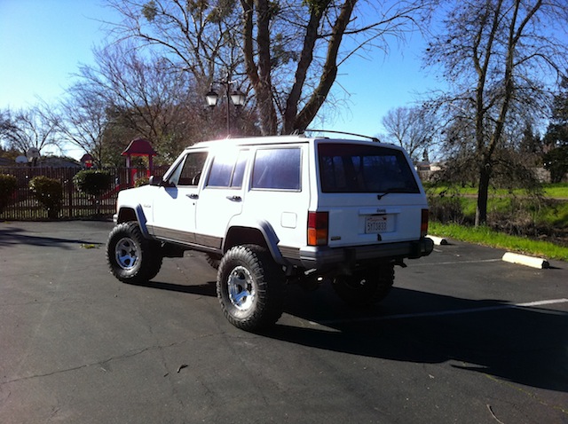

Some before and after shots ...
Looks realy good, what type of wheeling are you planning on doing? there is a cheap method to trimming the fenders and re-using the stock flares. there is a likely hood that you will rub.
I really like it, I prefer the pre 96 XJ's, I think they simply look better.
jps4jeep: Yeah, fender trimming and the rest is in the planning stages now. Then, off they come for paint and refreshing along with grill, bumpers, etc.

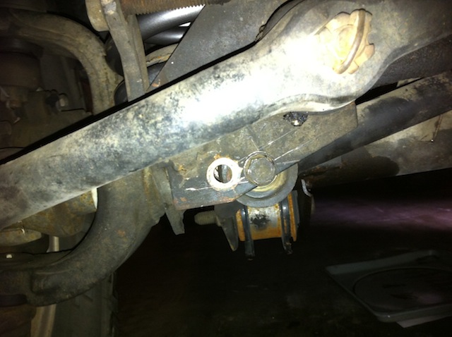

As I stated previously, the track bar is getting out toward the edge on the front of the track bar mount. My thought is to weld a plate to the front of the "channel" to give more material. As the existing mount is only 1/8" steel channel, then adding a 1/8" steel plate to the front that extends 1/4" below and 1/4" further toward the driver's side should be more than sufficient, strength-wise. The back part of that channel has NOT been cut off like the front so there is plenty of strength back there.

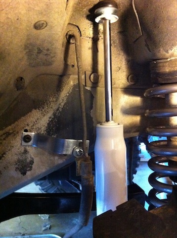

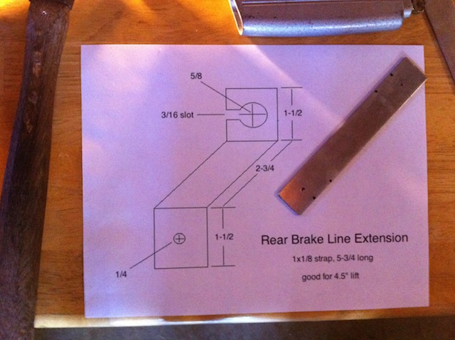

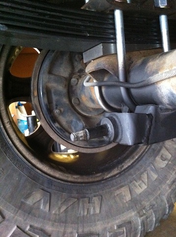

The next thing on the list to do was relocate and secure the front and rear brake lines.
After a fair amount of research, I discovered you do not need to get longer brake lines but relocate the ones that are already in place. GoJeep has a write-up on doing the rear brake line and most of the suspension suppliers have a similar bracket for the front.
After finishing, full flex is still there.

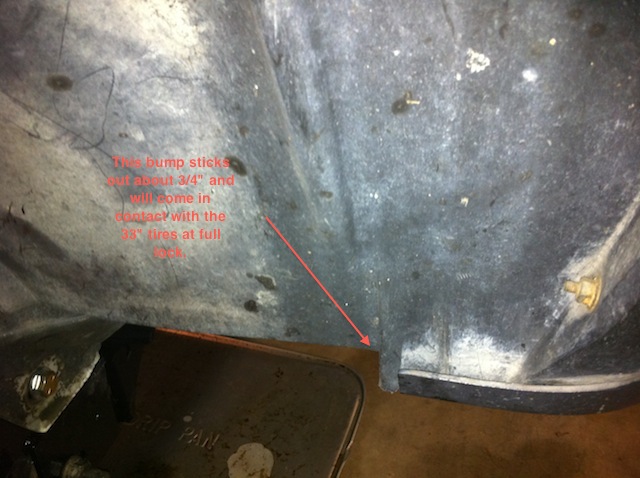

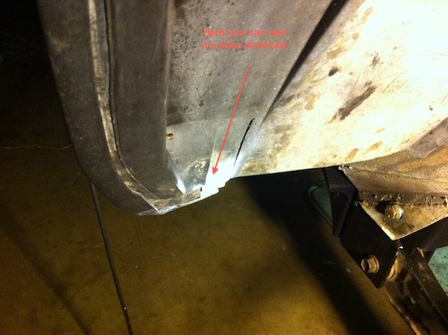

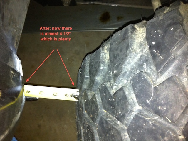

Pulling in and out of my driveway or making a tight turn at speed, the tires would rub on the back side of the front venders.
GoJeep has a great write-up on getting extra space for clearance just for that situation. How much space? Here are the pics.
Over the last couple of weeks there has been a whole lot of prepping, waiting and not a lot to show but, at last, there is something of some significance.
1 - Prepped the track bar mount, control arm drop bracket reinforcement and rear shock mount (cut for relocation) for welding.
2 - Did some fender liner and sheet metal trimming. Removed the front valance.
3 - Found a hole (no idea when or how it got there) in the vacuum bottle located behind the passenger side of the front fender … no wonder the speed control barely worked and the heater operated funky.
Welded the track bar reinforcement in place. Cleaned up and painted.
Not so much luck welding the CADB reinforcement. Turns out the welder is too small. Cleaned up area and repainted. Needs to have something before going off-road … I have another idea I'll share later after it is designed and installed. Didn't try to weld the shock mount for the same reason.

Here are some pics of the completed fender/liner trimming --
