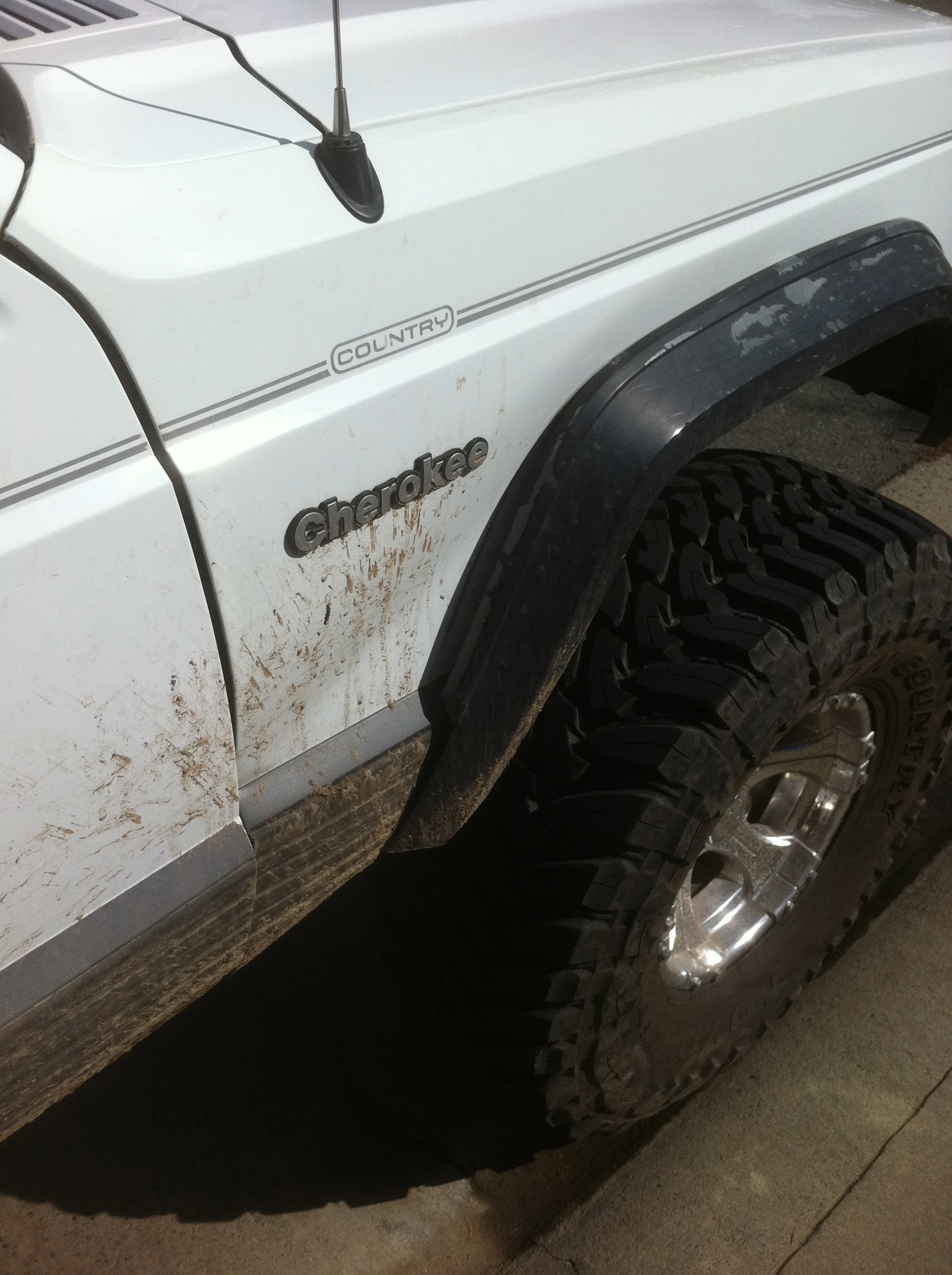

If you can see well enough, in the pic below you can just see there is about a 1" gap between the fender flare and the fender … it's kind of in the shadow. You can see the dent, etc where the tire jammed into the lower part of the front fender buckling it. No major damage. Just need to take out inner fender stuff and "pop" back out. Then … commence with more fender trimming!

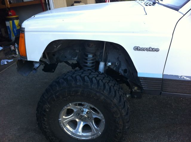

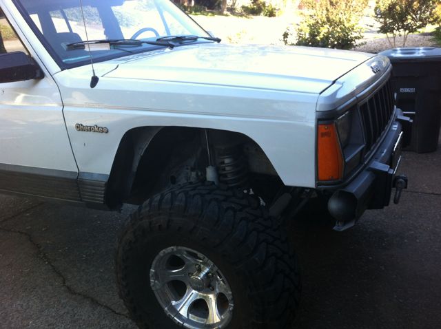

What I did this weekend ... no more problems stuffing my tires from here on out.
Next up is the rear fenders and lower quarterpanels.
Did you trim the metal, or just pull the flares off?
First, I drew 2 horizontal lines, the first even with the headlight bezel and the second 3/4" below. :idea:
Second, I removed the flares, put duct tape on the fender approximately where the top edge of the flare met the fender then put the flares back on. Using the infamous Sharpee pen, a line was drawn around the edge of the flare.
Finally, used a jigsaw and cut around the flare line (removed almost 3" of metal) :sawzall: and the lower of the 2 horizontal lines under the headlight. Folded up the lower 3/4" at a right angle to the fender, filed/sanded the edges and painted it all up. :givemebeer:
I was curious because the paint looked great. You did a heck of a job on it.
Thanks!
Using the masking tape I think helped as did using a 24-tooth metal cutting blade in the skillsaw. Really took my time and didn't push. A little 400 grit sandpaper to clean up the edges and the rest, as they say, is history.
