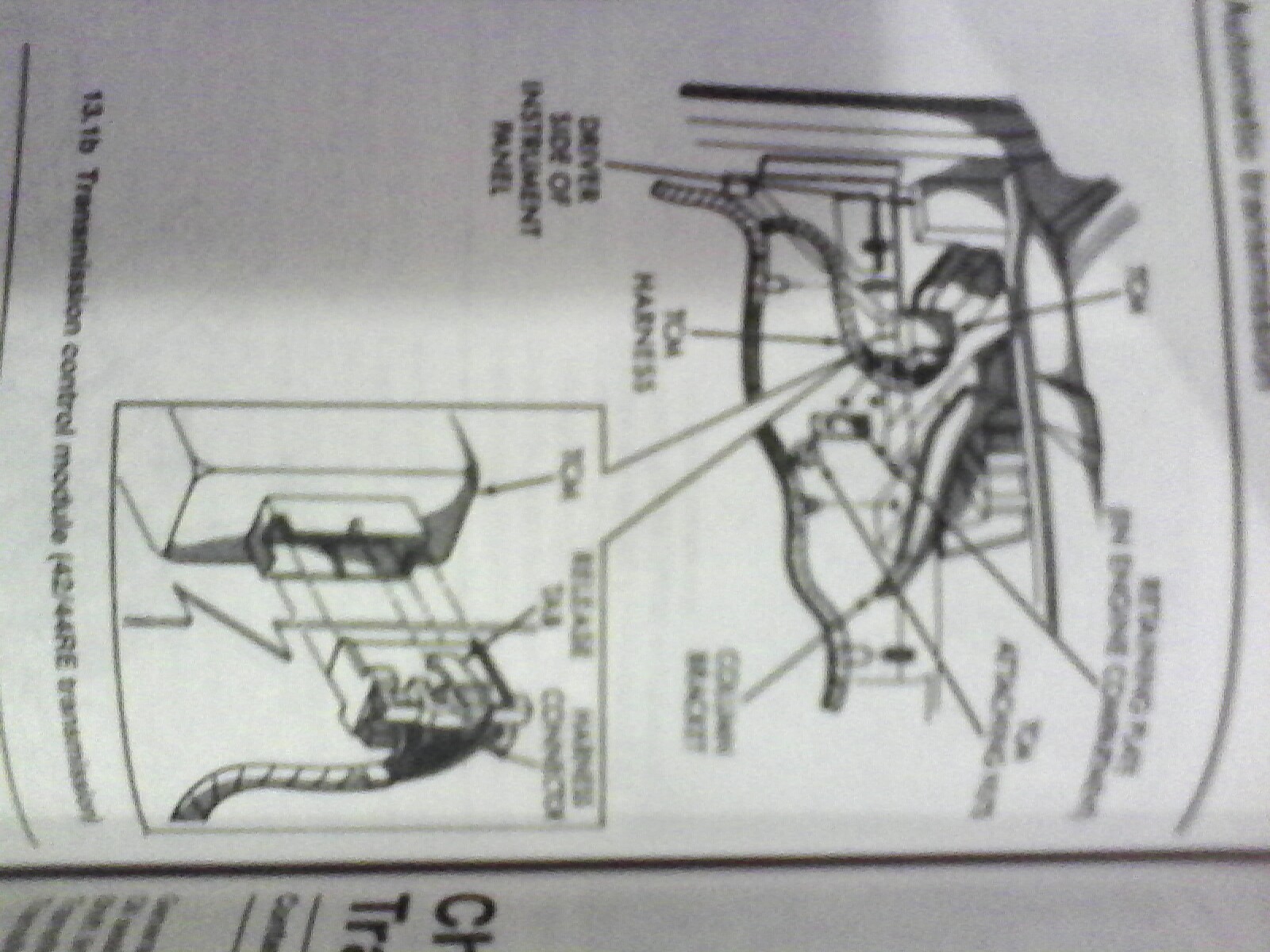

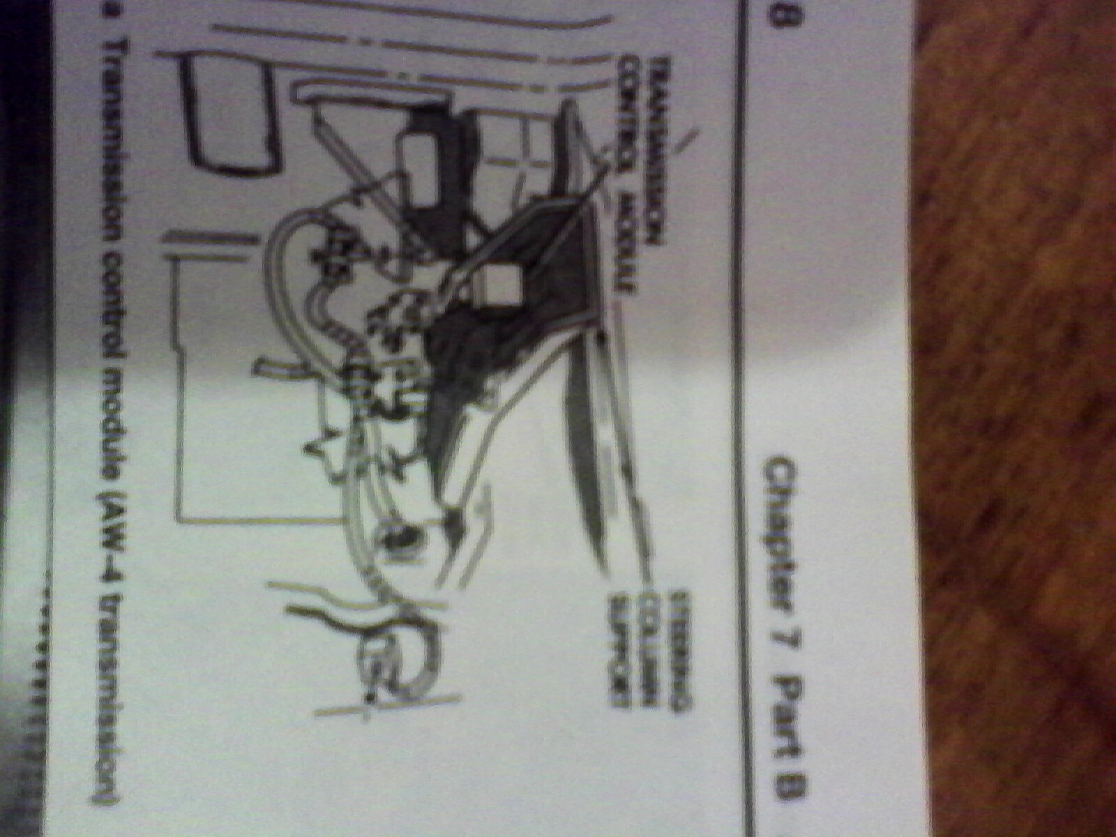

Ok , you have a late production '93 with the 42RE w/lock up torque converter. Contacted my brother whom used to own a '98 GC before it was trashed and he had gone through one trans with it. He mentioned that the TCU for this trans is mounted near the steering column or around the brake pedal bracket . To my knowledge , there is no access to the TCU on any of these transmissions via scan tool . If lime pressure is good ( but must be confirmed with a gauge ) there may be poor communication between the TPS and the TCU . Asked my brother if he checked this on his trans but as I would have guessed , he didn't bother . He may have just swapped a TCU or not when he swapped transmissions. Several years ago , he couldn't be sure. I don't know that I should advise you to swap the TCU unless you can get one cheap at the boneyard.
Hopefully this helps. First pic 42\44Re second pic AW-4 transmission
Sorry about bad pics, crappy tablet :redface:
Located underneath drivers side of dashboard, to the left of the steering column
