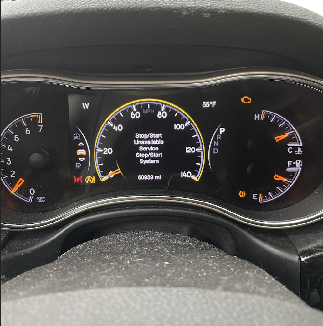

So my wife's jeep just randomly went into limp mode and wont go over 40mph. Yesterday it was running just fine, no issues at all. When I ran the code it looks like the throttle sensor is getting inconsistent power or bad signals. Per a mechanic's advice I replaced the whole accelerator assembly/sensor and cleared the codes but I am still getting the same lights and its still in limp mode. The next suggestion was replacing the throttle body but I'm hesitant to keep changing parts out.
Does anyone here have experience with this? We're pretty broke so I'm willing to keep working on it as long as I'm not risking permanently f***ing it up. My main experience with vehicle repair just operator-level shit in the army (on tracked vics) so I'm competent but not a pro.
Any advice is appreciated. Please let me know if more info is needed.
