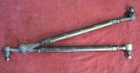

I would highly suggest buying a steering kit from Ruff Stuff, they are having a 15% discount right now on them.
"Y" Link Steering using GM 1 Ton TRE - RuffStuff Specialties
Should look like this

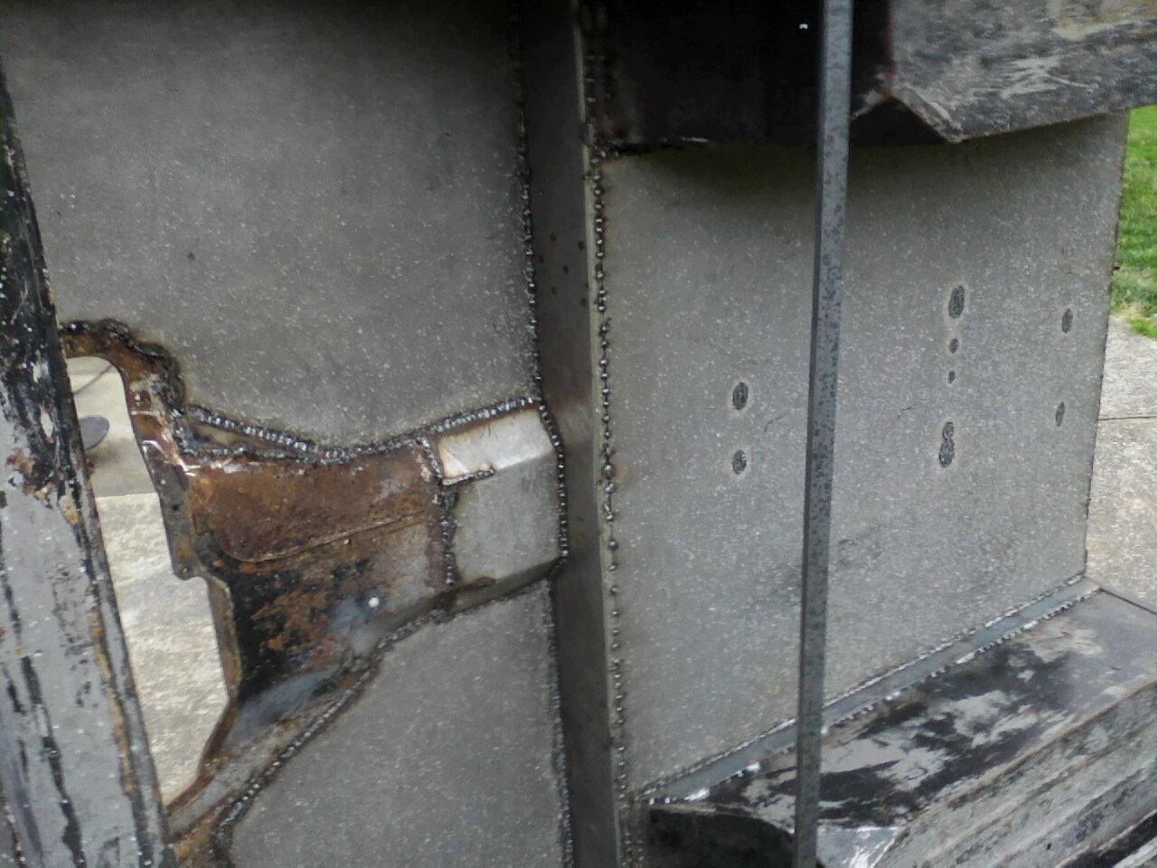

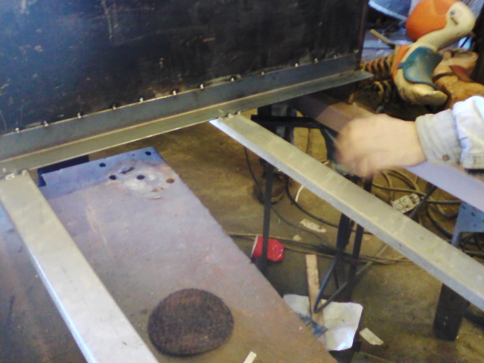

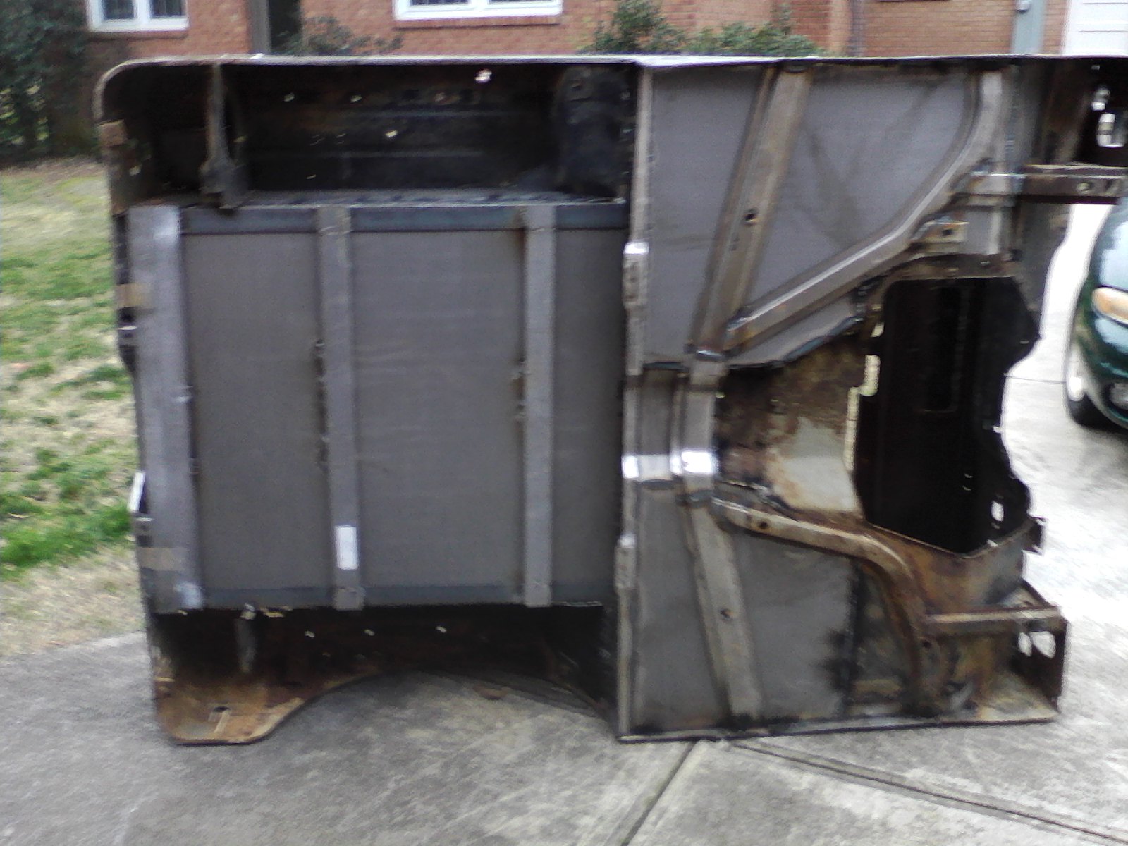

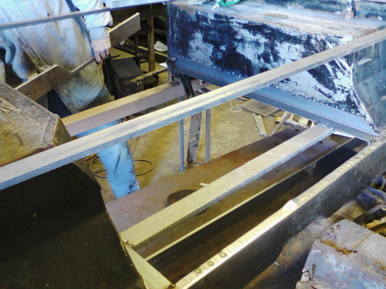

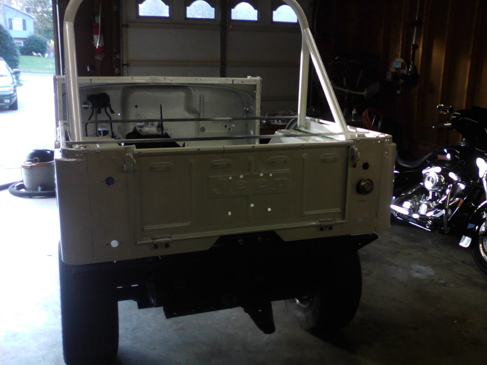

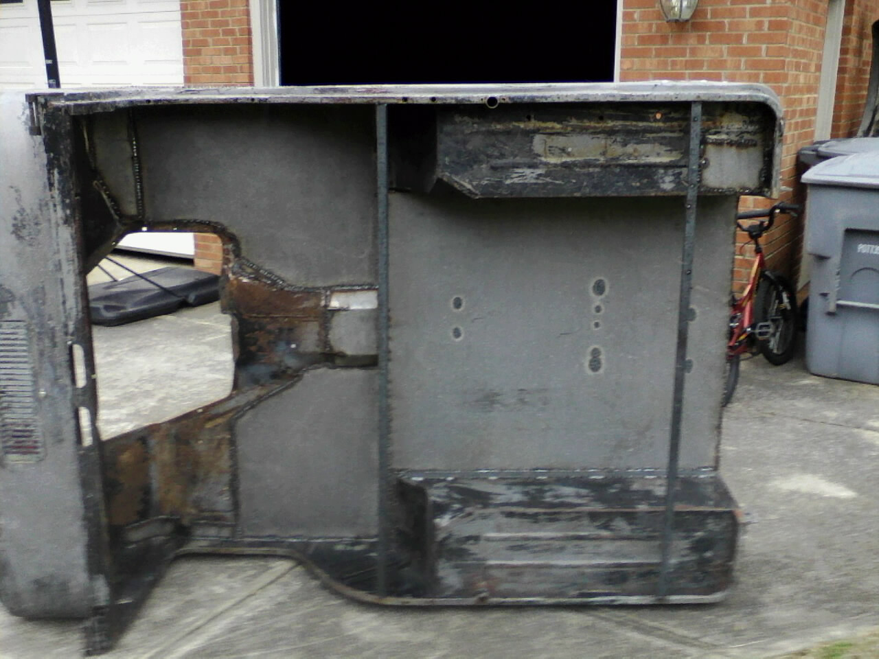

73 jeep rebuild 11

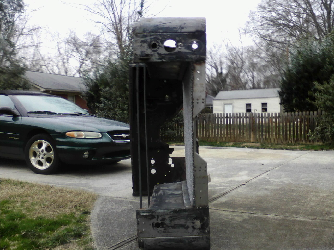

bed pan install

Re: 73 jeep rebuild 11
Its lookin good. I did the same thing to mine, yours looks identical except you front floor pan braces. I ran braces under my front floor but they don't look as nice as yours. It all pays off when its done. rock solid

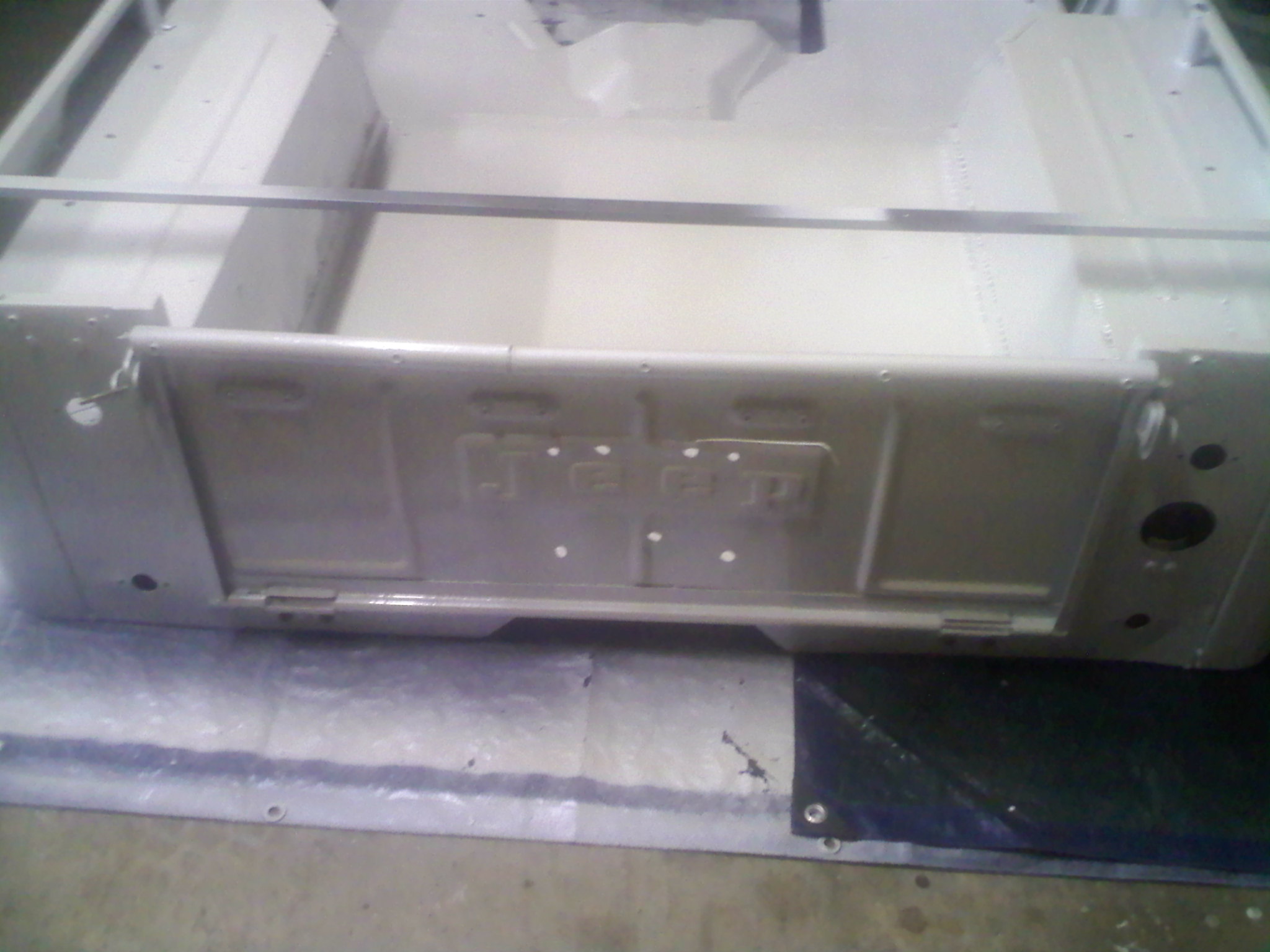

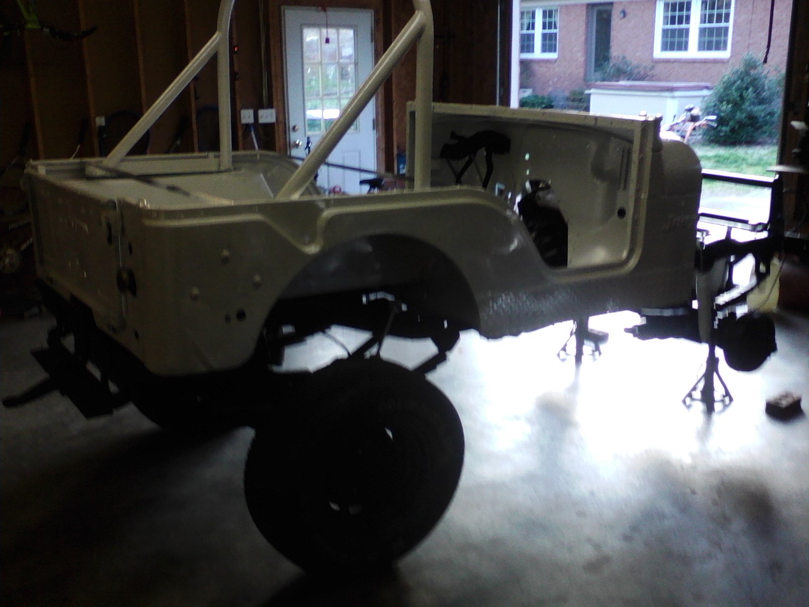

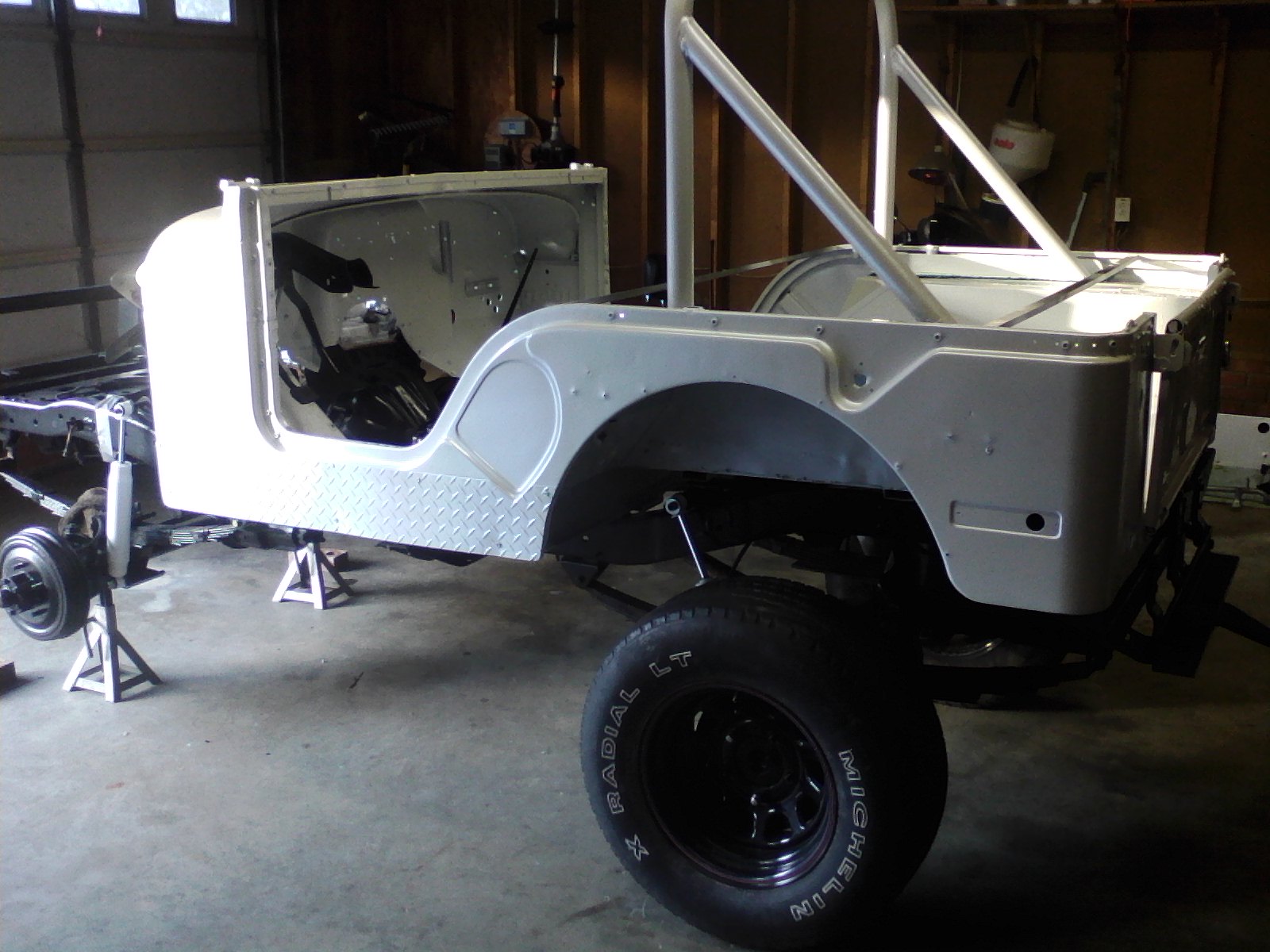

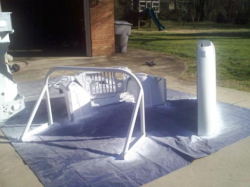

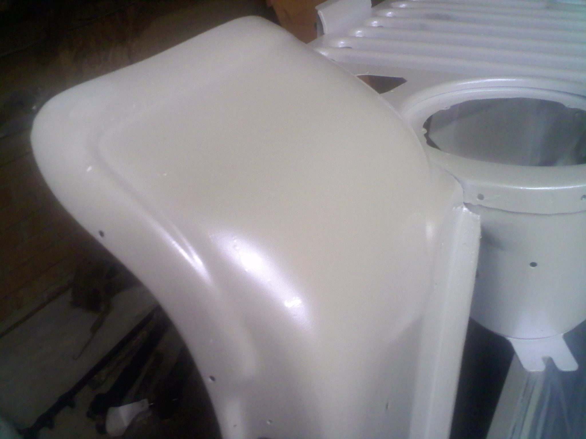

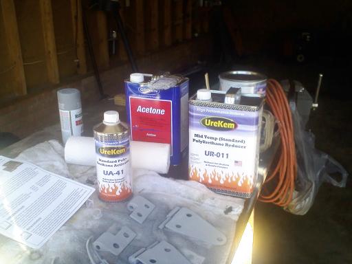

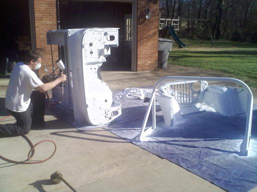

73 jeep rebuild 12
paint
lexus glacier frost mica

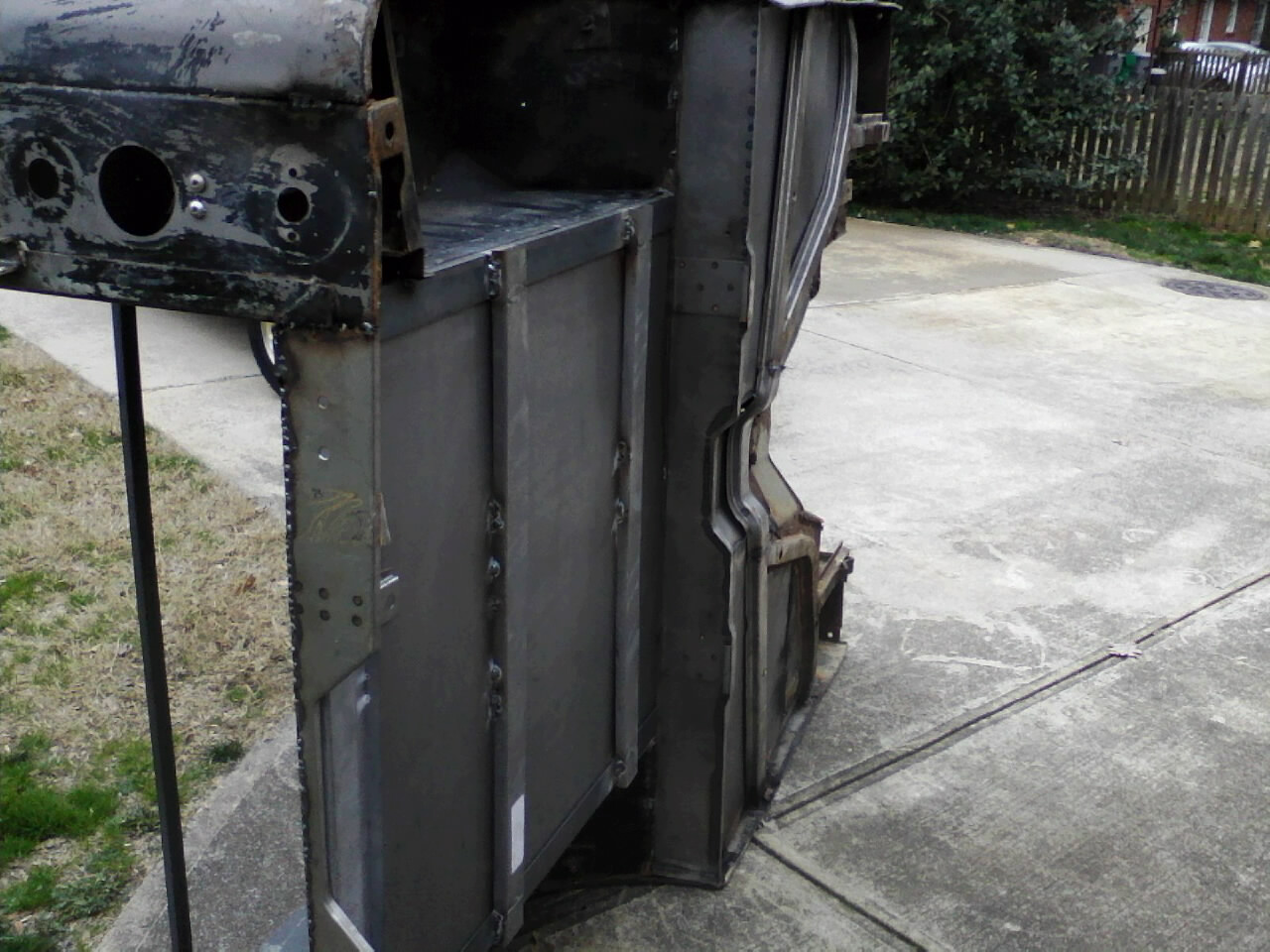

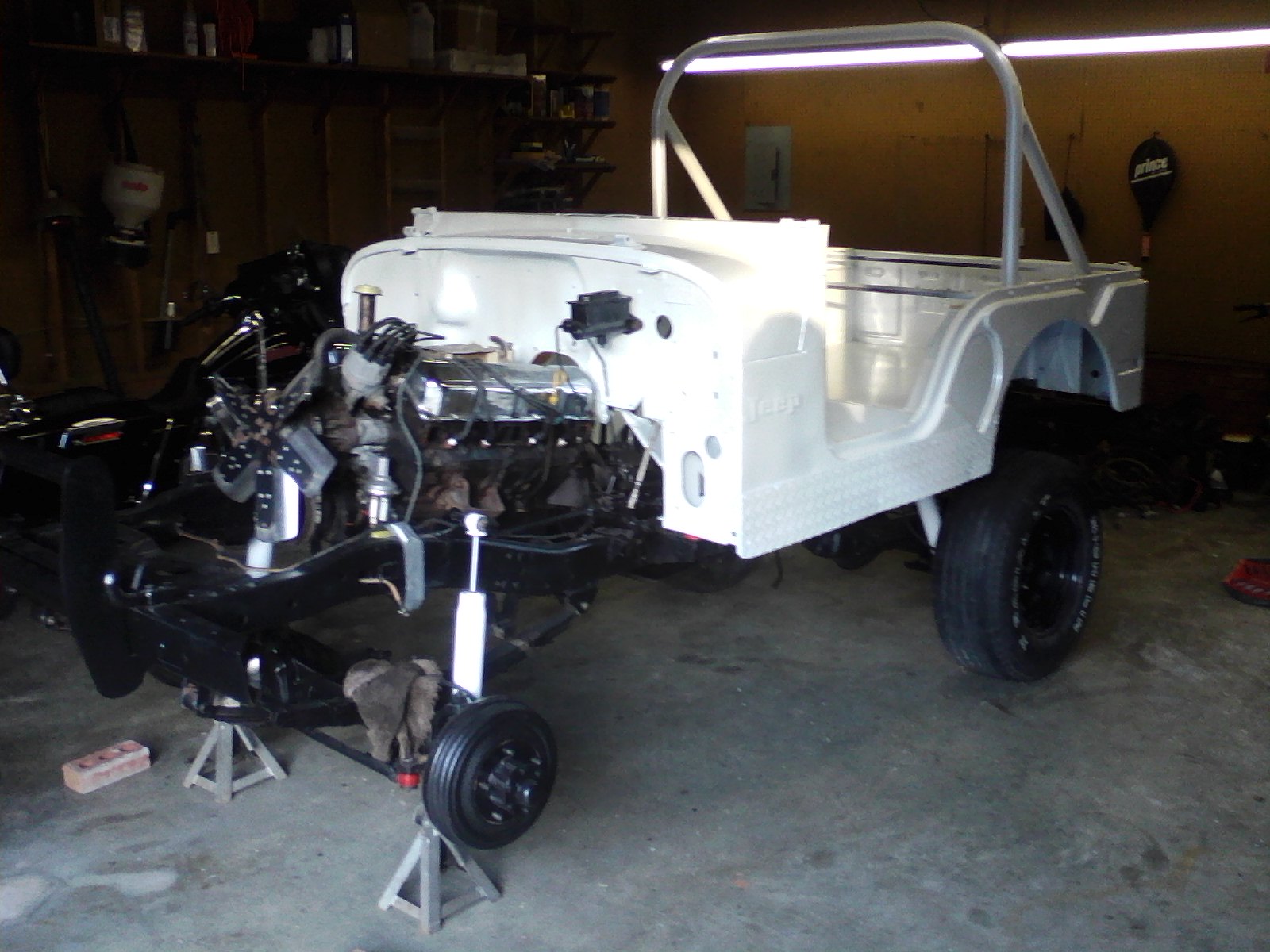

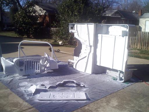

73 jeep rebuild 12 part 2
continued
