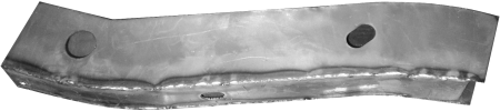

MORE makes a CJ frame strengthening kit - FP200 1976-86 CJ5, CJ7,CJ8 Rear Frame Plates. You could cut out the rusted section and replace it with something you fab up from angle iron, then weld the more kit overtop that.

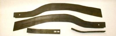

Autorust .com also makes a kit - Auto Rust Technicians - Safe-T-Cap Frame Repair Kits*::*Jeep Kits
Pp 303 of the current Quadratec Summer 2010 catalog may have what you need. All pre-formed, stamped and ready to weld in place once you cut the cancer out. Made for CJ's and YJ frames with cancer in various common areas.

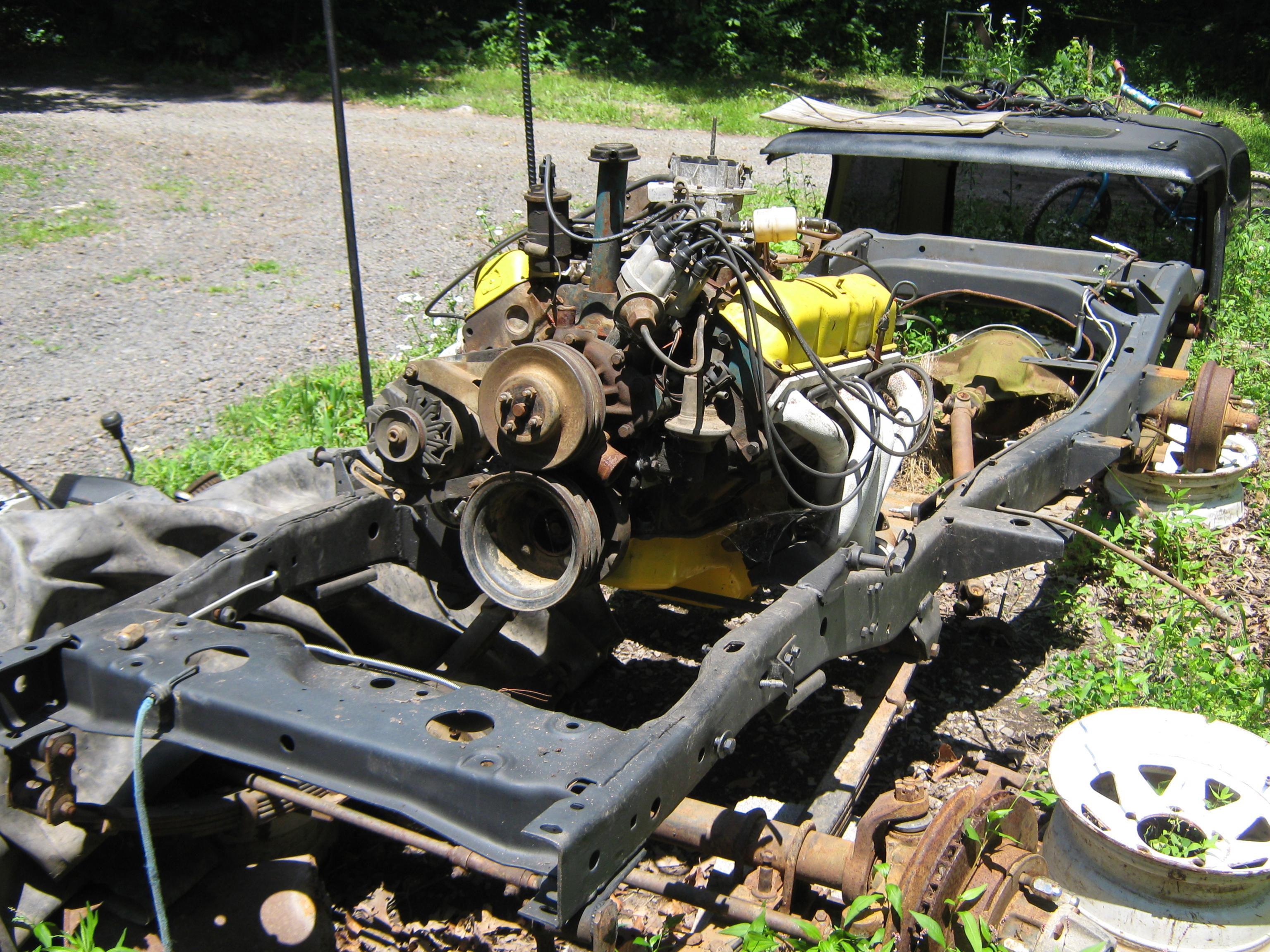

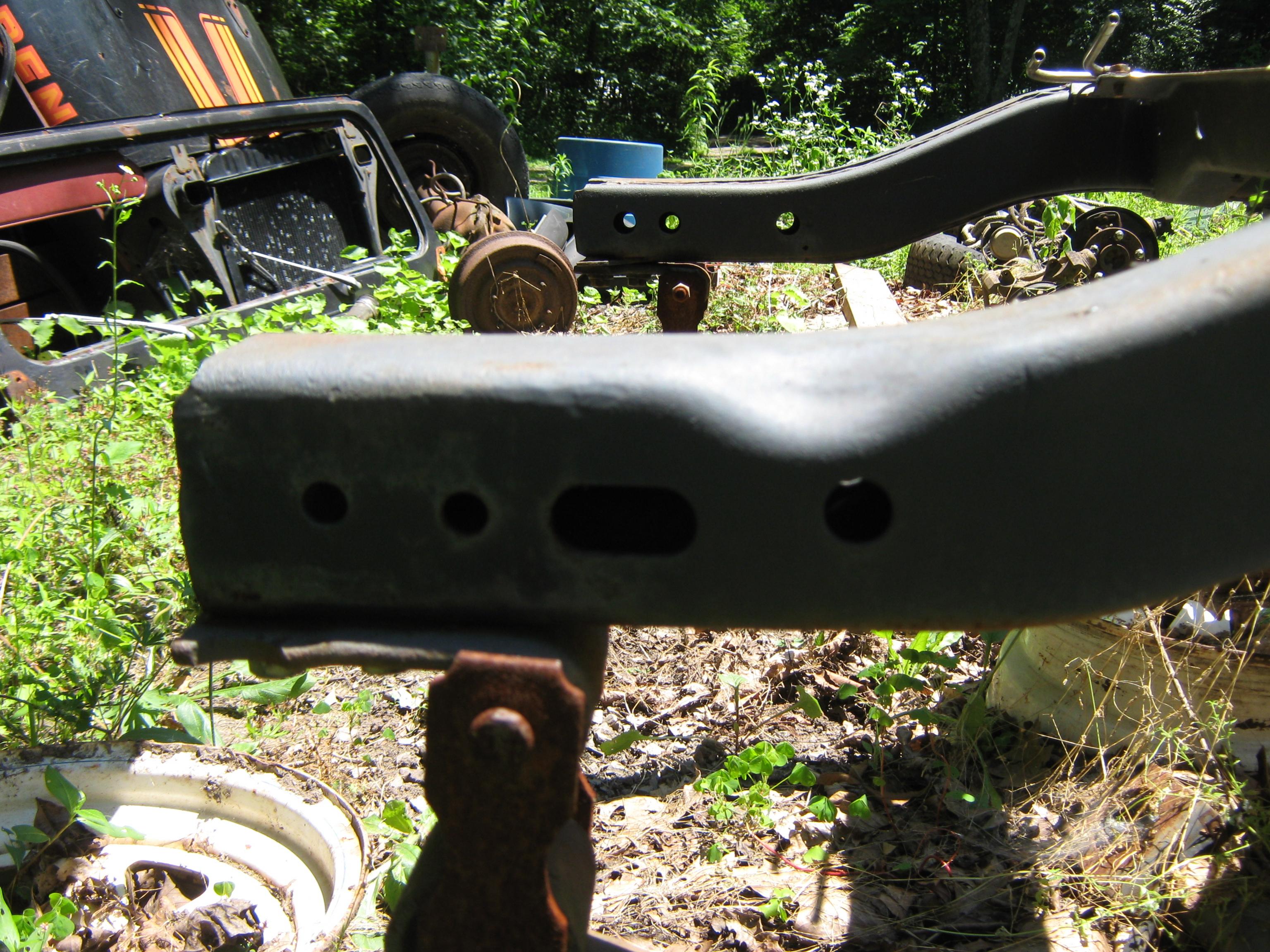

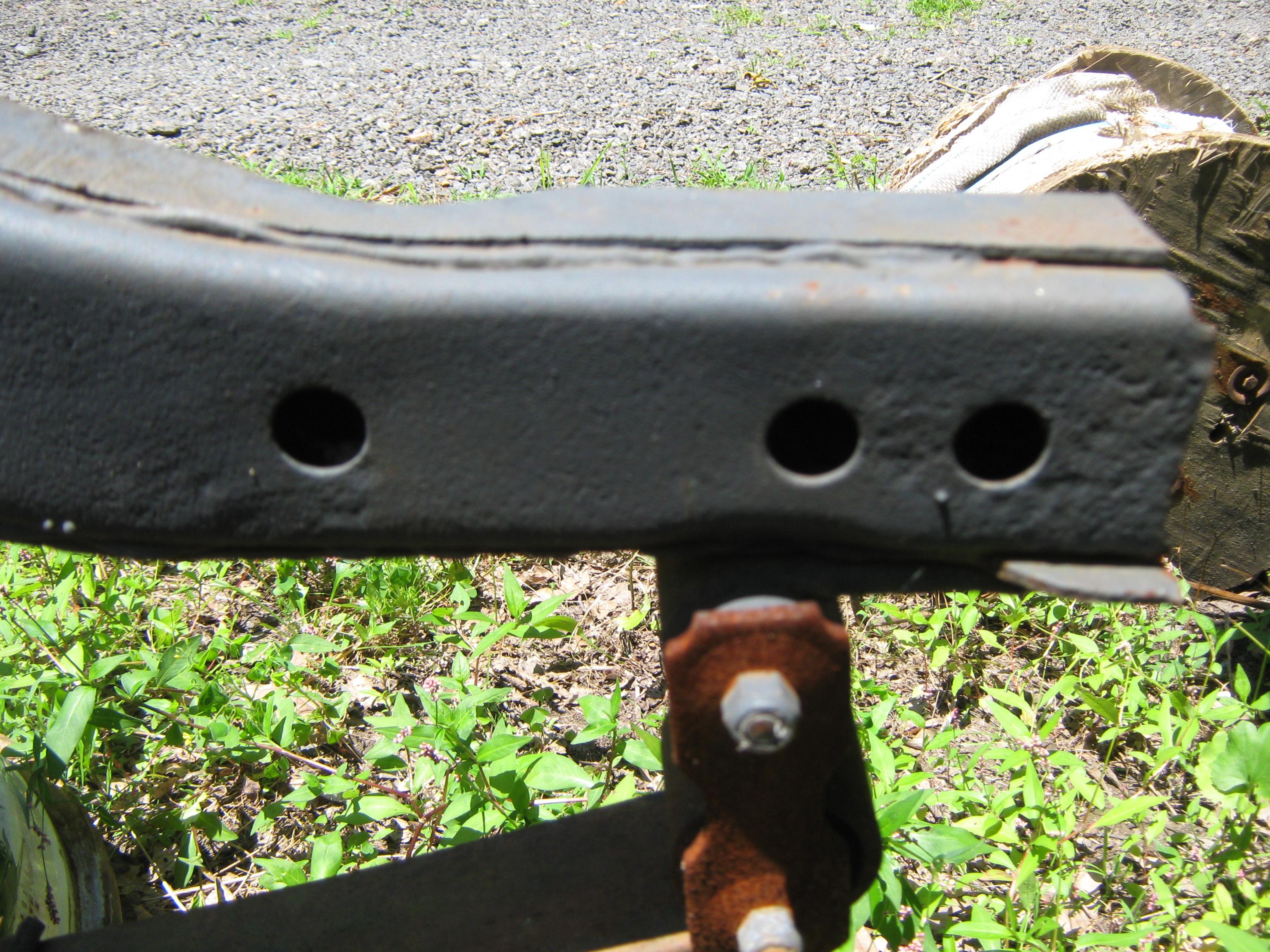

Where do you live? I have a rolling frame from a '79 cj 7 that I sandblasted and painted in excellent shape. It needs the rear crossmember welded in and has stainless brake lines already installed. There is a 304(semi-rebuilt) sitting in it right now. I'd like to have $600 for the whole thing. I'm in Pennsylvania, just north of Harrisburg.
It depends on how bad your body mounts are on the tub. I just finished putting a tub from a '92 on an '83 frame, and it took me about three days because I had to weld in new captured nuts on the bottom of the tub. If all (or most) of your body bolts come out easily, it shouldn't take too long. You're biggest problem is going to be the engine and drivetrain. If it was me, I'd swap the whole frame instead of patching the old one. I've done both, and patching the frame is usually only a temporary solution. If you're still interested in the frame, e-mail me at tlburd@hotmail.com. I can deliver the frame for a fee. Thanks, and good luck. Troy
