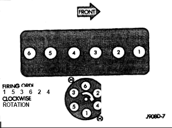

IMO it's doubtful to be either the timing chain or the cam. I've seen 4.0 run reasonably well with a timing chain so loose it contacted the inside of the timing chain cover (a couple even wore all the way through the cover and still ran OK). A flat spot on the cam is more likely to be on one or two lobes than all, a 4.0 will run without a cylinder, though poorly.
      1. Remove No. 1 spark plug.
      2. Place finger over No. 1 spark plug hole and rotate the engine crankshaft slowly until compression is felt. I usually use a compression gage instead of my finger.
      3. Align the timing index mark on the vibration damper with 0°(TDC) on the graduated timing degree scale on the timing gear cover.With the last turn being to the right as you are facing the motor (to try and take up any slack in the timing chain).
      4. Check the distributor rotor is pointed near No. 1, it won't be exactly on.
      5. Install the distributor cap and spark plug wires.
Most times the distributor cap has a "1" molded into it, to help you find "1". The distributor has a locking tab at the base, if it has never been removed, it should be in time, the ECU corrects for timing over a really large range (in my experience you can be one cylinder off and the ECU will still correct to the proper cylinder and the motor will run, though maybe not well at higher RPM's).
All the motor usually needs to run is, air, spark and fuel. Though improper proportions of air and fuel may make it run very poorly.
Once you recheck your initial setup, we can start troubleshooting.
I re-read your last post. A couple of things to keep in mind, the leading edge (pretty wide edge) of the rotor is where the spark jumps onto the pole in the distributor cap. So the rotor is unlikely to be centered on the "1" distributor cap pole at TDC. I wouldn't pull the distributor on a hunch, it can get interesting to get back in correctly. The pin for the distributor gear has been known to shear and the rotor shaft to spin in the gear and to be out of time, but don't jump to conclusions, take it step by step or your likely to have to start all over again. You can check this by grabbing the rotor and trying to turn it with moderate force (with the motor stopped), too hard and you may break the rotor (use an old one).
