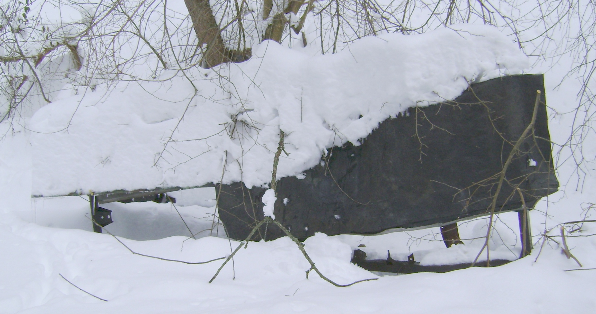

95 YJ w/122K rusted out from under me...so like a fool...
I thought the 56 Flx bus was my last project due to age and injuries...but nooooooo.
I tore it down last summer and have been cleaning/blasting/painting/swearing and limping over the winter.

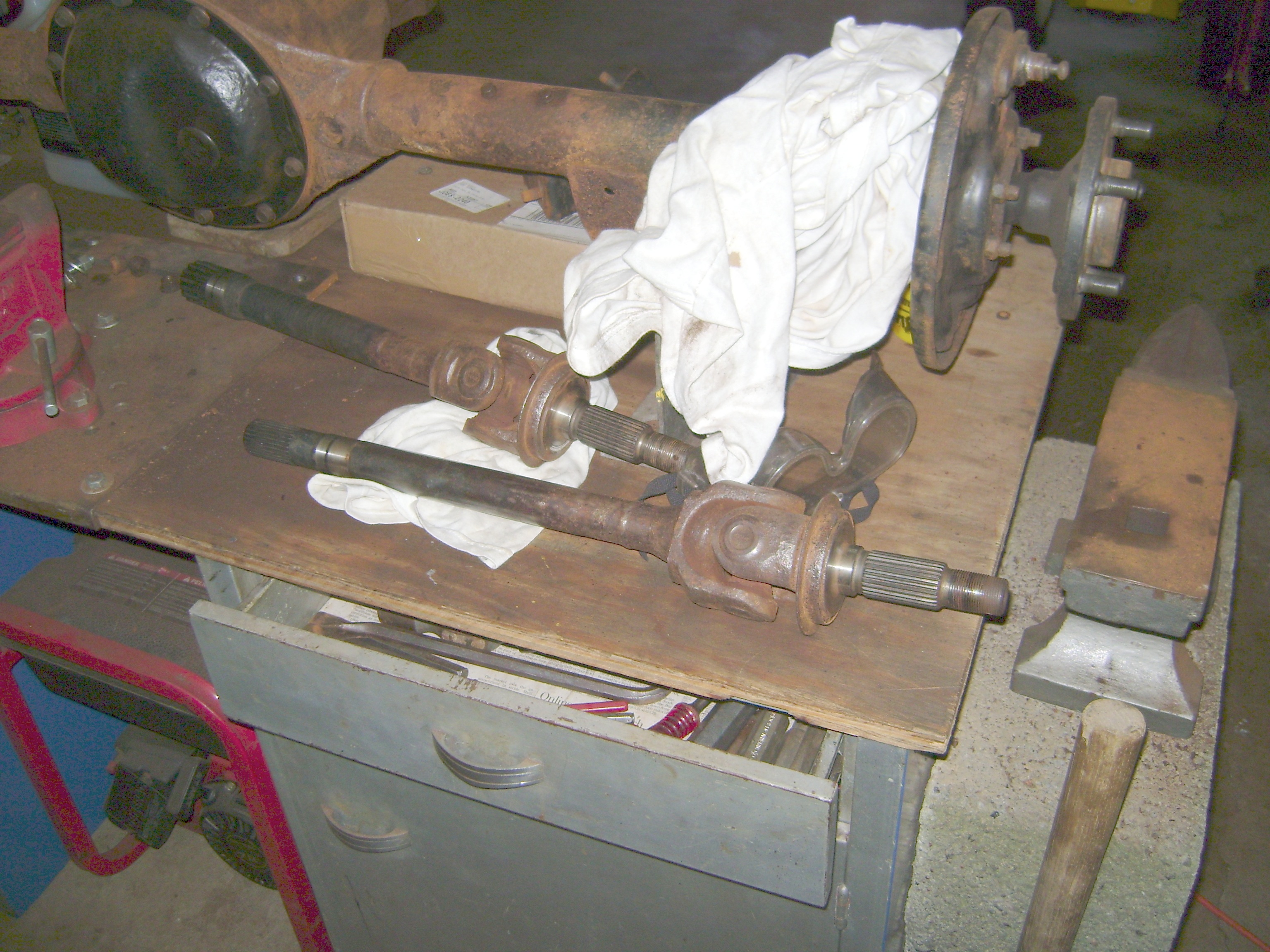

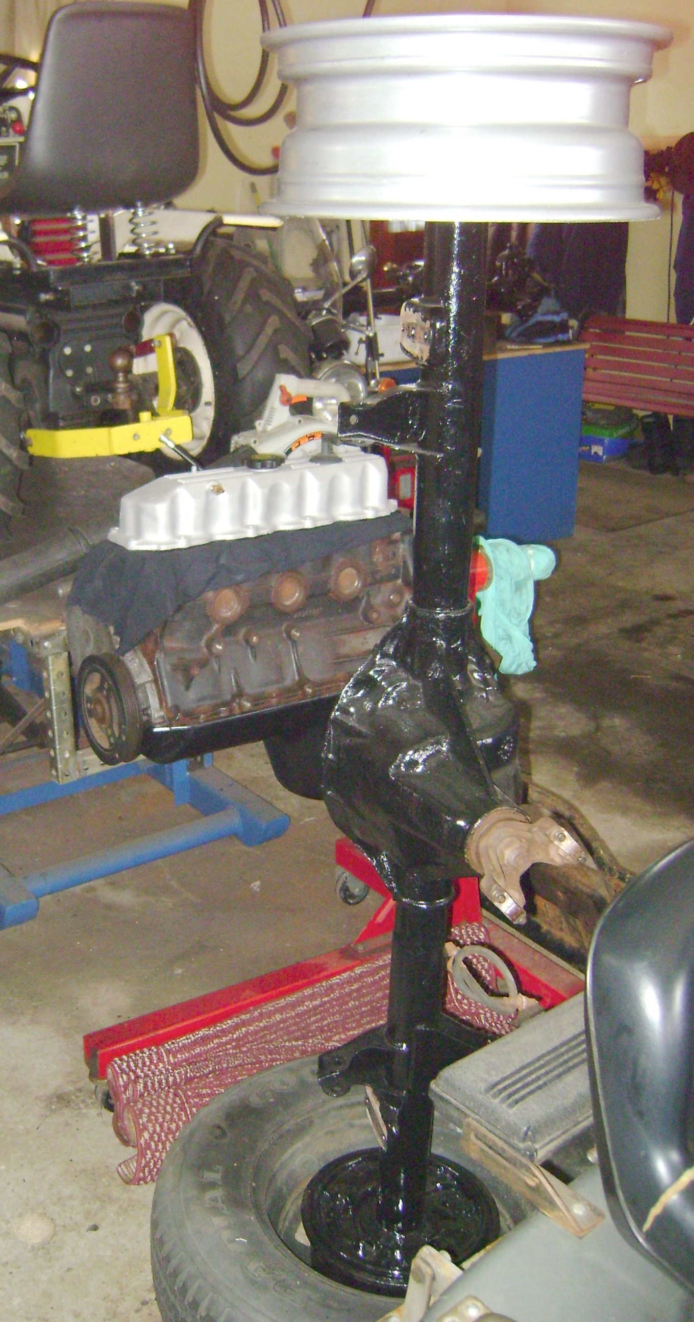

a rub a dub dub...
wheels are blasted and primed
axles painted with a POR-15-ish rust paint under a different name

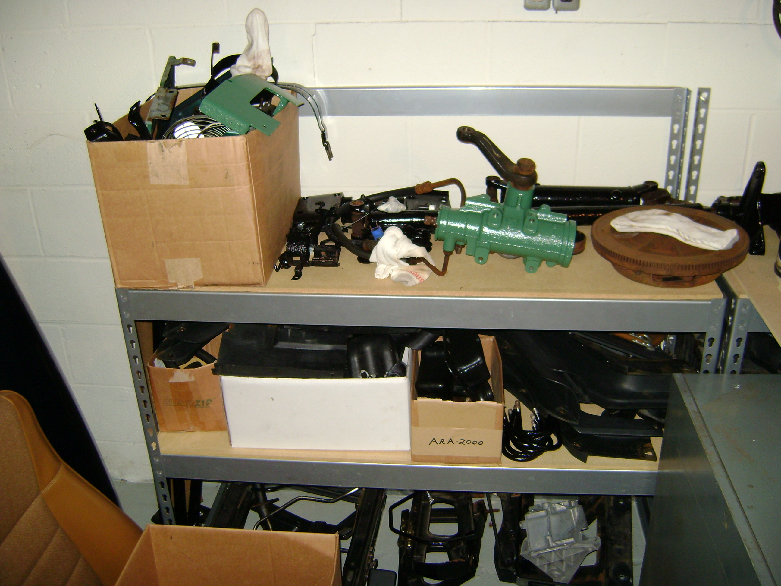

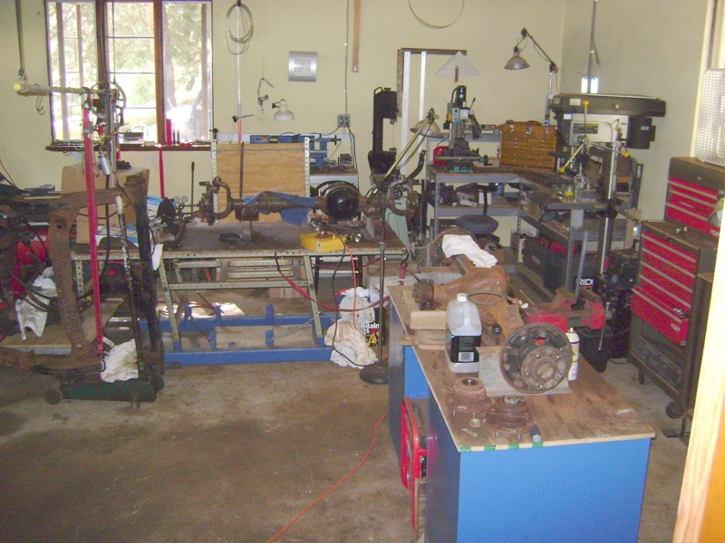

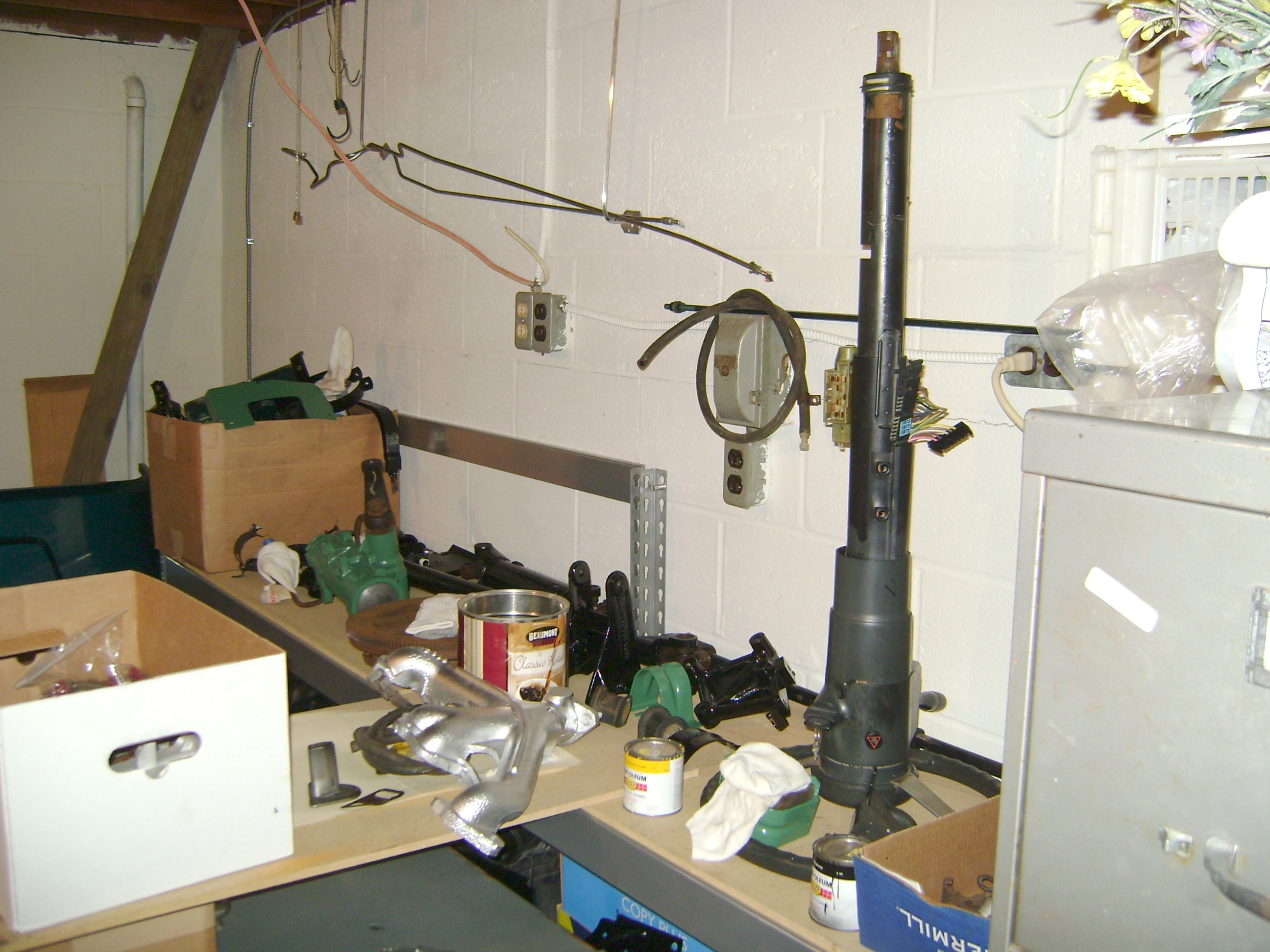

laundry room is the parts warehouse

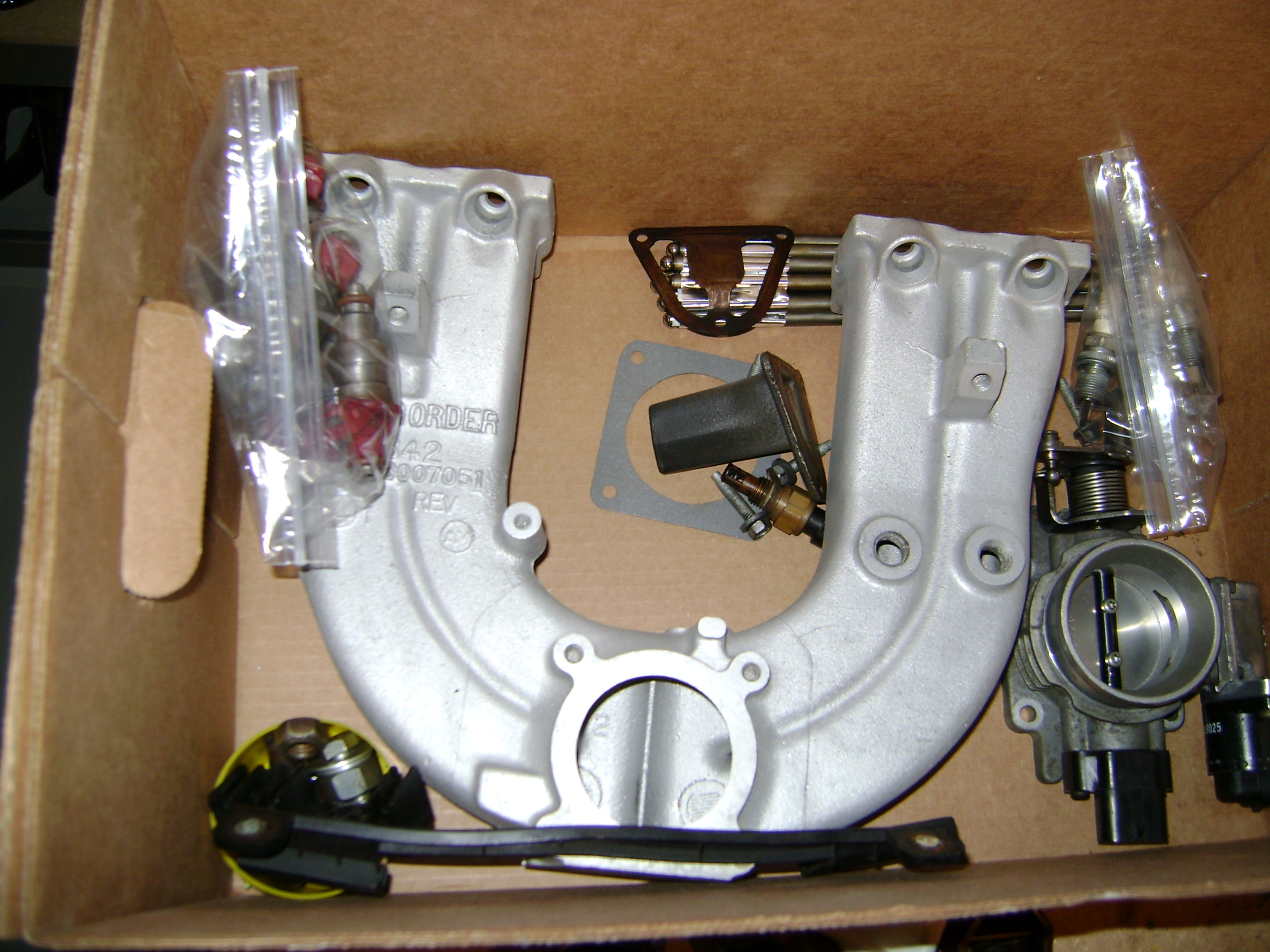

manifolds blasted up nice

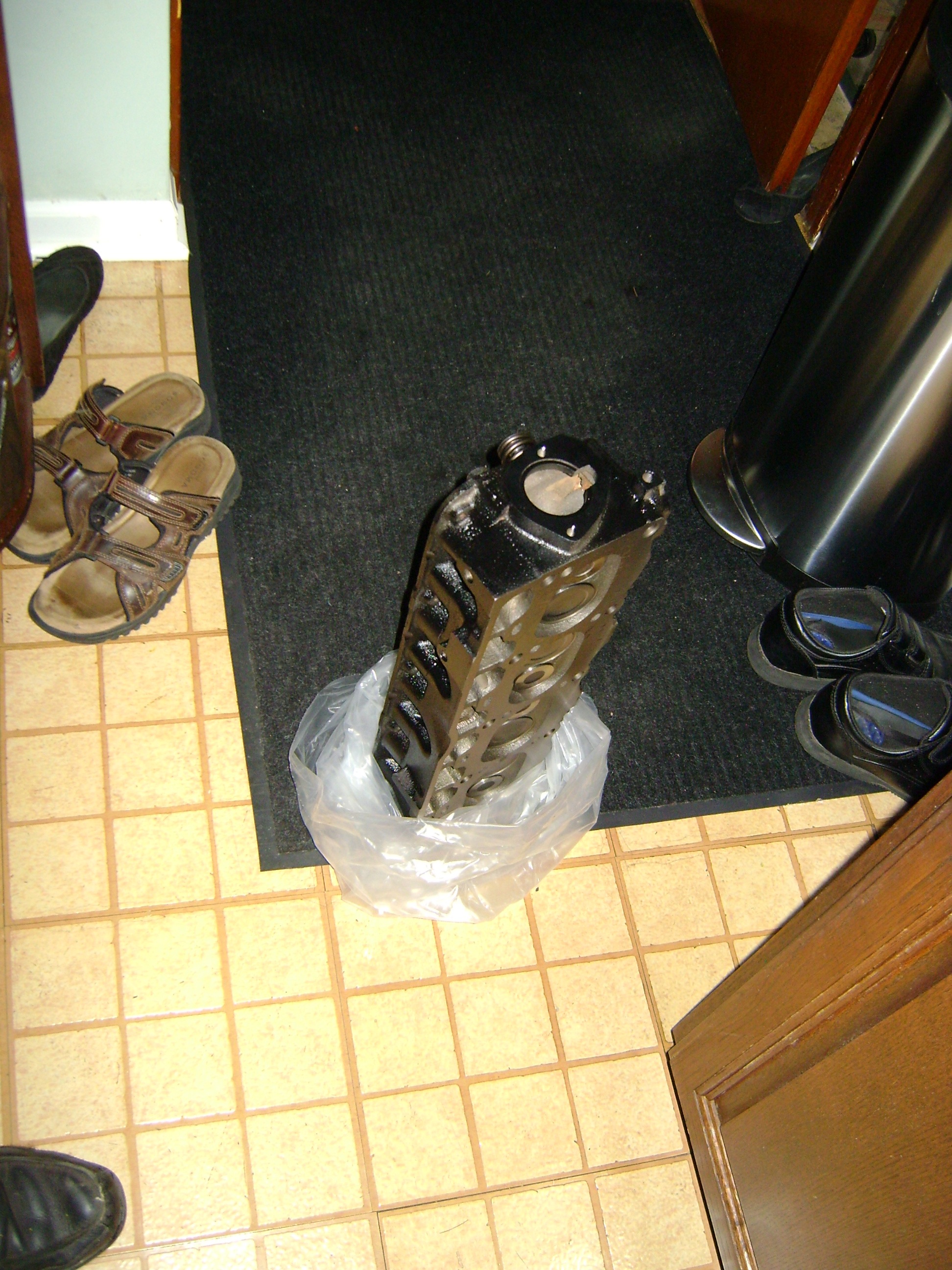

head's back from a valve job living in the kitchen
engine is yet to be torn down

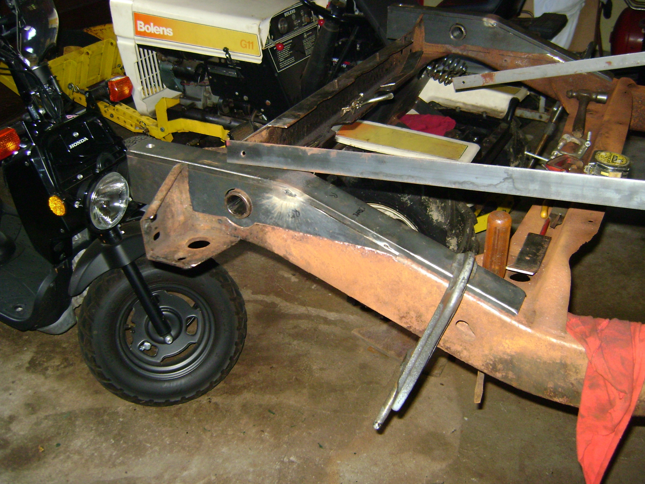

frame rear shackle mounts (R the worst) are shot and steering box mount captive nuts were spinning free, I had to cut and grind it apart... so come Spring I need to section some frame and do some creative welding...or go the new Montana $2500 frame route..we'll see.
I need a rotisserre for the body yet... there's some bad body mounts on the R side.

another picture in progress...rear shackle mounts
salvaged the sleeves with a hole saw.
boxes are 3/8" X 2 bottom I had laying around & side plates are 3/16" X 3" flat from tractor supply. I'm extending some meat beyond the original rear crossmember for draw bar, spare tire mount, ect... plus I want a bit more gas tank protection from the enemy rear sneak attack.
44 1/2" centers locating jigs.
I gave myself 1/2" or so of lift just for sport.
what I do notice now that I'm in to it ankle deep is while the front 4 spring mounts are good centers and X-ed good hypotenous-i (?), the 4-5 frame out of kilter mandrel bends to the rear throw any conception of straight and square out the window. these YJ frames (mine at least) seem pretty hastily put together... I may have to relocate a rear/mid mount to put it right... I need a laser frame table.
the good, the bad and the ugly. I hate these freakin' Jeeps.

Nice.. Please tell me your at least going to replace the 35 rear??? at least put a non-c-clip 35 in... the C-clip 35 in the 90 and on jeeps are just garbage.
this restore is likely a graduation gift for the daughter in the long run. I'm not crazy about the overall quality...setting up the shackle mounts, I found the frame bends are hap hazard throwing all sense of precision square out the window.
earlier in this thread you see the bus... this YJ is a far cry from a serious machine. It gave me 122K trouble-free miles as is...I'll make it go, but I'm not investing much to pretend it's anything more than it is.
I believe if I were to think serious 4WD, it would have to start with a different platform.

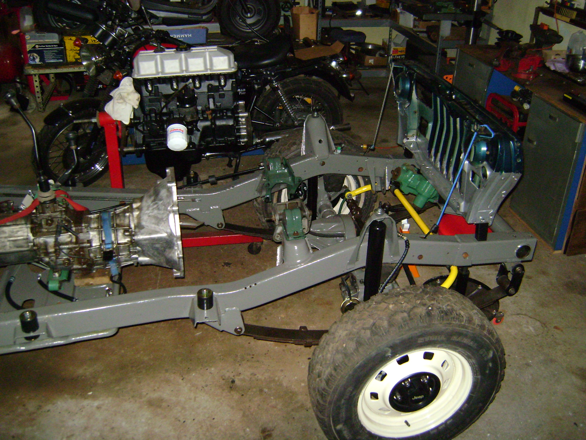

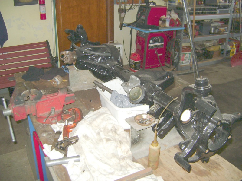

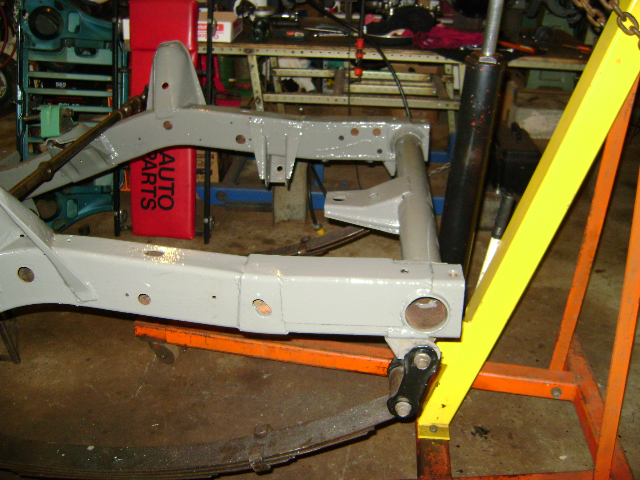

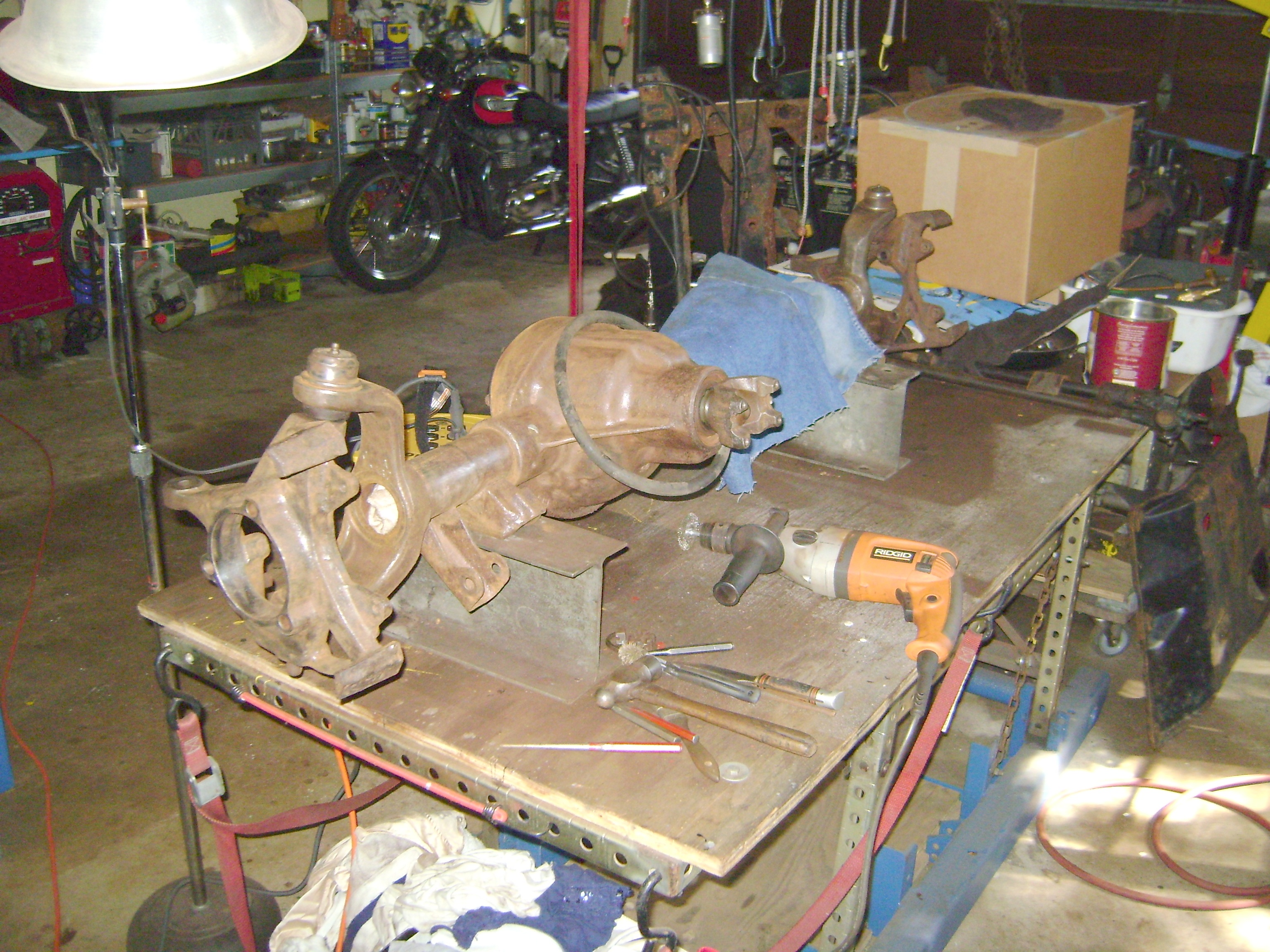

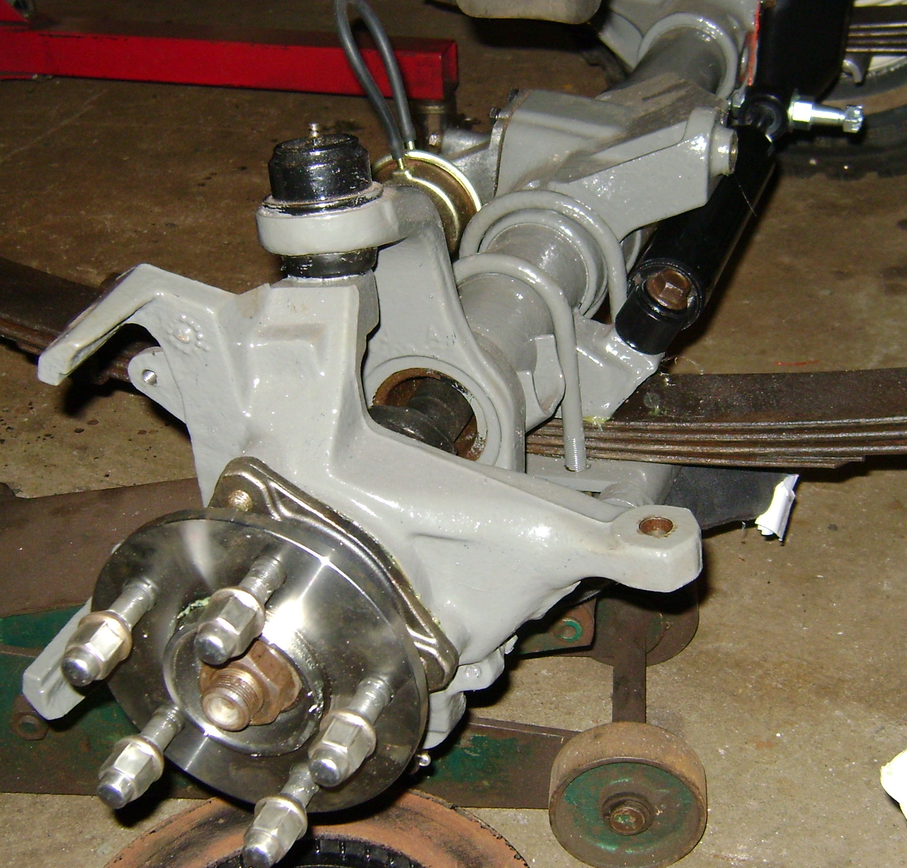

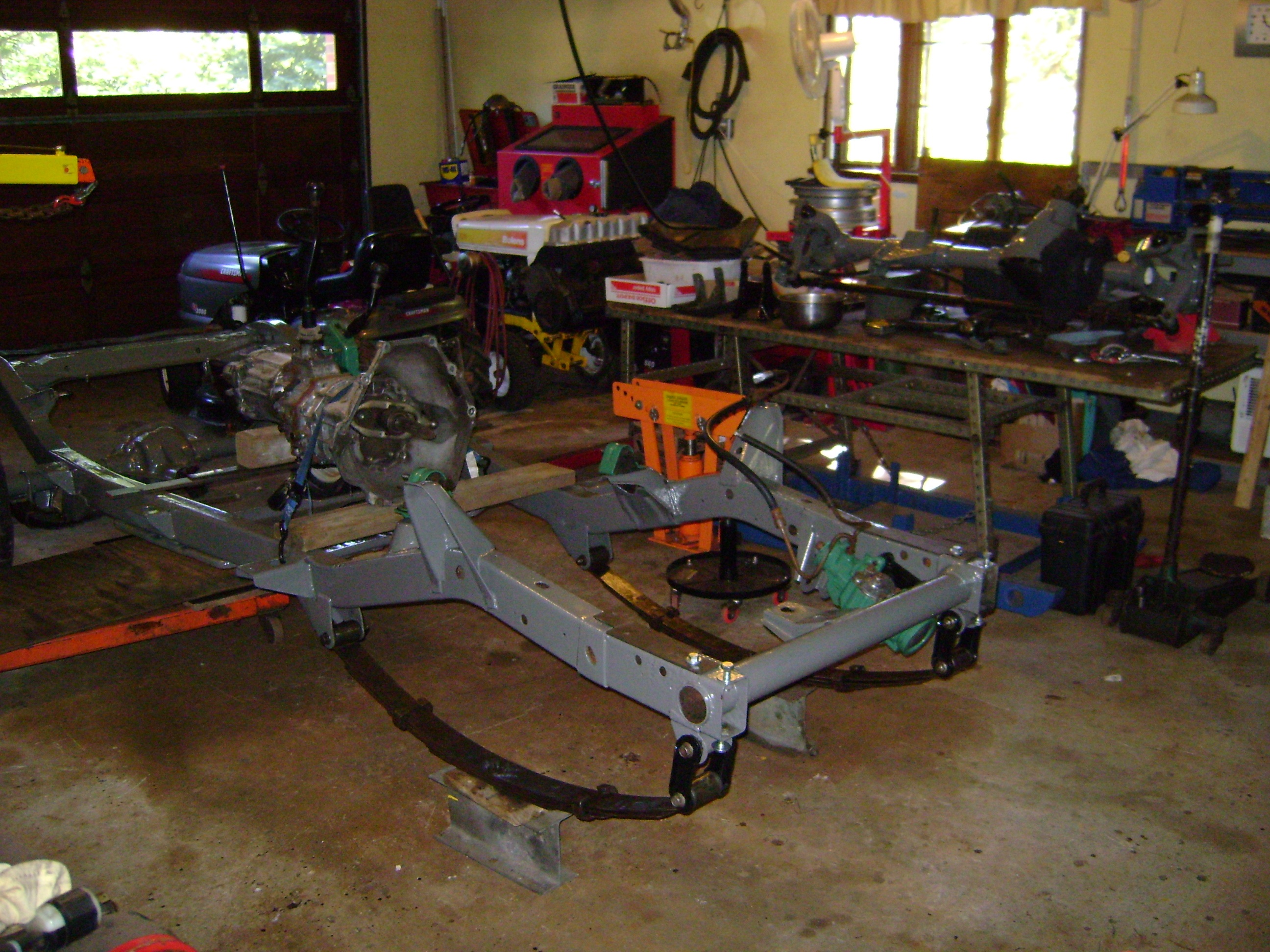

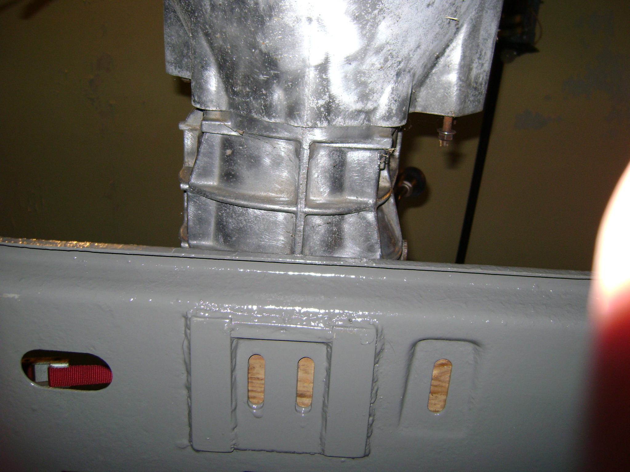

wallowed in the rust ugly for too long but spanked it proper. I have the frame sealed, axles were primed in a POR 15 clone already so I got some Massey Ferguson grey machinery enamel on the big parts. I had to weld up a new transmission mount on the belly pan, and I'm changing front axle seals now while it's still up on the bench at eyeball level, and soon to get the front axle mounted.
I still have some front frame plates to fab and weld in, but I have the rascal upright and pinned to the ground with enough weight so it doesn't flip belly up again...everytime it does that, it's more trouble for me.

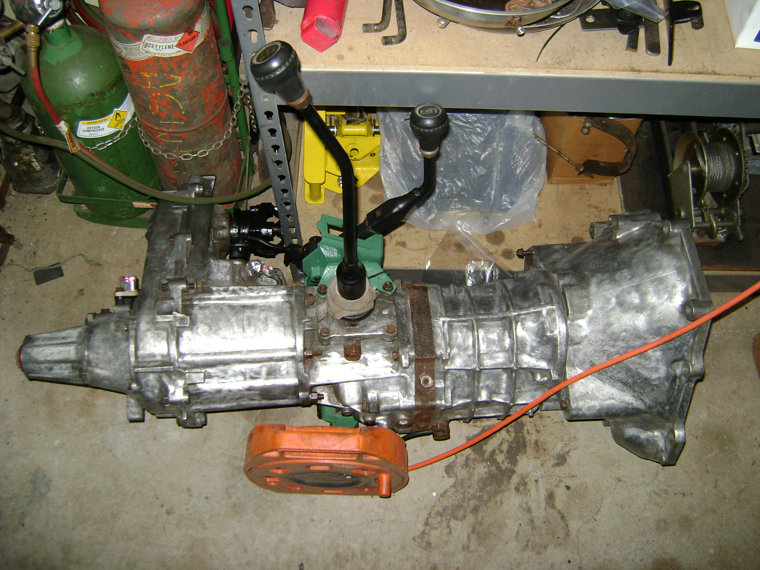

belly skid trans mount was just about gone, so I redid the 2nd skin with some 3/16"...and the saddles are on.
I changed the R side, but while it's down this far, I have to make a case spreader and change front L axle seal... then at last parts can start to meet back up.

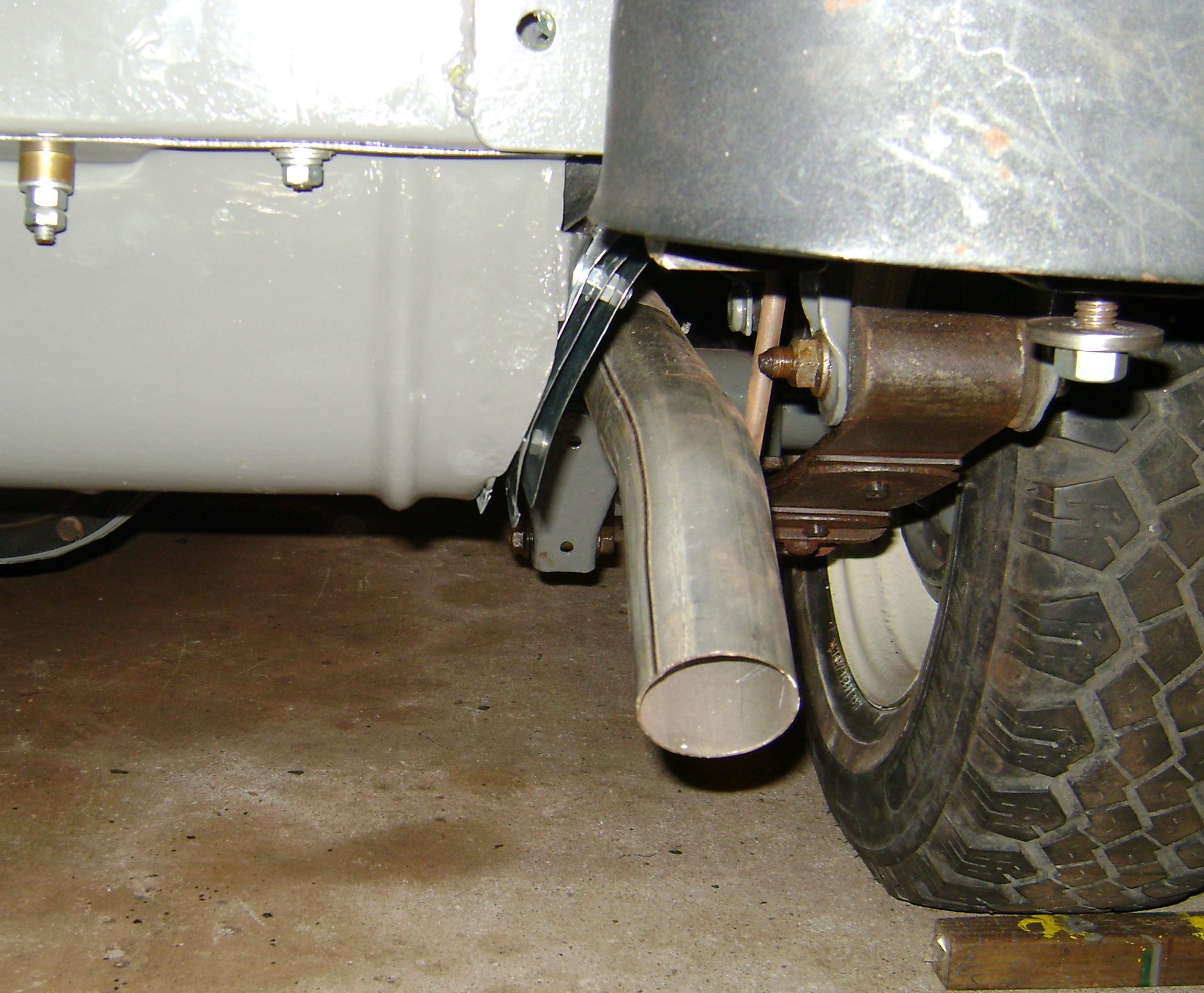

so...since it was rusted ugly and didn't come out gracefully, I trimmed the bad parts and had to make the heat shield... ended up a triple layer.

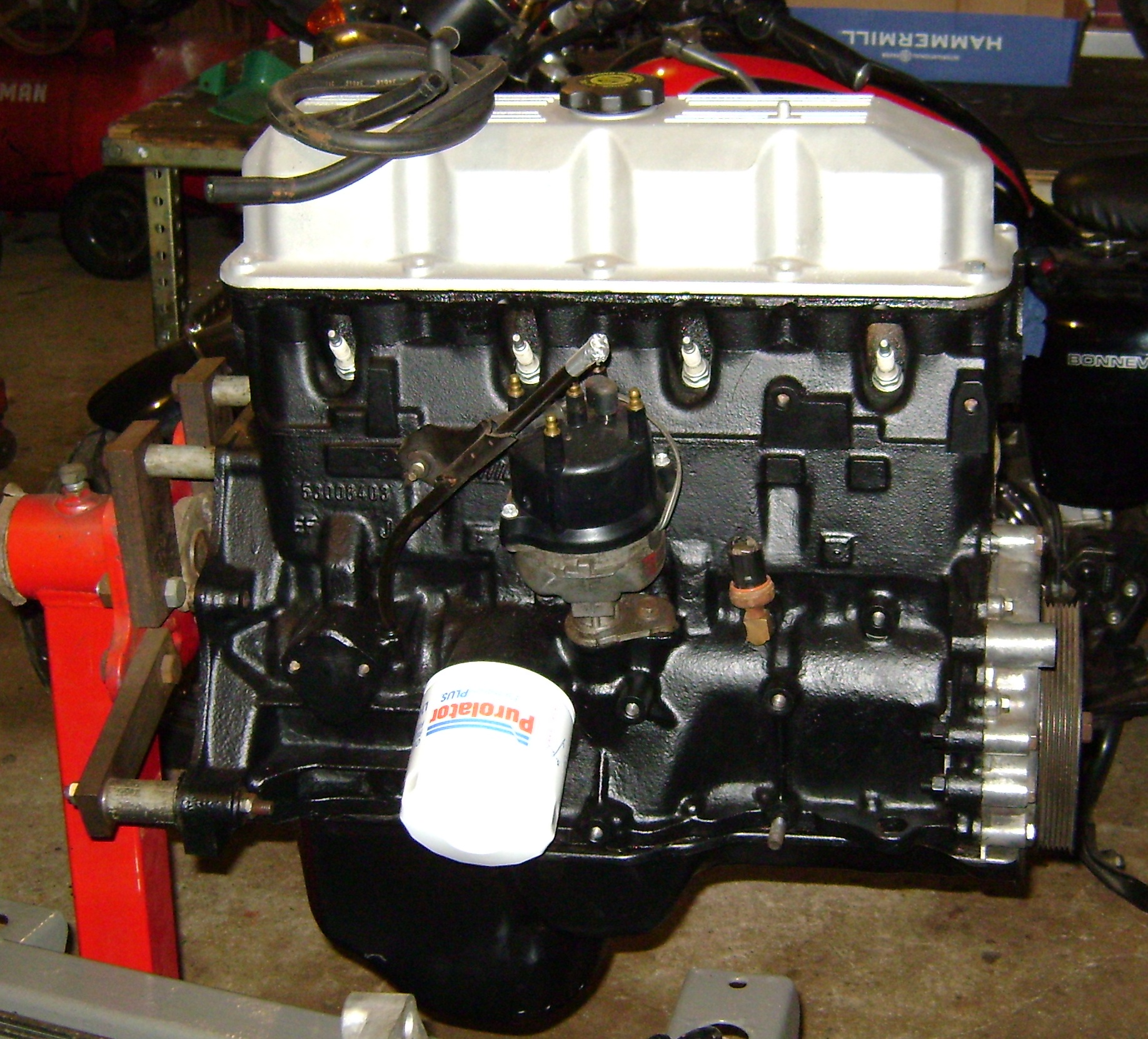

I also got the block cleaned prissy and sealed in paint, and after putting the front axle seals in, I can now start slapping things back together chassis-wise, ...misc parts from nooks and crannies all over the domain.
nice to have the tools. i should have this wrapped up by summer...or at least next winter.
about to run out to pick up brake parts/plumbing and next mountain is the the under body and mate it back on.

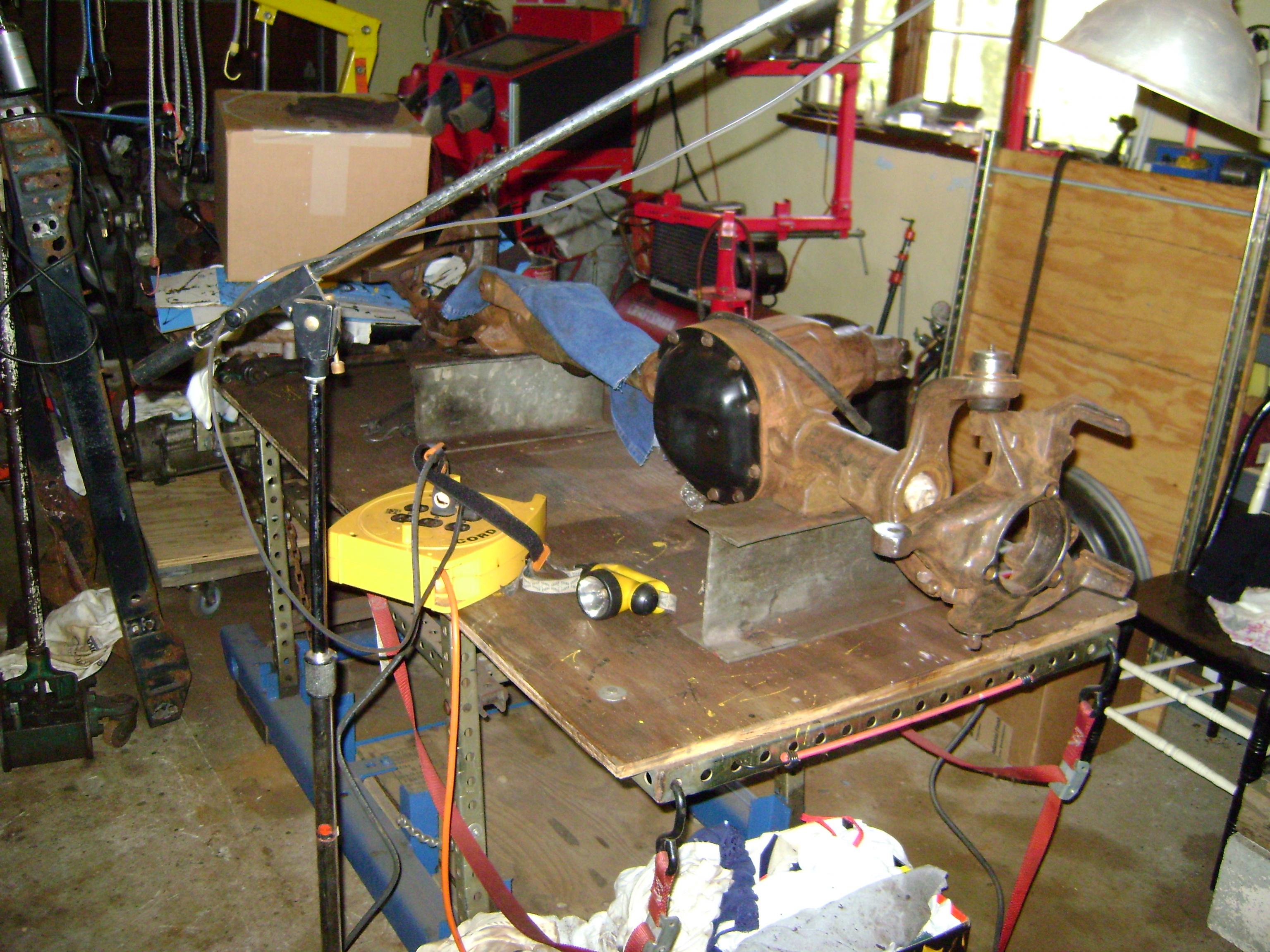

I need front backing plates, bearing hub mount bolts (heads are iffy...I can torque them in but no guarrenty they'll come back off 10 years down the road), plastic slingers for the fr. axles.
NAPA tells me they are dealer parts... I never walked away from a dealer happy, so anyone have an alternate source for right priced OEM?
steering box green started out as 1/3qt of blue rustoleum I had laying around and I mixed some yellow into it.
the dark green on the engine mounts was left over flat black in the bottom of a can I mixed the pre-mix green into for a commercial looking color.

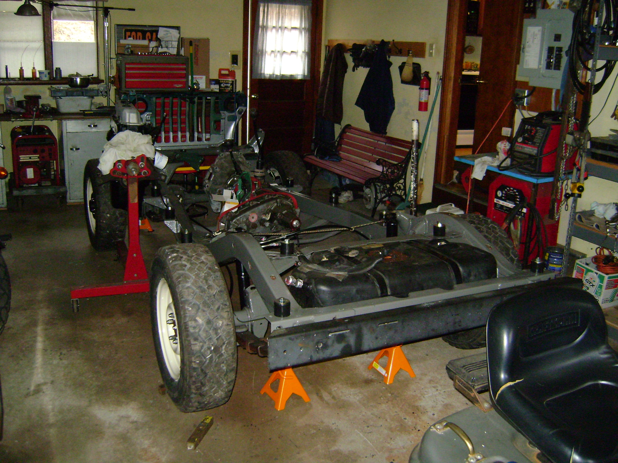

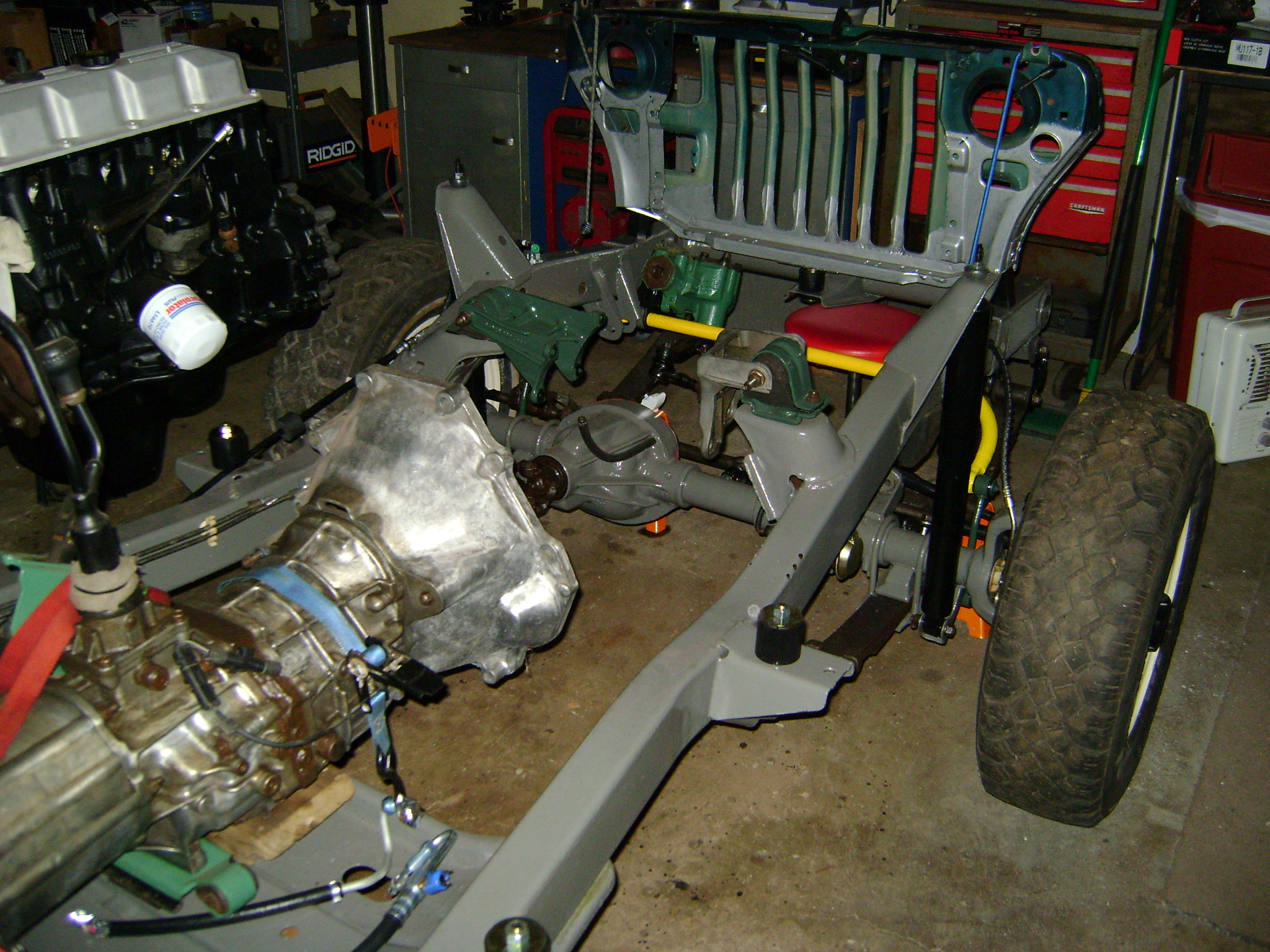

over the chill of winter I got the chassis pretty much back in shape. soon as the muse strikes with tropical breezes, I dig into the engine and trans for a quick once over... and all that's left is the body under...be some welding patch there. goal is to have it back in service for next winter.
money out of pocket is still estimated to be under/around $2500 all told.
the sway bar yellow is tweaking me already...I'm thinking of either painting it the dark green for that military truck sleeper look, or like a rattlesnake with ends...maybe put a danger sign on it.
