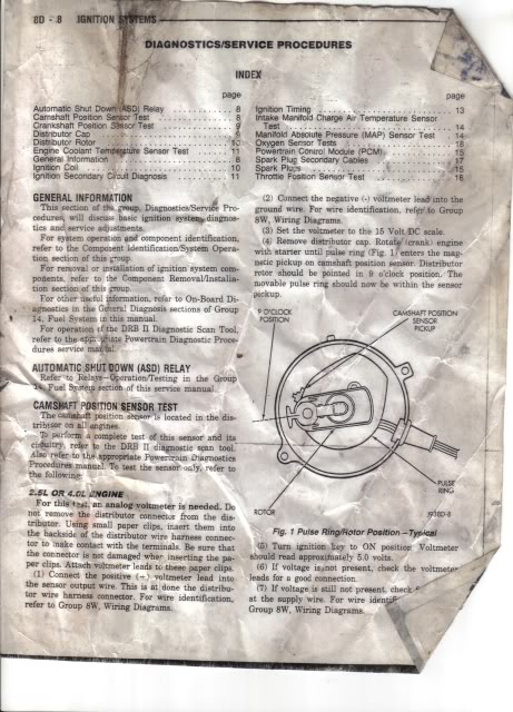

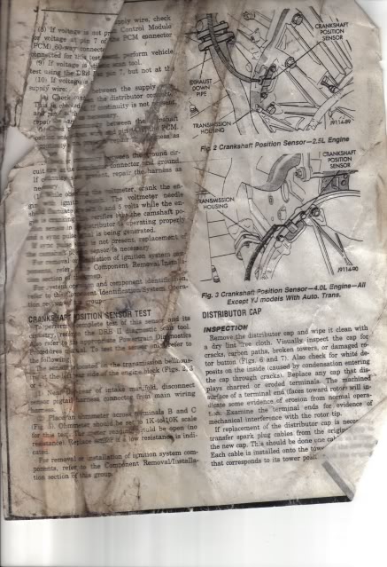

Looks like you have same one
anyway found my Chrysler service manual excuse the bad looks of it dog knocked it into a puddle while back
this may help dont know how clear it will be but Ill try
is that the same year manual? I have a FSM for the 97 and have been quite wrapped up in the majorly confusing schematics; the wiring diagram section in my 97 Ram Truck manual is easier to follow than the Jeep one IDK why they made the Cherokee one such a cluster#*ck. I have been more into tracing the TPS circuit and working from there outwards from the schematic.
(and a disclaimer; I'm not saying the 97 Dodge truck FSM would allow me to figure out this Jeep, or that I would use that one, instead of the "right manual for the application" just makin comment on the differences in layout.
I have many Chrysler service manuals dating back into the 70s. and this one is the most complicated of the bunch the way they have the wiring schematic section set up.
