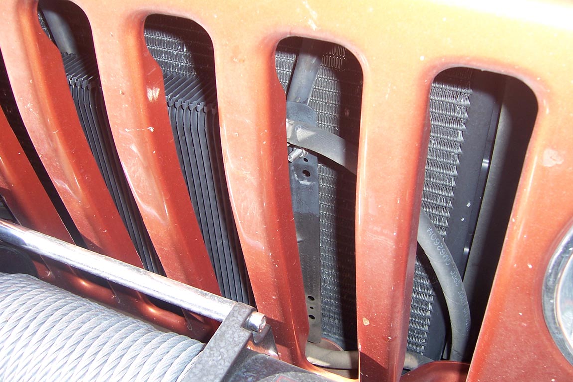

I also run a over sized transmission cooler in series (post radiator). Its made for a for pick-up but it bolts on to the two 'V' front cowl supports. Picture to follow later today. For every 5 degrees cooler you run your automatic transmission you extent the life of the oil 15,000 miles. I am running in the summer time around 145 degrees and up to 165 on the rocks.

this is how I mounted my Transmission cooler, I used those offset clamps and used two , one on each side to mount them to the 'VEE" bars that support the front clip.

Utah-Jeepster, I would like to add an external trans cooler inline with the factory unit built into the radiator. Can you tell me more about how you did yours? Cooler brand used and parts needed to complete the job? I have a 2006 TJ daily driver with the 42RLE overdrive trans running 33x12.50 MT's we live in the desert and the heat concerns me. I just bought the Jeep with only 35K miles so the trans is still in good condition, we just did a lift and added the larger tires.
Mark
GUARDIAN: Brand? I am sorry there I really didn't pay attention, I just went down to Auto Zone and bought one that looked like it would fit the "V" bars its for a 79 ford 1/2 ton pick-up.
The kit came 3/4's complete for my proposes, I also used rubberized hose clamps that I used to bolt the Cooler to the two radiator supports. (McMaster Carr # 3225T22)
The next part is a little more difficult that is crawling under and disconnecting one line off the radiator to find the power side of the fluid flow and which one is the return line.
I cut the hard line on the return side of the radiator and used a brake flaring tool to flare both sides of the hard line, (not really necessary but I am weird), and hooked on the hose and clamped it into place. Then I ran that to the top on the new cooler and took its lower (return line) back to the transmission return line. Strsapped everything in tight and I was done.
I also ran double hose clamps and flared the hard ends to make sure no errant branch could pull the lines apart. The first time I pulled a line off the radiator, it was the power side and I got soaked with transmission fluid so a nice bucket would be handy. But you want to cut the return line coming out of the transmission, close as possable from the radiator so you can run the rubber line along the radiator without littling it droop, let the radiator do the first cooling then the secondary one down stream.
