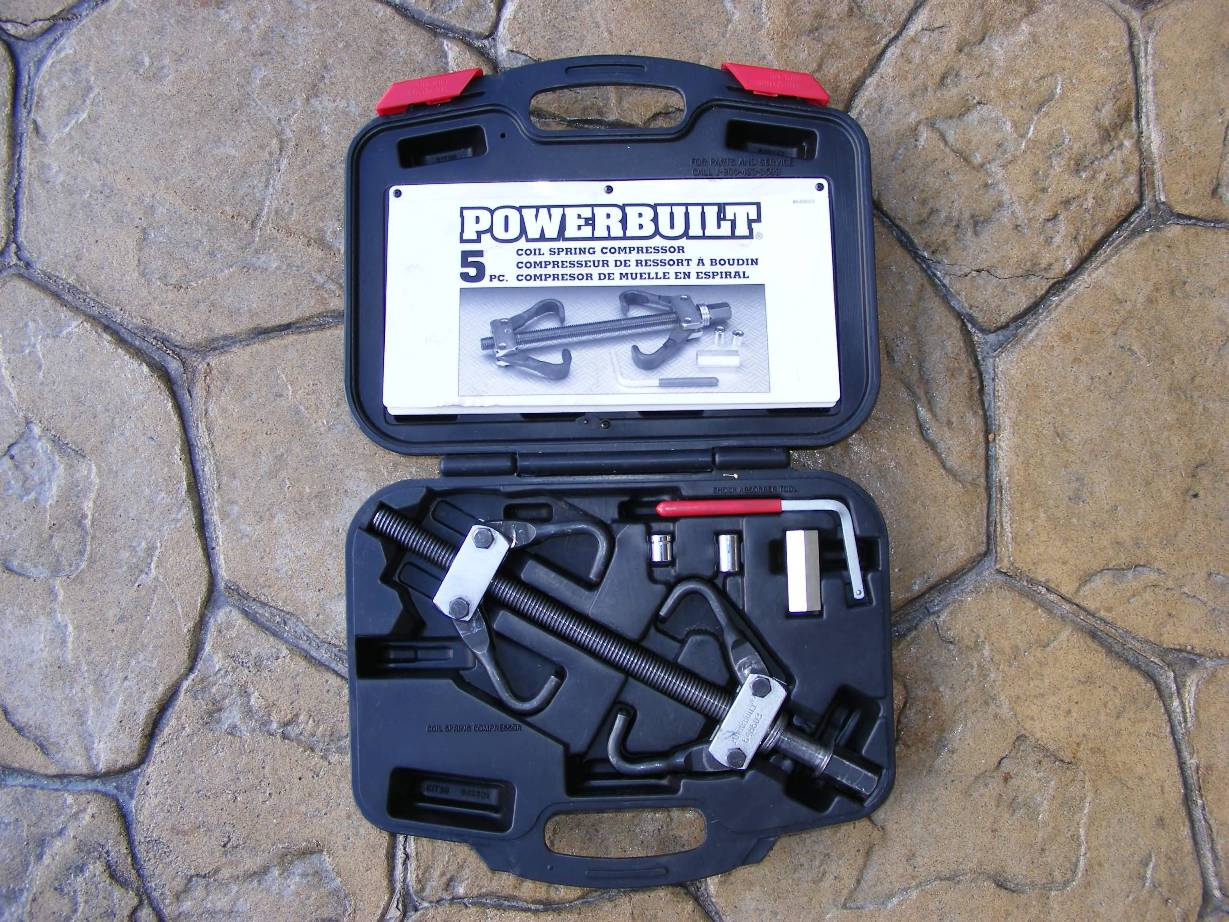

I could see where two compressors would work fine (one on each side of the coil). The one I rented has pretty clear photos and instructions on how to put it in the middle of the coil and hook this single device to both. I just think the jeep coils are too small for this.
I'm doing what BH suggested, and just raising the frame / lowering the axle, then using a long breaker bar to pry the springs in and out. Here's a shot of the compressor that I rented.

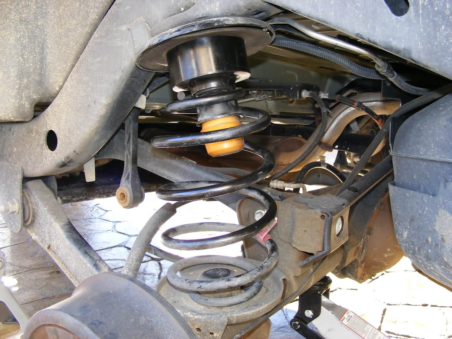

You have to take the coil off the Jeep, and sit the spacer on top, then wedge it all back in place. The coil compressor (at least in theory) will allow you to squeeze the spring without taking everything apart. I've found that it's easier to just unbolt most of the axle parts (tracbar, swaybar, etc) and put it on that way
Here's a photo of the spacer installed with the swaybar disconnected, and the axle dropped.

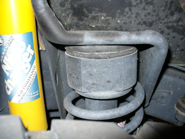

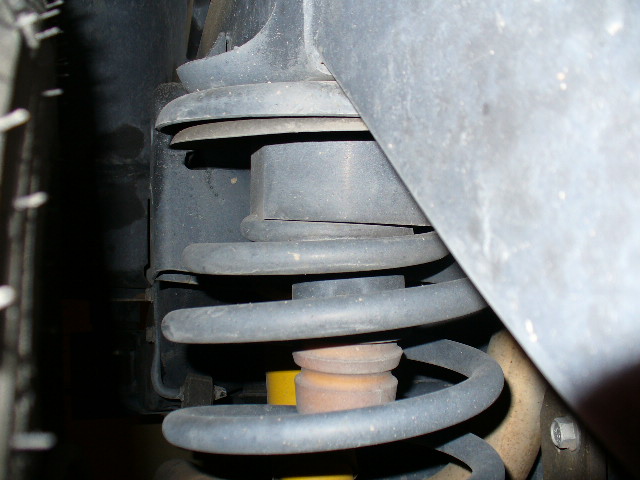

Yep....I didnt use a spring compressor on my BB install and had no issues! If I remember correctly, I had to play with the rear springs a bit more than the fronts.....but all and all a pretty simple kit! 8)
