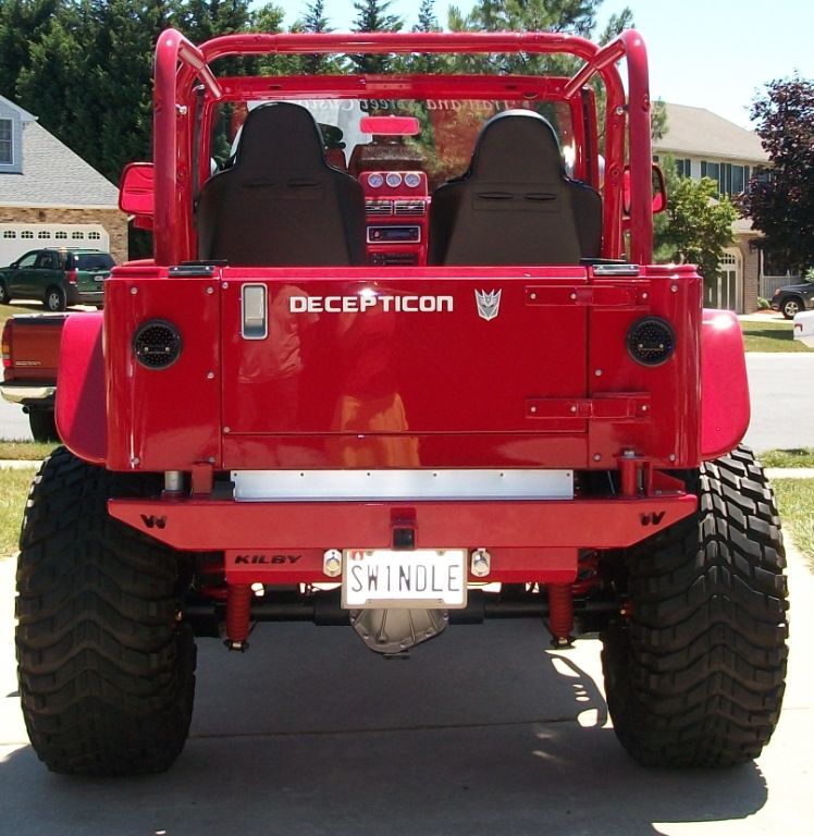

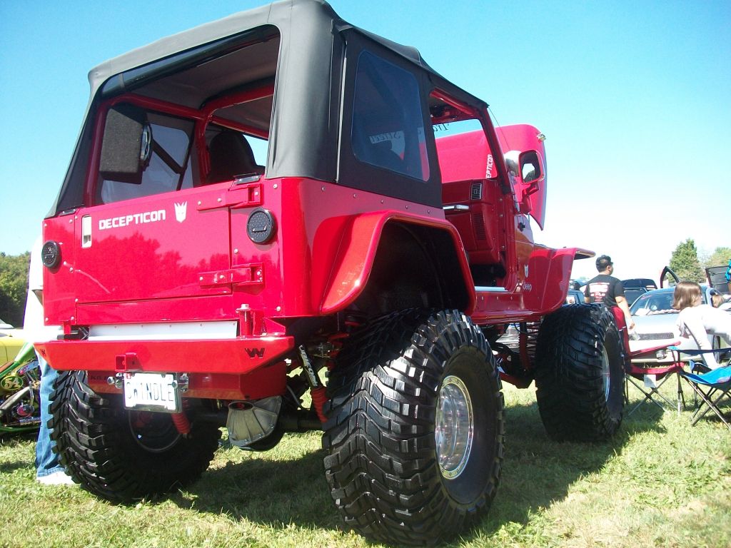

Here's what we did, aluminum door guards from home depot...14 bux...no rust...paint if you want to... simple.
