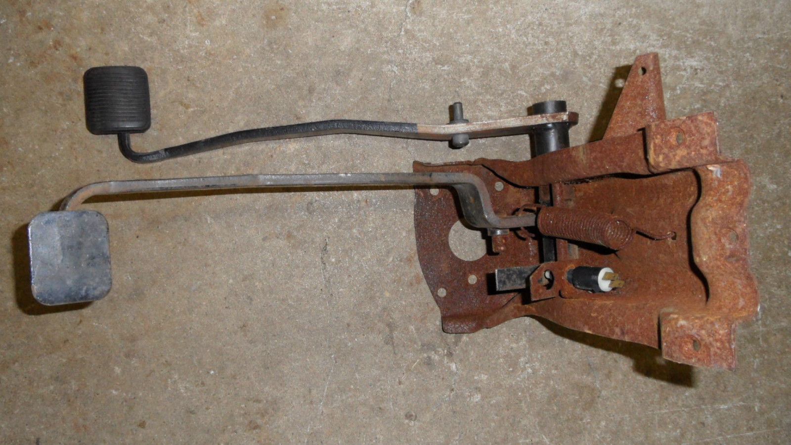

I'm tring to picture what your referring too. Are talking about connecting the round "eyelet" of the brake booster to the brake pedal itself? If so, the haynes manual would be correct if you have an OEM pedal group assm. I have both auto and manual trans setups in my shop and they they do not differ other than the auto setup is missing the clutch pedal and has a larger brake foot pad. The stud to attach the brake booster or master cylinder push rod (for manual brakes) is pressed into the pedal arm from left to right.
Again, just by thinking of what you are discribing, it is possible that someone remove the OEM stud and pressed it in backwards. But I would think that your pedal to rod alingement would be off during the braking stroke? Does your pedal group look like this:

My pedal group on the 88 wrangler looks NOTHING like that. Mine looks like this factory schematic that I found. The pin is a threaded bolt that uses a lock washer in the end. The way it was set up prior to me pulling it out, the brake light switch has the push rod eye sandwiched inside it's metal legs. On the manual transmission, the brake light switch is on the right side of the brake pedal arm. It did not bind, worked fine before, just wanted to make sure I was putting back together correctly.
