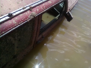

Mine gets stuck :).... I'm running 33s with a 35 and my 30 is the one that gave Me problems
Holy crap. Where do you find mud puddles that big! Or did you just decide to drive through a lake. Haha
