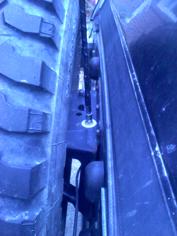

I run a 4ft firestick off the spare tire holder on the back. All that's on it is the firestick, connector, then coax from the stick to my cb. The only thing that I run a ground wire directly to is my cb, then I run the power wire from the cb into an open fuse spot. Hope this helped.
