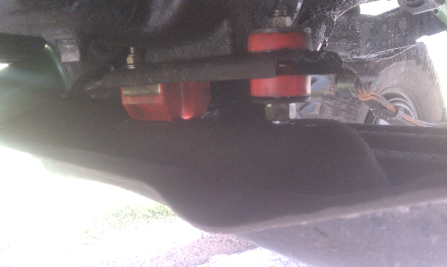

You can continue by eliminating some other factors. Do you still have the factory style "bell crank" clutch linkage? If so, have you installed a body lift? Are you certain that the trans/transfer case bushing and control arm are solid at the skid plate. The control arm helps off-set rotational torque and if the mounting bushing is broken you can have the problems you are experiencing. Does the front axle have a locker?
Yes bell and linkage are factory parts. No body lift. And I got new trans mounts, that I just but on. And no locker in the front. I was thinking that something had came louse but I haven't found anything. Yet.

Yes its mounted to the crossmount/skidplate you should be able to see a pic that I put up. And i see the flywheel.
