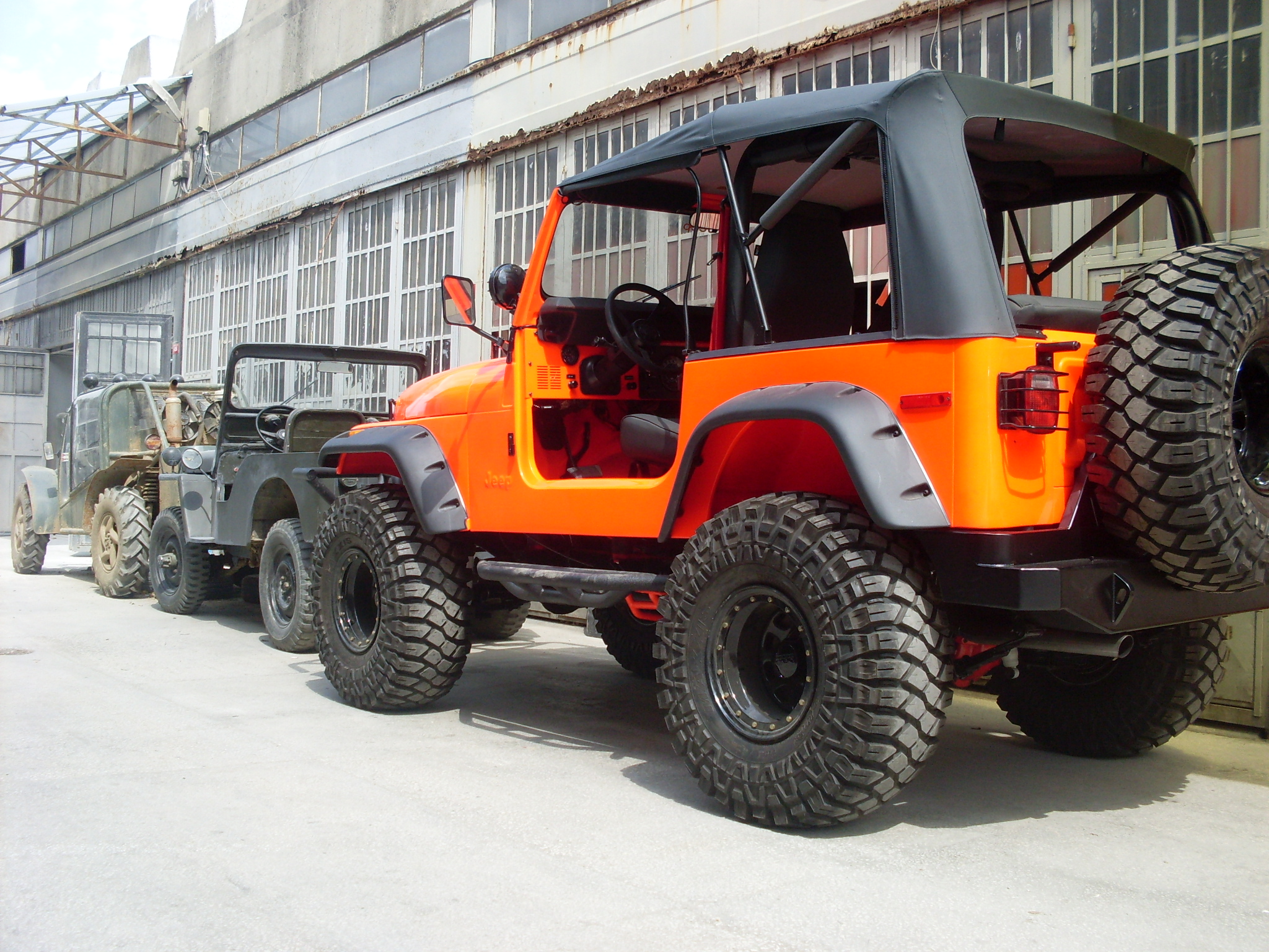

eccentric 2000-6000 rpm ... we are doing the test does not seem a problem now

rear bumper re-done ...
