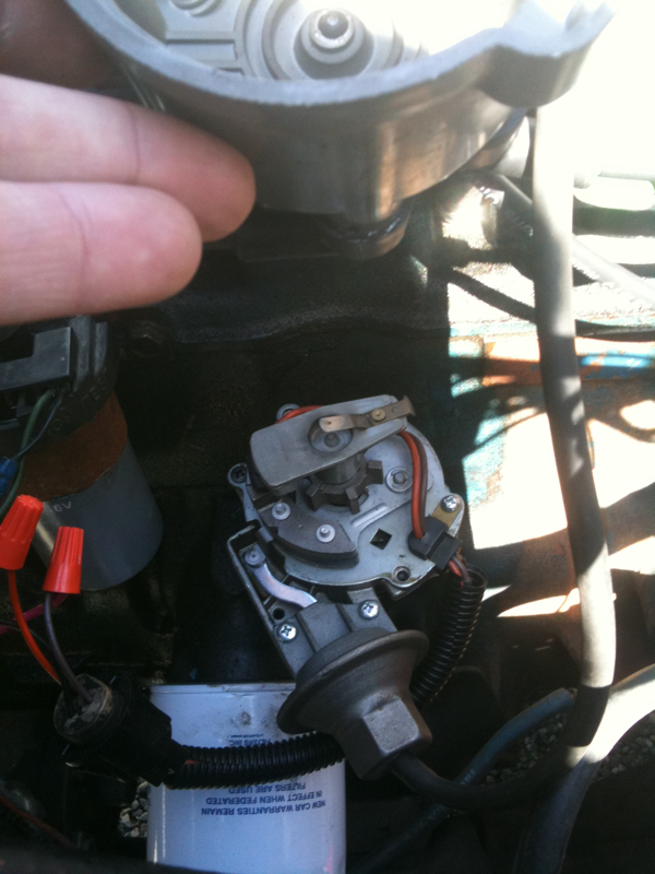

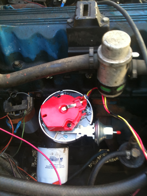

Still waiting on fed ex but.... She should be ready. What do you think? Pic one should be TDC. Pic 2 is where my rotor is lined up. Keep in mind, I was out of whack when I started. COME ON FED EX!!!
Rotor looks correct. Your vacuum advance should be around 3:00
Well son of a B. I might be allowed to keep my tools yet. Still no fed ex. Have no finger nails left. Gonna be hard installing HEI with little to no feeling in my fingers. Lol.
