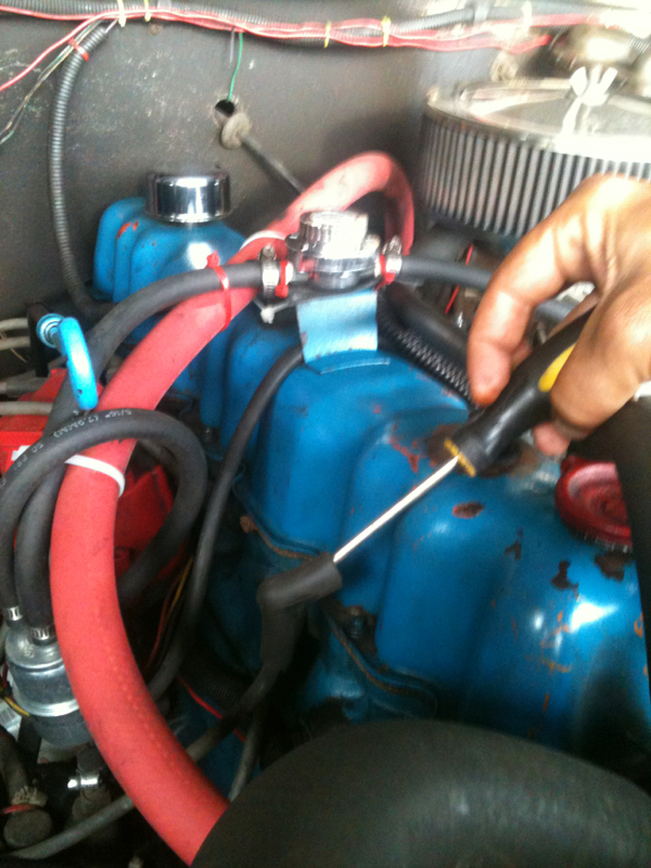

Just changed the plugs and.........wait for it........wait for it. NOTHiNG!!!! Just cranks and cranks. Plug 5 and 6 smelled like gas
I use a Philips head screwdriver. Put it in the spark plug wire and hold it about a quarter inch away from a metal surface on the engine. Have someone crank the motor over. You should see the spark jumping between the metal of the screwdriver and the metal of the engine
you are not kidding. i lay the screw driver so its about 1/4" away because i hate how bad that shocks you.
does that plug smell like fuel? thats an odd color for a spark plug

absolute moon, pull your cap and rotor and make sure they are good. check the rotor with a volt/ohm meter set on the buzzer noise for resistance. it makes a noise and reads zero when you touch the tips together. put one tip on the end of the rotor that spins and the other end on top where the button form the cap sits. also, make sure your wire from the coil is good, check it with the meter too, one tip in each end touching the metal. it shoud make the noise and read zero too.
if both of those are good, check for power to your coil by putting the meter on volts and touch one tip to each wire. it should read 12 - 14 , or whatever your battery reads.

you just did the nutter right? check to make sure all your wires are still connected first

If the terminals on the cap and rotor are corroded, the spark won't be able to jump the gap. Creating a no spark zone.
first, make sure your wires on the nutter bypass are connected well still
