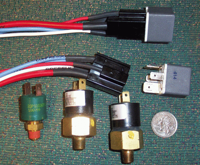

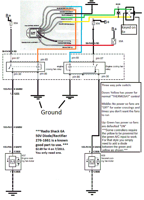

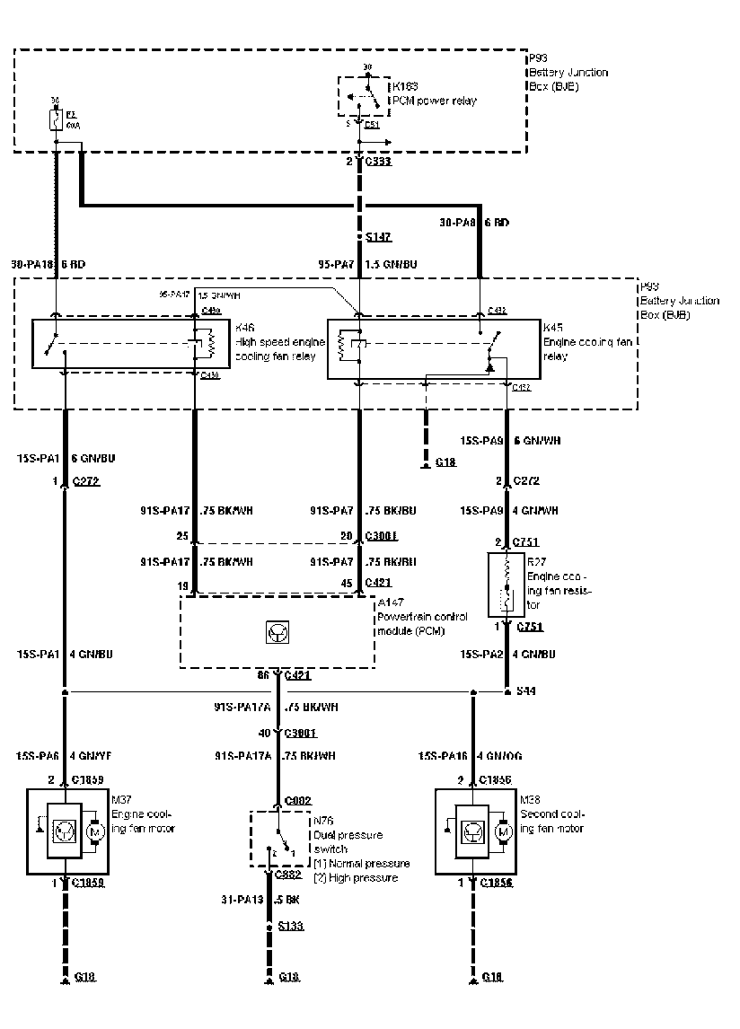

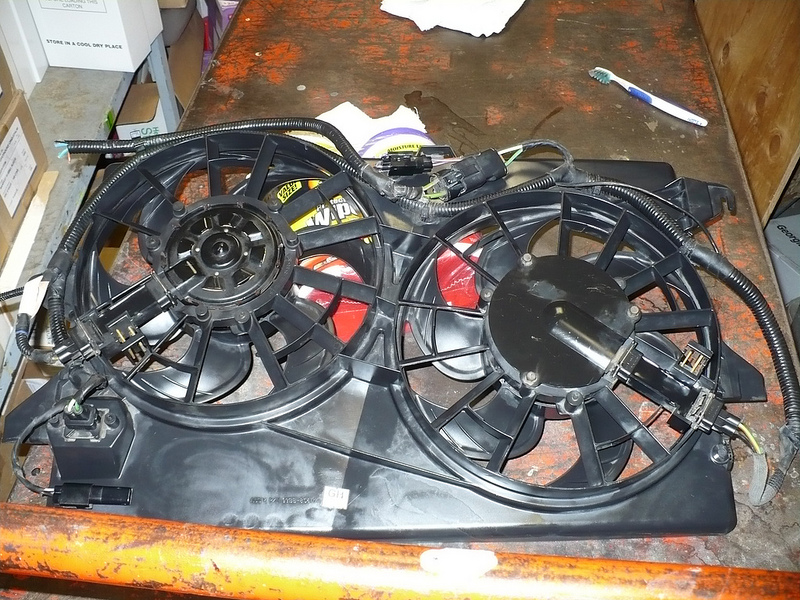

Hi gang, from this and other forums I got it straight about wiring up these fans using relays and such. Now what parts would I need to incorporate a slow startup for these fans? Could I wire in a capacitor? IF using a capacitor once it reaches capacity does it just DUMP amperage onto the line? (and POP goes your wiring)? and where in this circuit would be the approapriate place to splice one in?(Thanks to Coiz for the images)
