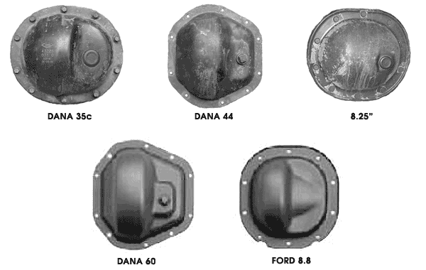

Here is a photo from rustys

also, just look at those diff covers. the front is always the d30. the rear is the one you have to compare
