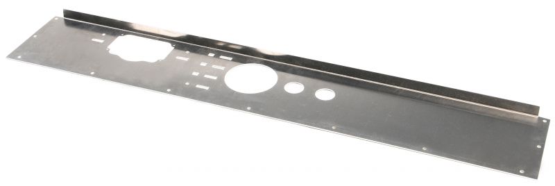

Quadratec sells a replacement dash for all 76-86 Jeep CJ-5, CJ-7 & CJ-8, so the can't be that different
Aluminum Dash Panel (With Cutouts) for 76-86 Jeep CJ-5, CJ-7 & CJ-8 - Quadratec

Yep. Quadratec or 4WD Hardware have all the various styles and even have blanks if you want to make your own cutouts.
I just had a piece of aluminum sheared with a 1" lip bent at the bottom for rigidity. Then I cut all my own holes so I could use larger Autometer gauges and move the stereo over where the glove box used to be. Note that it is a bear to cut the square holes for the pull knobs though.
