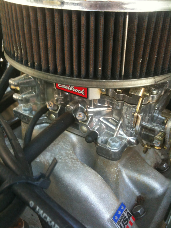

Here's a pic of my carb I think that other nipple with the cap might be a vacuum. Would it help attaching that?

There should not be a return line. That looks like a 1406 electric choke carb. The small ports on the front are vacuum ports (EGR and distributor.)
Also looking at the picture, generally the distributor vacuum line goes to the timed (pass side of carburetor) port. This is mandatory on emission controlled applications, if so applies to you.
Disregard that, I am an idiot, you have it on the correct side, I had a massive brain fart.
You can use a fuel regulator. holley, eldelbrock, both make them and others im sure. I have seen them a advanced auto before. As to the ported or full vac debate, I like running the full vac all the time, other like the ported vac, but jps4jeeps is correct that the timed port is more for the smog engines of the 70,s and 80,s. which is you.

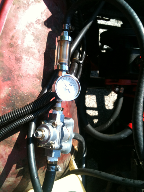

I have a Holley pressure reg. I don't have a pic but its got one inlet and two outlet. Is one of the outlets suppose to be a return? Cuz I've got a gauge on that second one.
Yes, it can be a return line. I would re-mount my gauge in a tee after the regulator on the inlet side of the carb.

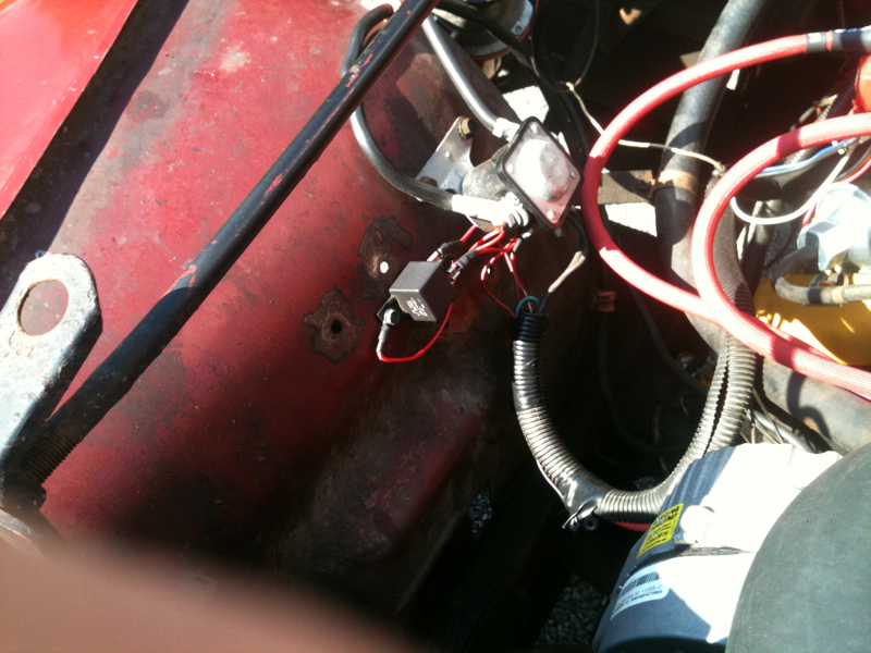

No problem....... You may want to consider installing a oil pressure switch and relay. This way you will have a N.O. circuit that will run the pump with oil pressure and another N.C. circuit that only works during starter turn over.
I will send you a schematic when I get home.

Looks like you got the same reg as me. Where'd you set the reg psi at? Cuz I almost always have a low reading.

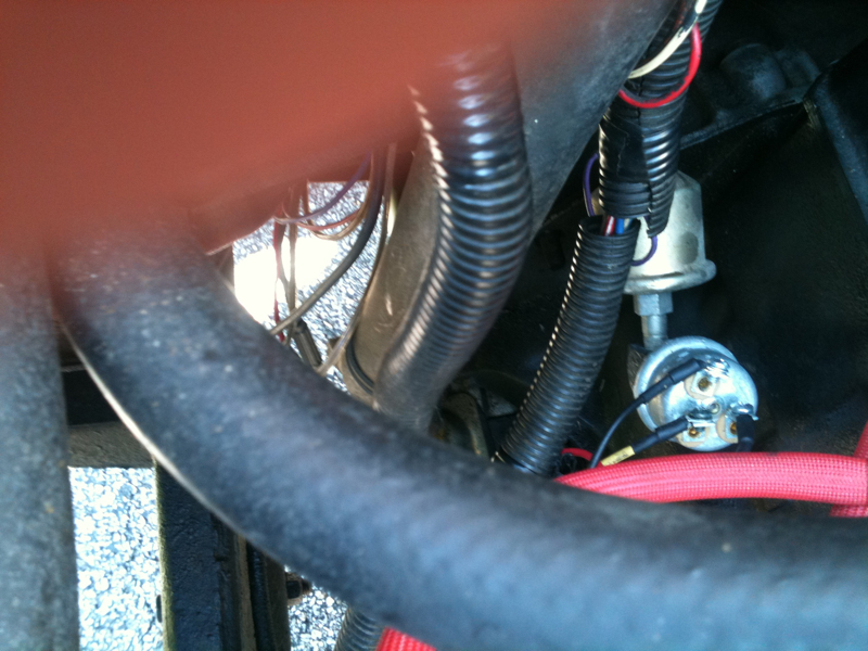

As far as the oil pressure switch, I'm assuming that it will replace the oil to gauge set up by relaying electrical signals instead of physical oil. I prefer the mechanical cuz it's less likely to fail.
So if you got another alternative to the oil switch I'd be interested to hear about it.
Mine is set for 4 psi. because I run a Weber. You would keep the mech. gauge, you would just plumb in a 1/4" tee at the engine block. Sorry I don't have better photos with me, I'll see what I have at home later.

Your current oil psi gauge should be threaded into the block, so you'll remove that and install a (1/8th inch) nipple into the block where your current tie in is, then a tee (1/8th inch) and re-connect the oil line going to the dash. On the branch of the tee you'll install a oil pressure switch (i.e. Holley # 12-810).
