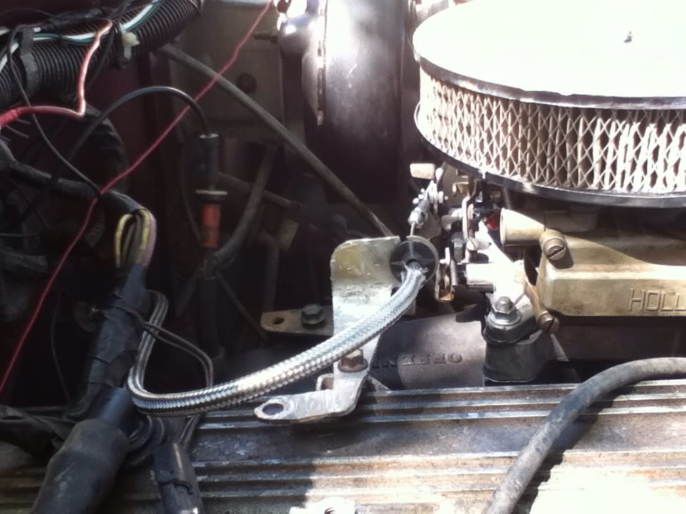

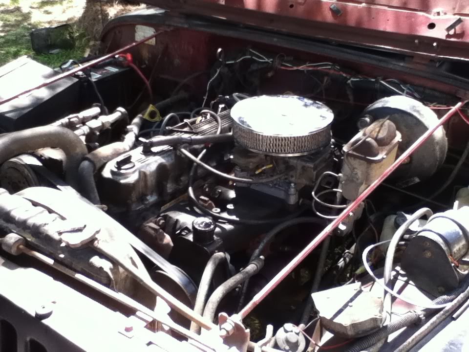

This is the best of any of the carbs I have used on the jeep so far. Rock sold idle, accelerates like a sports car, 3500 rpm is 95 mph, no hanging idle or flat spot, it's just unbelievable how smooth and powerful the jeep is now. It's like my two barrel Holley but doubly better.

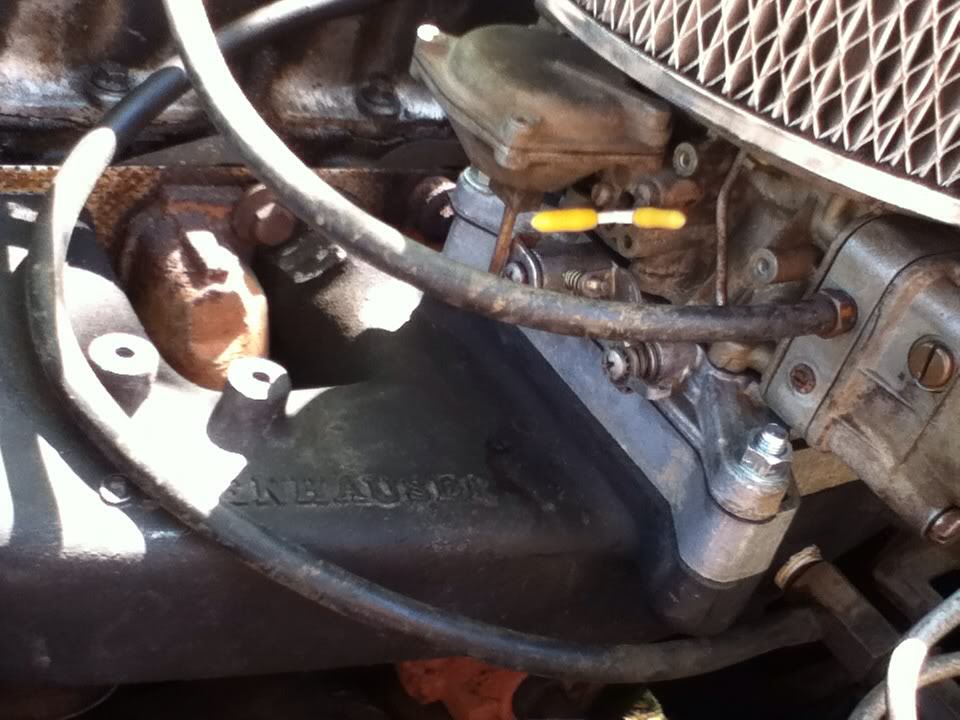

Here are some more pics for you guys
Once I find a proper choke housing, I can pull that white tee out but for now, that's a huge vacuum leak without the tee.
For all you other 4.2 carb guys, forget the motorcraft 2100/2150 and just get a dang Holley 390 or 450 cfm four barrel and be happy
dude, its so nice. the other guy with an 87 black wrangler, chris, has a 600 cfm edelbrock on his.

its a 470 and a few people are running that one on jeepforums. i thought about getting that one but this 450 showed up so i got it. i didn;t even know there was a 450cfm because the holley web site doesn;t list it. i was searching on ebay for ford four barrels and it popped up listed a 66 mustang four barrel, it didn;t say holley in the title so that must be why it went so cheap, no one was finding it on the searches.
