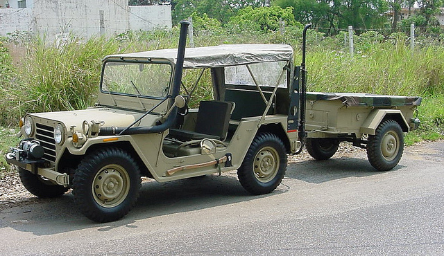

When I see posts regarding fording and such I remeber back when I was in the Grunts, Being a Motor T driver. Our Jeeps (if it looks like one, smells like one and leaks like one, it's a Jeep in my book) there was a snorkel not only for the intake, but for the exhasut as well. I reckon it was to prohibit the results of cramming a bananna up the tailpipe.
there was a unique way to come off an LST or other vehicular landing craft when driving an M151 Jeep. The procedure was (depending on state of tune) to rev the motor up with the foot throttle (not WFO but enough to keep from stalling) and pull out the hand throttle to lock the revs. Then standing on the driver entry to the tub, using your right hand to steer and keep your chin up. Half the time mine found a dam hole (blub blub)
