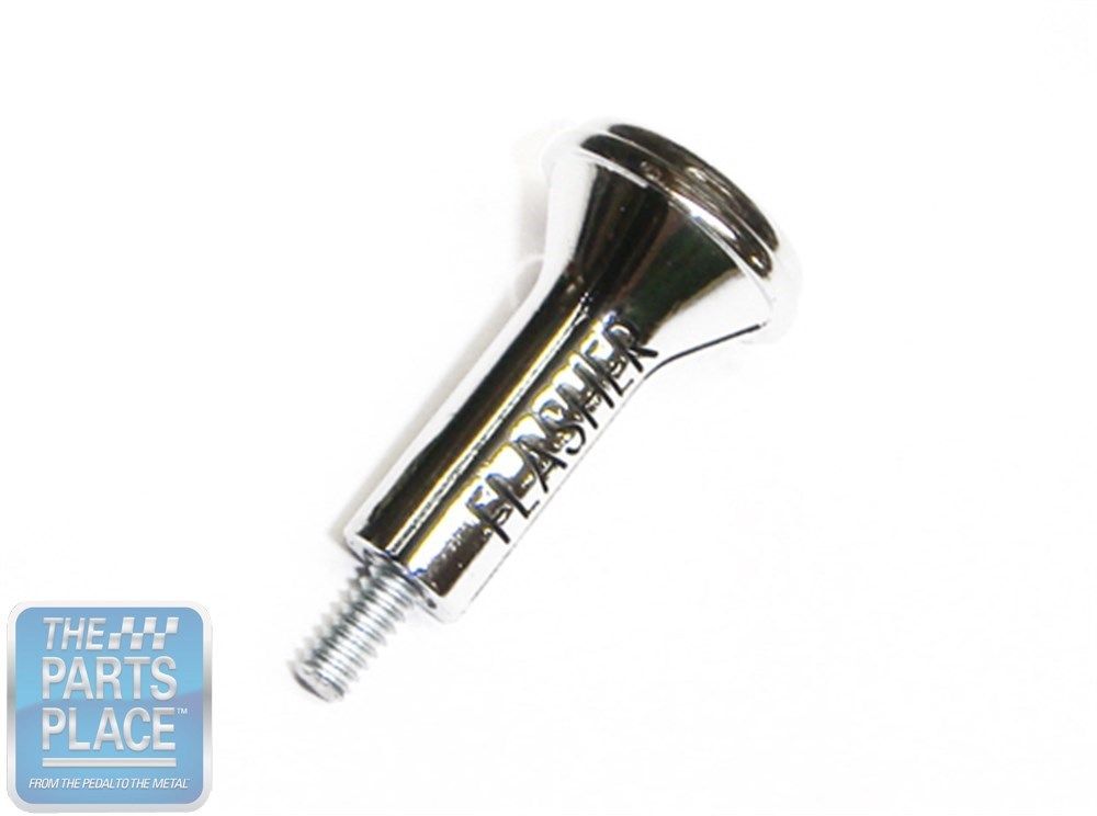

I had enough slack in the cable group to pull out the upper end of the assembly and from what I see it seems that the Hazard button installed
May be the wrong type and not long enough to engage. I wonder if these may have a longer reach.
They screw into the upper end harness after it's hard mounted up.

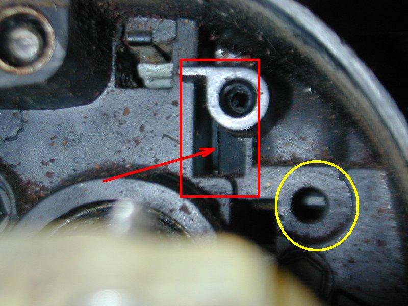

A wierd thing I found in this column was an STS threaded in as kind of set screw for the ignition cylinder. It doesn't seem OE and there's no reference I can find about it in the TSM. Has anyone else found this?

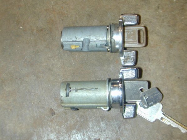

I learned from another forum that the later CJ's had a set screw and recess on the cylinder to accomodate one while earlier CJ cylinders have a tab that pushes in to lock the cylinder in. On mine the added set screw is what led to my issue with having to very firmly push in the key and rotate the cylinder to start.
From that forum;
Later model CJ's has a screw that held the lock in place.
See the angled slot in the top cylinder? The lower lock just has a spring loaded clip that holds it in place.

The yellow hole is were the retaing screw goes and the red box is were earlier CJ's had a detent to push in to release the lock.
