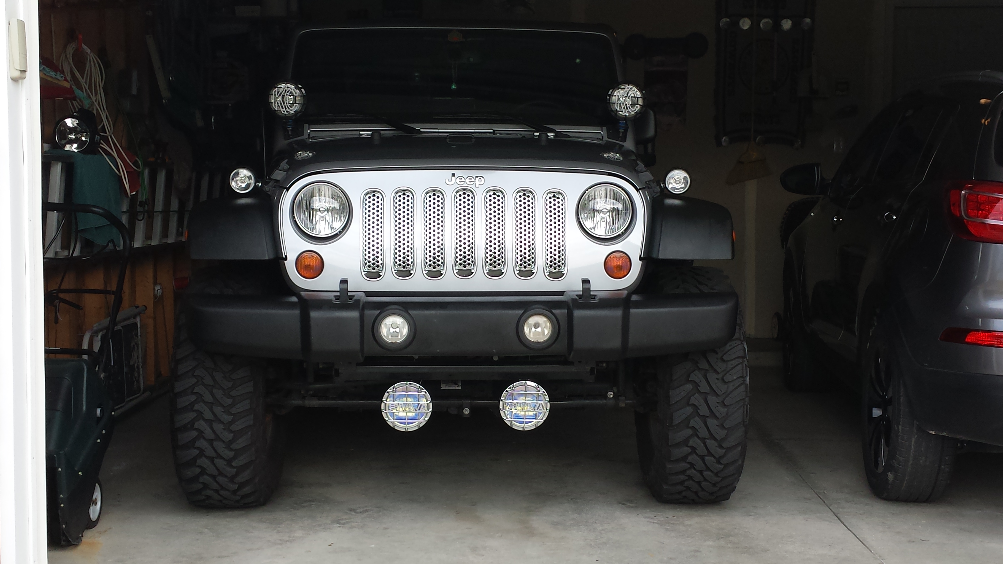

Great advice! I also had an '08 Wrangler Unlimited that had a "wandering" problem and after checking the alignment was correct and all the stock parts were in decent shape, I installed an after-market steering stabilizer and that fixed the problem. Not saying this will correct your problem with certainty, just something else to keep in mind. The stock stabilizer just couldn't handle the larger tires after 60,000 miles and the after-market heavy duty stabilizer could. I also replaced my stock shocks and that improved my ride significantly. I bought that Jeep with the lift already on it and it was a budget 2 1/2" lift. Lesson learned. When I bought my '13 Sport brand-new, I spent serious money on a quality lift that included Bilstein shocks and both the lift & shocks are outstanding.
