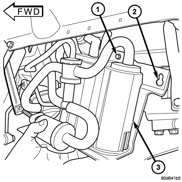

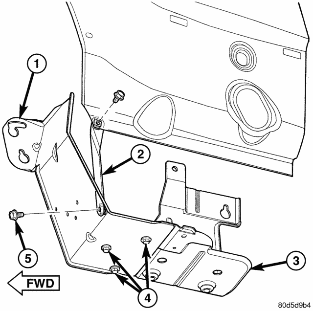

The EVAP canister is located behind the left-rear wheel (LOCATION, LDP / EVAP CANISTER). It is attached to a two-piece support bracket (TWO-PIECE SUPPORT BRACKET).
  1. Equipped With Rear Tow Hooks:</B> Remove tow hook support bar (2 bolts). This bar is located near the upper / rear support bracket bolt (#2) (SUPPORT BRACKET BOLT).
  2. Remove 1 support bracket brace bolt (TWO-PIECE SUPPORT BRACKET).
  3. Loosen, but do not remove 2 support bracket nuts (SUPPORT BRACKET NUTS).
  4. Remove upper/rear support bracket mounting bolt (SUPPORT BRACKET BOLT).
  5. Carefully lower support bracket assembly to gain access to vapor / vacuum lines. To prevent damage to lines, suspend bracket assembly with rope or string.
  6. Disconnect necessary vacuum / vapor lines at EVAP canister.
  7. Remove EVAP canister mounting bolt.
  8. Lift canister from support bracket (2 pins are used to align canister into support bracket)
