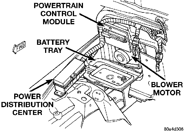

UUhhmm, That illustration is for a CJ.. Here's the one for the TJ.
REMOVAL
  1. Remove the battery from the battery tray. Refer to Battery for the procedures.
  2. Remove the three screws securing the Powertrain Control Module (PCM) to the mounting bracket on the engine compartment side of the dash panel. Move the PCM away from the blower motor opening in the dash panel Blower Motor Remove/Install
  3. Unplug the blower motor wiring connector.
  4. Remove the three blower motor and wheel assembly mounting screws.
  5. Remove the blower motor and wheel from the heater-A/C housing.
  6. Remove the blower motor wheel retainer clip and remove the wheel from the blower motor shaft
INSTALLATION
  1. Install the blower motor and wheel into the heater-A/C housing.
  2. Install and tighten the three blower motor mounting screws.
  3. Connect the blower motor wiring connector.
  4. Install the PCM to the mounting bracket with three screws.
  5. Install the battery in the battery tray.

I agree with you.I went and looked at my tj and yours is correct..Time to mail Haynes and have them some corrections.
