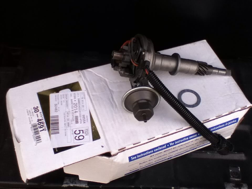

here is our fun distributor, part number 30-4691, available from advanced auto parts (and probably others too). it is for a 1980 cj7 with an a 4.2 liter motor.

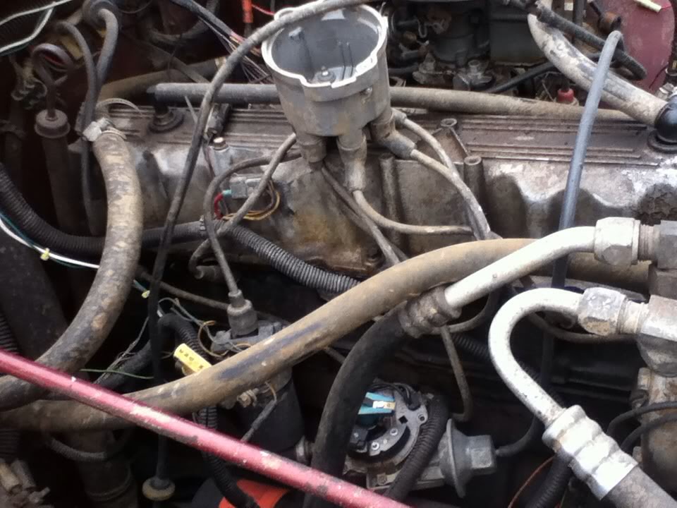

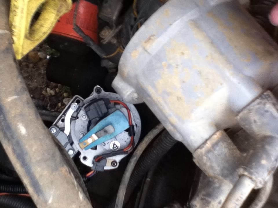

unscrew your distributor cap and set it on the valve cover
pull the rotor (the blue piece in the center of the distributor) and set it in the cap

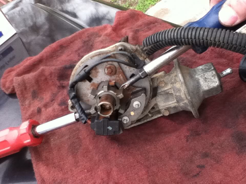

here is your distributor, be it out of hte vehicle or still in the block, you can do this either way. it is actually easier in the block so you don;t even have to pull your distributor to check what kind of unit you have.

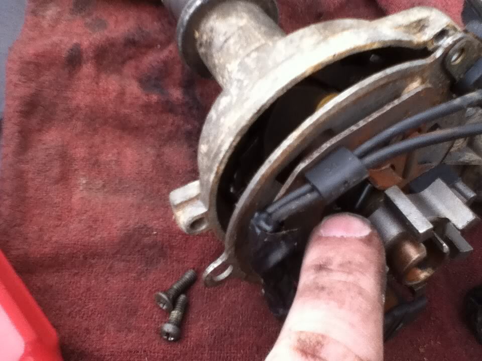

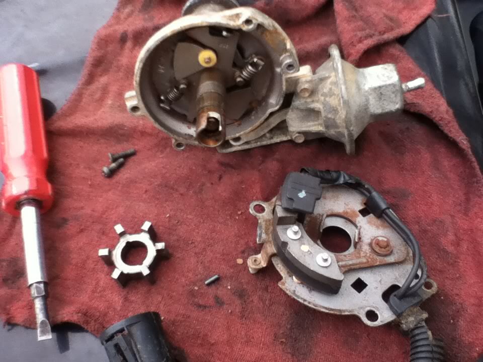

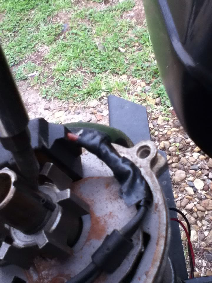

that little star looking piece in the center needs to come off. you just put two screw drivers opposite each other slide it up. don;t forget to undo the screws though or you will be looking at it like i was and wondering what the hell??
once you get the star to move to the top, start being a bit careful as their is a roll pin in it that holds it from spinning on the shaft. that roll pin needs to not drop and get lost or you are going to have a heck of a time driving to the hardware store or autoparts place to find another.
luckily, the little black box on the plate you unscrewed is magnetic so you can stick the roll pin to it and it will be safe.
slide your whole plate and star off and set it somewhere safe

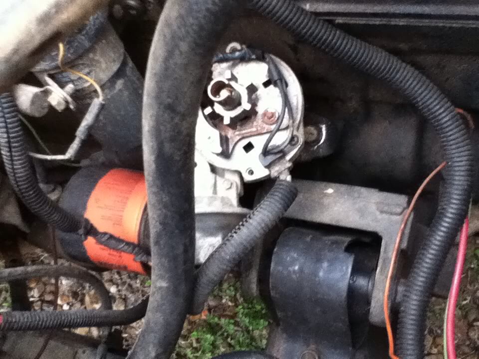

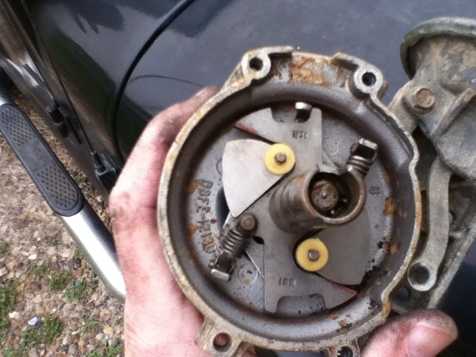

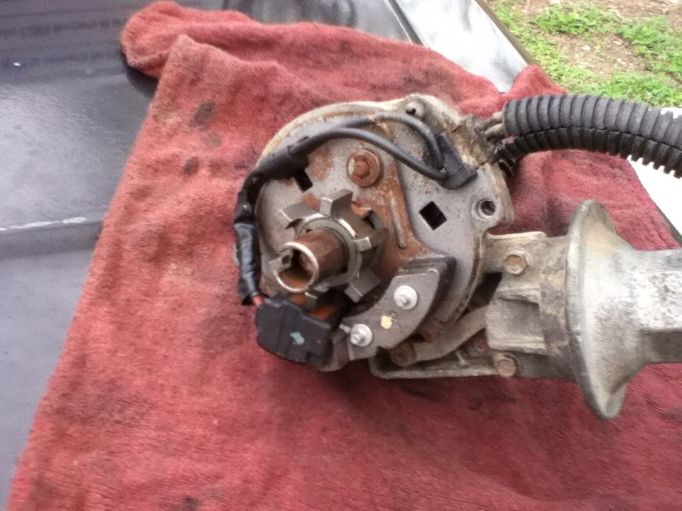

you want to look into the distributor at your spring advance plate
see how this one says 13r and 16r? yours will not say that, it will say 7r and 9r or 8r. (this is the dumb part i warned you about earlier. i never actually opened my distributor up prior to buying the new one. i assumed mine was the older version and now have two of the good distributors)
what you want is purchase the one i showed up above sitting on the box and then open it up and remove everything we just did and swap your plate so the little metal arm is sitting in the 16r slot which will allow you to have the max advance you can get.
once you have purchased your distributor and swapped that plate around you will have to pull your old distributor and replace it with your new hot rod distributor though, this is how you do that.

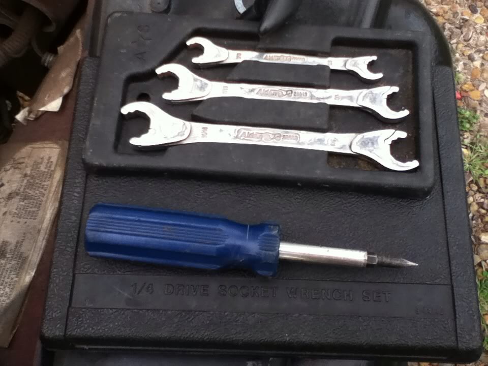

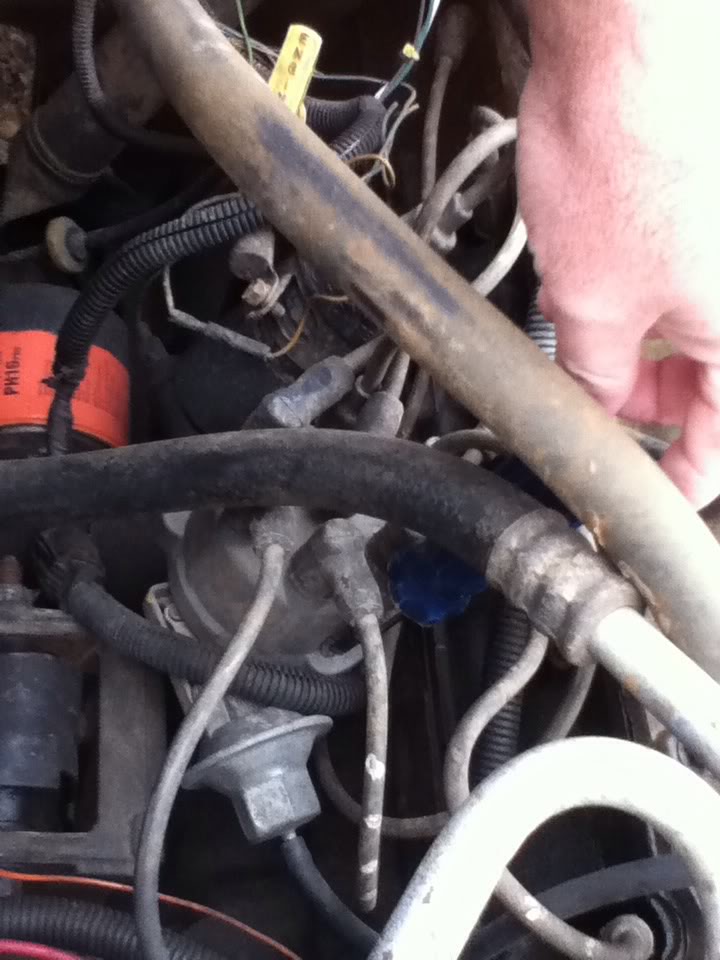

you are starting here with your handy dandy screw driver, wrenches, and sockets
put the sockets back, you will not need them

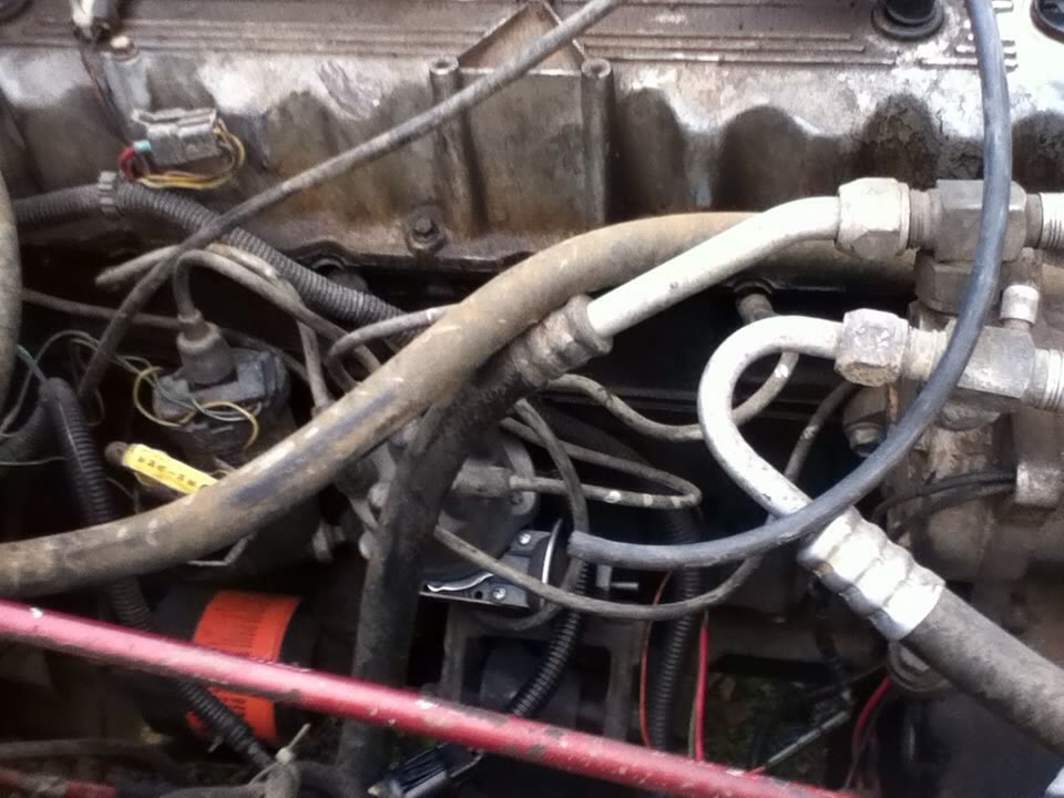

unscrew the little weird screws holding the cap on and lay the cap on the valve cover again.
pull rotor (remember where it is pointing, you will need to know later) and put in cap, again

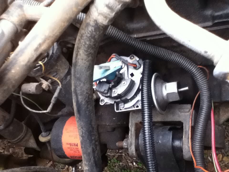

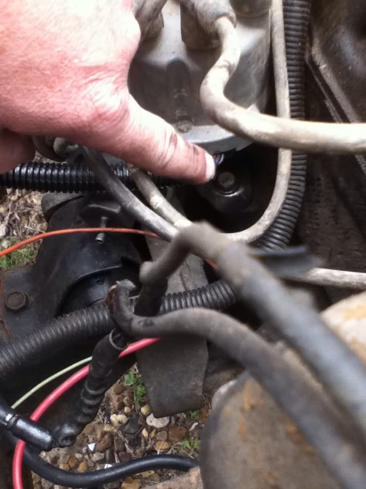

pull vacuum line and lay it on top of valve cover too

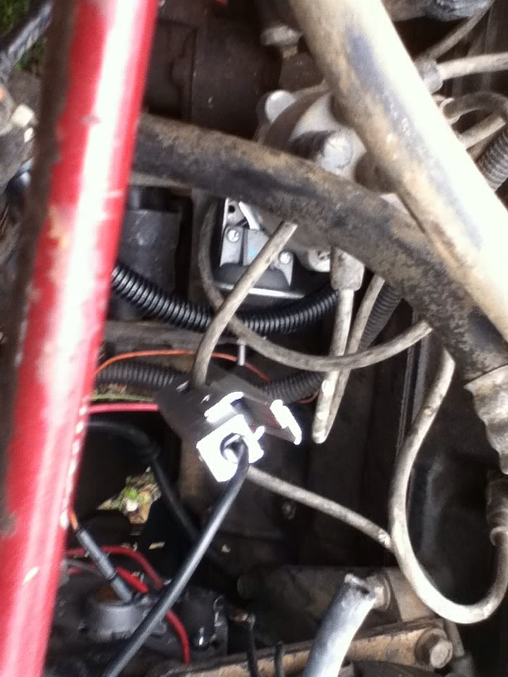

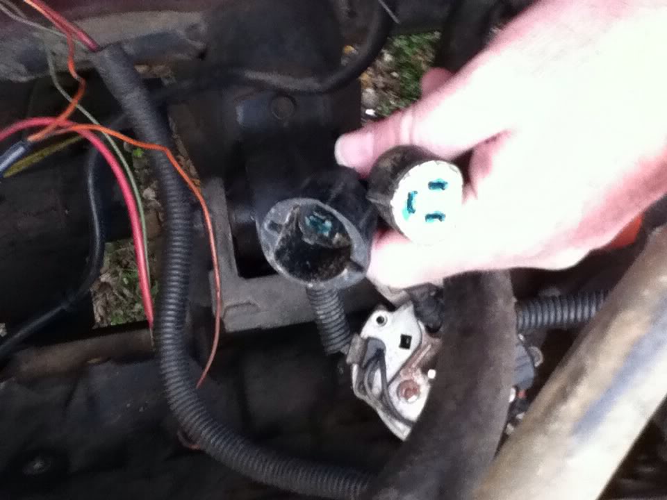

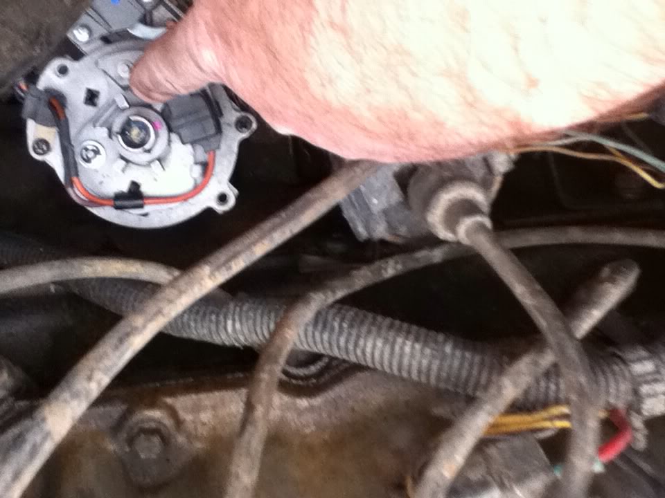

unplug electrical line (what hte heck is that!!!!!? that is corrosion, our evil arch nemesis who is always trying to stop our beloved jeeps from running. by some electrical cleaner in a spray can and get hte out)

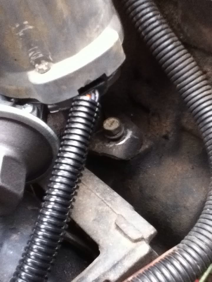

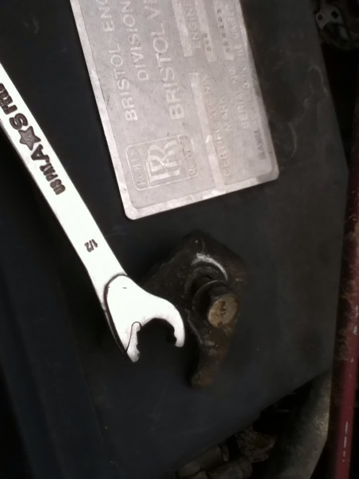

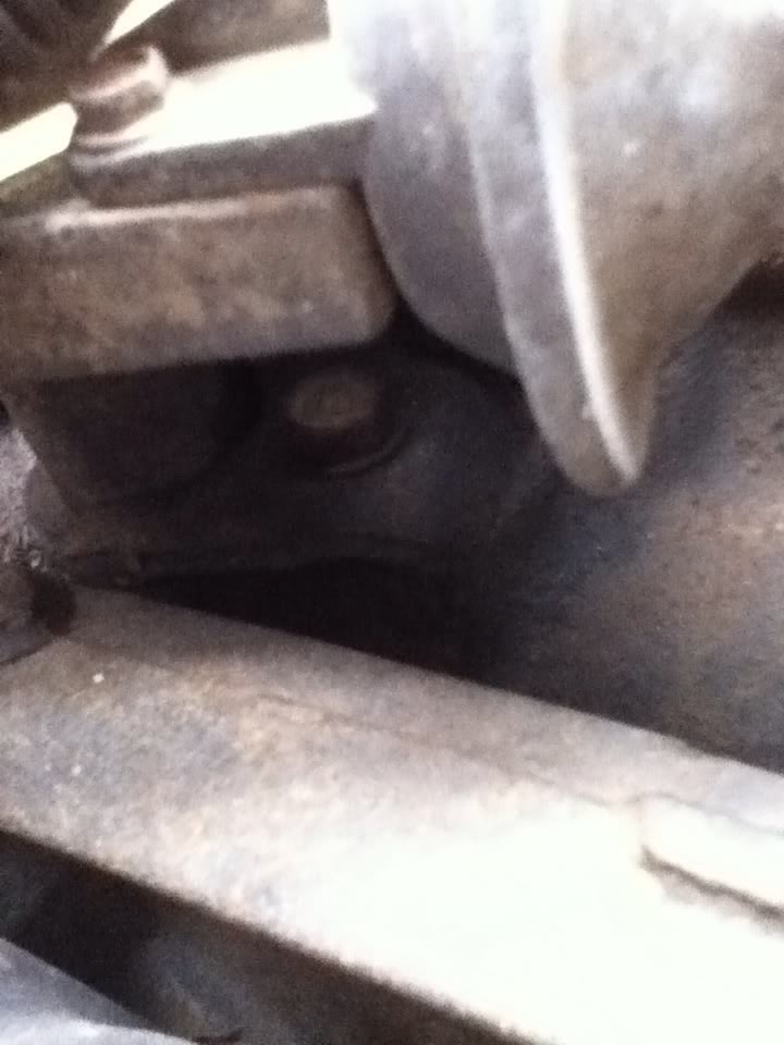

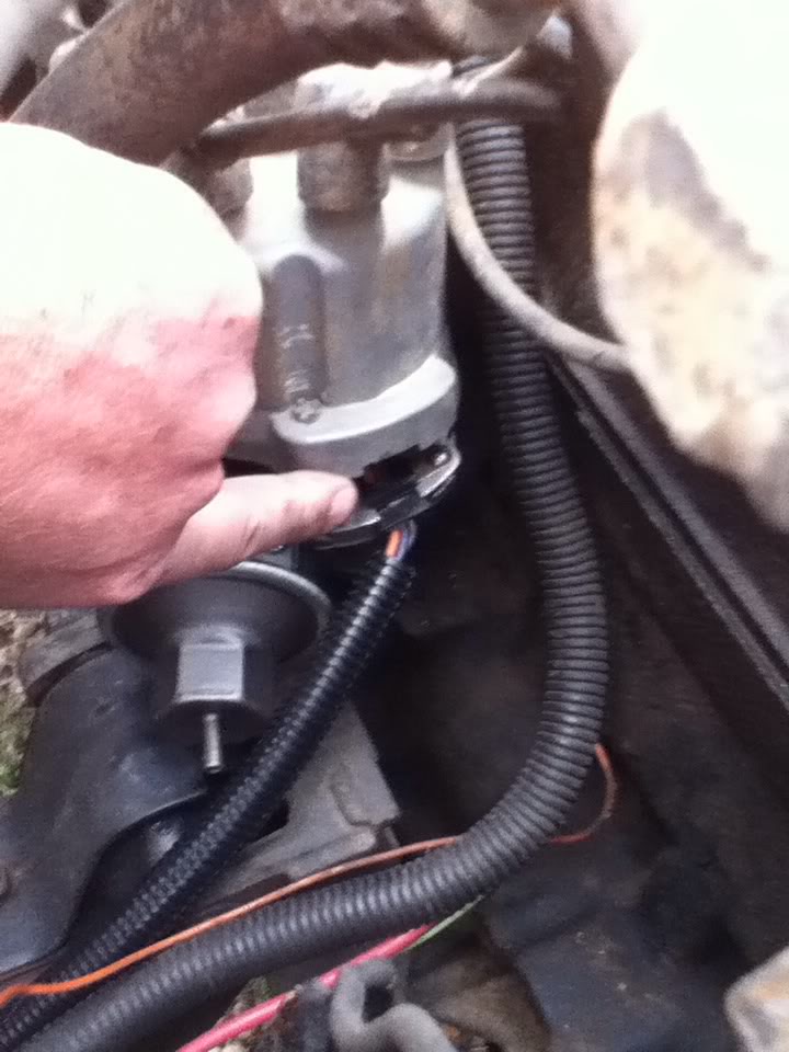

underneath the vacuum cannister is probably where you clamp and bolt are, like mine was
take that bolt out and keep it with the clamp somewhere safe. its another important piece

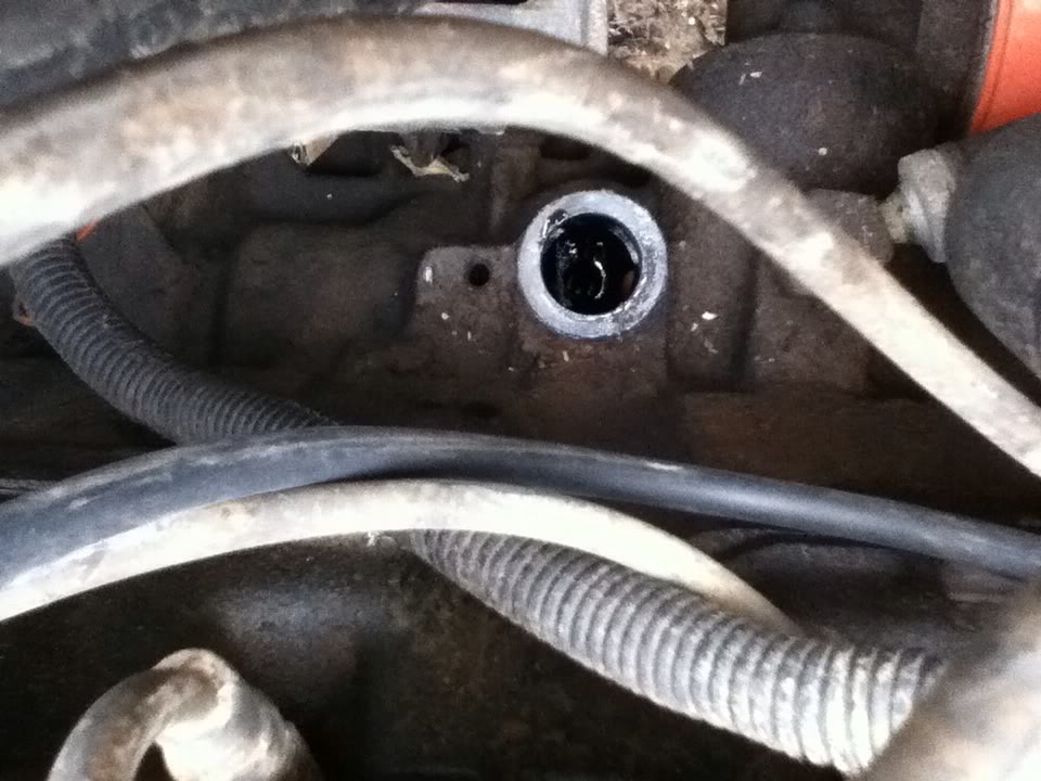

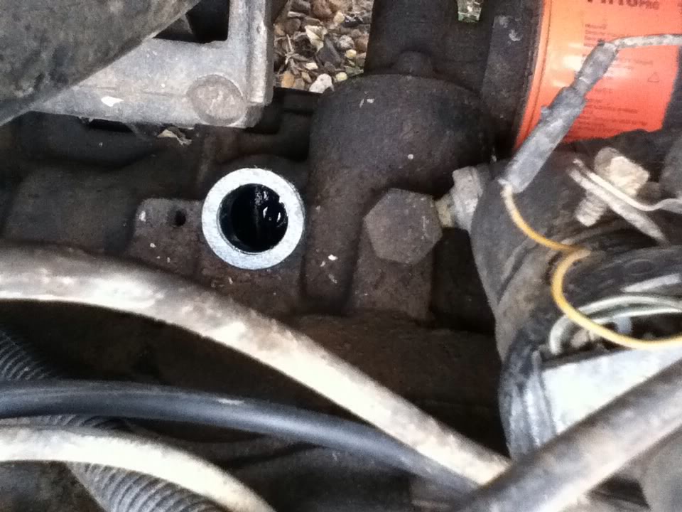

now, you will just pull the distributor straight up and out of hte block leaving a large hole so don't drop anything into this hole. no dirt, leaves, nuts or bolts, anything!!
that slot in the bottom is your oil pump slot. the teeth are from the cam gear. that is why you don;t want to drop anything in that hole. it will just screw up your oil pump and cam gear causing you to have to take some other stuff apart that will take way longer then the half an hour or hour this takes.
now you are up to the reinstalling your distributor point. it will just drop right back into the slot but will invariably not line back up exactly as before so you will have to adjust your timing a little bit. we will go over that too.

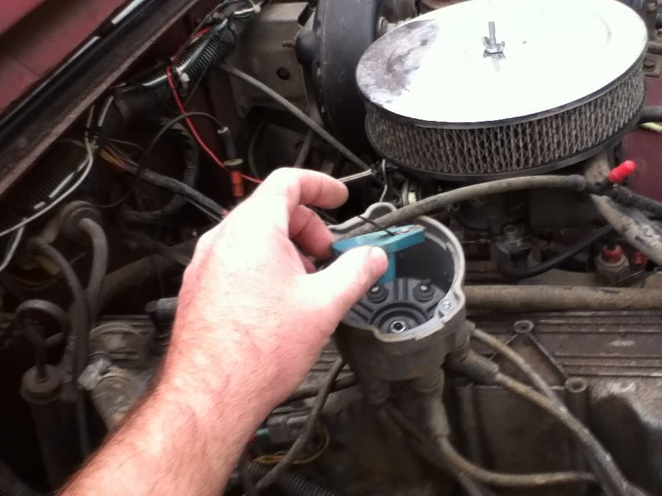

see this slot on top of the distributor shaft, it is what aligns your rotor. it needs to be open end to the way your rotor was pointing when you pulled it off originally. this one is 180 out so turn the shaft until it points roughly where the rotor pointed in the earlier pics
and then put the rotor back on
your cap only goes on one way so be sure to align this slot up with the wires coming out of the distributor body
oh man, don;t forget to put the bolt and clamp back on or you will never stay in time.

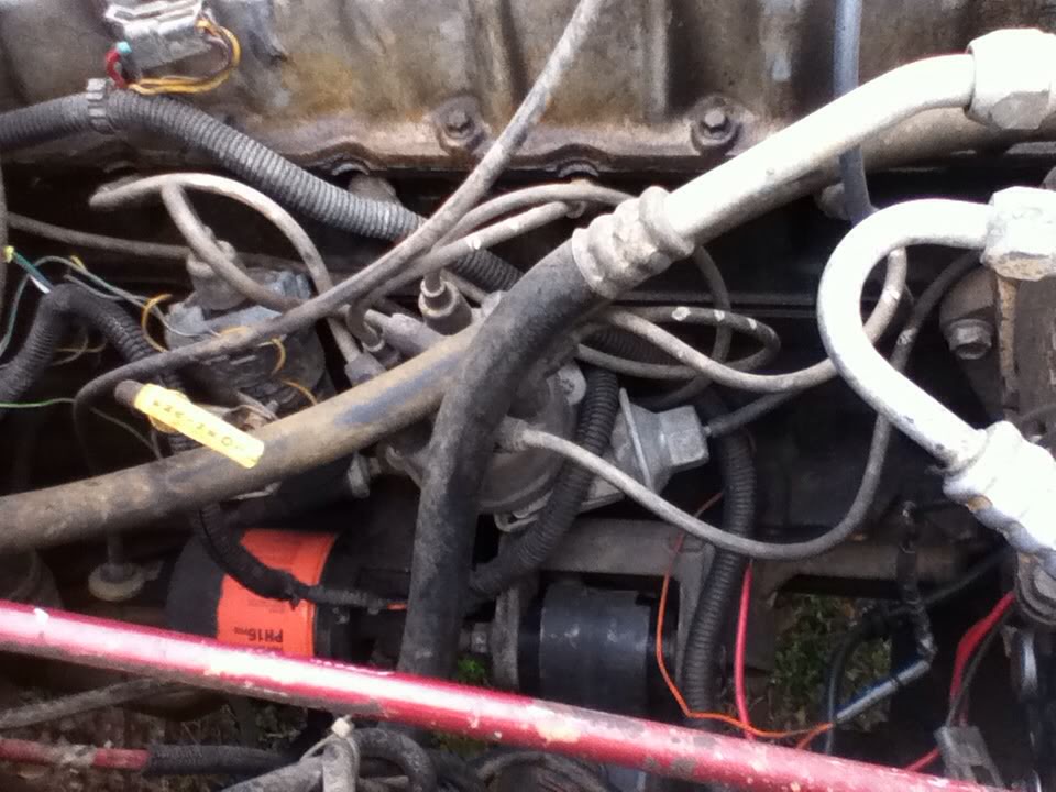

your distributor rotor should be pointing roughly where it did when you first started
this is hte earlier shot of the removal
when i say roughly, it has to be fairly close. see the differences in my roughlies? it was enough that the jeep would not start and was having a hard time cranking so try and align it as close as possible. to align it without pulling the distributor over and over, just twist the vacuum cannister to where it is inline with the rotor more.

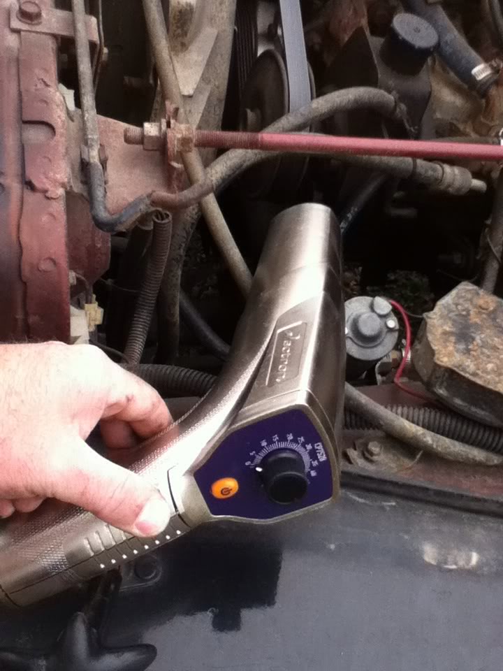

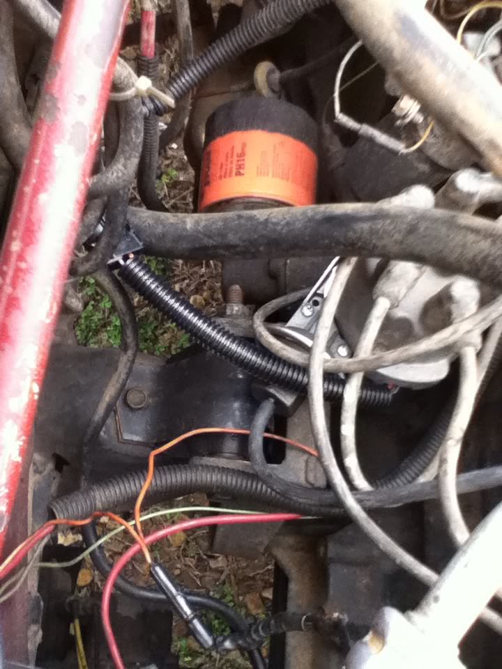

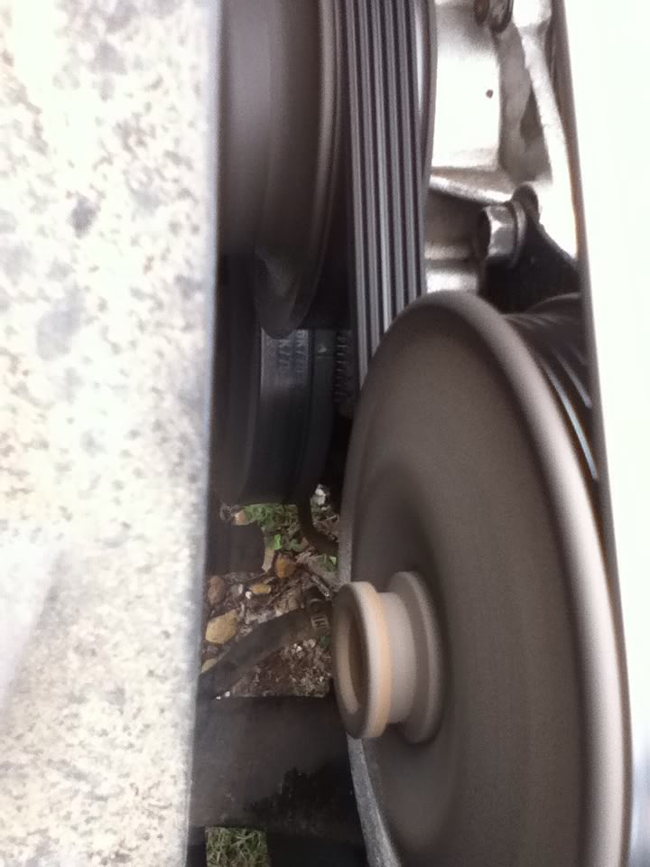

get your timing gun and lay the leads out so they will not get caught in your fan or any belts.

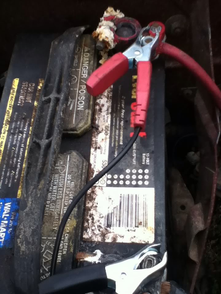

i run mine in front of the radiator. hook your red to the positive on the battery, black to the negative, and the inducer to the number one spark plug wire.

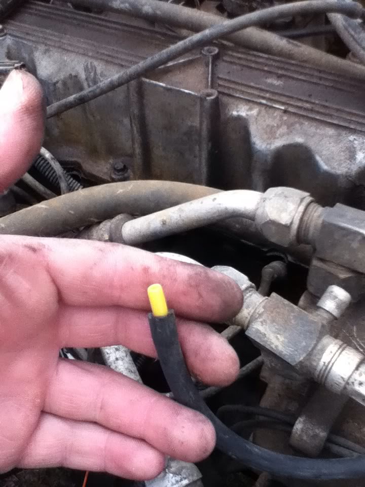

be sure to not have your vacuum hooked up to the distributor and make sure the end from the intake is plugged or you are going to be off a bit

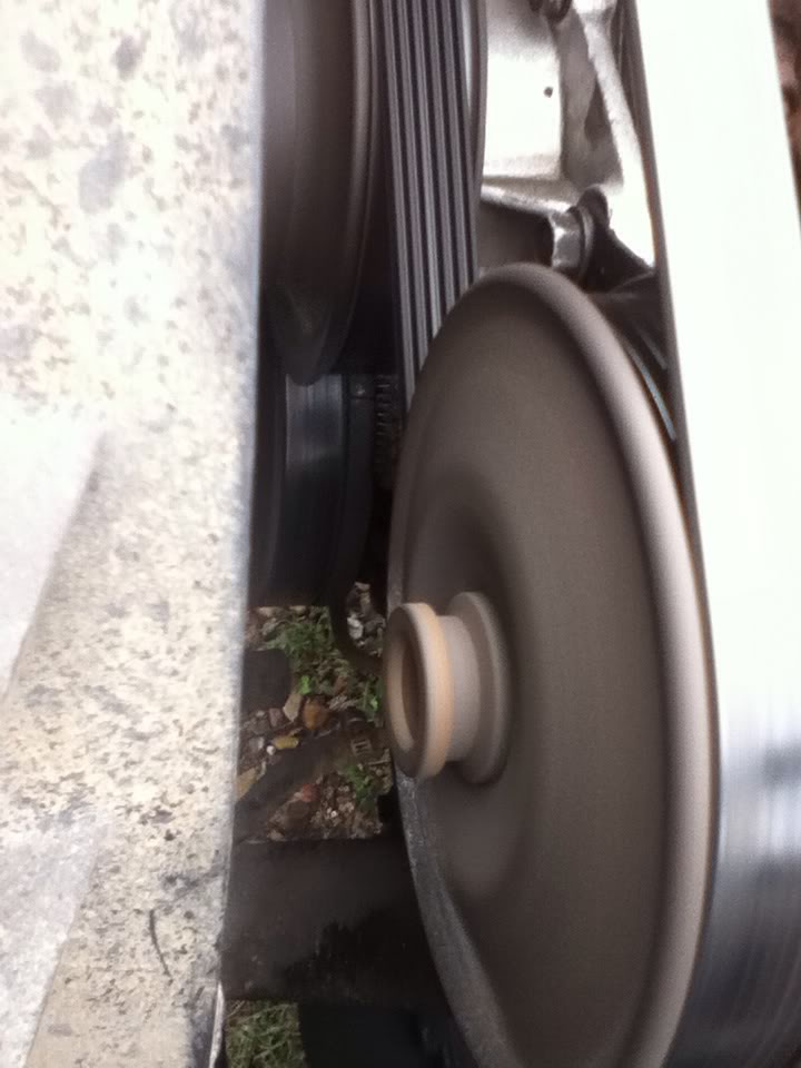

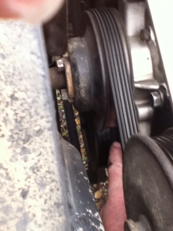

once it starts, you want to look here for your timing marks
point your timing gun at those marks and pull the trigger (a note on your timing gun: make sure the knob is set at zero, if you have a knob. if your using a timing light (no know) then you are good) you will probably just see nothing, like i did. this means your timing is way off in never never land and probably about 40 or 50 degrees out. its ok, the jeep started. your idle is probably way up there too, around 1k or 1200 rpm? don't worry, it is running and easily fixable now. :shades::shades:

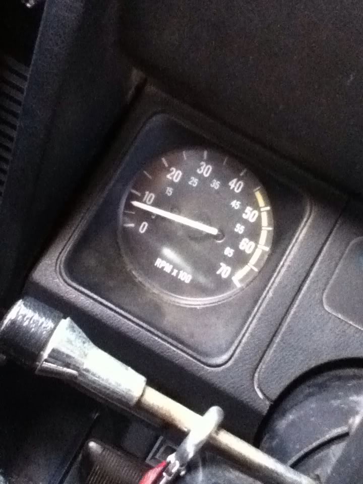

go over to your distributor and turn it clockwise a bit, while the jeep is running. your idle will drop while you turn the distributor. what you are doing is bringing your timing back to where it is supposed to be, around 8 or 9 degrees. keep turning until your idle sounds like it did before, about 700-800 rpm.
now go grab your timing gun and point it at the marks again and you should see this.
whooops, we are a hair to high on our timing. since i accidentally cut the numbers off the mark when i took the picture, that line with the white dot is the crank pulley on the engine showing top dead center on the crank (tdc). those little lines on the right are the timing marks showing before dead center (bdc) with a 2, 4, 6 ,8, 10, and 12, if i remember the numbers right. either way, that line with the dot is about 10 or 11 degrees which is still a bit to high as you will probably get knocking when you go up the on ramp in warm weather at this setting.
turn the distributor a hair more, please, and then check your marks again. this is pretty much where you want to be, 8 degrees. everything runs good here. you start easily, idle smooth, and can run up on the highway with no knocking or pinging under load.

i am waiting to hear how to adjust the star ring on the shaft to change to the 18r instead of the 13r so i can get some performance benefit from swapping to the same distributor.
ok guys, i made some adjustments to the old distributor i removed in the write up and reinstalled it but i was unable to get pics because i was in a rush to have a running vehicle to get to work in.
i removed hte advance head from the top of the distributor shaft by pulling the little c-clip in the top where the rotor normally sits. then i unhooked the springs from the raised arms and lifted the whole plate off the distributor and reinstalled it 180 degrees. this adds 18 degrees of advance in stead of 13 degrees when everything is at full advance. so add your vacuum advance of whatever the cannister applies when vacuum is sucking and hten add 18 degrees and add your initial 8 or 10 degrees you set the timing at and that is what i have changed.
