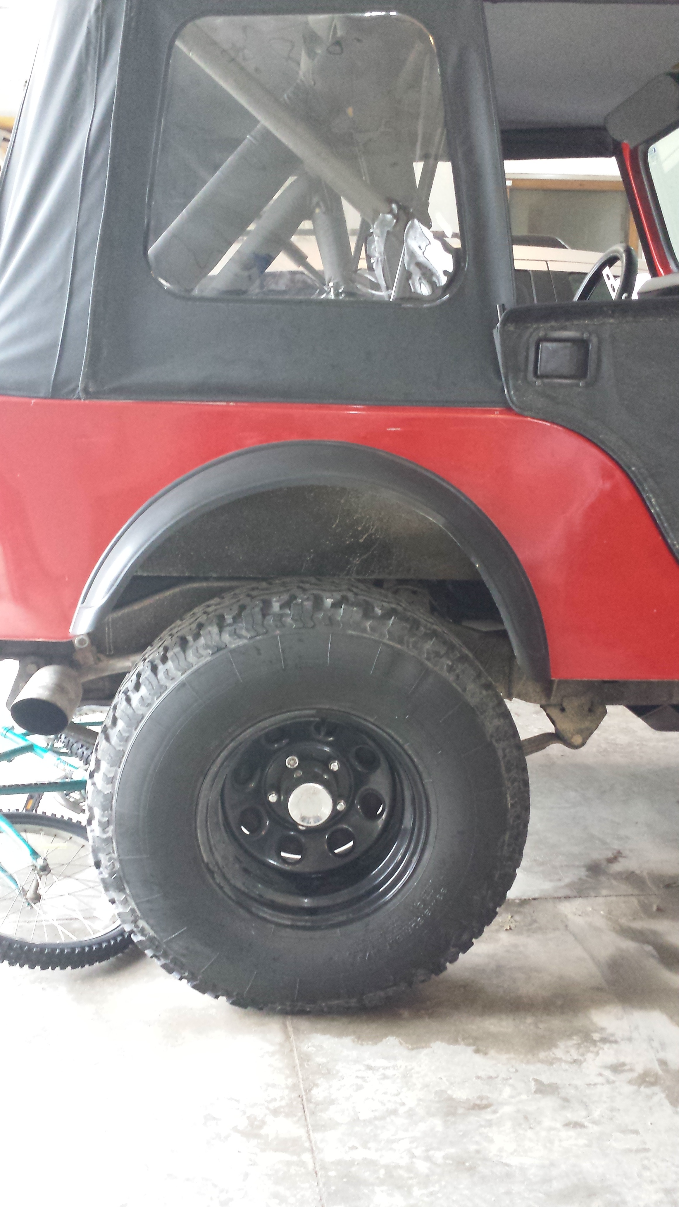

Here is a pic of the rear passenger tire. Tires are 33s and the jeep is a 76 CJ-5

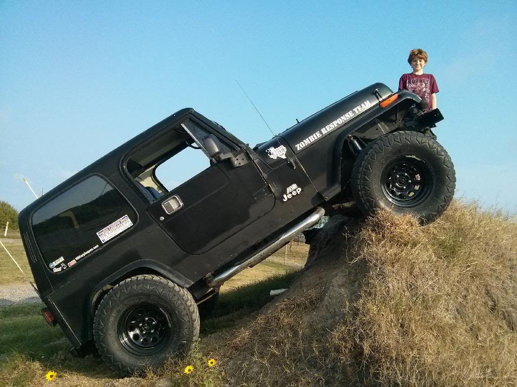

This is 4" lift and 33s on a 76 cj5 parked in front of my 87 yj with 2" lift and street tires
I think J may be right. that just may be a 4" I don think you would have that much clearance between the tire and fender flare with a 2.5 and
33,s
4" is about as high as you can go without getting into a lot more modifications. You might consider a small body lift, 2" or less. Swapping to stock springs and putting the axles beneath the springs (spring over axle conversion) will net about 6" of lift.

No markings on the leaf springs which is where someone else told me to look too. Based on looking at Superj's photo mine sits higher than that so Im guessing a 4 inch lift. It requires my 5'1 frame to jump up into it :) (no complaints there) Now to look for nerf bars to make it easier to get in and out. Thinking about cleaning some old logging trails on the farm I own to make some fun "roads" for the jeep. Have about 200 acres and about 12 miles of logging trails I think I am going to have opened up.
