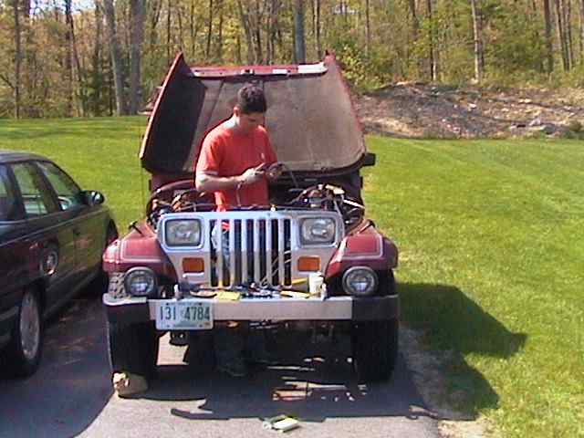

...that was the easiest way to work-on/clean the engine area while I was having it re-built (may03).

LOL. I've worked on my Cherokee while standing IN the engine compartment quite a few times now, just like you are in your photo! It's very do-able when I have the batteries removed from the engine compartment, as there are very few components in there.
It does allow you to see things from a better perspective :mrgreen:

I can stand in my engine bay WITH the engine installed ;) Having an electric fan on the 4banger is nice, I can stand on the front axle between the engine and radiator (18"+) and make working under there a whole lot easier. The old YJ was the same way with the 350.
Again, I'll add a note of caution: DO NOT ATTEMPT WHILE VEHICLE IS IN MOTION!!!!
