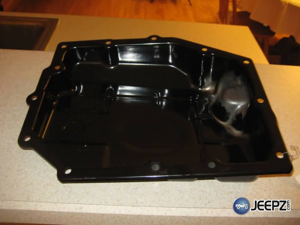

The sensor needs to be welded into your transmission pan - well, more accurately, you weld in what's called a bung (this is like a nut, and has a threaded inside). A hole is drilled in the transmission pan, the bung is then welded over that hole, so that you have a spot where you can screw a sensor (looks like a bolt) into the transmission pan.
The thought of drilling and welding my only transmission pan made me nervous. I was able to pick up a new pan off of ebay for only $45, so I went with that. I took it to my local metal shop, and had them weld on the bung.
Here are some shots of the new Wrangler transmission pan

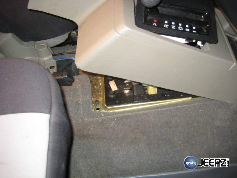

I removed the old transmission pan and installed the new one - changing the fluid and filter along the way (take a look at my Wrangler fluid change article here: http://www.jeepz.com/forum/drivetra...tomatic-transmission-fluid-filter-change.html ), After the new pan was in place, I pried up my center console and ran some wires through the console area under the Jeep).
Here are shots of the center console popped up with wires (through a grommet) to the underside of the Jeep.

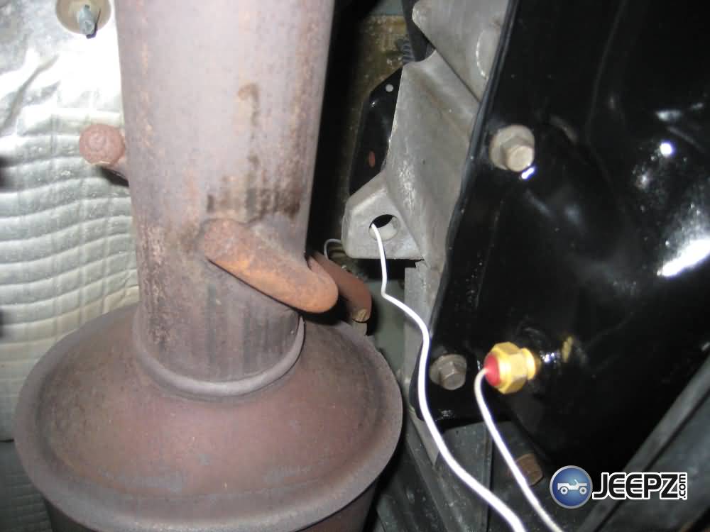

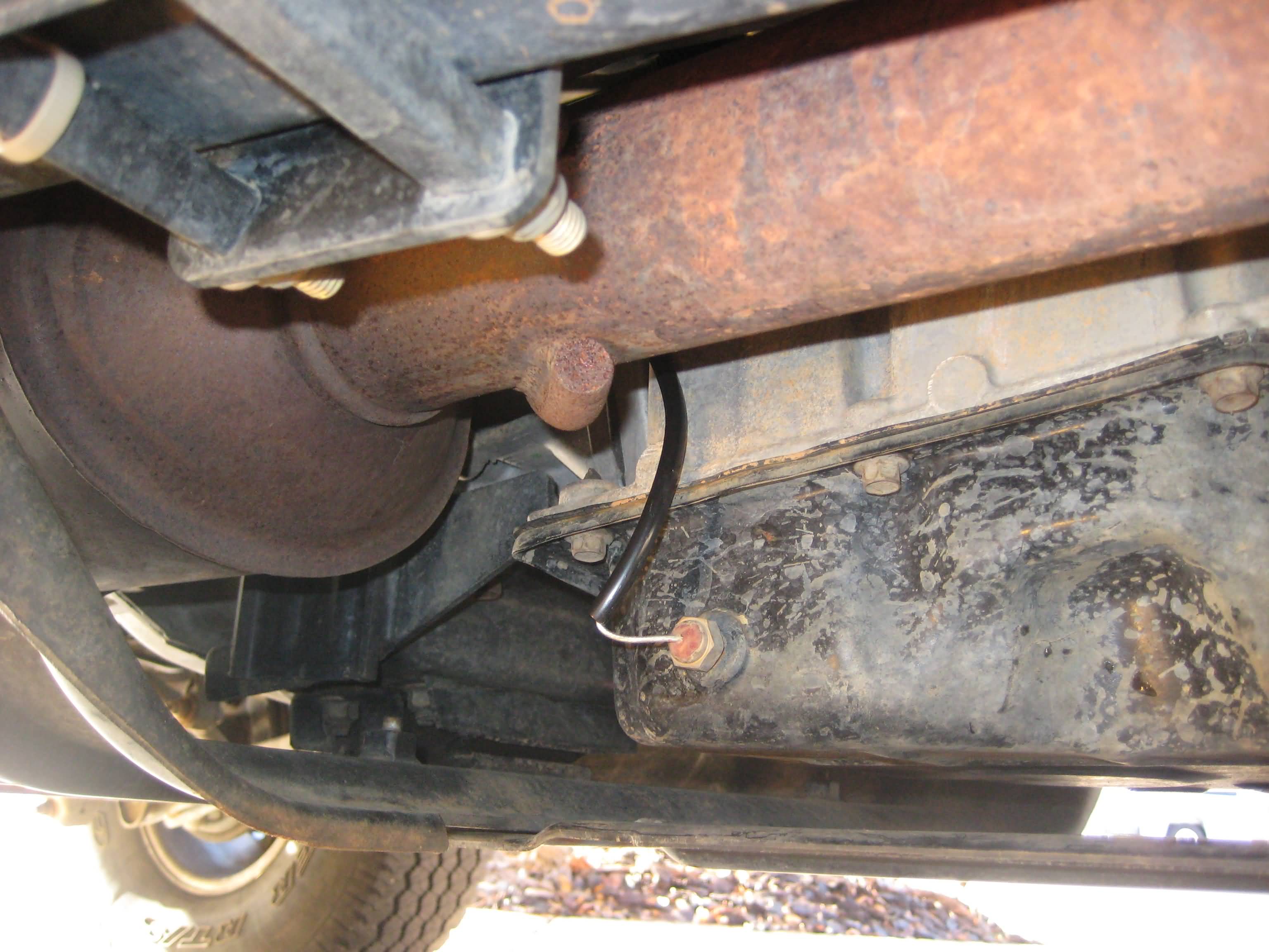

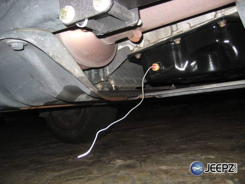

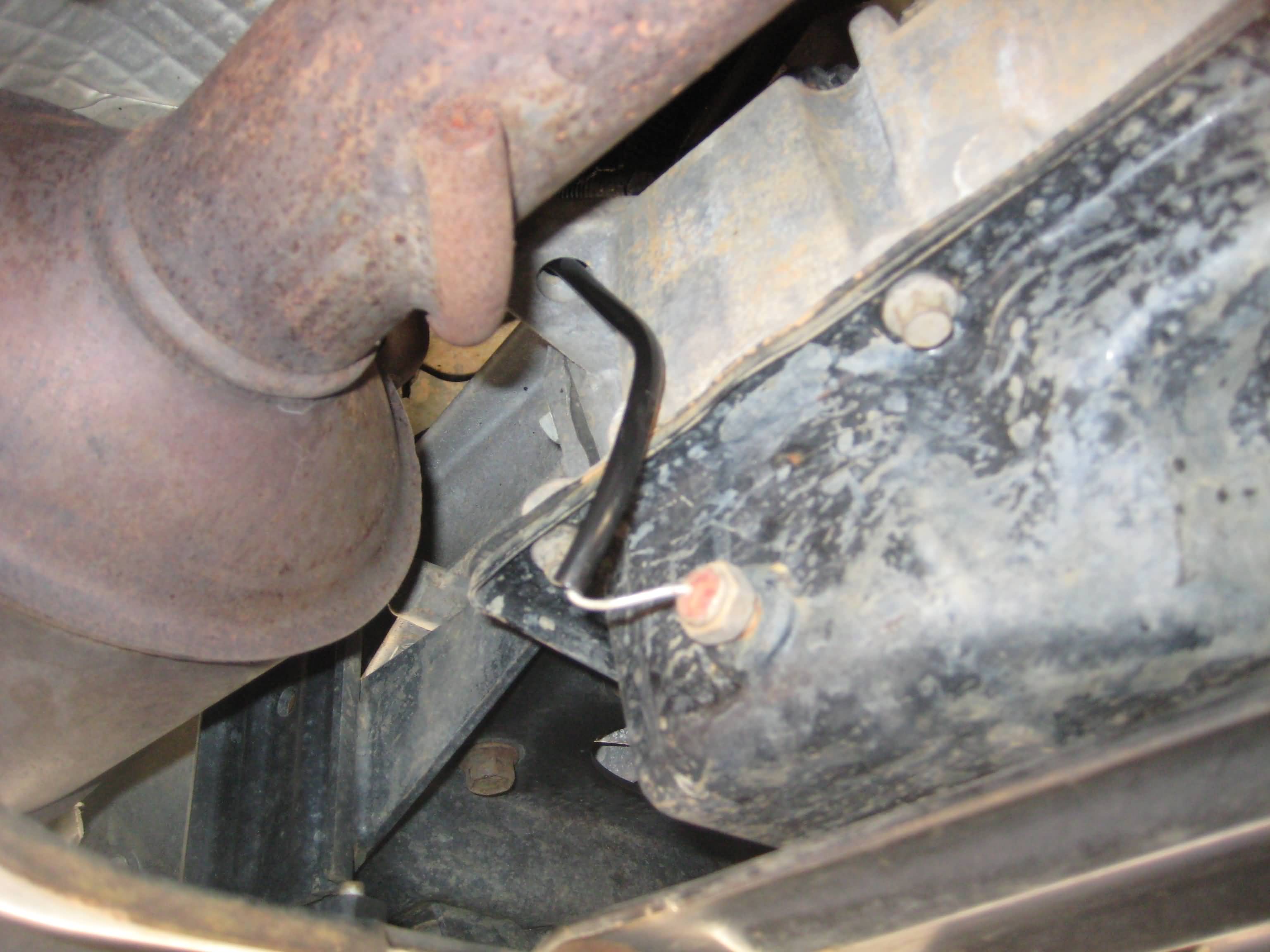

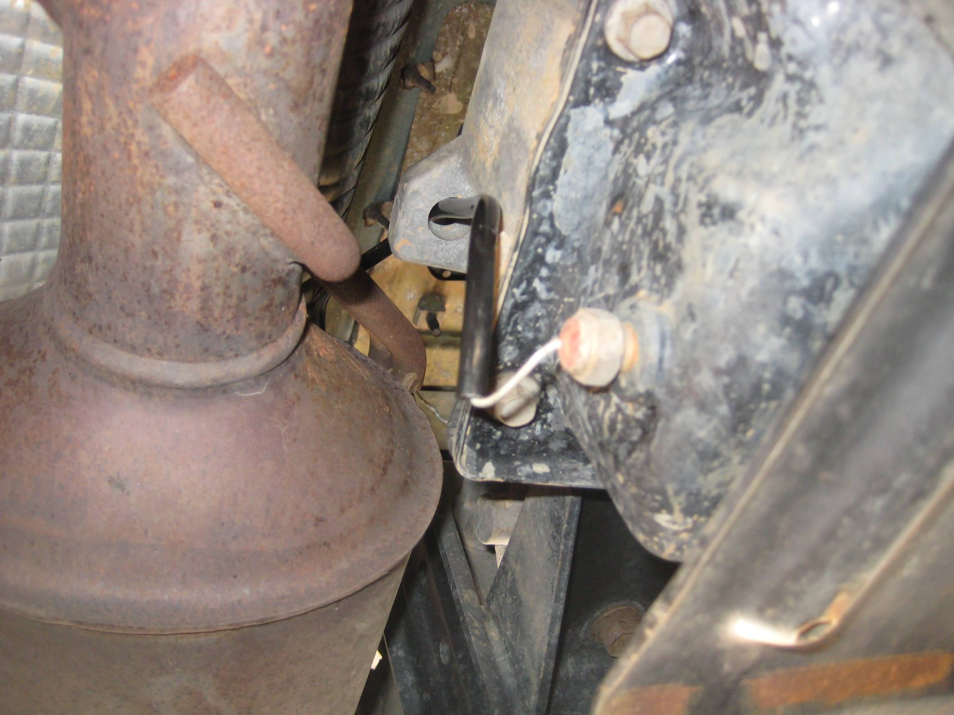

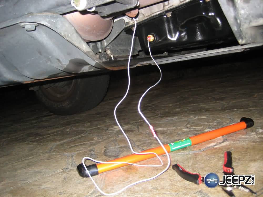

Next I climbed under the Jeep and wired up the sensor. You'll want to wrap the wire in some heat insulating material - I slid on some high temp vacuum line that protects the line from heat.

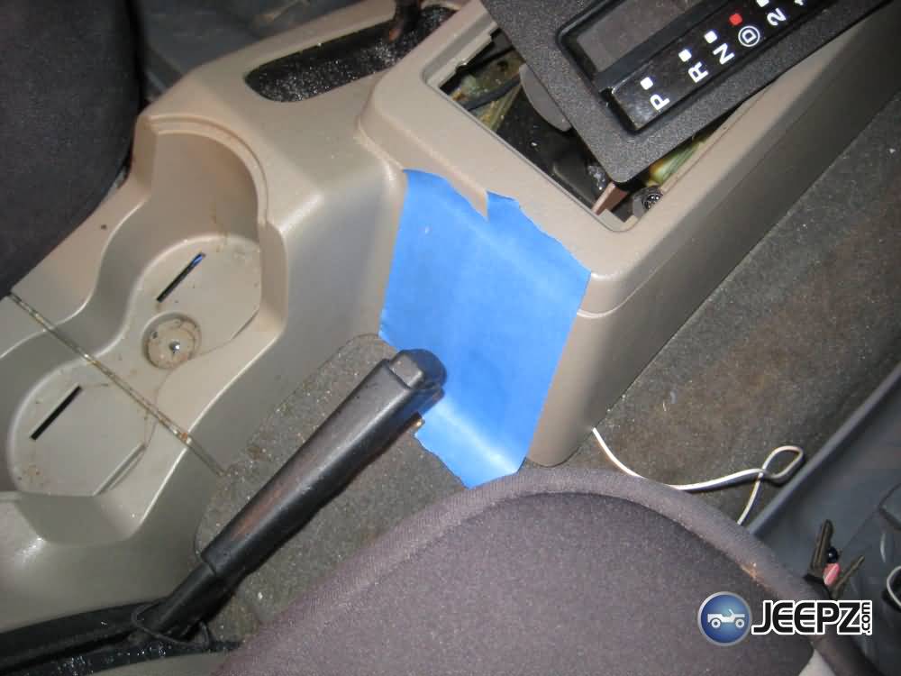

Next I prepped the console in order to drill the gauge hole. I used a hole saw (a large drill bit designed to make holes) for the mounting hole, but before drilling, I taped over the area. This helps prevent extra knicks and marks.
