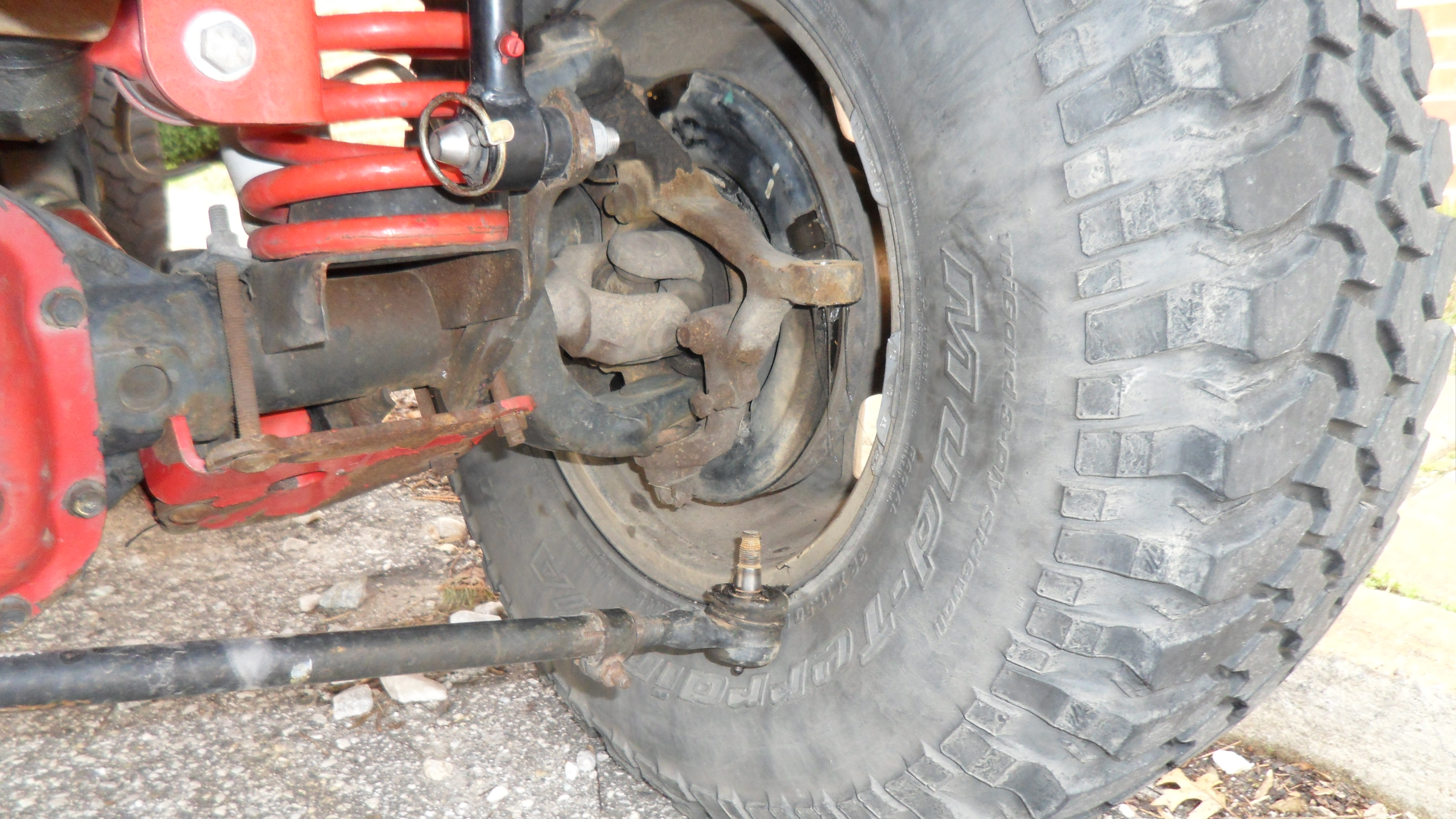

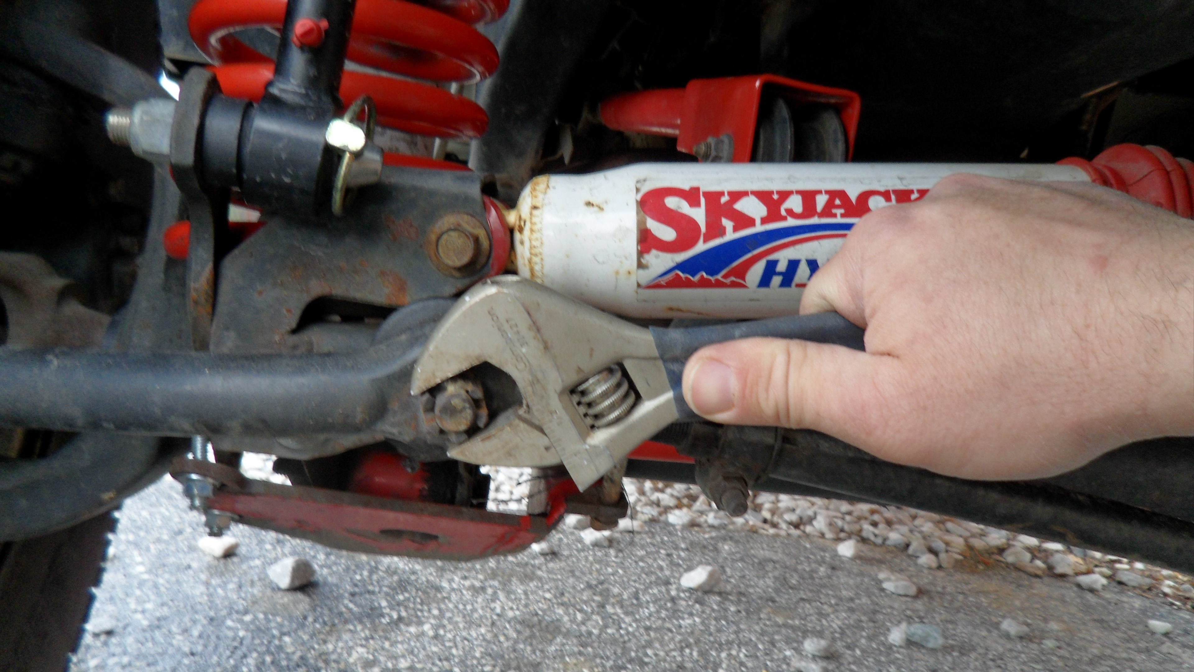

The next step is to remove the stock (in this case damaged) tie rod. To begin, start by removing the cotter pin from the bolt attaching the tie rod end to the driver's side steering knuckle. Then using either a wrench or a 19mm socket, remove the nut from the tie rod end.

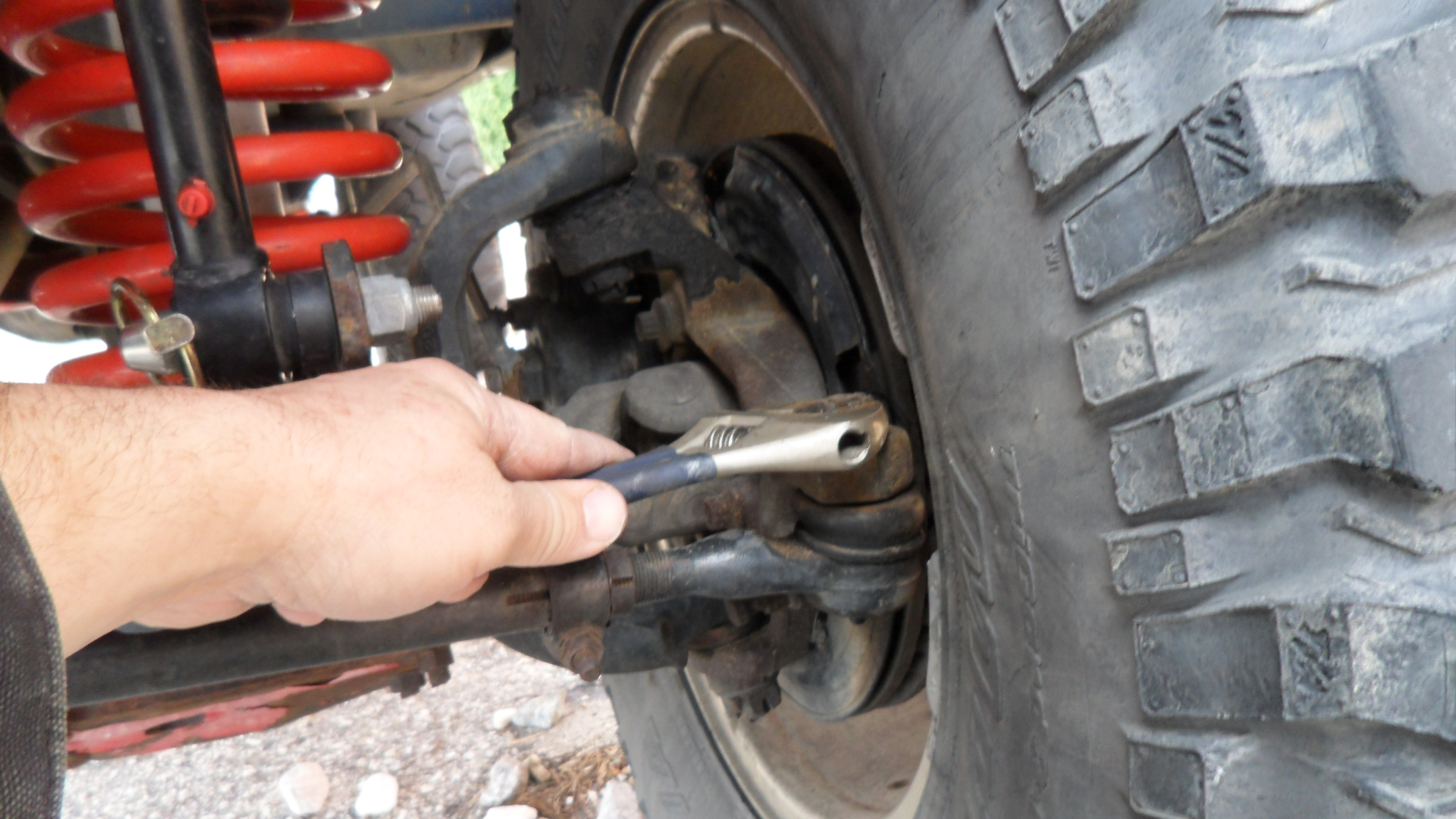

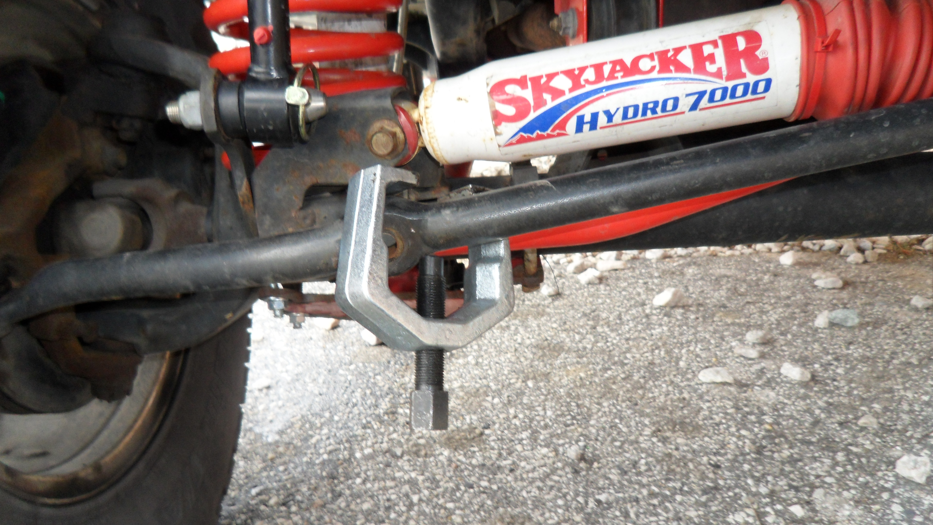

Next, you need to pop the tie rod off the steering knuckle. If you have a puller you can fit in there, now would be the time to use it. My puller wouldn't fit in the tight space between the wheel and the brake, so I used a pickle fork. Place it like so and give it a few hard whacks with a hammer to break the ball joint loose.

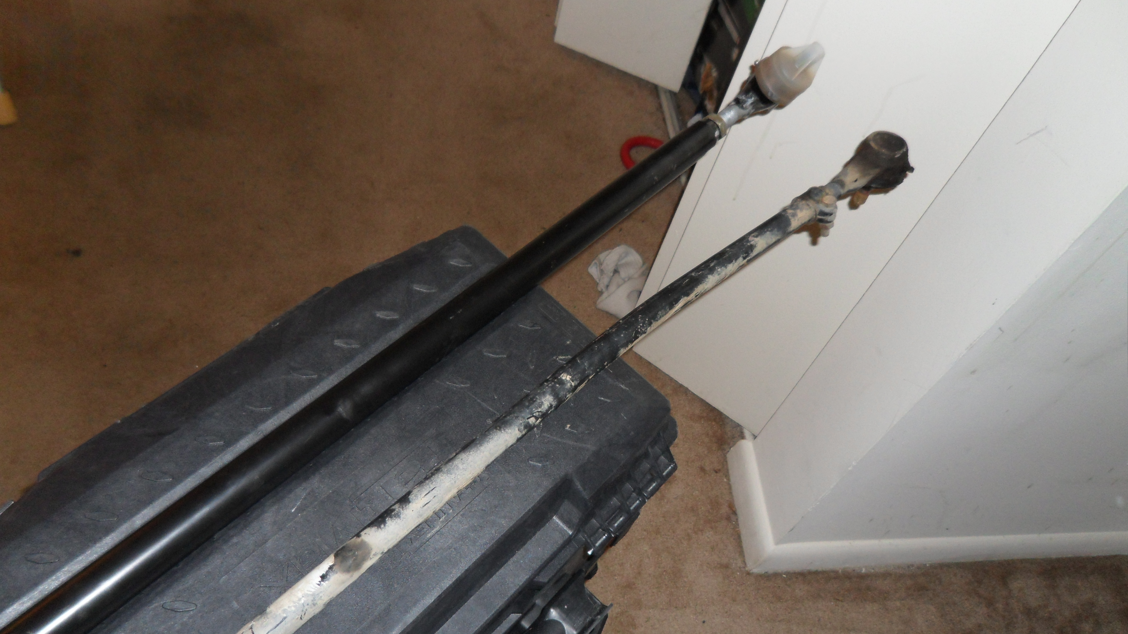

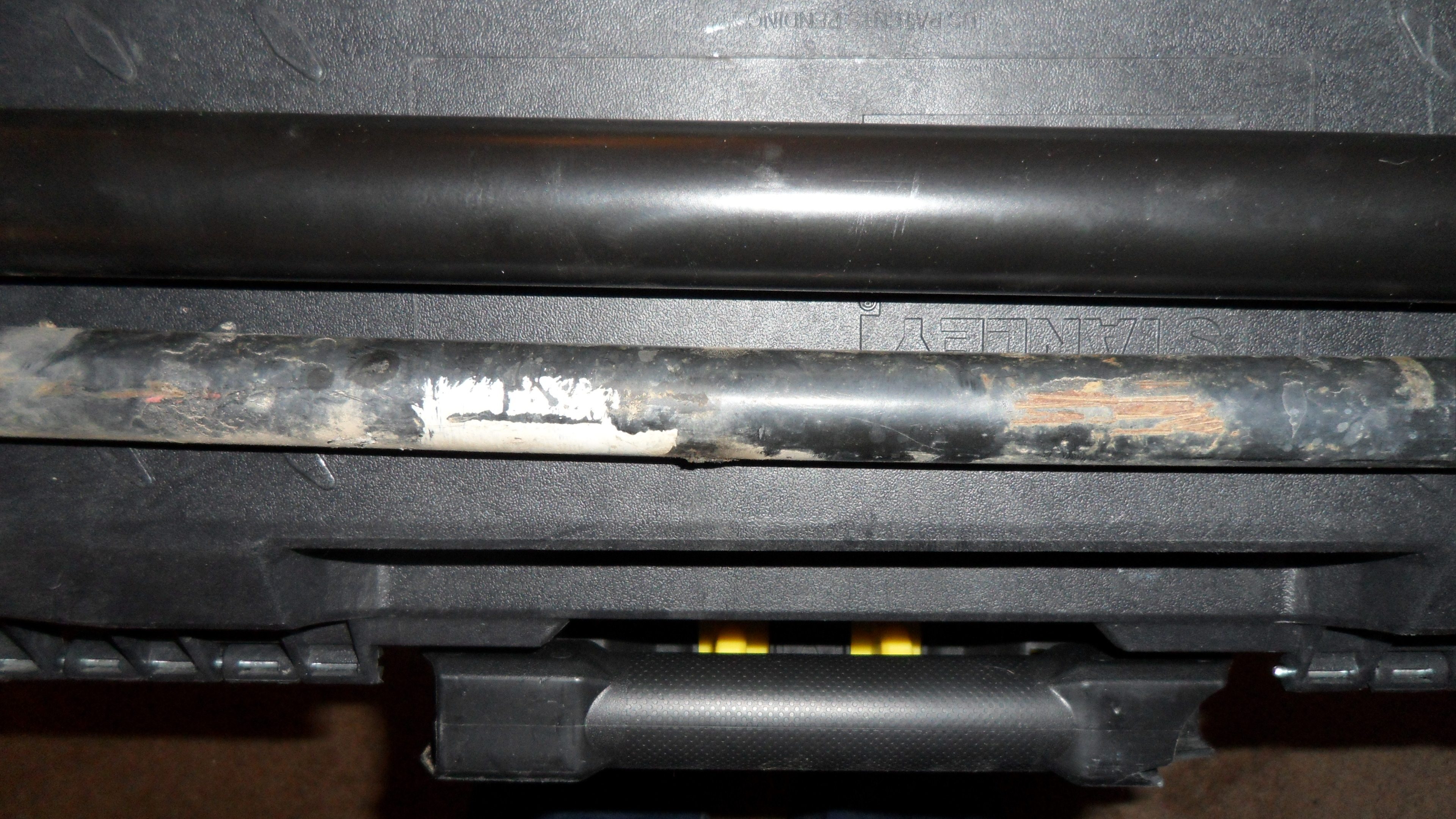

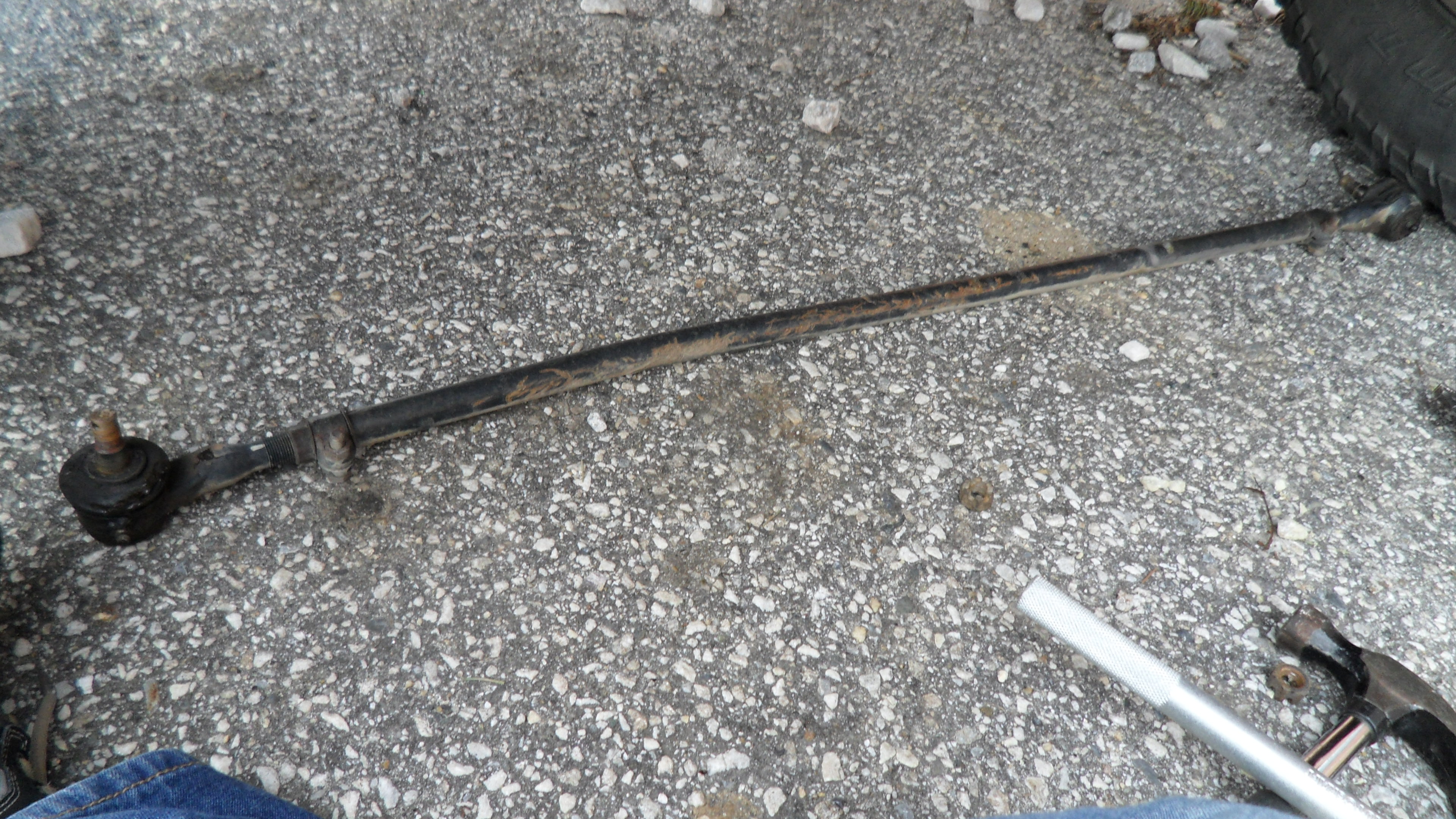

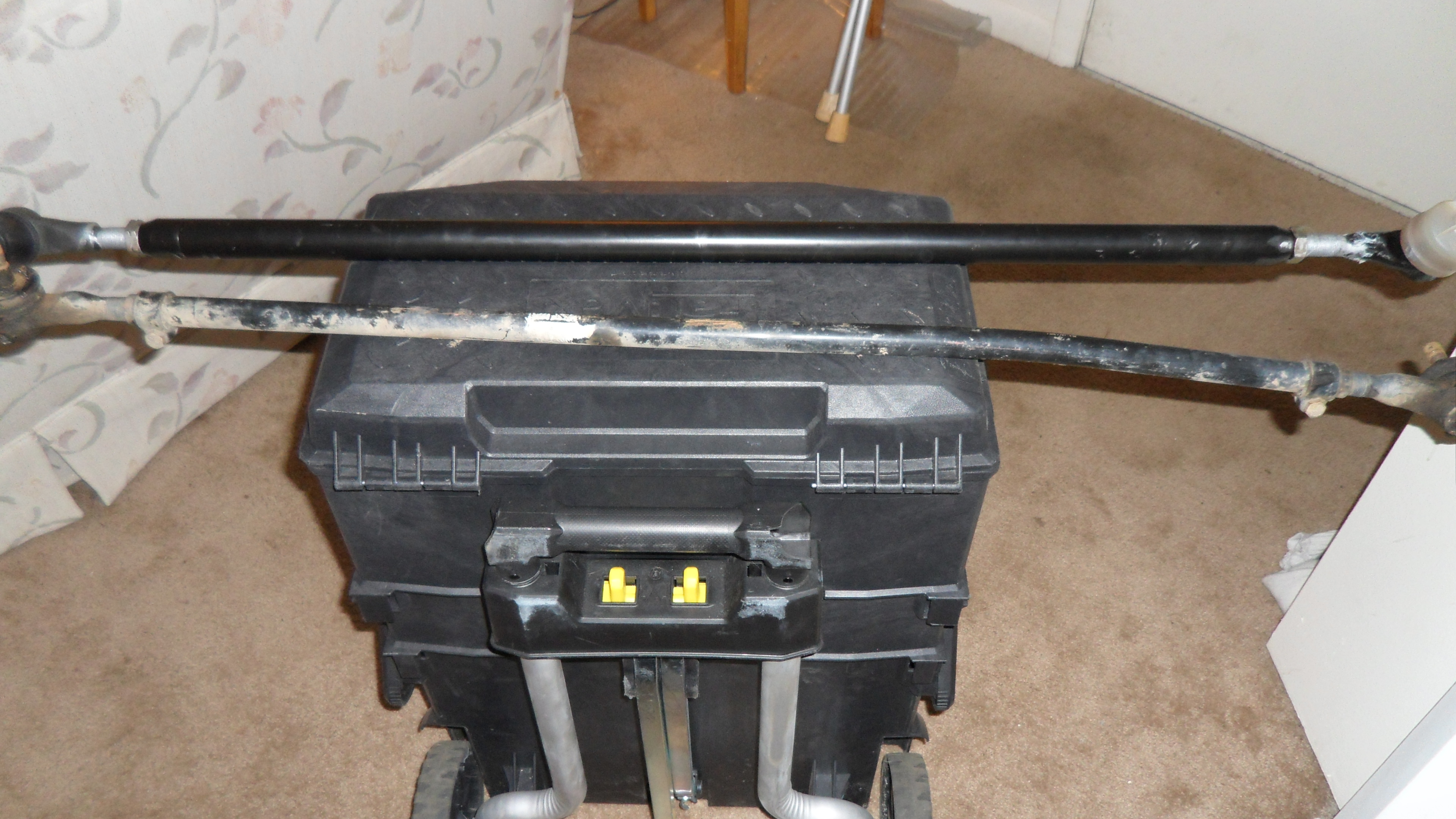

Here are some comparison shots to show you the difference between the stock and Big Daddy tie rods, and also the bend in the stock tie rod.

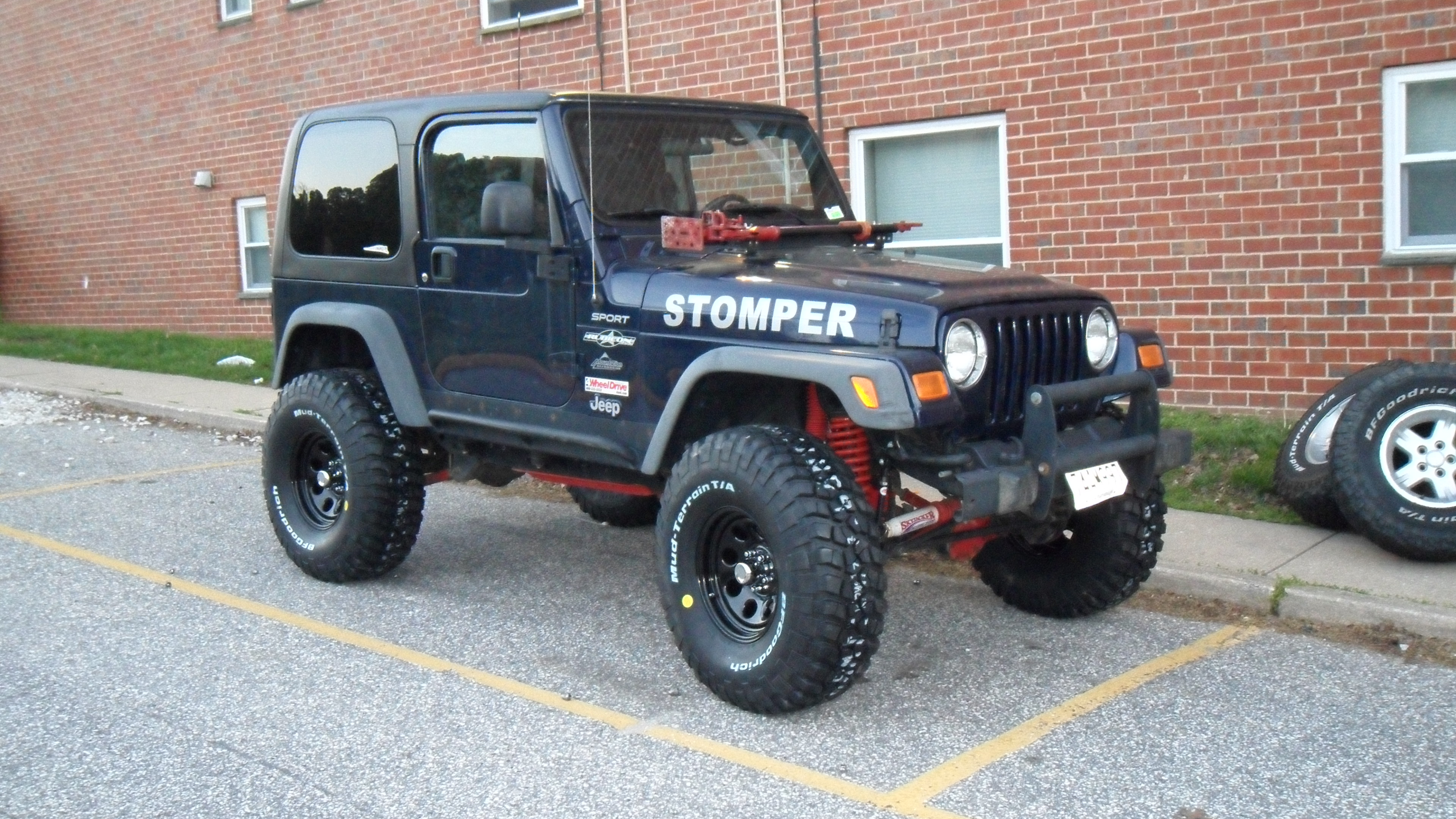

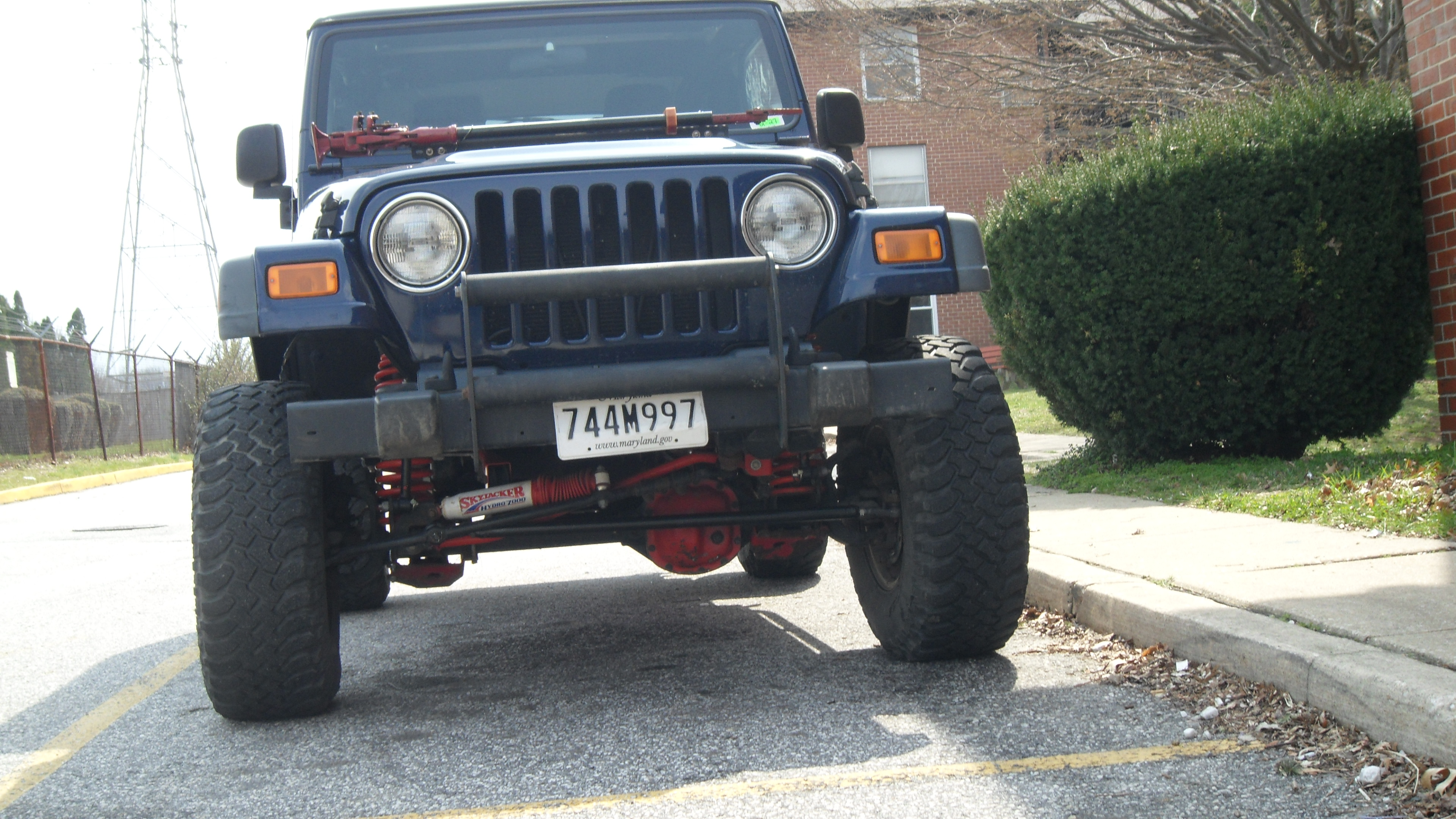

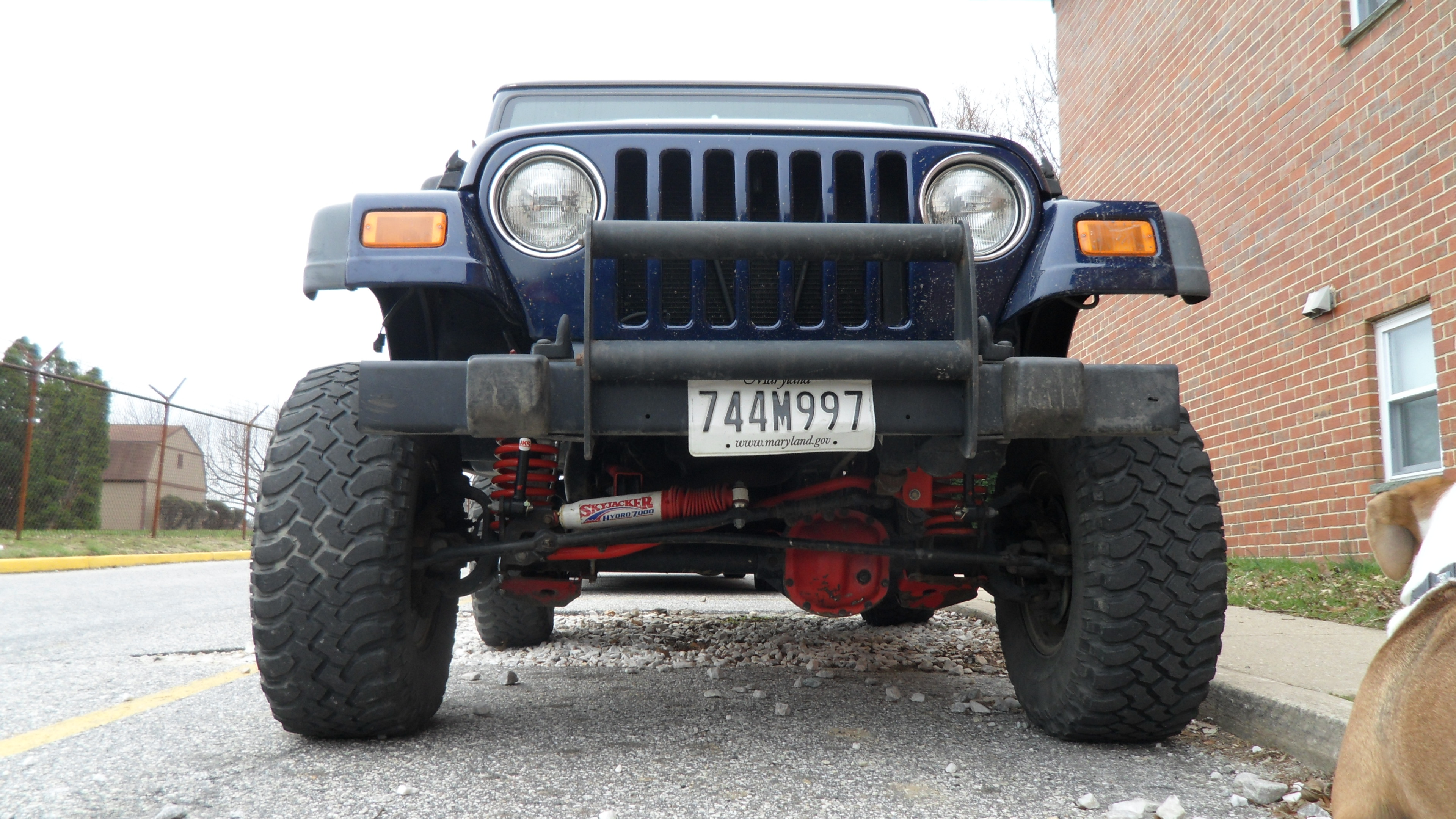

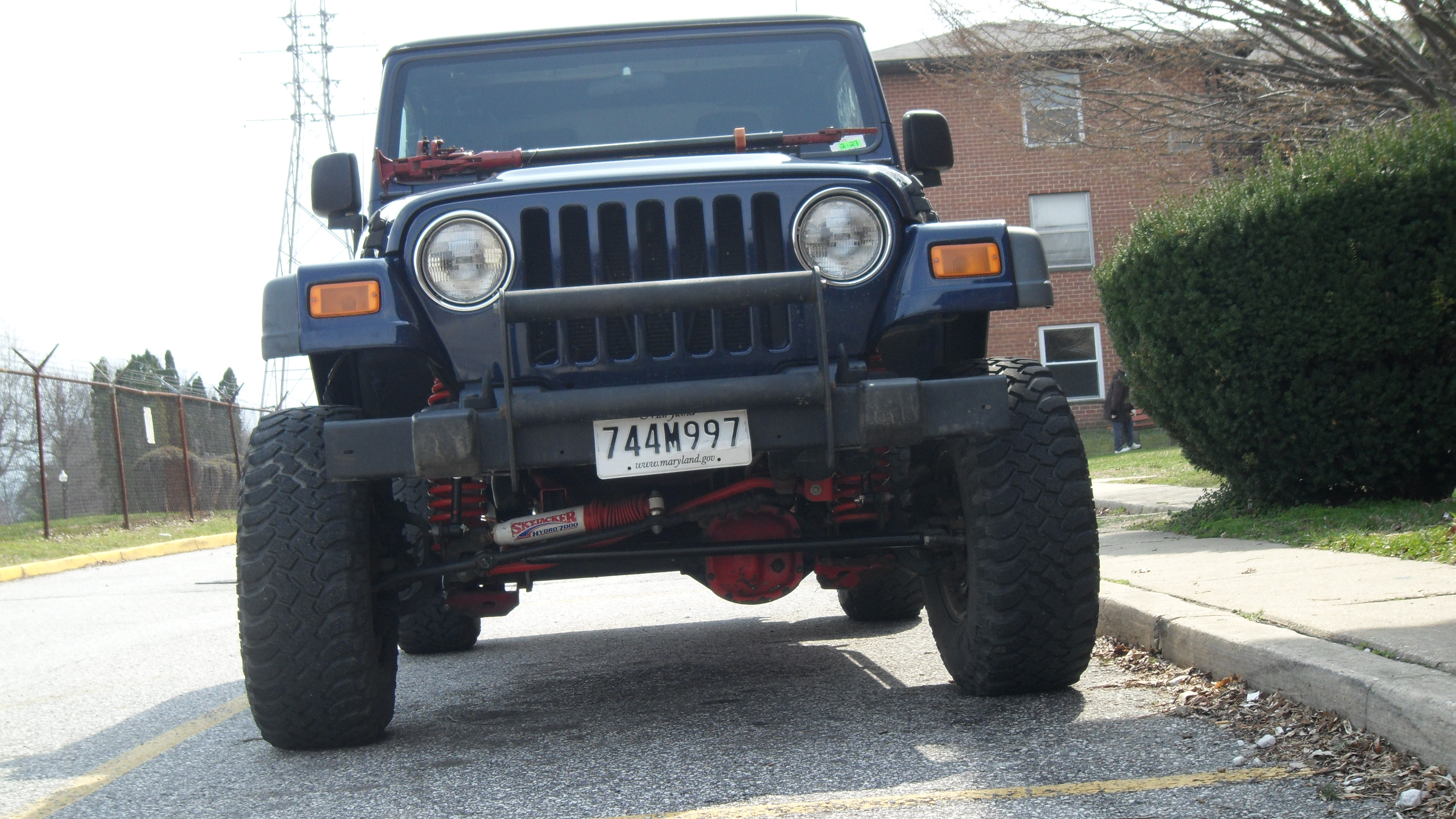

Here are some before and after pictures (alignment coming tomorrow).

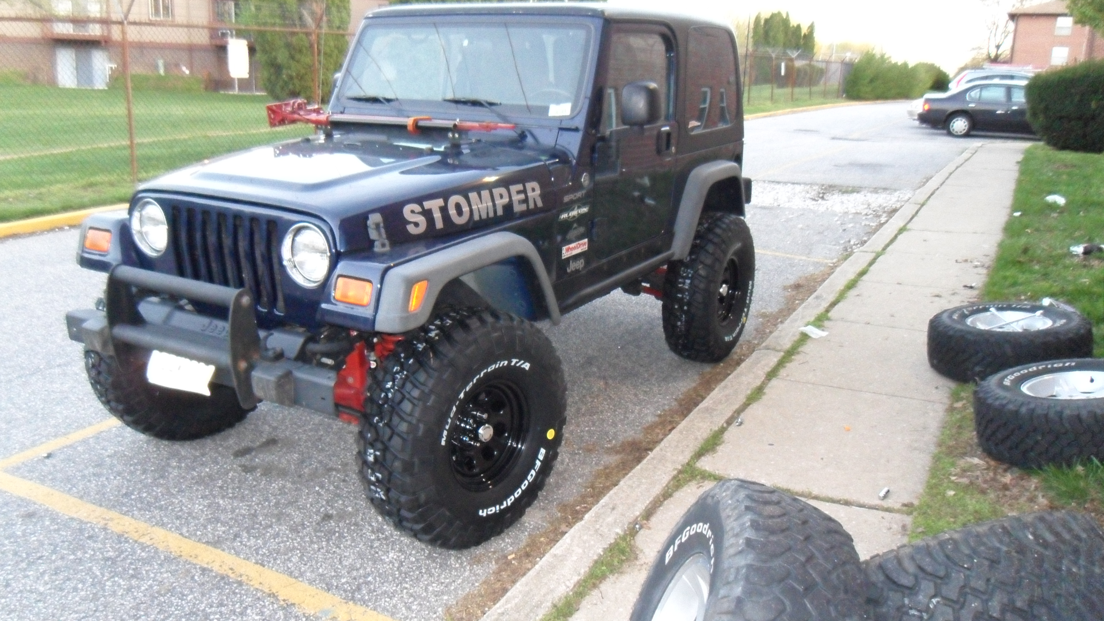

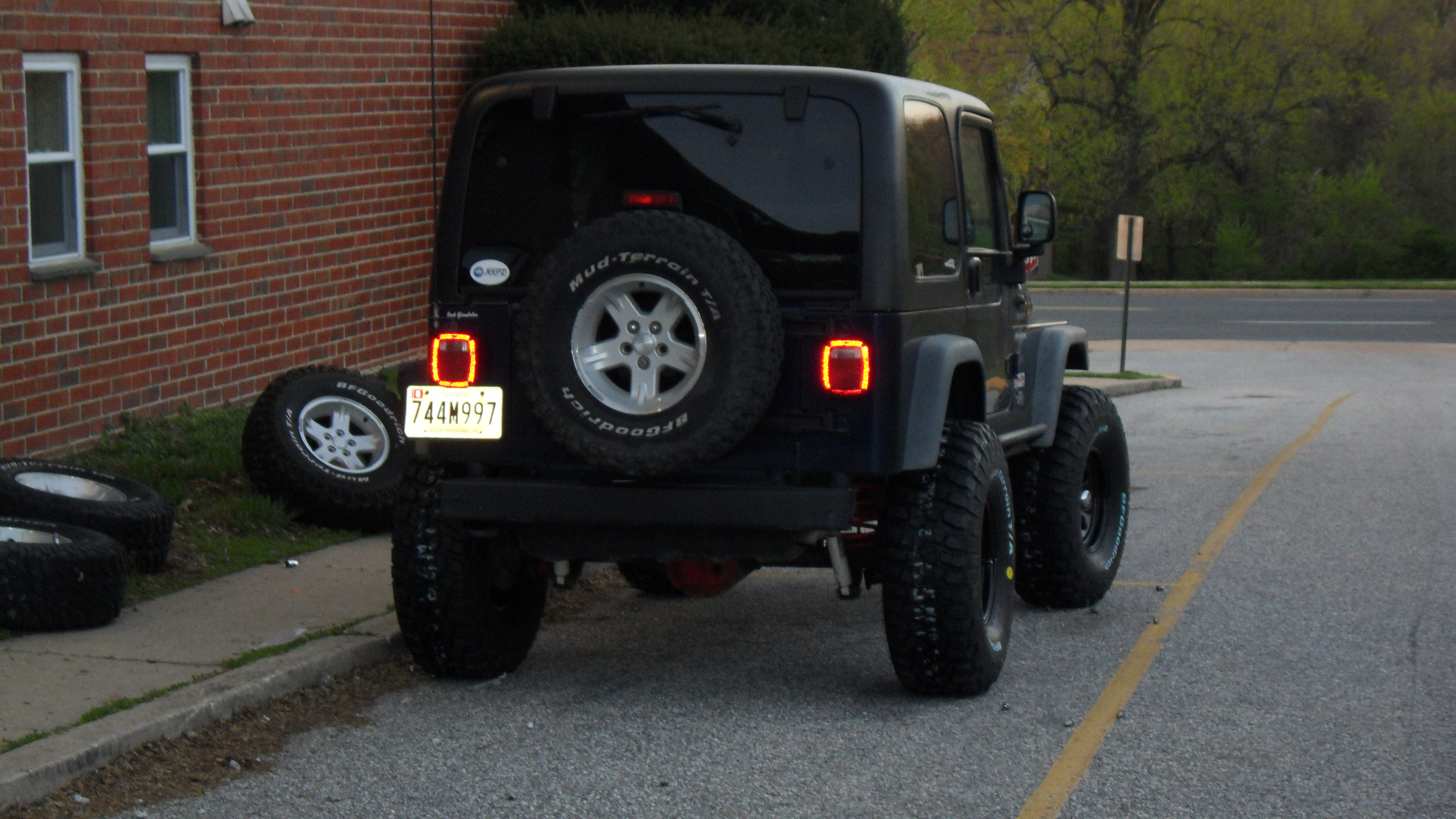

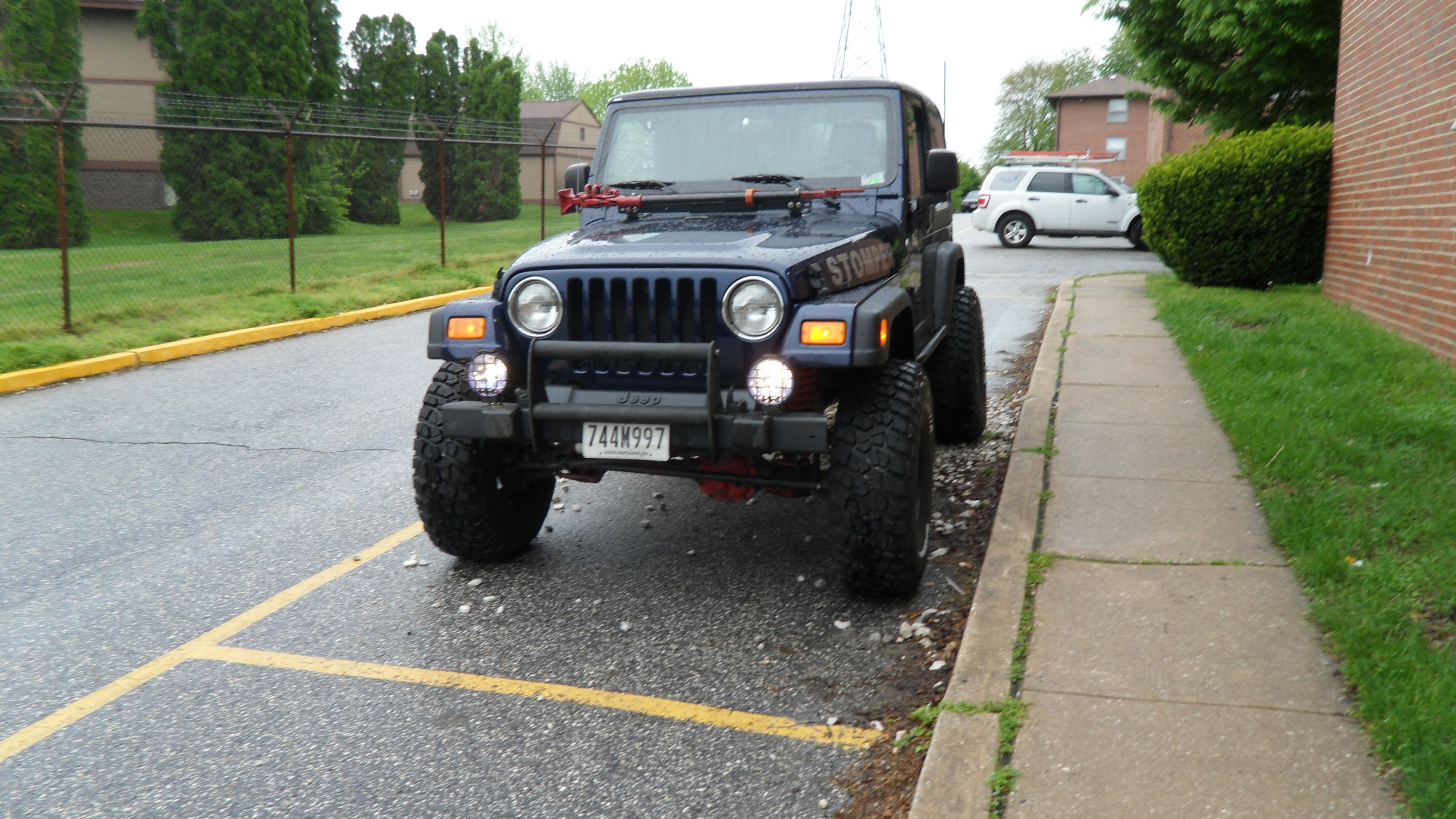

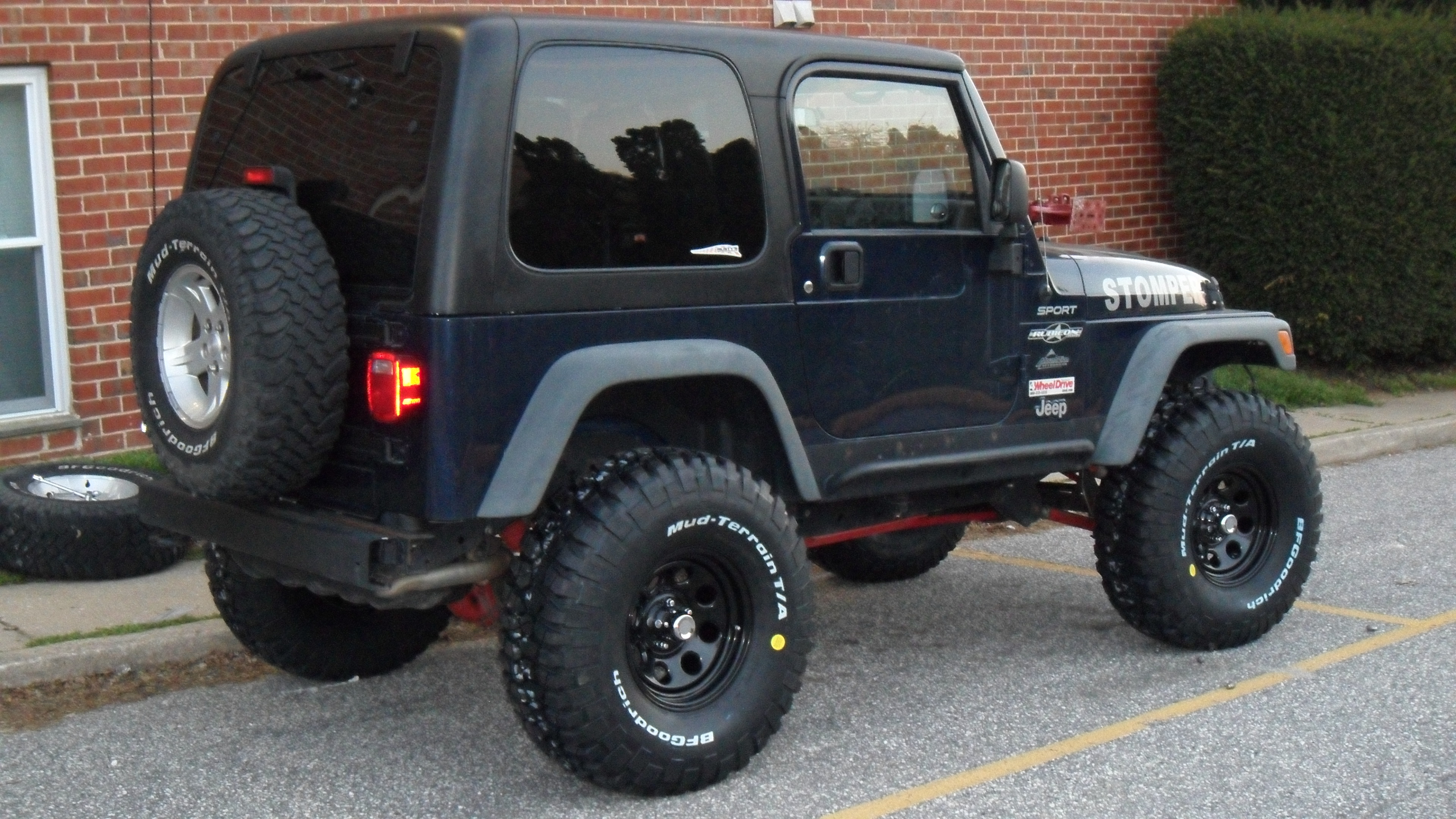

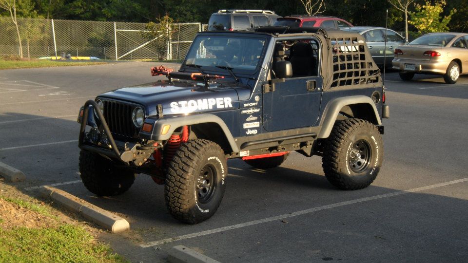

Today my TJ grew up. 35" tires + Unique Soft 8s.

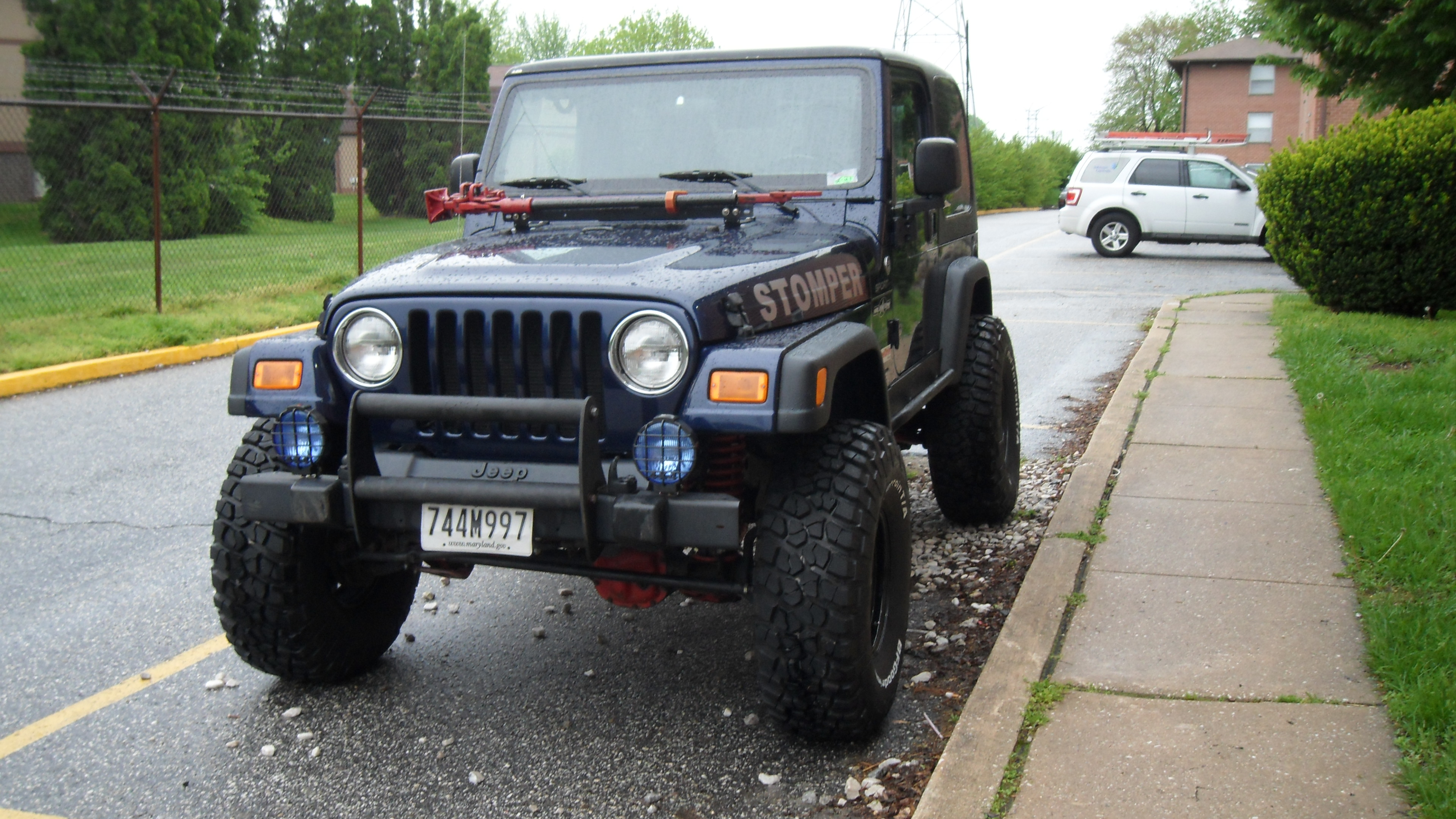

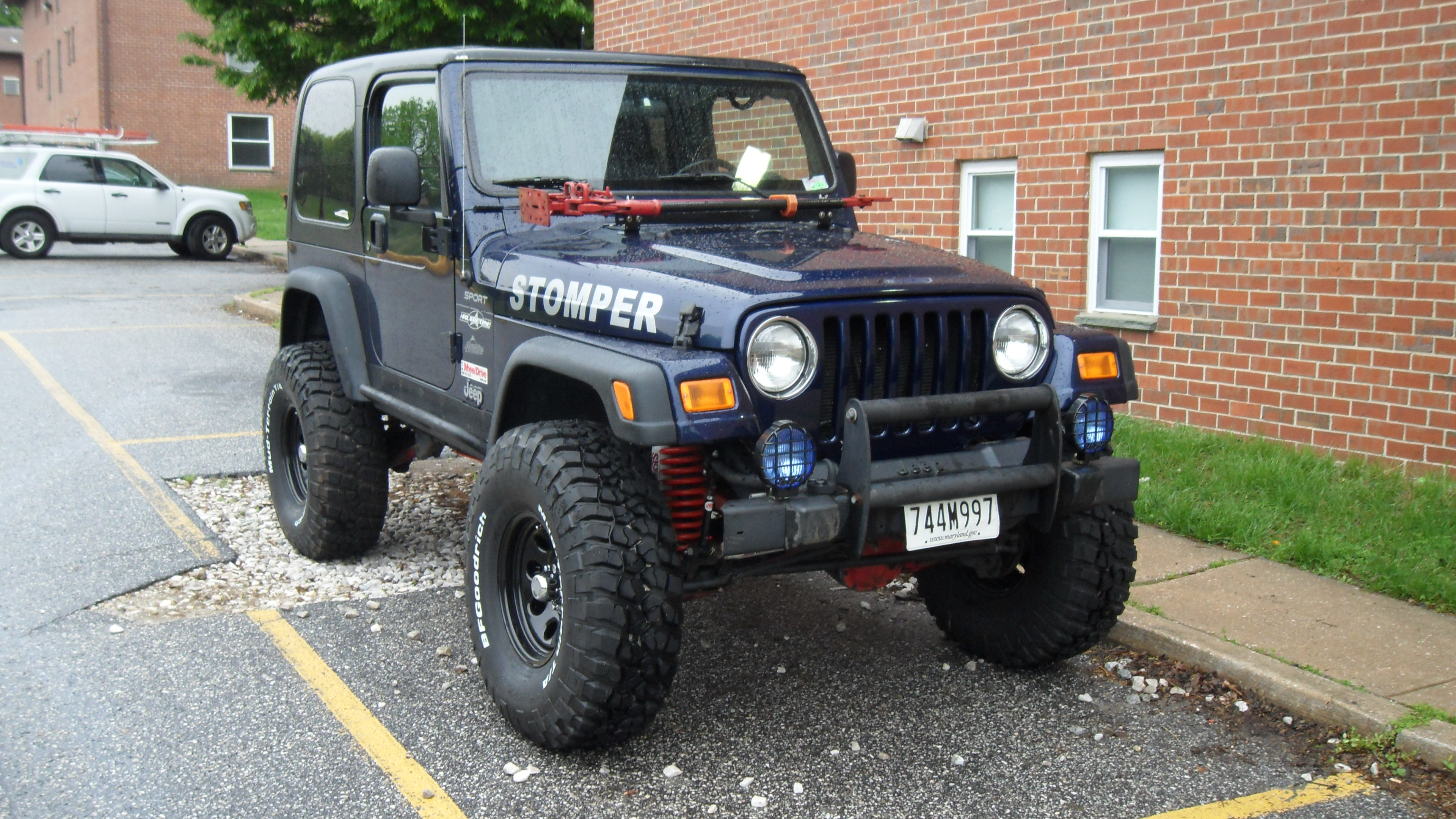

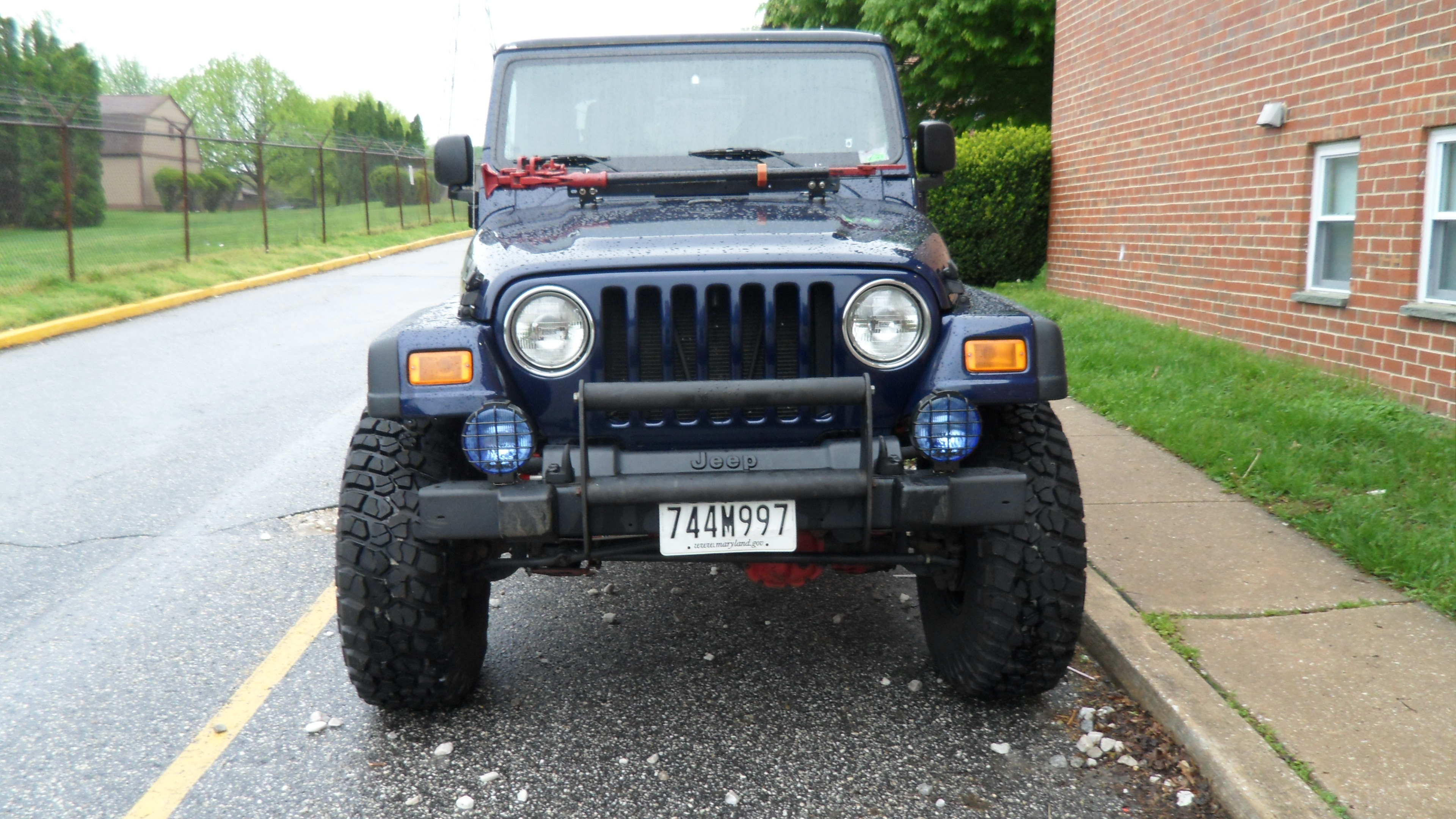

I used to have the factory fog lights on my TJ, until somebody was walking through the parking lot at my apartment complex and apparently decided to break one of them off.
I've been wanting to replace the fog lights. I went to Crazy Ray's junkyard this morning in search of a new factory fog light. Thousands of cars, but only four "Jeeps" (lots of XJ/WJ's, but I'm talking about "Jeep" Jeeps). They had one TJ that had been rolled, it was pretty much stripped clean. Right across from it was a YJ that had what looked like a Renegade body kit on it. In the same general area was a DJ (who knows how it ended up there). Lastly, on the other side of the yard I found a '76 CJ hiding behind some other cars. That was it for Jeeps. So, I decided to go the aftermarket route. They work just as good and look similar, so they work for me.

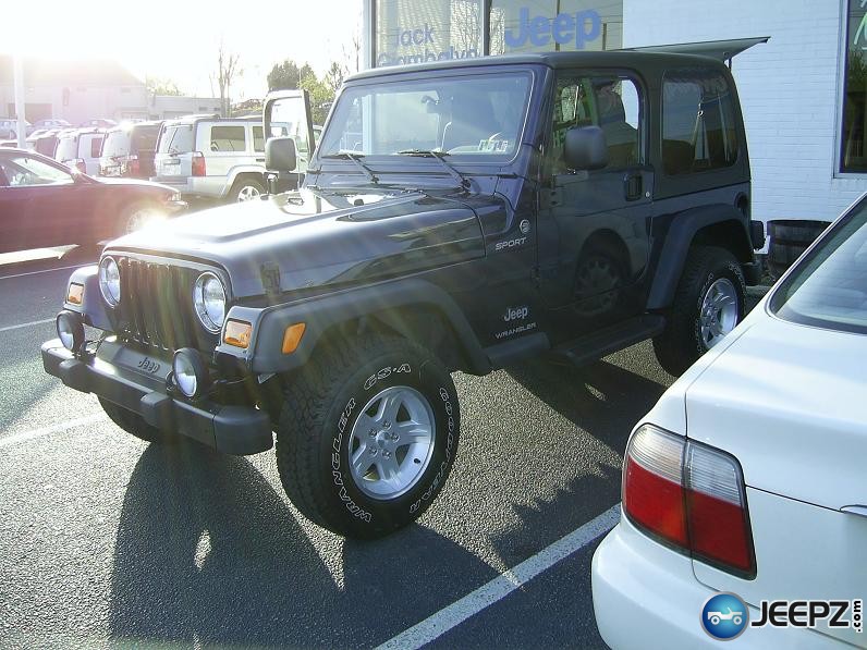

Just for fun, here's a shot of my TJ when I picked it up at the dealership.

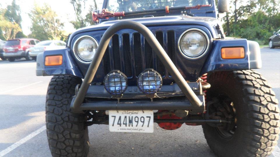

First of all, bought a stinger bumper off of craigslist for $50. It was used. I was told it was an old Smittybilt design. I custom fabbed up a plate to mount the fog lights on.
