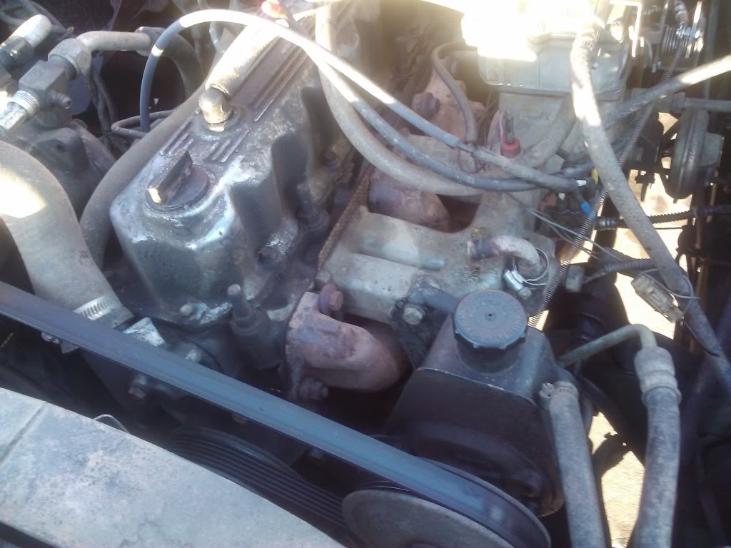

i pop the hood and find that smaller diameter hose from the thermostat housing to the intake is torn at the clamp, like it was on too tight. so i tell my son to start the jeep and roll it up while i put .75 cents (what a damn rip off, .75 cents for about 4 minutes of water at a dribble) in the machine and put the tip in the radiator. i filled hte radiator back up and Jason told me the temps were down to where they normally were at so i told him to kill it so i can fix the hose.

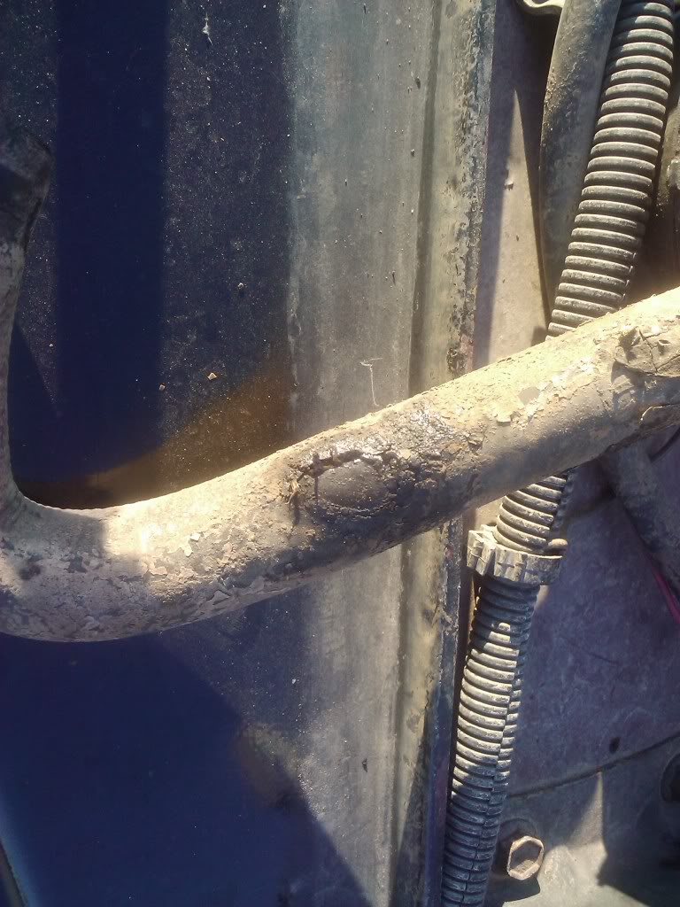

i pull the hose off and trim that first 1" off and put it back on and Jason starts it again while i watch the radiator (had hte cap off still). suddenly water is spraying from the dang hose again so i look a bit closer and realize whoever put this engine together failed to put that piece of abrasion protection around the hose and it has worn through at the point where it rubs on the valve cover :x.

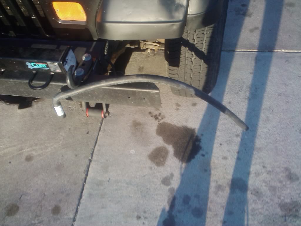

we get back and the jeep is not vandalized, so i am happy , and we pop the hood and take the old hose, lay it next to the super sized new one, and cut to size. this time though, we cut the old hose and put it around the new hose at the point of abrasion, like should have been there to begin with. :x
and install it on the jeep again. now, another dang .75 cents for stupid valero's dribble of gas :x and rev the engine a bit to remove air and make sure no little other leaks and we are heading home :shades: for the evening.

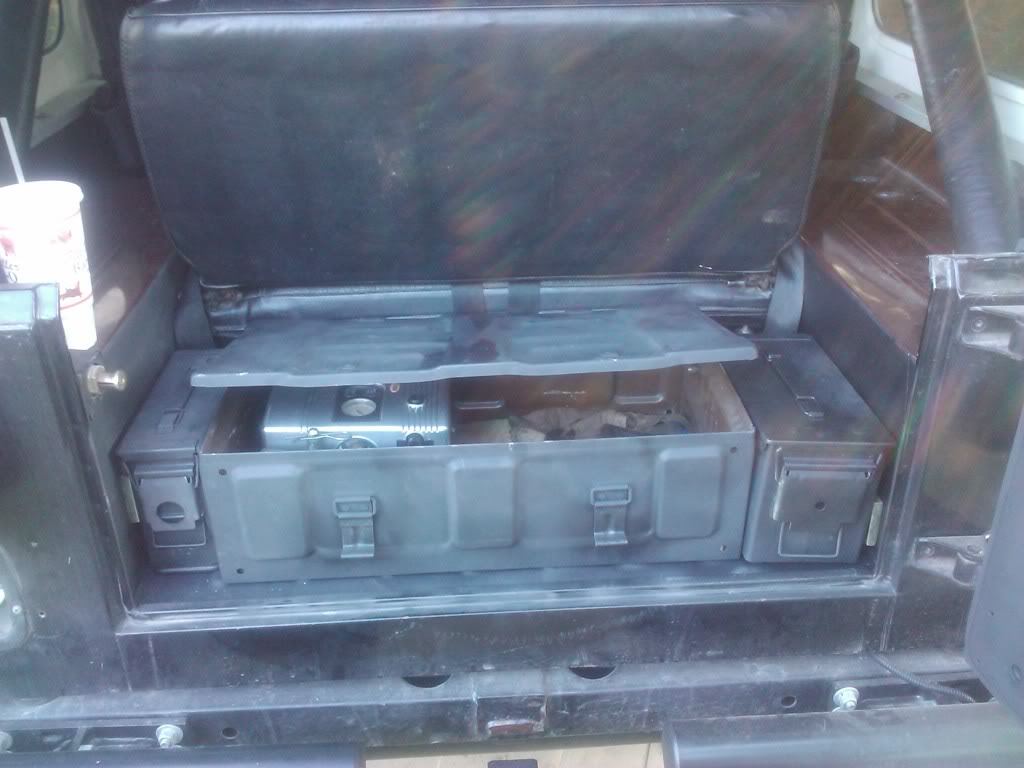

well, that was my first break down in the old 87 wrangler. it never got past the half on the gauge and we took care of the issue with a fairly long jog/walk and luckily we have tools in the ammo can in back,
or we would probably had to wait for hte espousa to get us the stuff and run it out to where we would've been horribly bored.
