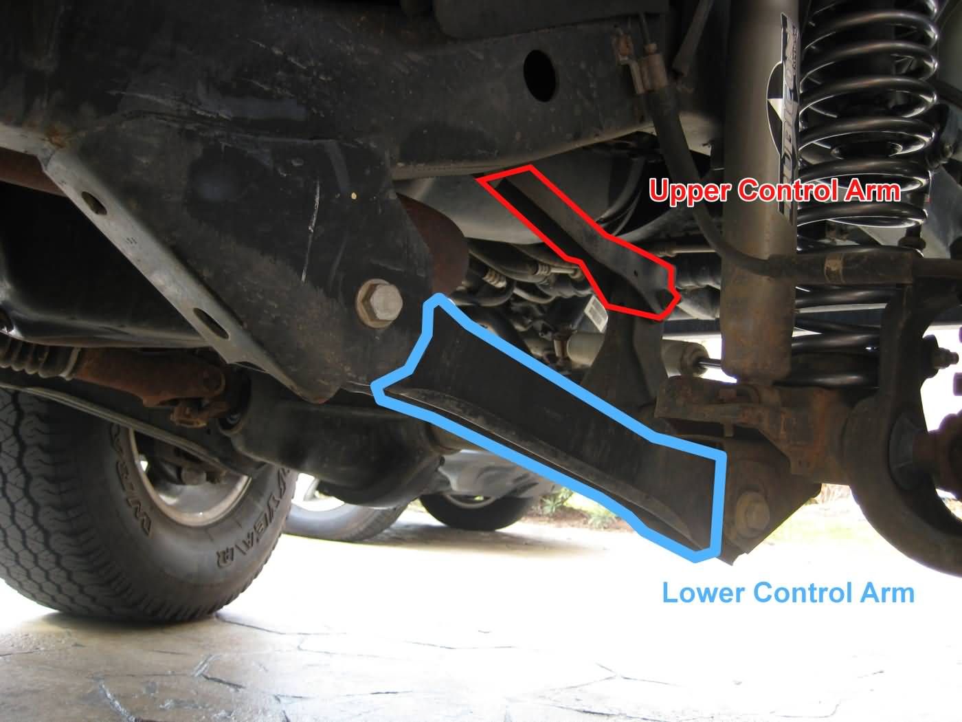

The most common reason to install new control arms is to help restore proper suspension geometry after installing a lift. When you install longer springs on your Jeep, the axle is pushed downward, away from the body of the Jeep. Since the lower control arm is a fixed length, it is forced down, and back towards the body of the Jeep. This is like the hands of a clock - when the minute hand is at :20 it's farther to the right than when it moves down to :25. So, to restore the proper axle position (and caster) we'll need to lengthen the lower control arms.

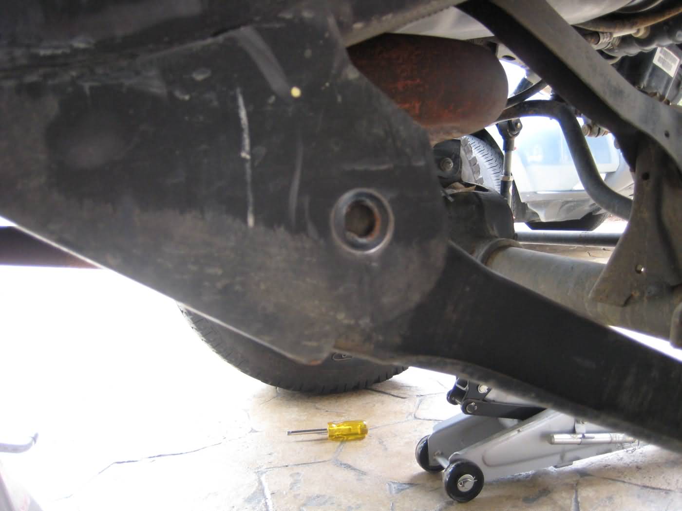

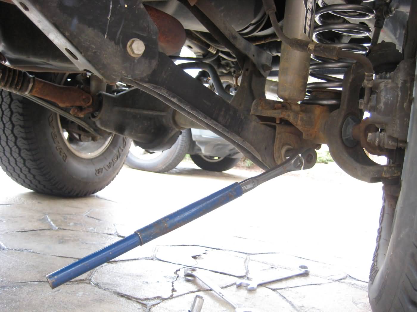

In this photo you can see the stock upper and lower control arms. We'll be unbolting the bolts on each end of the lower control arm, and just replacing it. That's it - two bolts per arm.
Stock Wrangler control arms

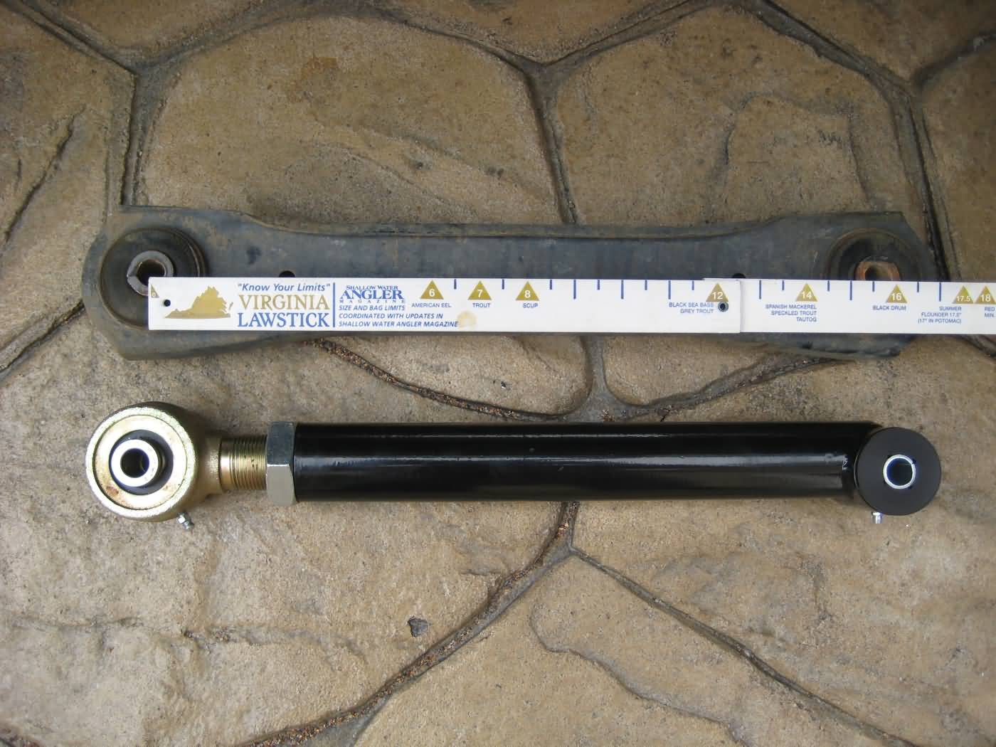

You can see the stock lower control arm below - it's just a thin piece of metal , more than enough to handle the front to back forces that are exerted on it during daily driving, but not so much when it comes to any side to side pressure (i.e. rockcrawling).

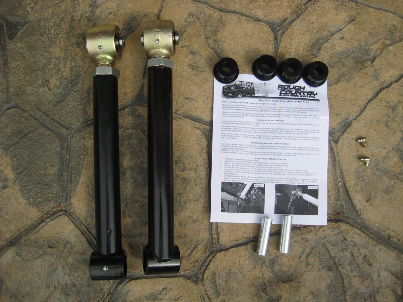

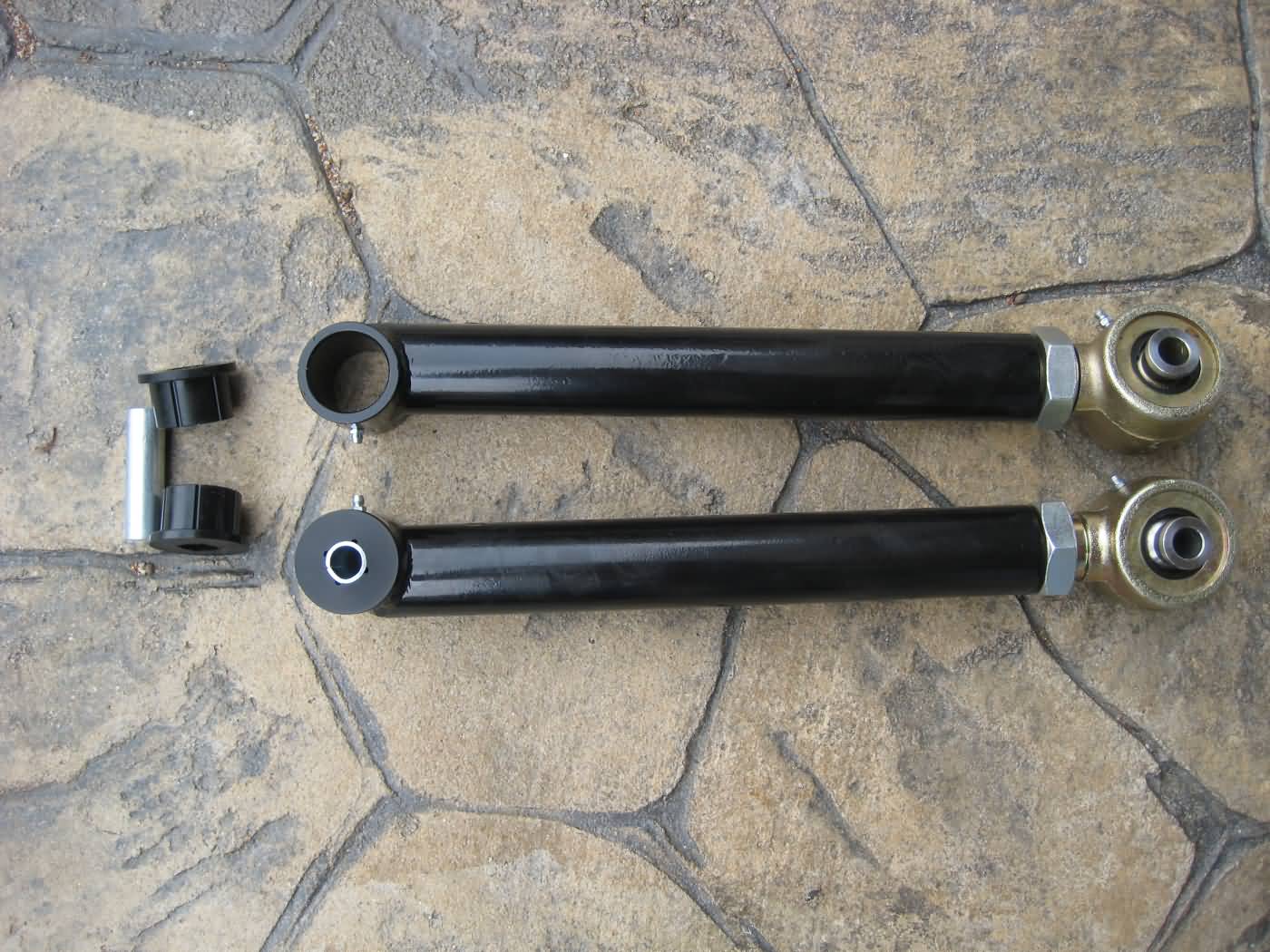

New lower control arms
These are my new Rough Country X-Flex lower control arms - they are considerably stronger than stock and include flex joints, polyurethane bushings, sleeves, and grease fittings. These allow for some side to side movement of the axle.

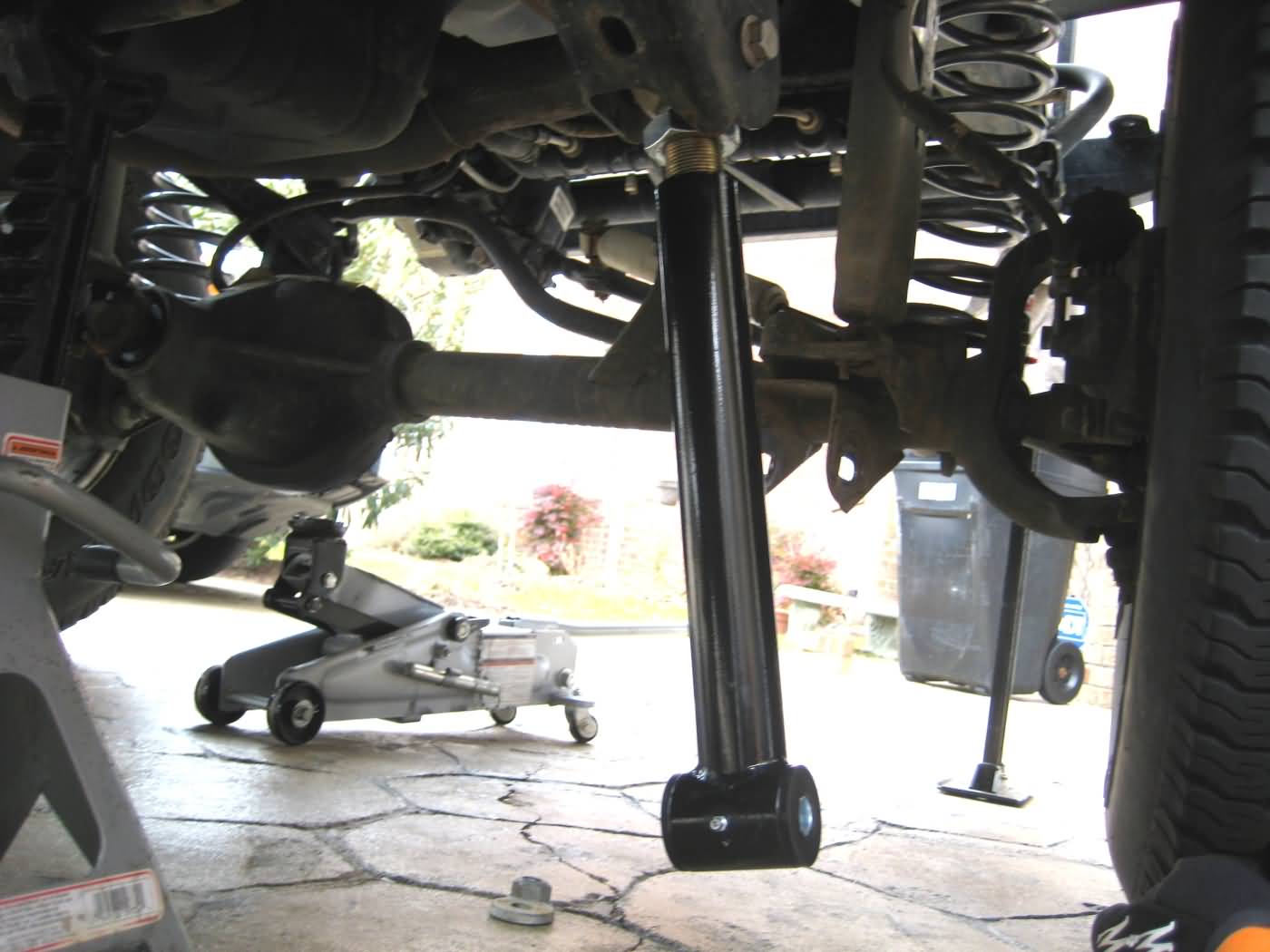

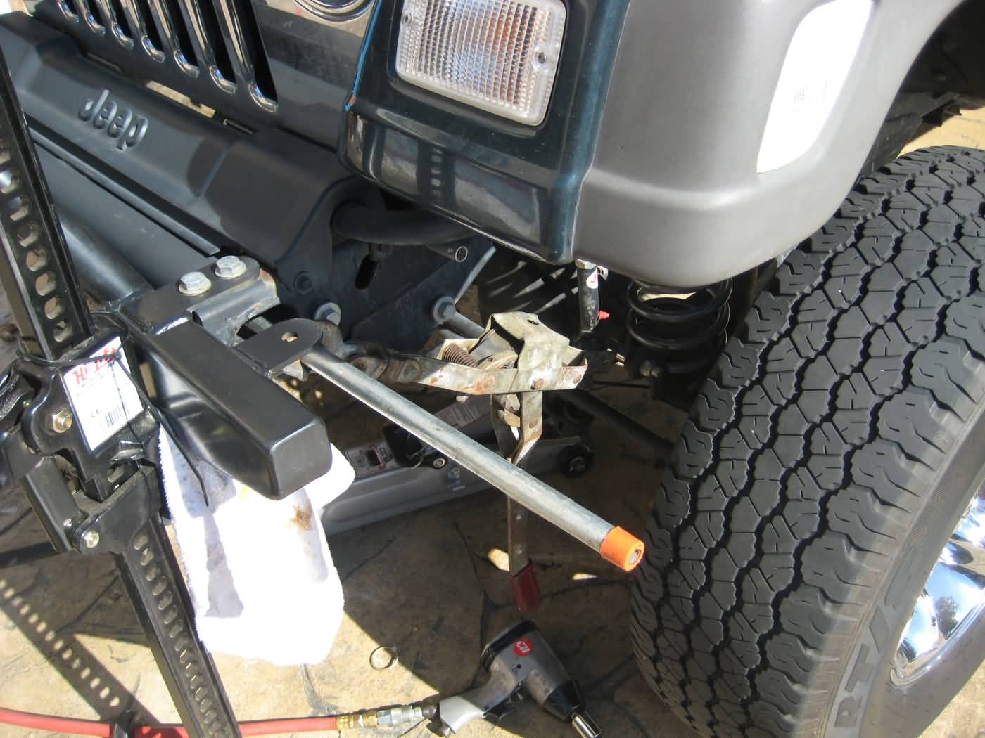

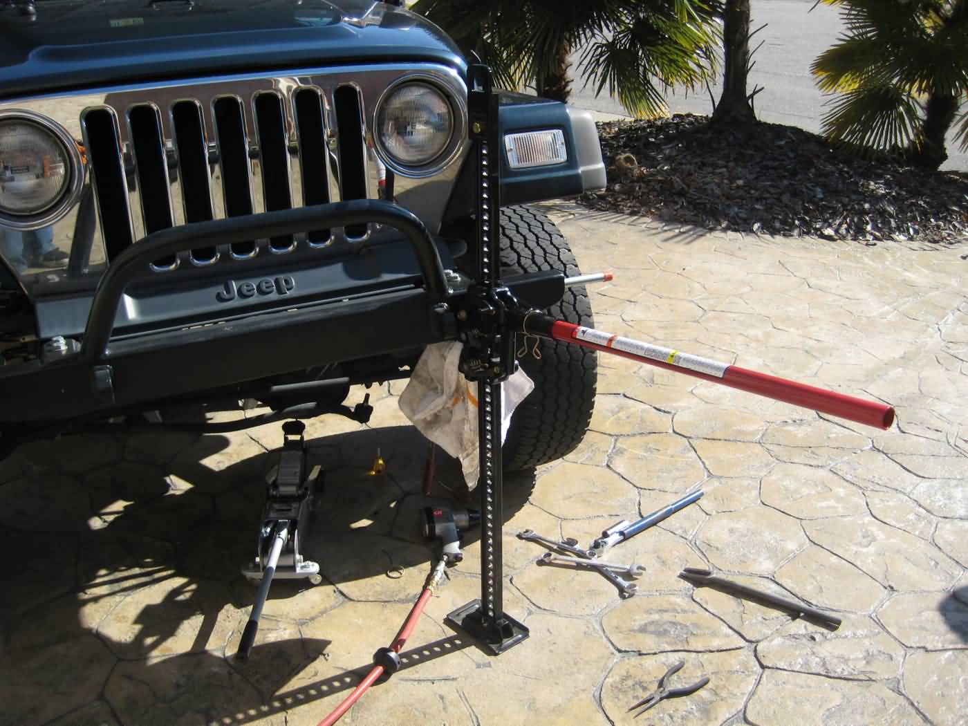

1 Removing the stock control arm
You will want to remove the lower control arms one at a time, so the axle doesn't shift too far. Just unbolt both ends of the control arms and pull the bolts.

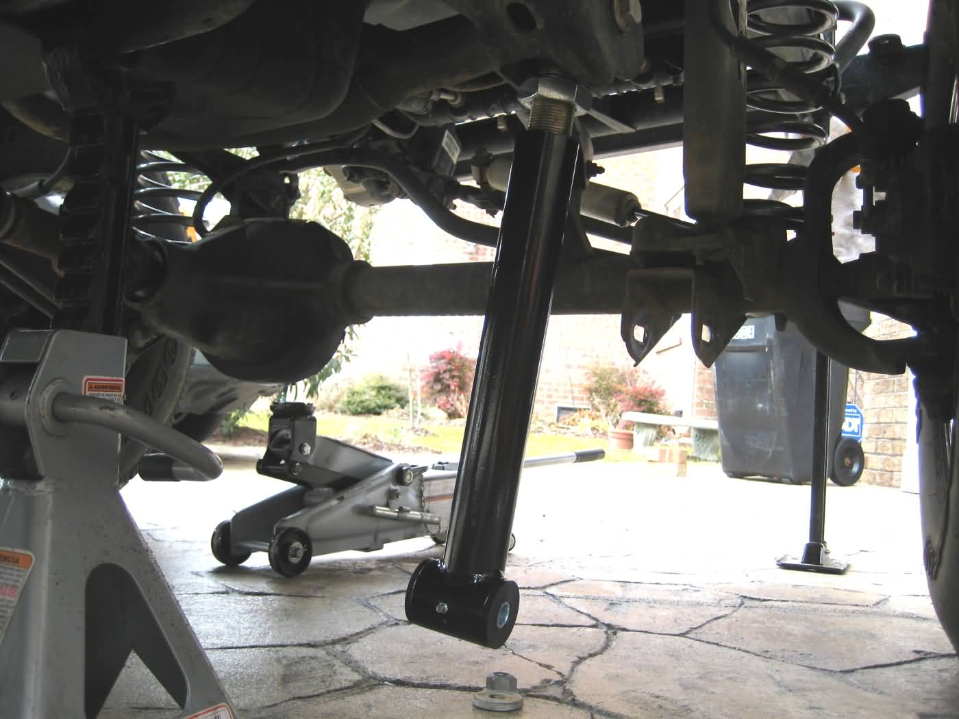

2 Installing the new Control Arms

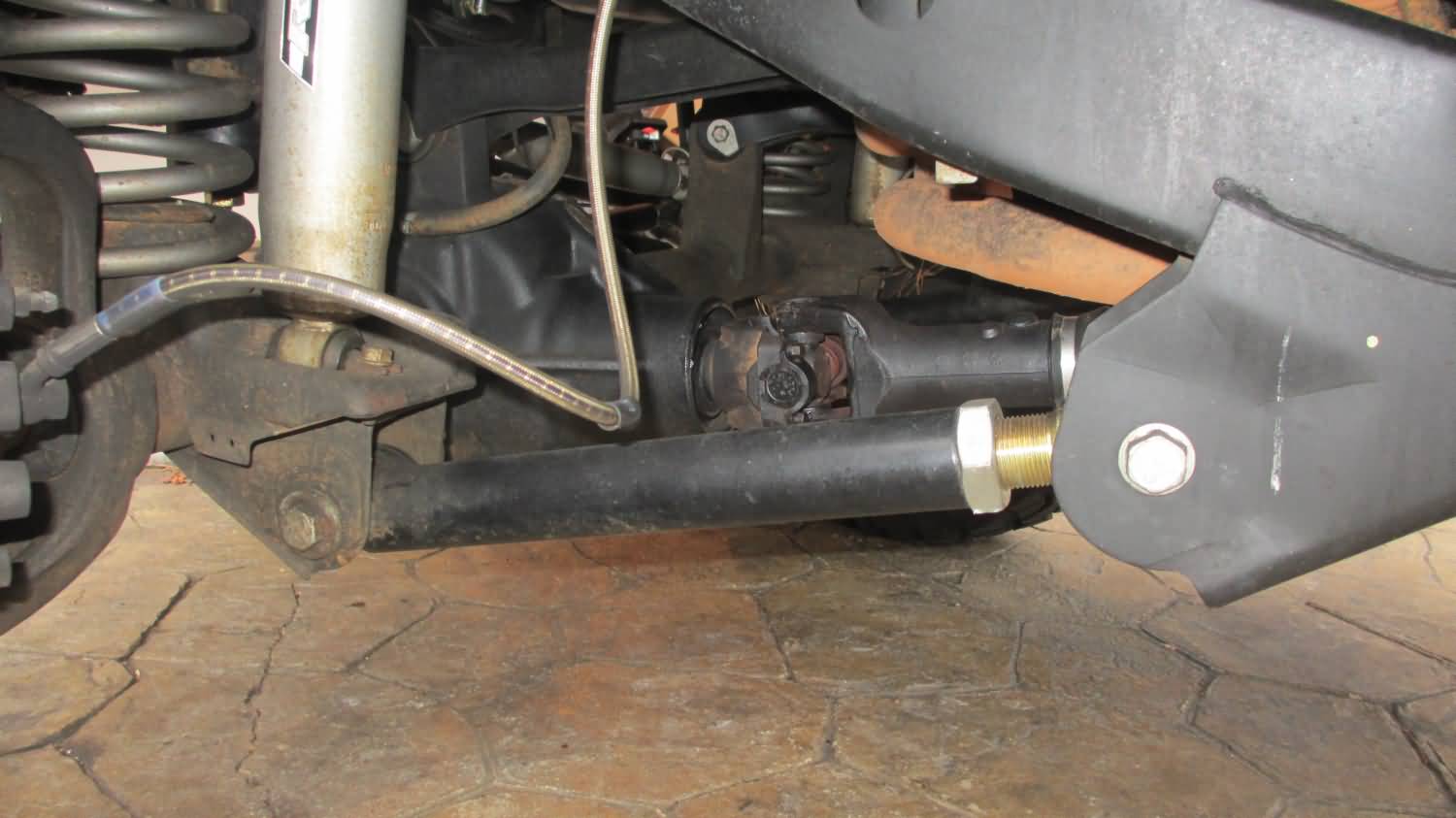

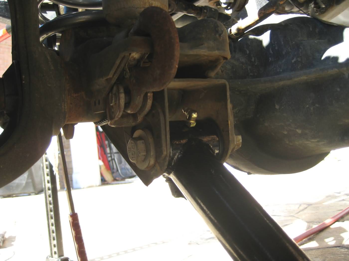

Once you've got the old ones off, begin installing the control arms. I began by setting the new control arms a half inch longer than the stock ones. Then bold the control arm into place. Begin with the frame side, making sure that your grease fittings are pointed up (they'll be torn off on a rock if you don't).
You can see from the photos below the flex that these control arms allow. Your axles can now shift left and right without destroying your control arms.

3 Installing the second control arm
Putting in the first control arm was fairly easy for me, since the stock control arm on the other side held the axle in place. When I went to install the second arm, then bolt holes would't line up. I lifted that side of my Jeep and used a come-along to pull the axle into position. Once you get the axle into position, you just slide the bolts into place and finish up.
Finished installing control arms
