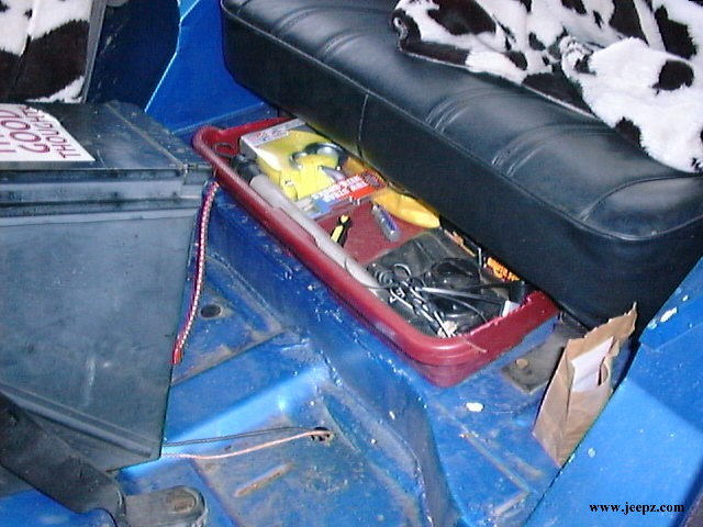

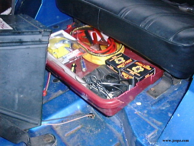

This is a very low tech way to add more storage space to your Jeep, making use of the space under the rear seat. All you have to do is get a regular ray, designed to go under a bed, or other low sitting container. Just cut the tray starting the top diagonally until one end is about 3 inches lower than the other end. I use a bungee cord to keep the tray from sliding out when I lay on the brakes.
