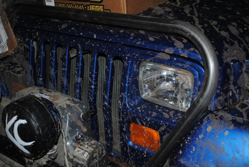

I bent up a rad hoop, I am thinking of cutting the back of the grille off and put it behind the grille for a clean look.
I am making some hi-line fenders, gonna take about 3" out of the hood so they will tie into this hoop.

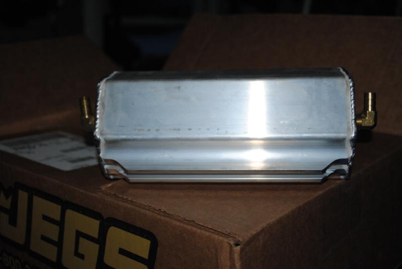

around christmas time, jegs had a killer sale with free shipping so I picked up a new aluminum radiator over flow tank for less than $20 shipped with all the mounting brackets and hardware
Balistic battery box

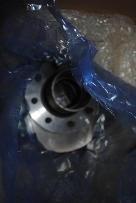

Brand new SRW hubs, rotors, studs, bearings and races.. won't say how much I paid, but way less than they cost now since GM is no longer carrying the part number

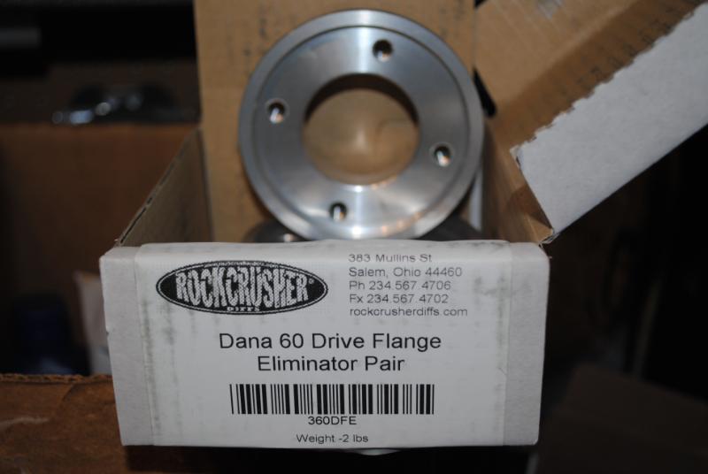

Rockcrusher billet drive flange eliminator's

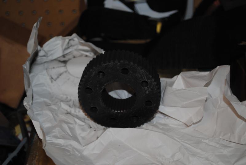

Rockcrusher 4340 35 spline slugs

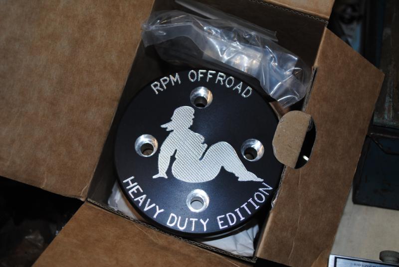

RPM motorsports fat chic flange covers... Heavy Duty!! Good Guys out there I ordered blue, but they sent me black by accident so when I called, they refunded me for shipping

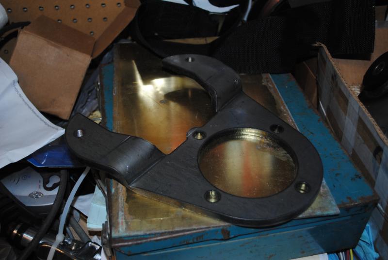

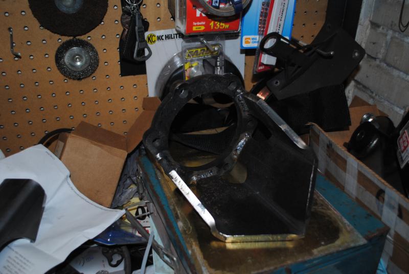

package from ruff stuff I got last month.
14 bolt pinion guard and disc brake brackets

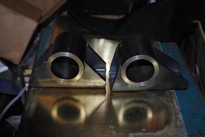

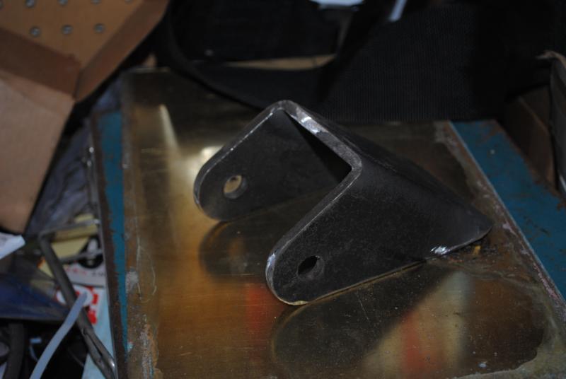

Shackle hangers. Obviously these come in pairs...
The centered ones are for the rear and the off set will be for the front.
I have the bushings, they are just not in the pic.
I got these 2.5" hangers on the front, the ones on my frame are kinda beat, so I am going to french these into the front of the frame, mean while offsetting them the 1/2 inch out to accomidate the stock D60 perch mounts.
Also by frenching them into the frame, it will correct the pinion angle slightly due to the fixed mounts on the D60

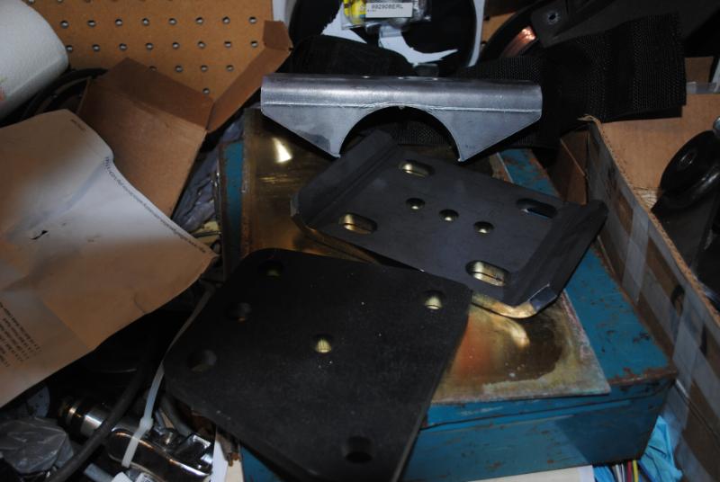

Lastly a couple of old stand by's. I needed some D60 u-bolt plates and some longer 14 bolt perches. I am obviously going to run a anti-wrap bar and some nice s-10 mains in the rear spring pack, but hopefully with these also used, the wrap won't be too bad. I do plan on 4 linking in the near future.. the worse the wrap is, I guess the sooner I start saving money for the 4 link.
Also ordering 40 feet of 1.5" HREW for some much needed mods, more on that later.

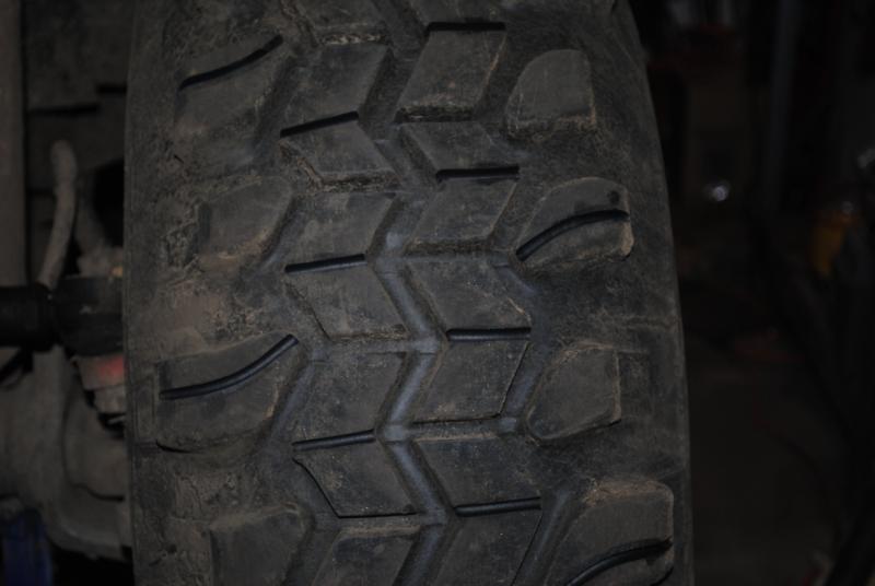

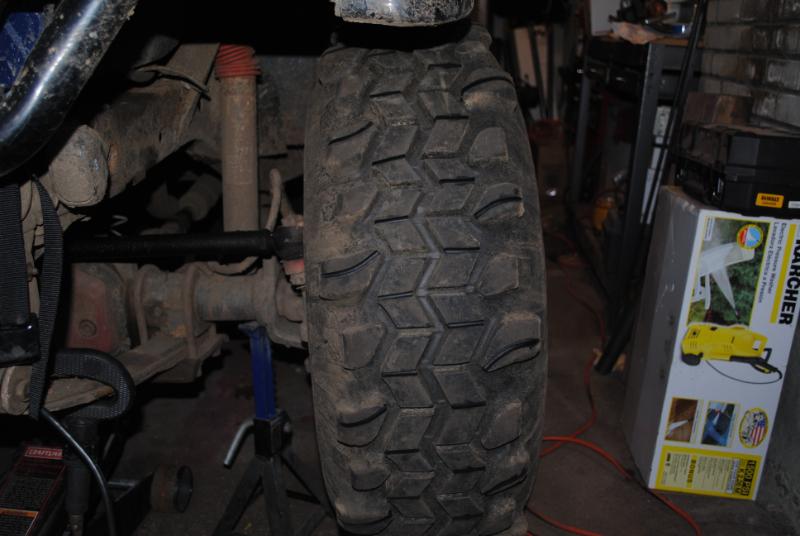

So.. if you have $900 worth of tires that have less than 200 miles on them total, pretty much all trail miles.
what would you do?

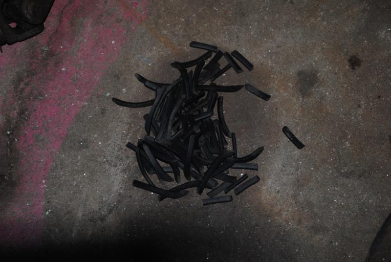

well I wasted some rubber.
A friend had the tire iron, and while I will firmly say that the TSL is one of the best tires for a all around offroad tire, it does have some shortcomings on wet rock. so hopefully a little grooving will help me have a tad bit more grip when I want it.

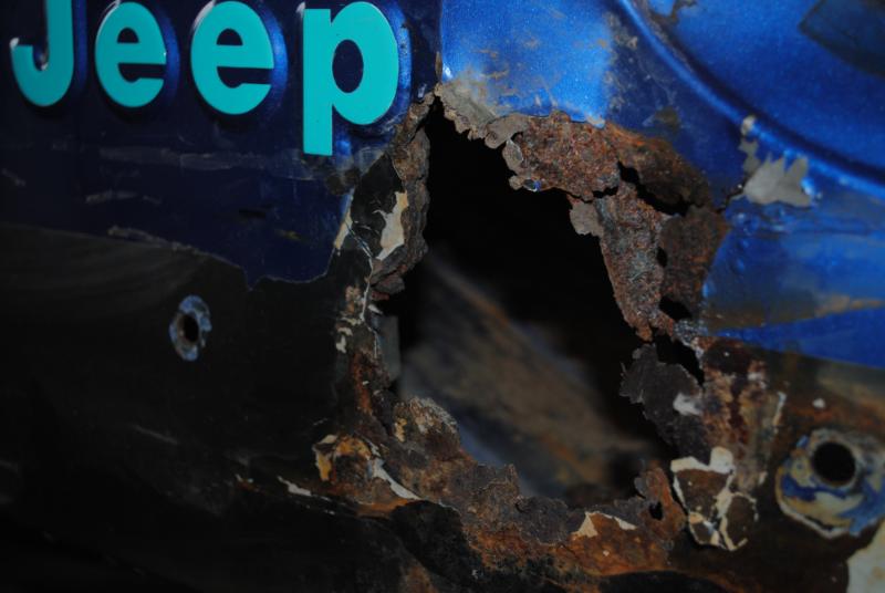

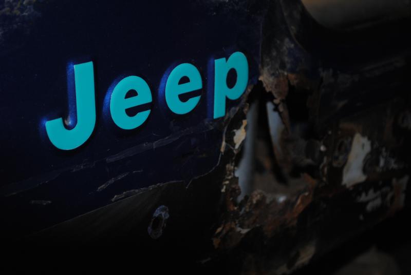

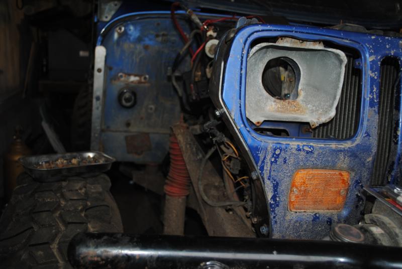

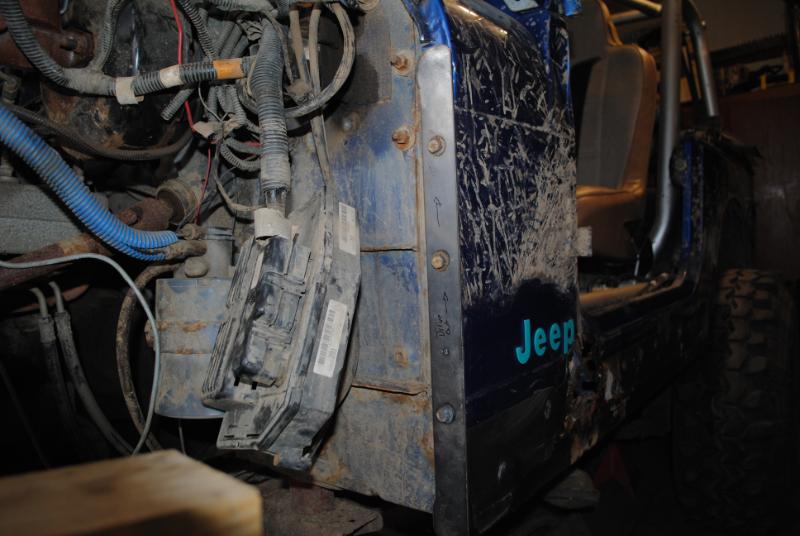

Well, between work, family, and the 20" of rain we've gotten up here in the past week (no lie) Slowly been dedication some time to the project. The plan is to still wheel it this year with the 44's under it, but I have a rot problem, luckily it is the only one on the tub. on the fdricers side, there it has rotted clear through about 5" wide and about 7" tall. Luckily it goes to the bottom corner of the tub and doesn't really spread much farther.
All the TJ flares are off (and for sale)
Rocker guards are off (also for sale)
Fenders are off (keeping those for now)
Going to be making the cut on the rockers for the boat sides just where the top of the current guards are and removing from there down. some of the rot goes above there, I am simply going to patch what I need to.

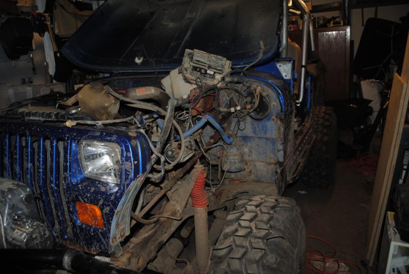

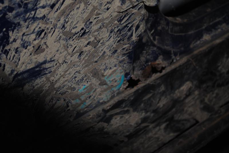

Well after being in Phoenix for a month and then working in NYC and CT.. I got home a little early, I got back last night and started ripping into this. here is a shot of the rust, it was not as bad as I thought, but it is not pretty, amazingly, this is the only rust on the jeep.

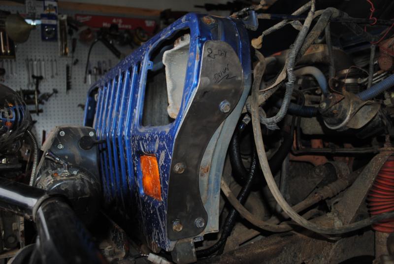

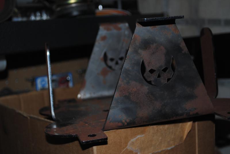

Prior to leaving on my trip, I gave a friend that has a plasma table some templets on the basic brackets for the front fenders, they will be further modified when I get more cutting done.
the front piece was flat, when I speced it out in 3/16, I didn't think ahead that it would be a huge PITA to form it to the contour of the grill.

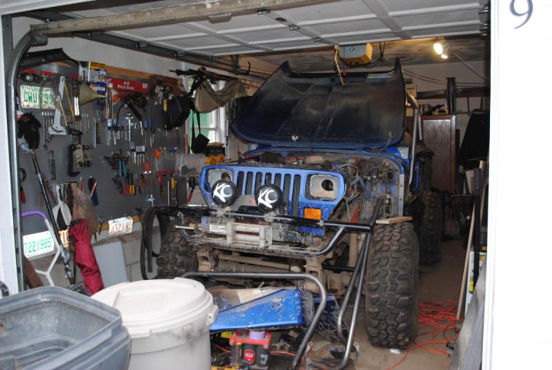

a quick shot of the front garage where I am doing the work, man it's tight in there.

In total I will be taking 3" out of the hood, by my estimates I should be able to safely fit a 40" tire with a SUA 3" lift, but, since I want the magic 106" WB, I will be SOA with XJ springs front and rear but will be frenching the mounts into the frame and the mount the shackle hangers as high as I can on the front and rear cross members so I am estimating my SOA lift will be about 2.5-3"
