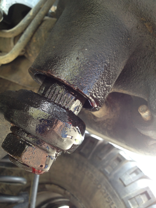

Hey Jeepers.. I've got a VERY VERY leaky steering box on a 00' TJ. It is leaking directly out of the shaft (pitman arm) and I was wondering if it can be fixed or does it need replaced. It's lifted 4" and has a drop pitman arm. It works great, just verrrry messy :(

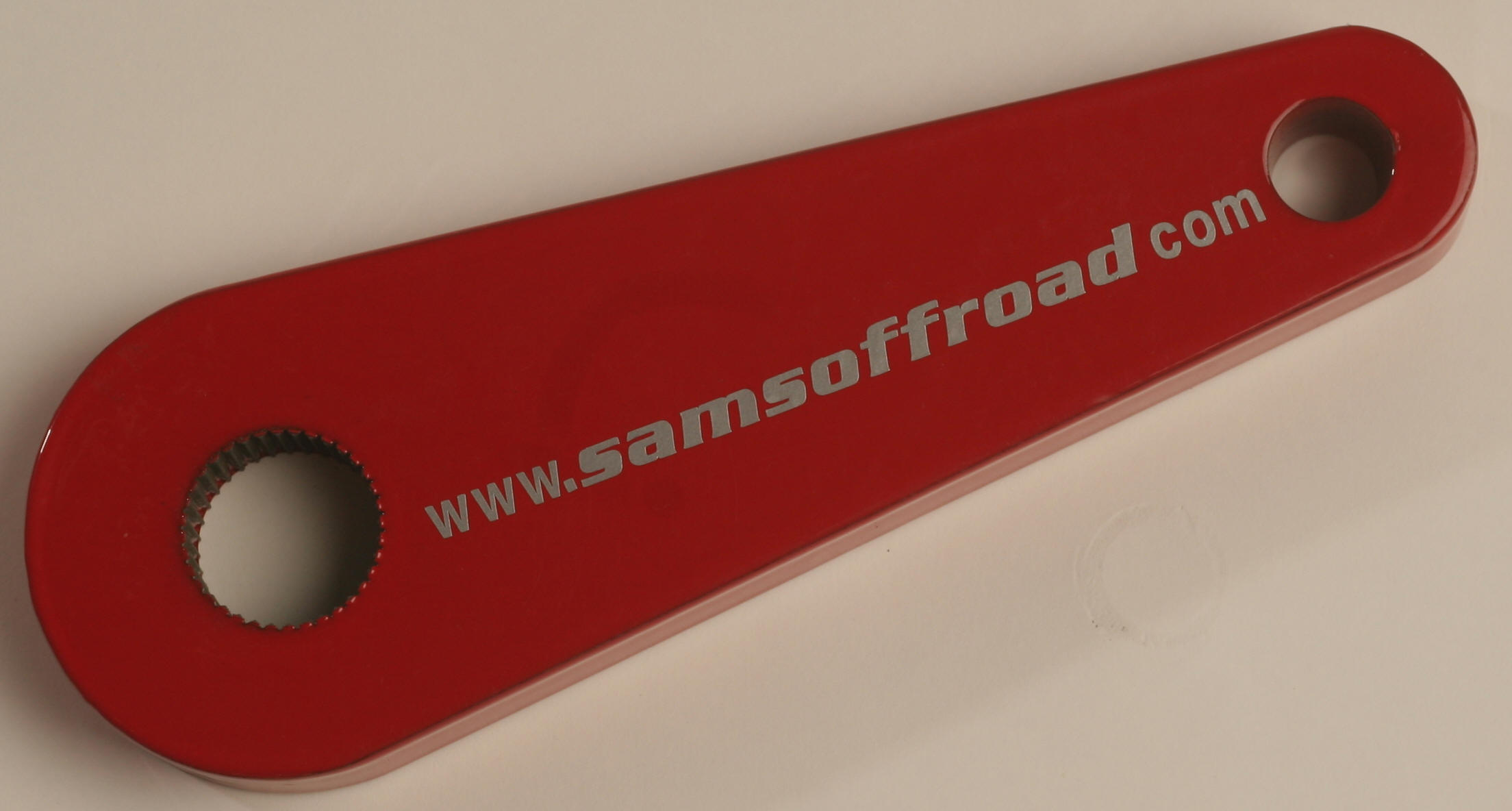

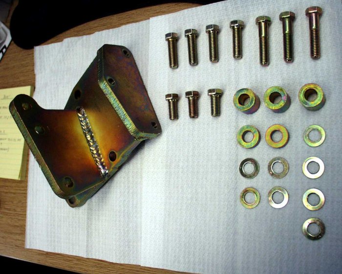

When the Saginaw box started leaking on "Betty" I took 'er into a stellar front end shop in Albany, OR and they installed a rebuilt box as mine was apparently too far gone. While they were at it I had them Install an H.D. Steering box bracket and H.D. pitman arm from Sam's,
<img src="http://www.jeepz.com/forum/attachment.php?attachmentid=13779"/><img src="http://www.jeepz.com/forum/attachment.php?attachmentid=13780"/>
after they lined everything up "Betty" tracks straight as an arrow even with BFG M2's
That's a nice set up. How much was it?
For the parts and labor it ran about $350 clams which may seem expensive but given the results I'm very satisfied.
Crap. It's leaking so bad now that I have to refill it everyday now:( I have been catching the fluid with a oil drain pan and pouring it back in lol. It was a good strategy until it poured the rain and made a REAL MESS.. No I don't have a garage to park it in:( I've watched a few vids on YouTube on replacing pitman arm shaft seals and it looks like a nasty job. I found seals for about $15 but I may save up and buy a used steering box. The ol budget ain't got much room for jeep parts at the moment if u know what I mean. Or I could remove the power steering belt because I am running an old school 283 ci 4.6 liter v8 small block Chevy motor lol.. It has all the classic Chevy leaks, but in this case, it's the jeep part that is malfunctioning. I thought about stealing my wife's steering box and playing dumb:P Oh your steering box is leaking now? Huh?? Mine isn't anymore.. Ha

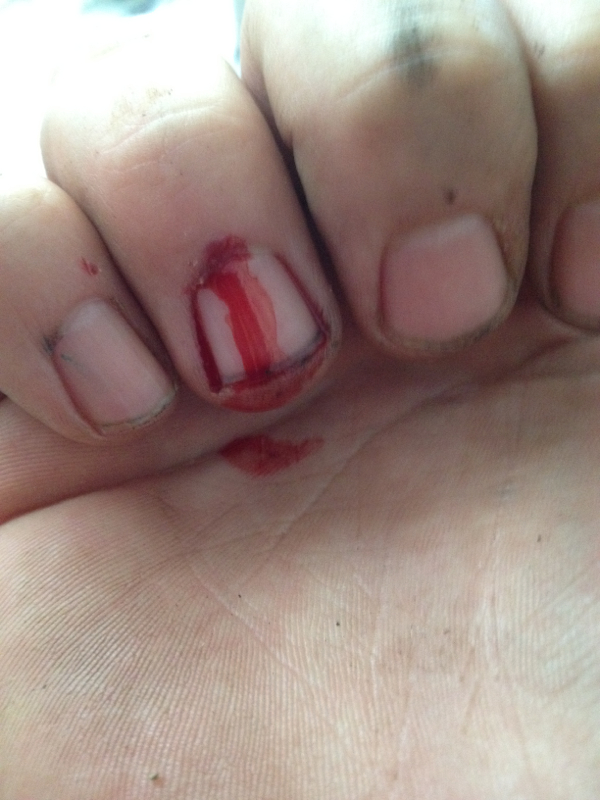

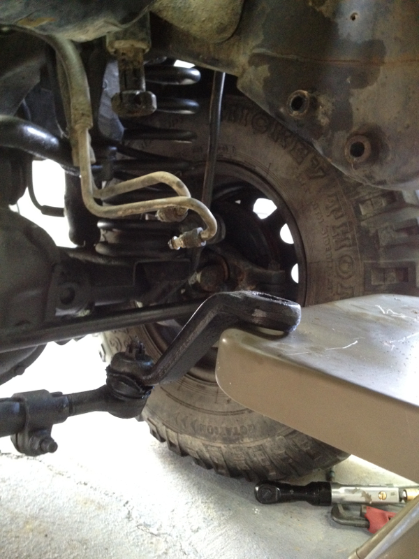

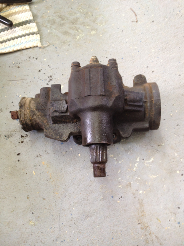

Hello jeep peeps.. I am glad to say that I replaced my steering box with a refurb box from advance. Holy crap she steers good now. You can drive with one finger now. It steers better than my wife's tj with 70,000 miles on it. My tj has over 150,000 on it. Hers is hardly broke in compared to mine lol.. It was not really that bad of a job. I didn't need help until I had to hook up the steering stem, rod, bar, shaft thingie, whatever it's called lol. Busted a few knuckles and fingernails but it wouldn't be a proper job if I didn't draw blood.. NO MORE LEAKS.!!!
