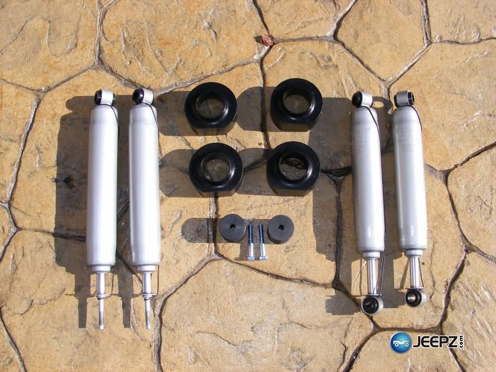

The kit - Rubicon Express budget boost
Here are the componets of the RE7030:
4 coil spacers
2 longer bumpstops and bolts to go in them
4 new shocks
some of the least helpful instructions I've ever read
It's a pretty short list. Here's a shot of the lift kit, and the directions

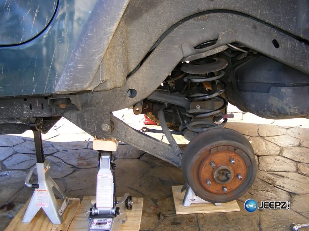

1 - Jack up and remove wheel
I decided to start with the easiest first, which means the rear wheels. I decided that I'd just do one wheel at a time, but if you've got some big boy pants, you could probably do both.
First, put some wheel chocks in front of and behind the front wheels. Now, place your jack under the rear axle and jack it up. I jacked the rear axle as high as my standard jack would go. Then put a jack stand under the side frame rail. I put a second jack under the rear axle, just to be on the safe side.
Once safely jacked up, remove your rear wheel.

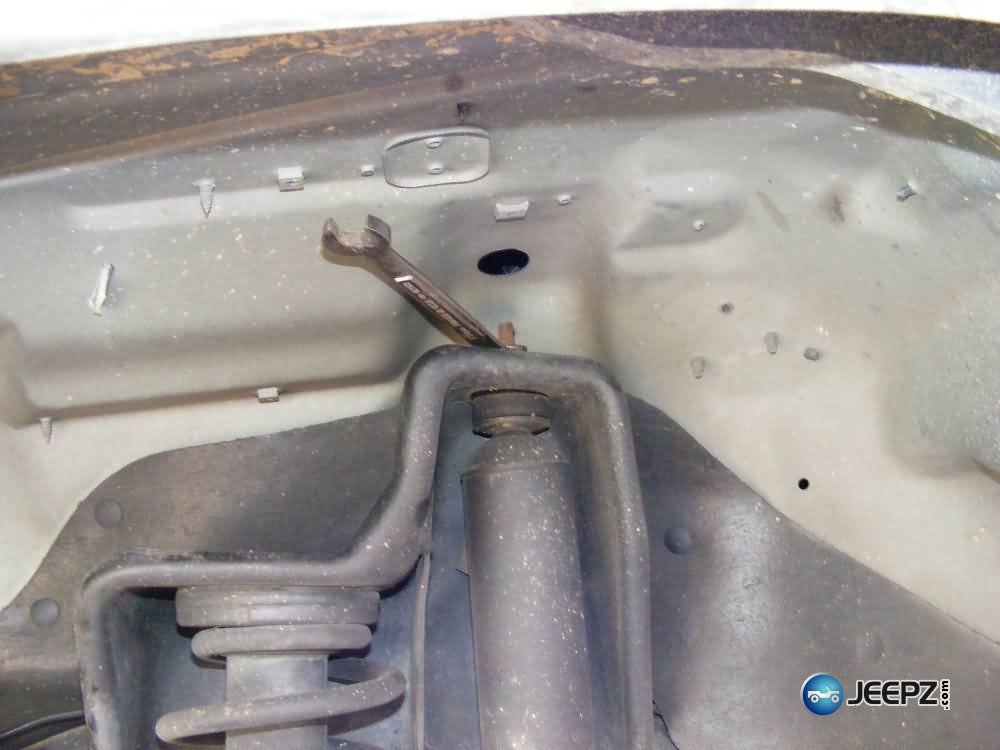

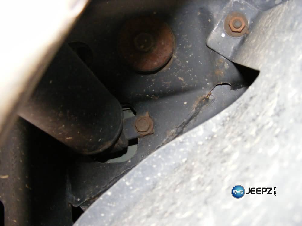

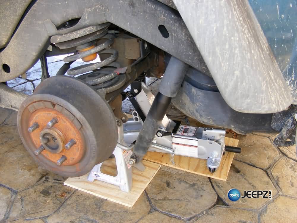

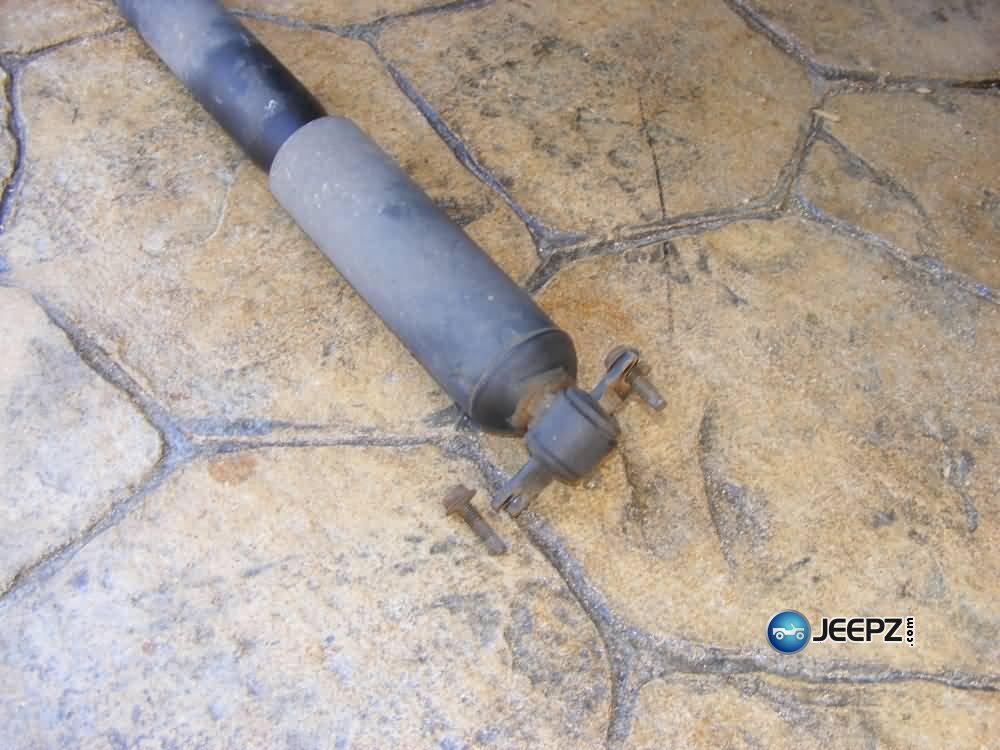

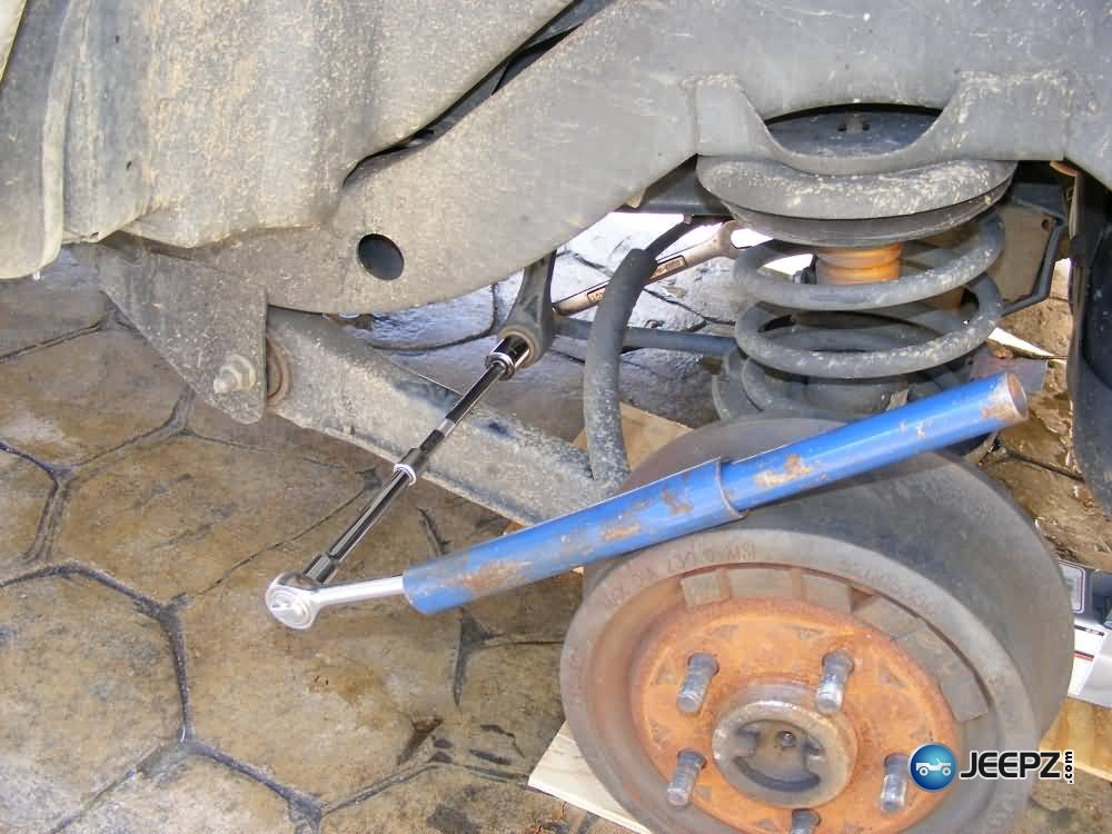

2 - remove the shock
Now, we'll have to remove the rear shock. There are two bolts in the top of the shock (first photo), as well as a large bolt with a nut at the bottom. Finally, you can see the shock off the vehicle.

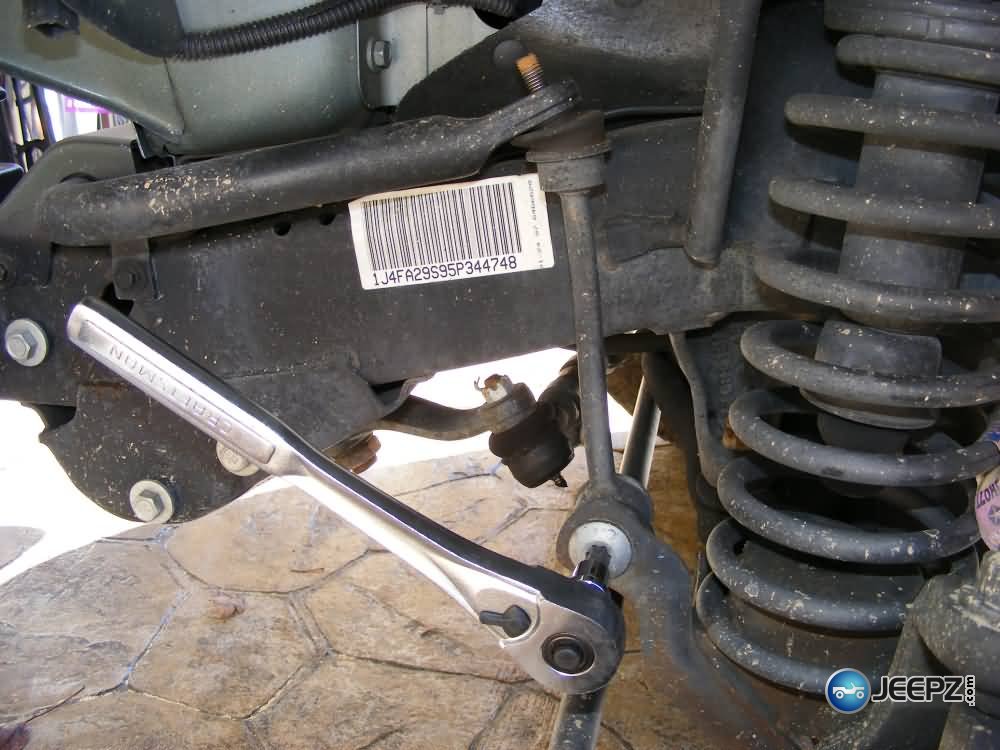

3 - Remove the rear sway bar
The rear sway bar reduces body roll when you're on the road, but right now it will prevent us from dropping the rear axle down, so it's gotta go.
Just remove the bolt that holds it on. You don't have to create socket wrench monstrosity like I did, but it doesn't hurt.

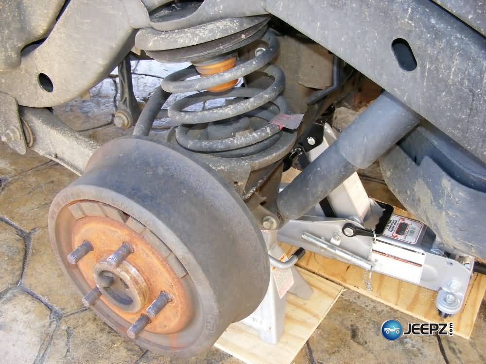

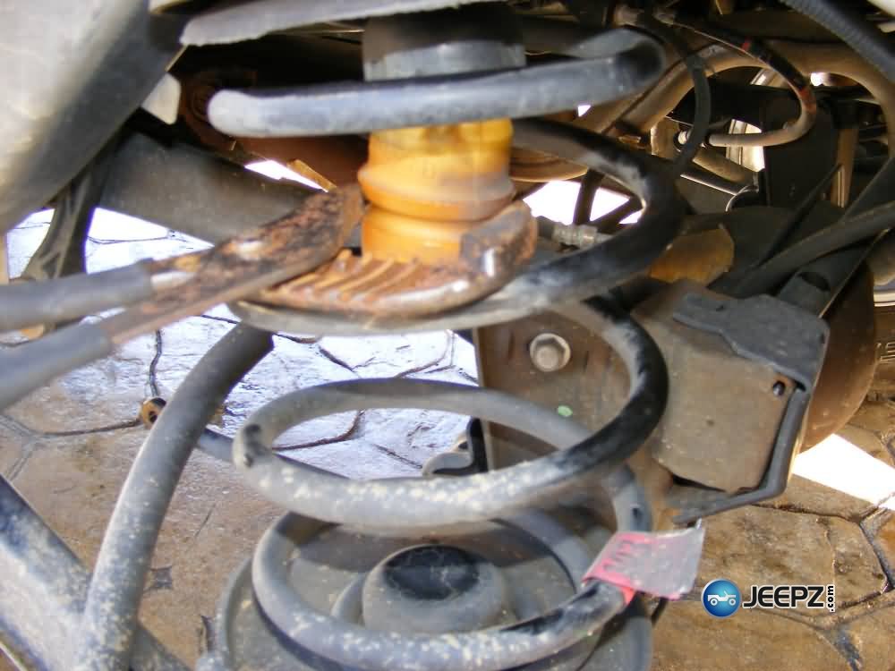

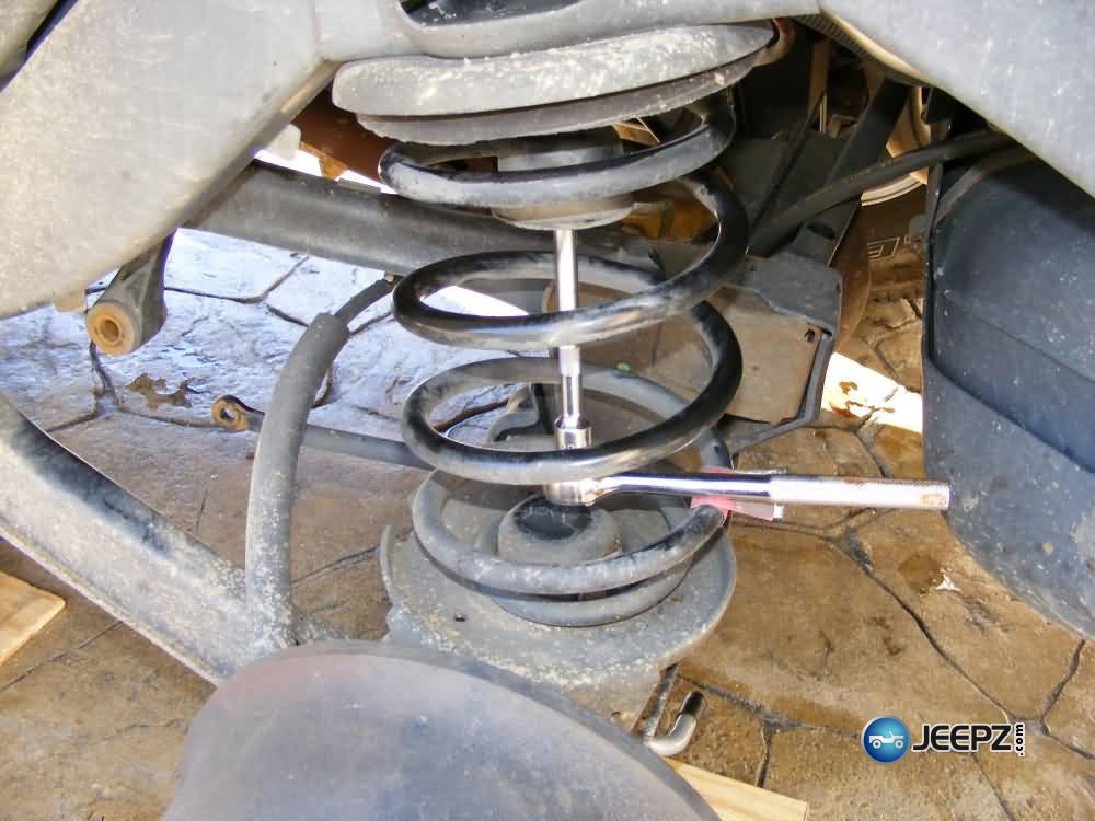

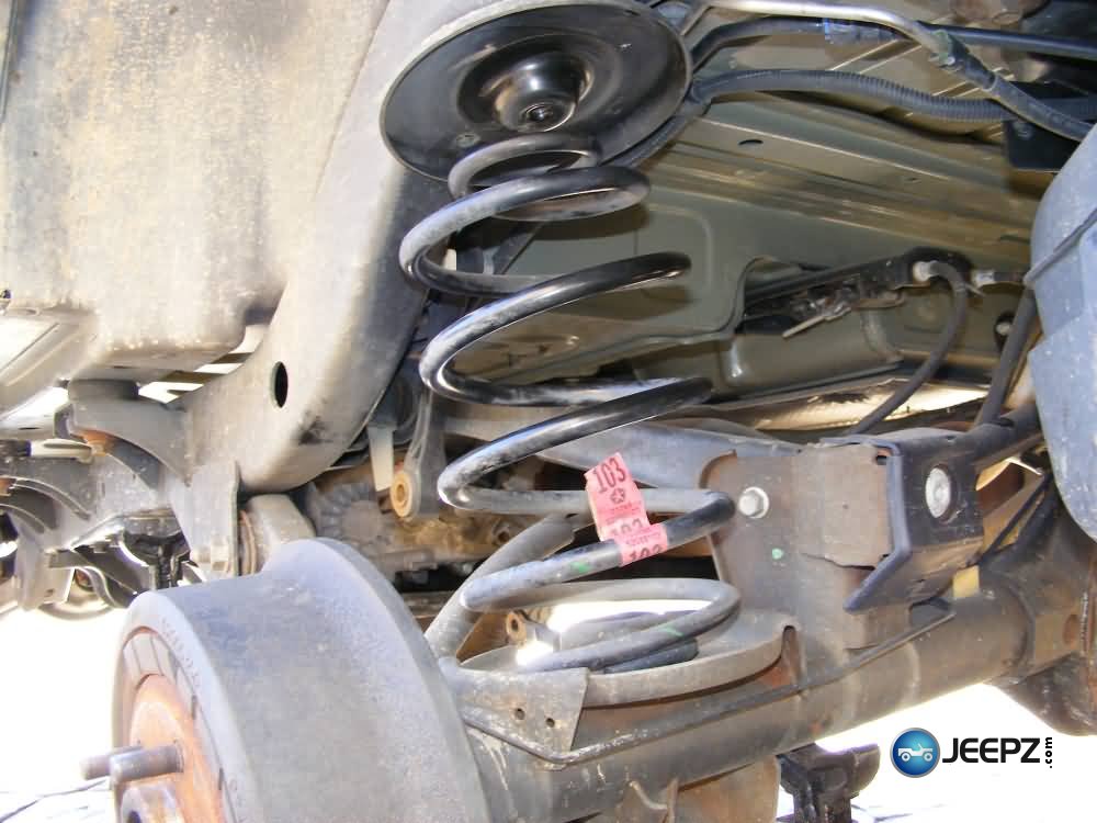

6 - Remove the coil
It took me some time to find the right jack placement, and alas, it was after this photo was taken. The idea is to hold the frame up high, while dropping the axle down low. Jack your jeep up as high as your jack will go, and put jack stands under the frame, then lower the axle.
As you can see here, the axle is dropped far enough to allow me to pull out the spring.

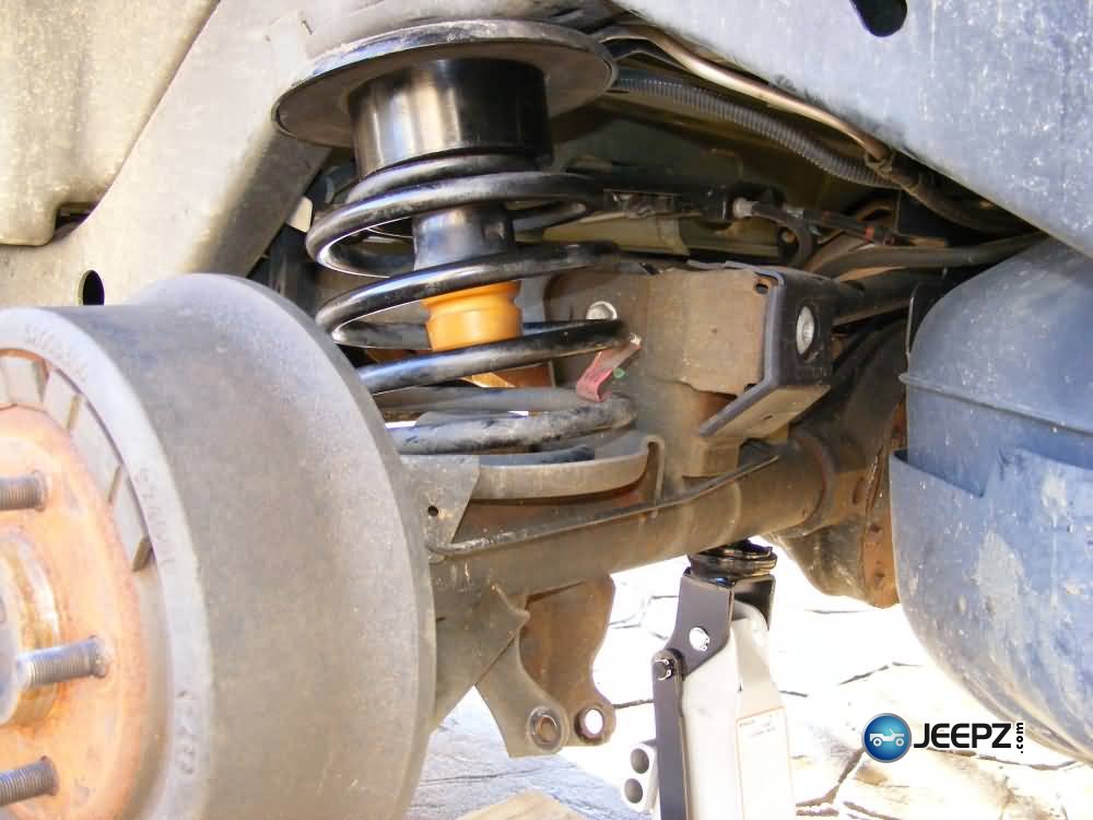

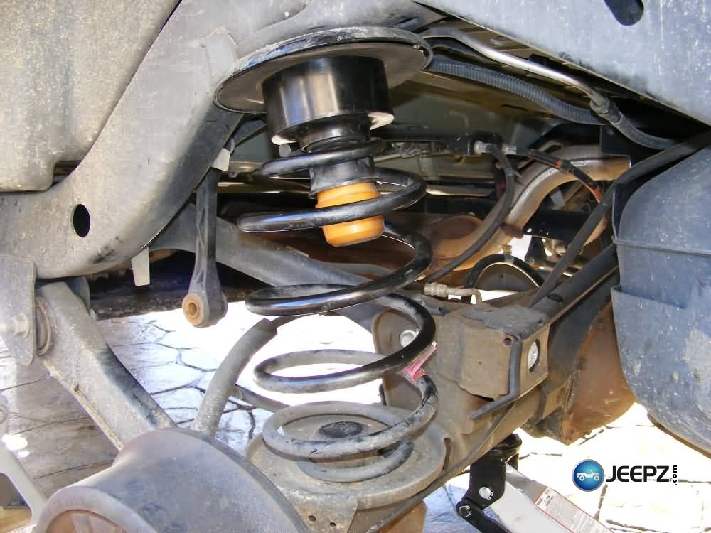

7 - Reinstall the coil
Now, you'll need to sit the new coil spacer on top of the coil and put it back in place. Once everything is seated, put the new bump stop extension up through the coil, and bolt the cup in place with the new bolt supplied with the kit. Finally, push the rubber bump stop in place - I found that squirting some armor all on it made it go in place alot easier.

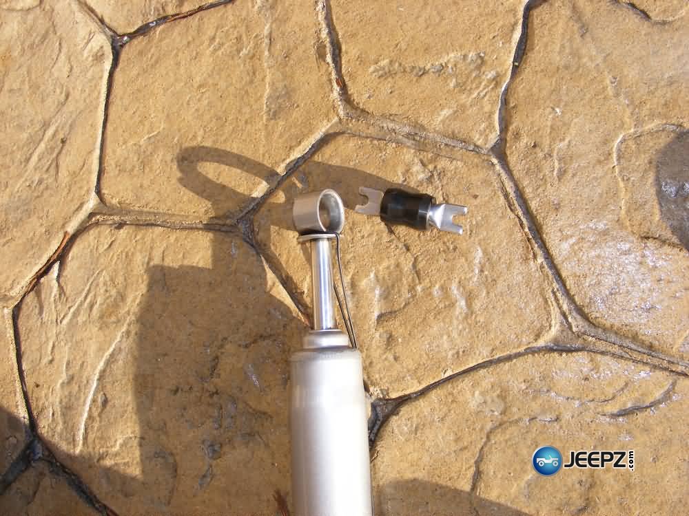

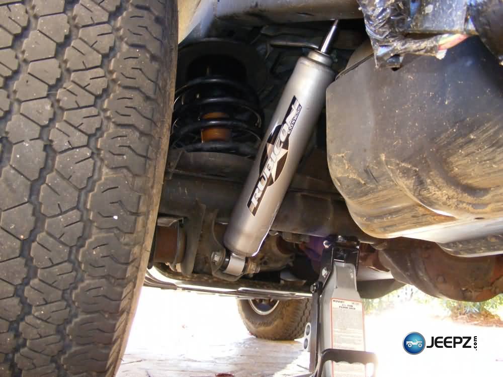

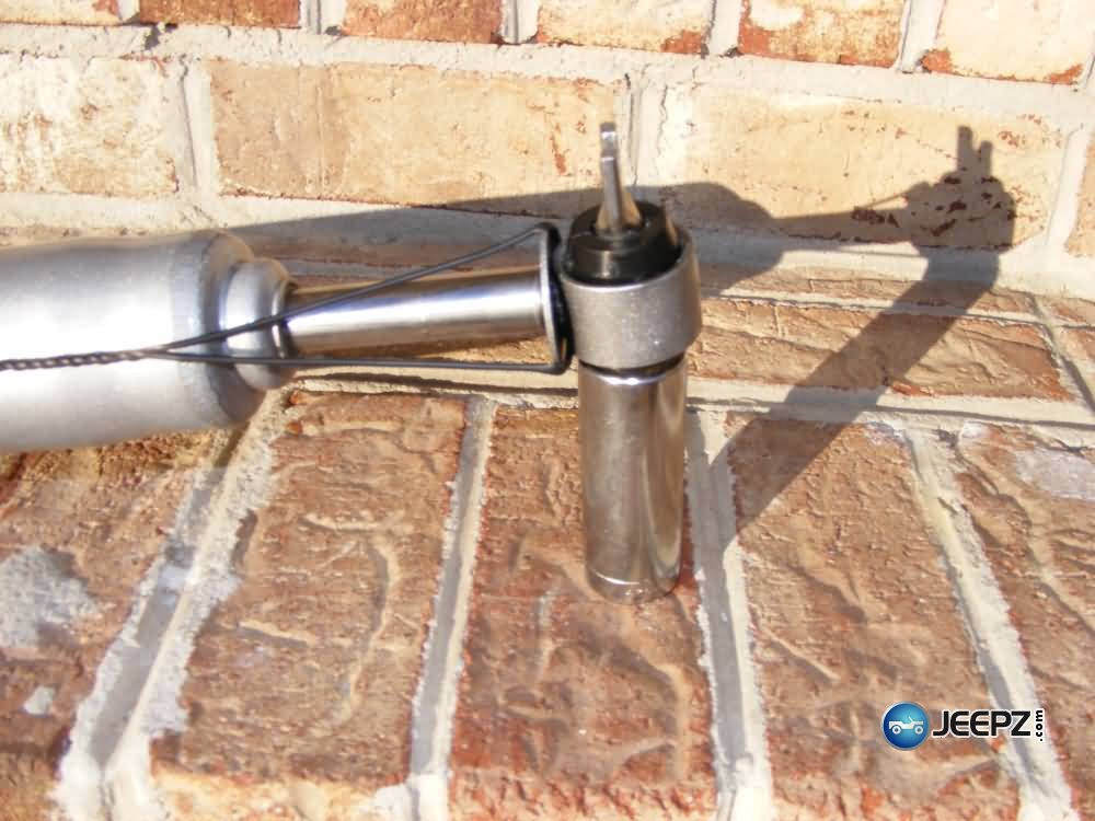

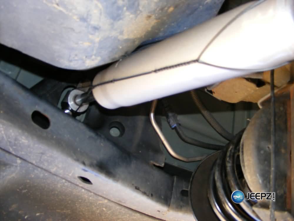

9 - Install the rear shocks
Now you'll need to install the rear shocks. I found it easier to install the metal mount by taking the rubber bushing out of the shock and pushing the mount through the bushing. Then to get the bushing back into the shock body, I found a socket that would allot the mount to slip inside, and press on the rubber bushing. I then pressed the bushing back in with my hands.

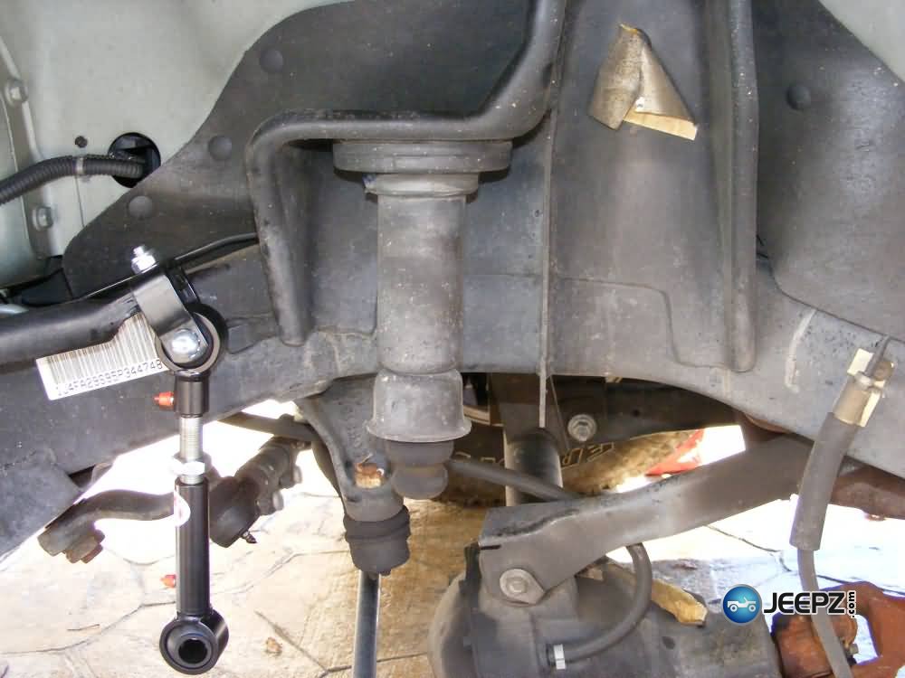

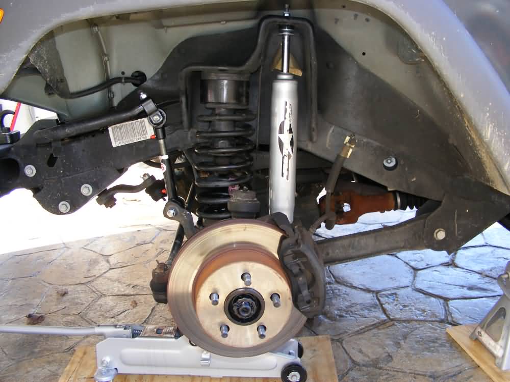

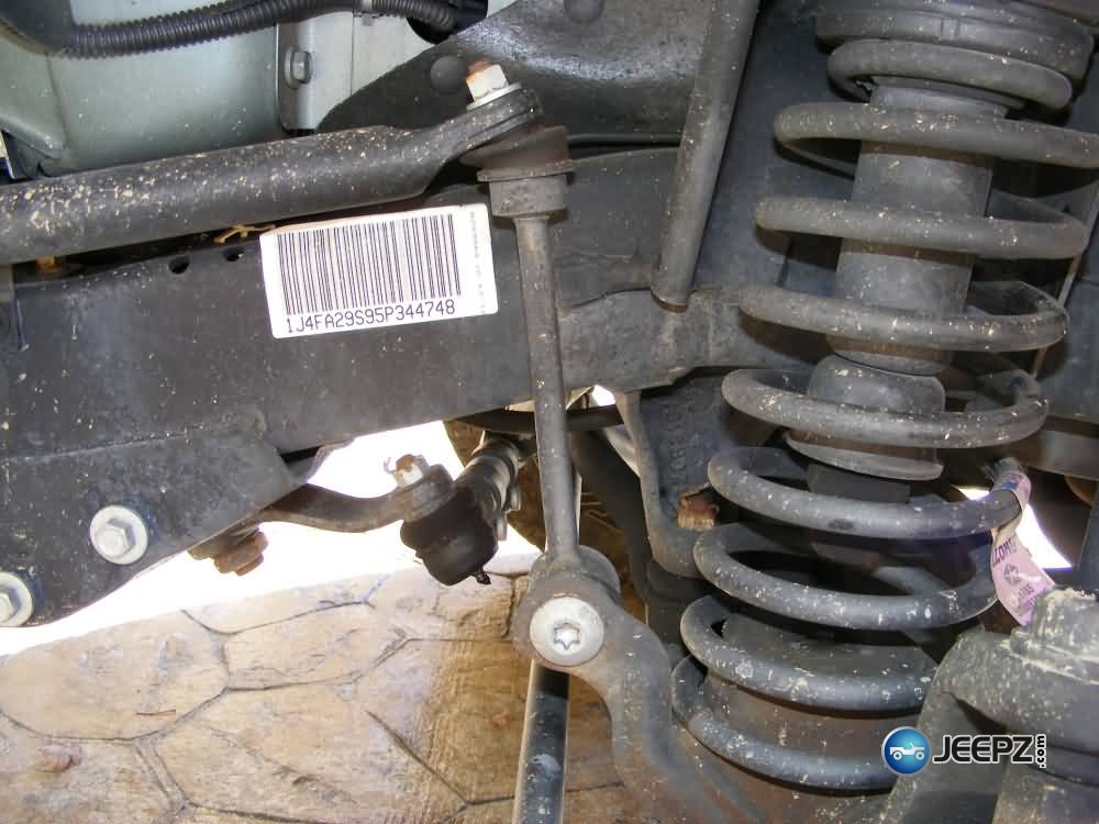

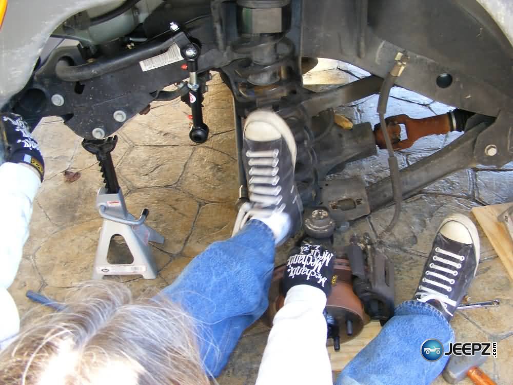

11 - Remove the front tie rod
Once I finished the rear wheels, I moved onto the front. Just jack up the front axle and remove the wheel.
Now, unbolt the front tie rod

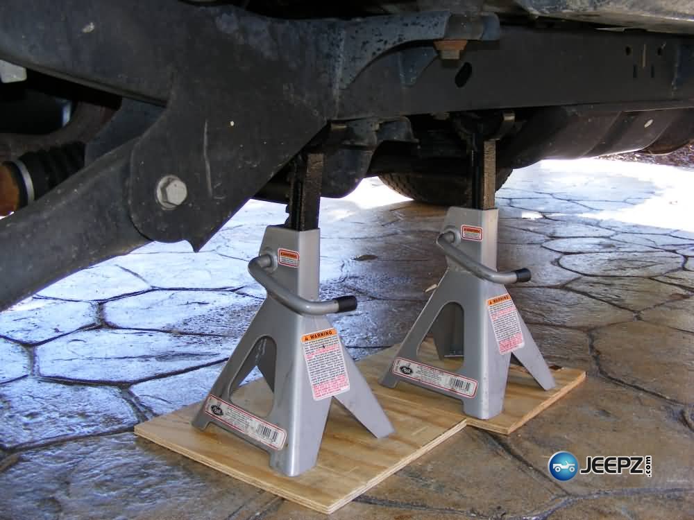

12 - Remove shock
Now, remove the shock and position the jack stands

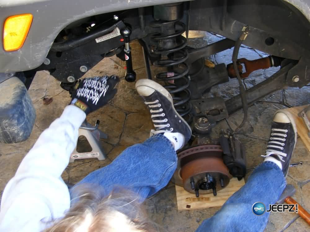

13 - Remove coil
Jack up the frame, and lower the axle. Once the axle is dropped, the coil will come right out.

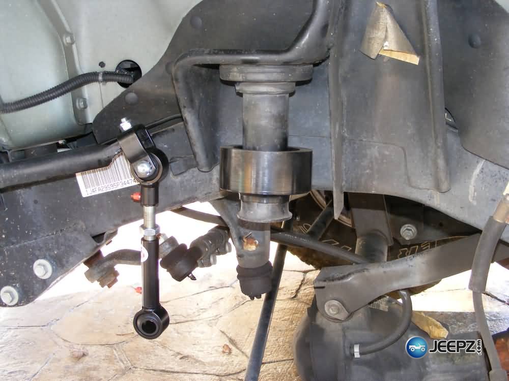

14 - Install spacer
Now that the coil is out, just remove the cup and add the new 2 inch spacer

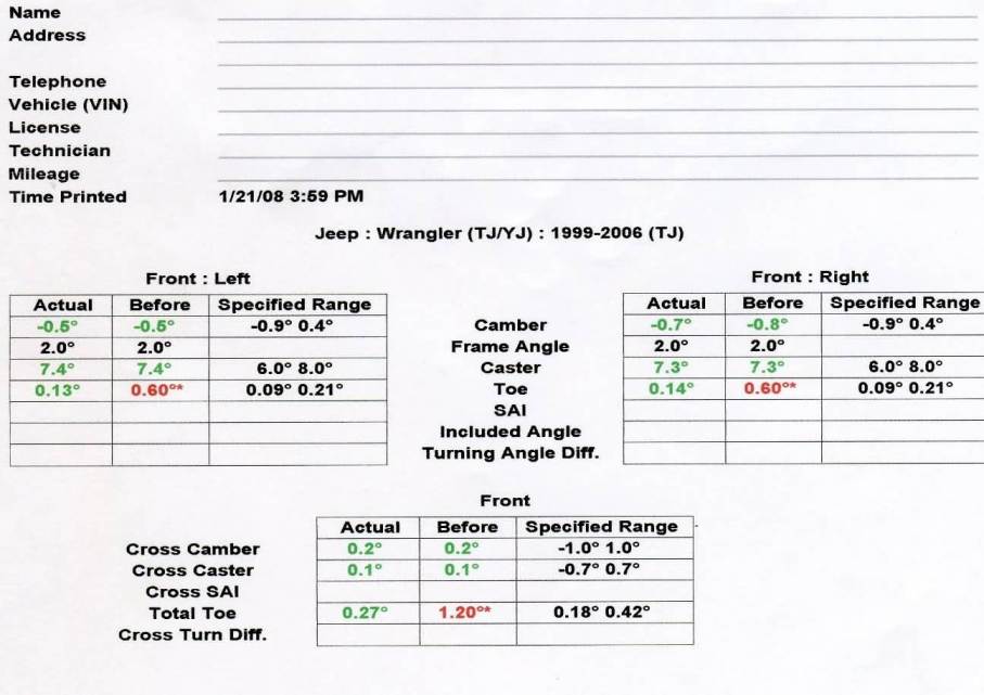

All done
After finishing a lift, you should always have an alignment done. I drove the jeep to a local tire shop and was surprised at how off the readings were. Here is the findings from the shop (note the red numbers)
