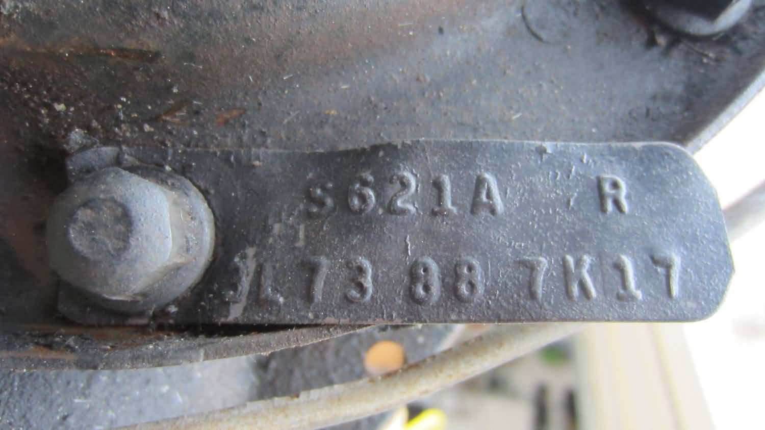

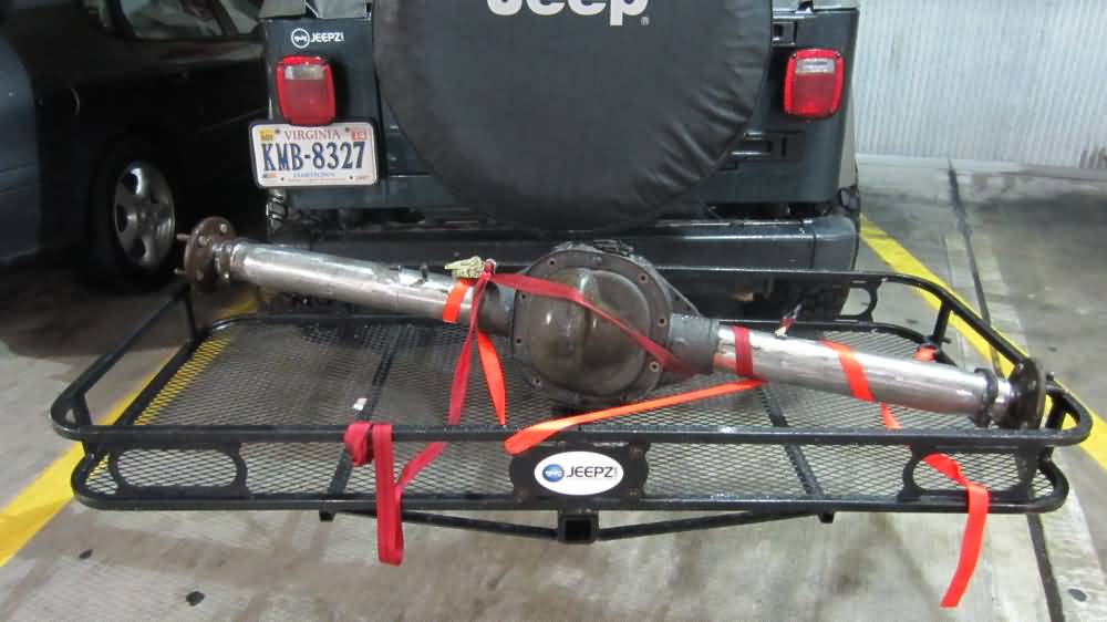

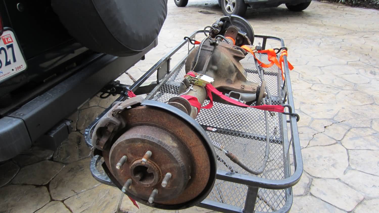

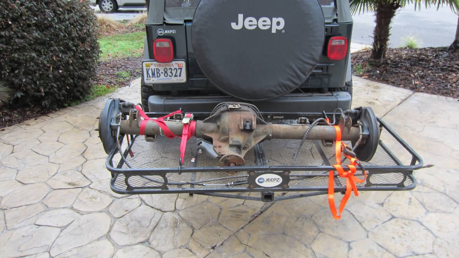

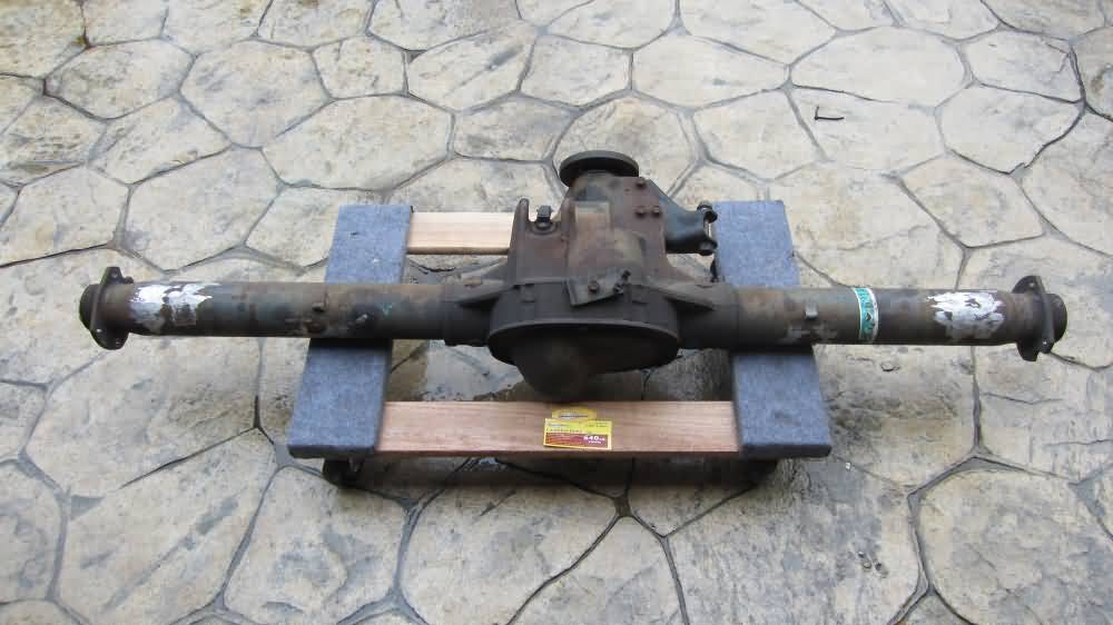

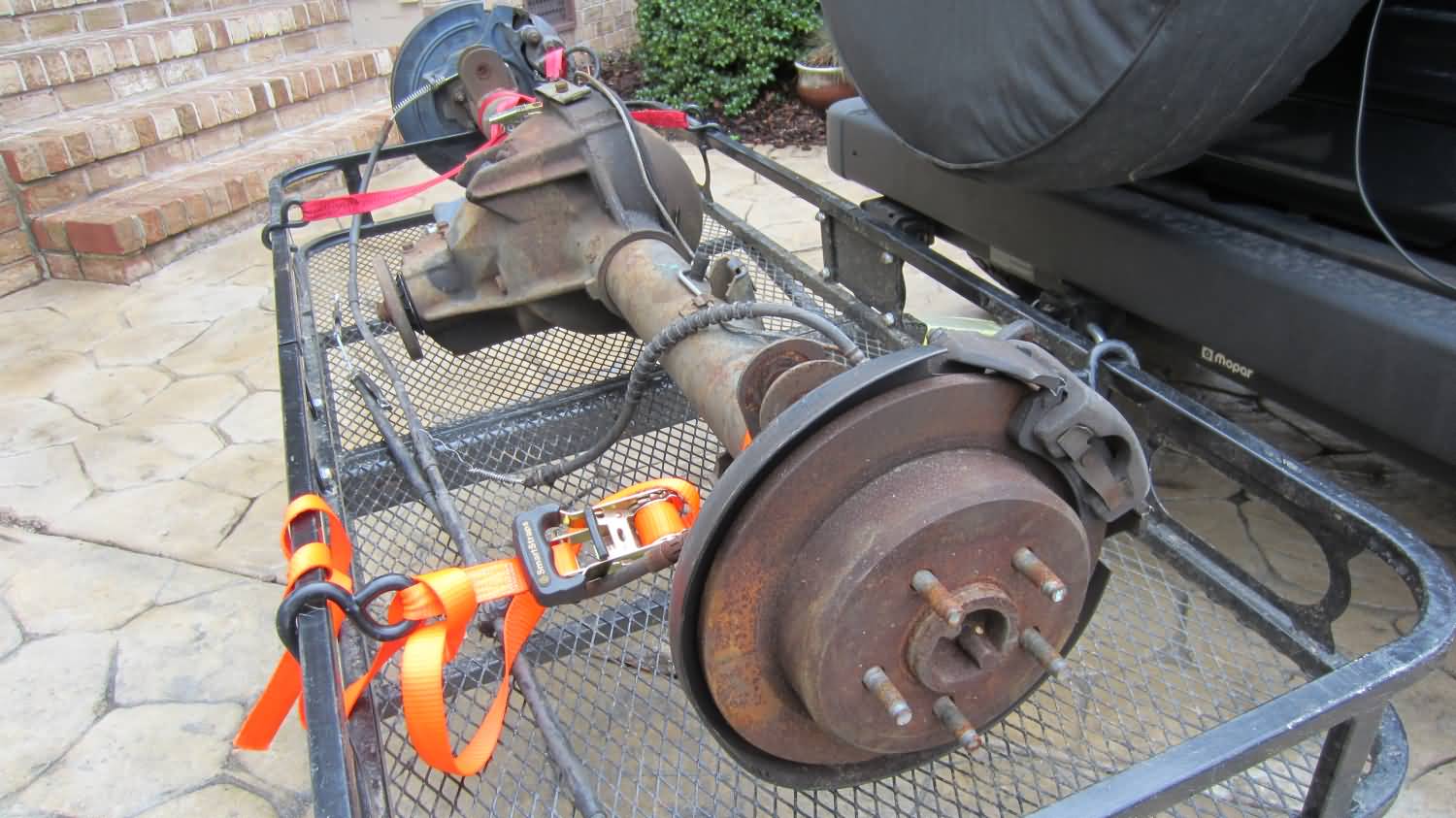

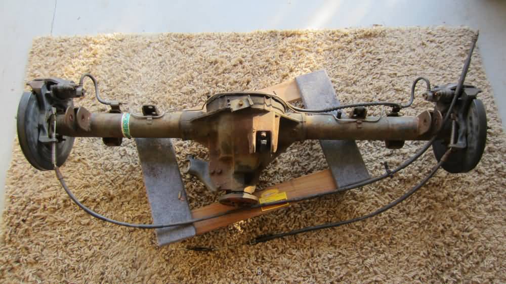

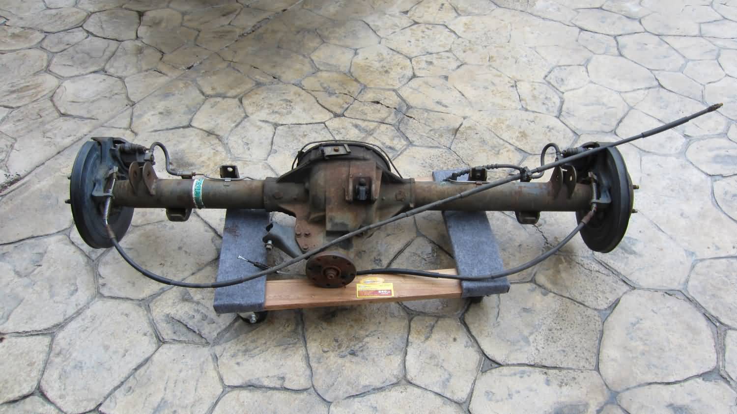

It just couldn't stand being under that Ford Explorer any longer, so this little 8.8 came home with me.
I picked it up for $175 - It's got 3.73 gears and has a limited slip. I've got 3.73s in my Wrangler now, and will probably end up running the limited slip for a while, until I can save up for a real locker. I'm pretty stoked to get this project started as it's the first serious upgrade that I've done - it's been all body lifts, longer coils and the like until now.

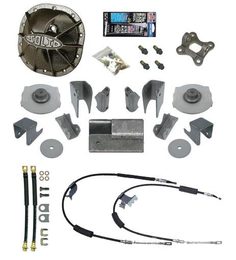

Is East Coast Gear Supply the best place to pickup the brackets? They're the cheapest I've found so far.

Great find for a good price, congrats.
I just worked on a TJ yesterday with the ECG brackets on the 8.8 and it's a very nice kit, I recommend it.

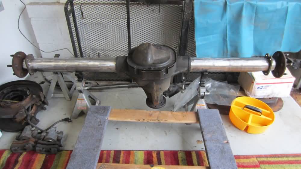

I've made some real progress
When I started:
Brackets cut off:
ground off all the rust:
Loaded up to go to the machine shop. I found a guy that would weld on the brackets for me for under $200.
