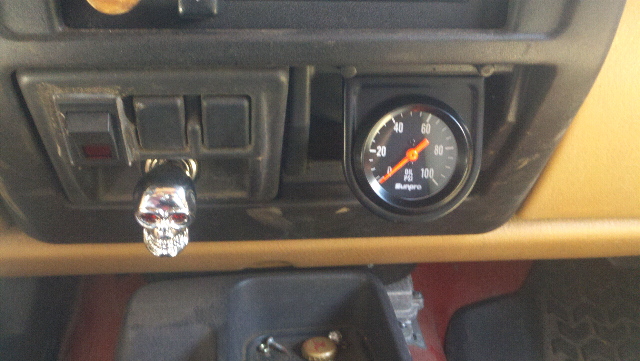

I been having issues that my oil pressure drops to 0 at idle after the engine is warmed up.
I want to install a manual gauge to see if it is the sending unit or pump.
Is there already a spot on the block to install it and where would it be located?

I want to leave the electronic one.I just dont trust it so I want to add a manual as well so I can compare.

a quick google search, i.e I didn't do a bunch if research, says its right in front of the distributor. or at least that's where the sending unit is.
Found it.a pain to get to.had to remove cai and air conditioner compressor.I did have to add a t block so factory and Manuel would connect.factory reads about 20 lbs under the Manuel gage.

Passenger side of block in front of distributor below ac pump.
