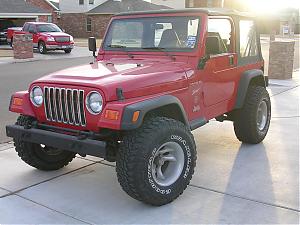

Here is acouple old pictures of my TJ, I'll take some more tomorrow when it's light outside haha
Jason4x4- your Jeep looks great.
How wide are your tires?
Are those stock rims?
Where did you purchase your lift?
Thanks.
The tires are 32x11.5x15. I bought my Jeep new, it came with the 30" Goodyear GSA's. I bought the 2" Rubicon Express budget lift (spring spacers and shocks) from either 4wd hardware or from Quadratec (I think it was Quadratec). I had only intended on buying 31" tires but I found too good of a deal to pass up on the 32s. The only issue is they rub on the swaybar if you have the steering wheel cut all the way in one direction or the other. Usually not a problem though...and this could be corrected with either wheel spacers or aftermarket wheels with more offset (yes, those are the stock 15" wheels). And I've done blue trails at both the old Paragon park and Rausch Creek with no problems with this setup. I'm currently working on upgrading to a 4" lift and some 1.25" wheel spacers (I like the look of those stock wheels).

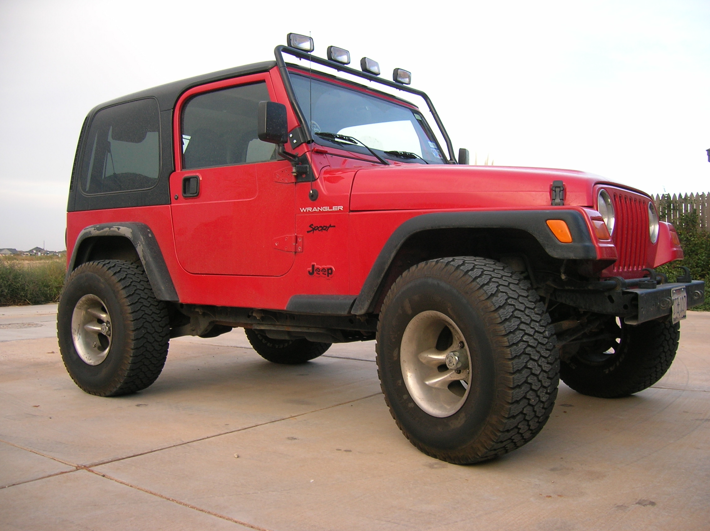

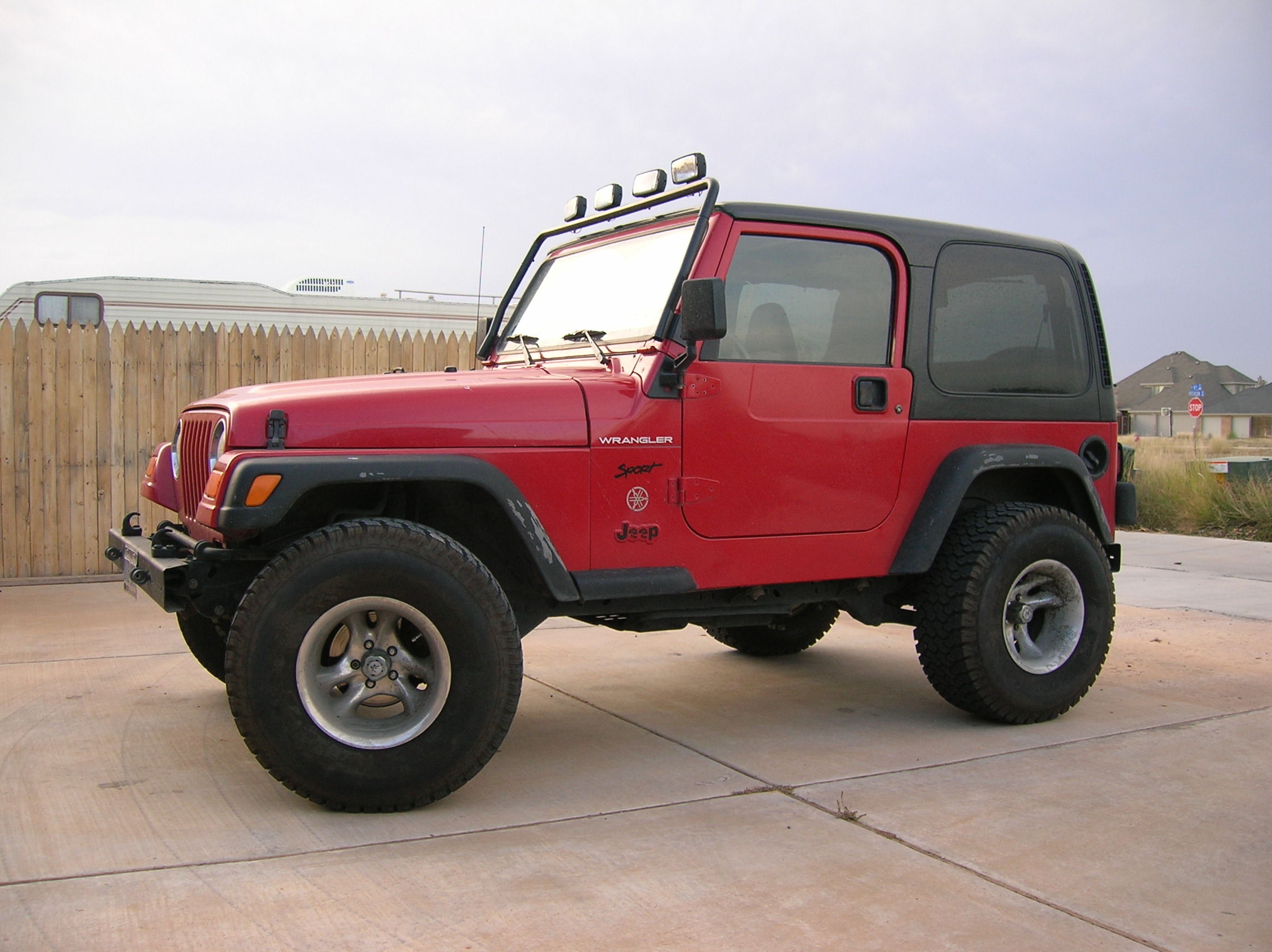

Here are some recent photos of my jeep

As for your peeling fender flares, my guess is that a previous owner may have sprayed them with some sort of paint or coating to keep them from looking all faded like normal, and maybe they didn't prep them properly so it's peeling (or maybe they're just that old that it's wearing off). I've recently discovered that if you wash your Jeep on a fairly regular basis that "tire-wet" type products make the faded flares look like new and hold up relatively well (lasts about a week or so depending on how much rain there is). I specifically use Meguiar's NXT "Insane Shine" for this purpose. Your mileage may vary, however. If it doesn't bother you, you can of course just leave it as it is.
Nice Jeep, by the way.
Thanks, and I think I'm gonna leave them as they are, because it really doesn't bother me. I was just curious.
