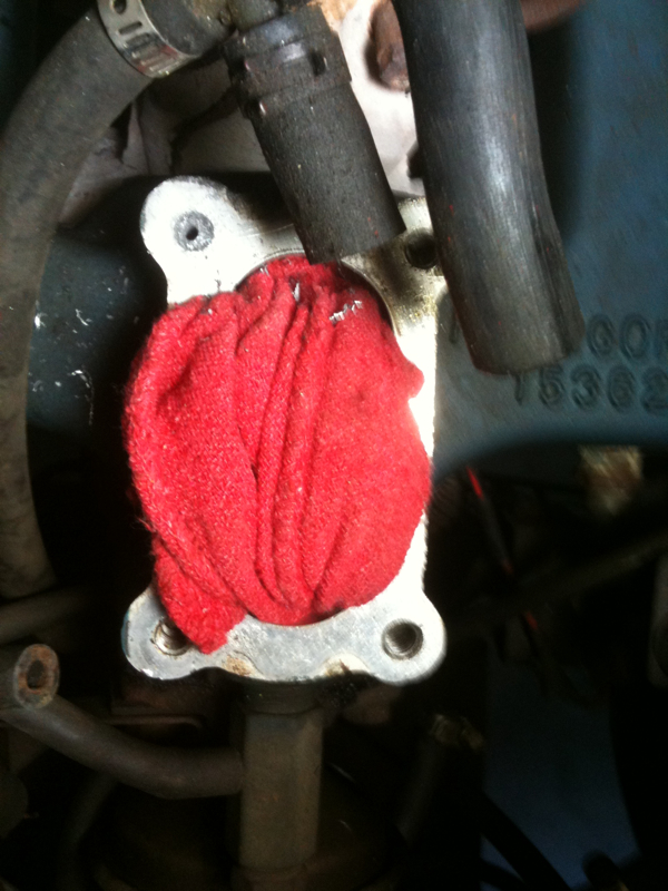

Does anyone happen to know if I have to bypass my computer after I swap the carters with the MC 2100? I think it's called the "nutter bypass". No hurry for an answer as I just sheared of a stud from the old carb. I think I'll be drilling most of the day. Anyone have any tips on getting this sucker out? Feel free to weigh in.

carefully drill it out and retap it.. or they sell easyouts, I have a couple but thankfully have not had to use them so I cant say how they work. I think the idea behind them is to drill a small hole in your broken off bolt and run the easy out down it and it grabs the metal and backs out your bolt.. I have no idea if they work well though. their cheap, 4,5 bucks at local autopart store.

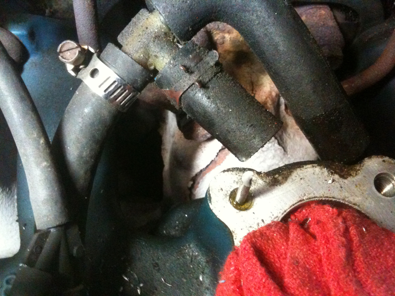

Went and got an easy out. Check out the results. A broken easy out that wasn't so easy. Now I am really scratching my head. Any thoughts?

Oh geez, so much for how well they work. now i feel bad for even suggestiong it. Is the easy out stuck in the bolt as well or can you get it out? Lord, IDK. If you got it at autozone or the likes (thats where I got mine) maybe they are poor quality and somewhere like napa, smyths, would have stronger better quality ones. I know not to try mine now, thats a bummer. If I was at your point, I would just drill the bolt with one size smaller drill bit, I have had the heat from drilling the bolt loosen it before, not requiring a retap. I ran a tap through it anyway just to clean out the threads. good luck and keep us posted.
Don't feel bad. It was my only option unless you consider beating the crap out of it. Going to lowes to by a dremel with a carbide burr and grind it out again. I'll keep u posted. Hey look, another grey hair on my head. Where could that have come from? Jeep owners understand.

Did you use the largest possible easy out? Use one of the studs you removed as a reference. As long as you don't mess up the threads it should come out. And soak that sucker with a good penetrating oil
Broke off easy out so it was flush. That eliminated the sparks from the cutting wheel. Using a carbide burr bit to gring out the rest of the not so easy out and will retry with a larger one. Keep your fingers crossed
