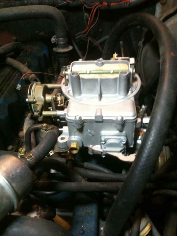

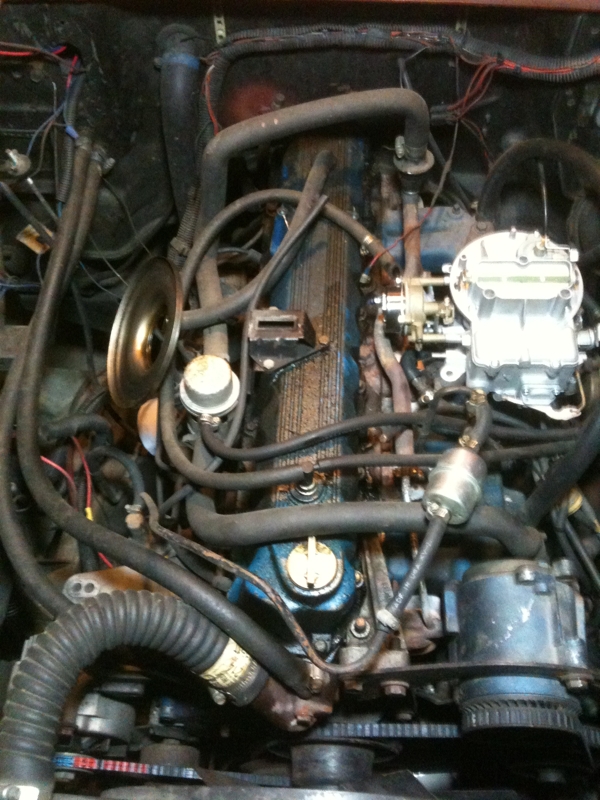

Alas!!! That dag on stud has been ground out. I have to clean up the treads a bit. (well, a lot) Here she is (a dry run of course, make sure all the gaskets fit.
Now, still have to figure out throttle linkage and these darn vacuum lines.

is it an automatic? i have pics of my automatic linkage.
as for the vacuum lines, google cj vacuum lines and a ton of color illustrations pop up. i used a cj diagram for my yj since it is set up old school now
I GOT THIS ******* RUNNING!!!! Holy s**t!! The best sound I've ever heard. Now for the throttle linkage. This should be fun. After that, the maze of vacuum hoses.
