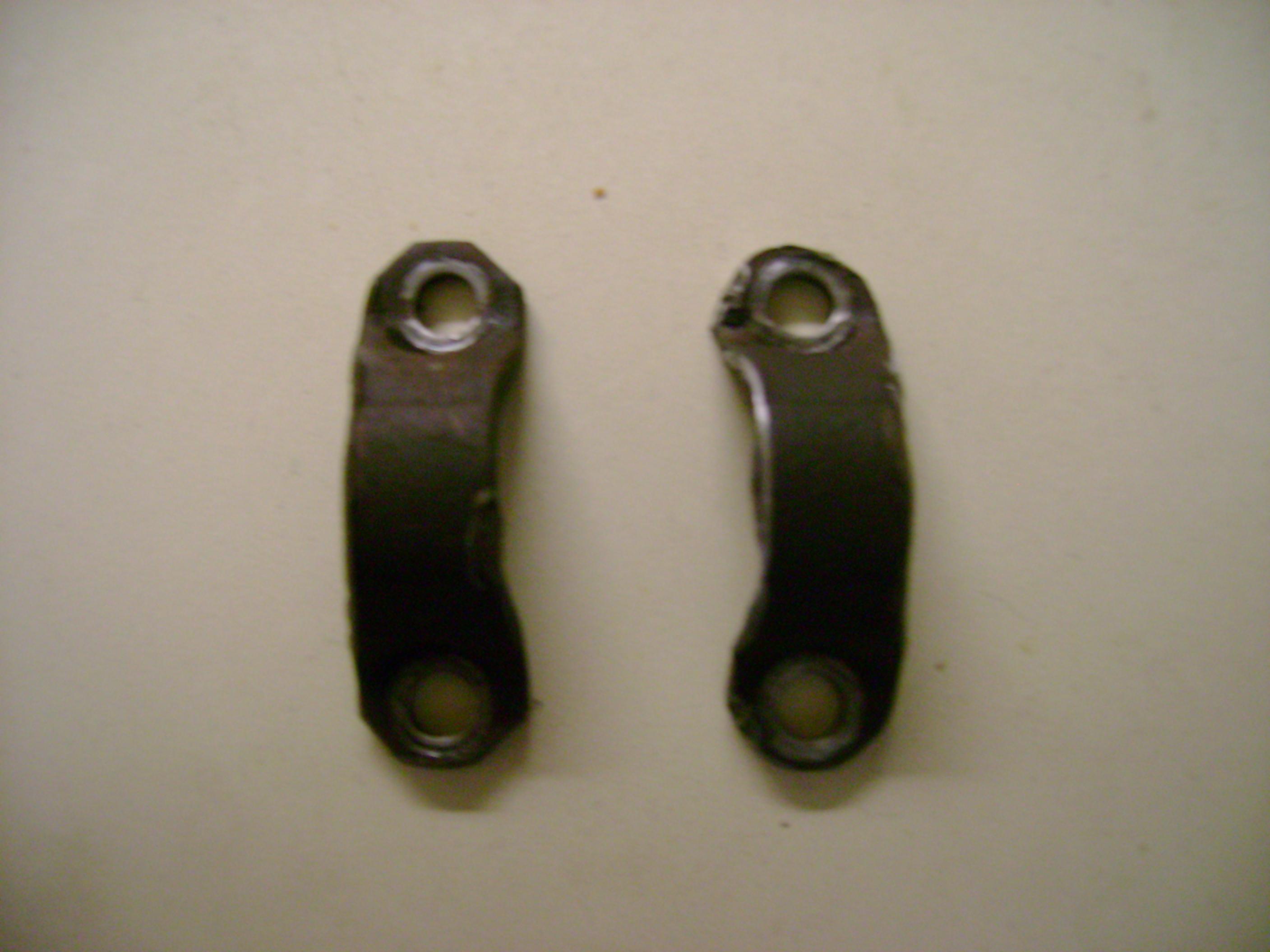

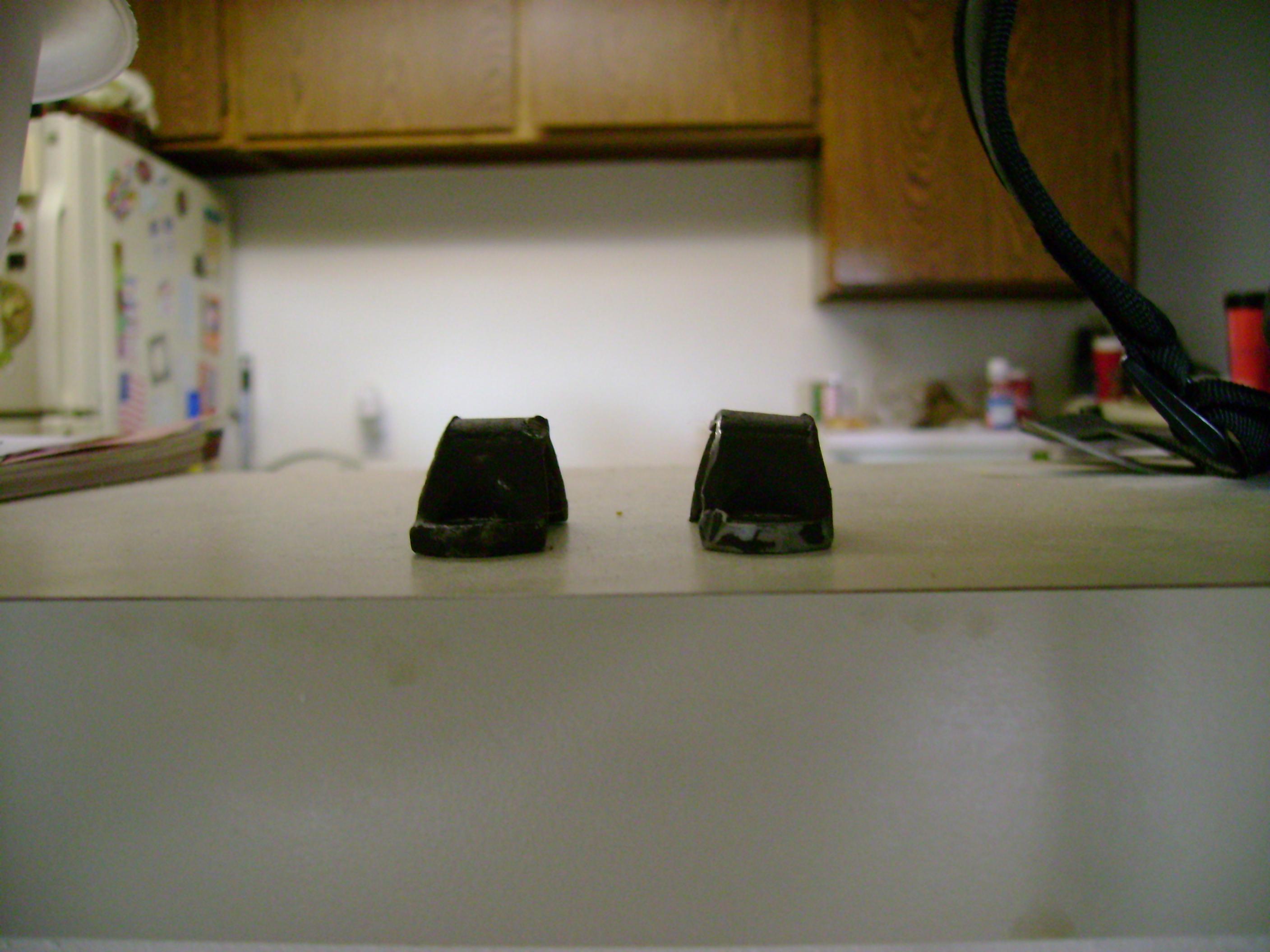

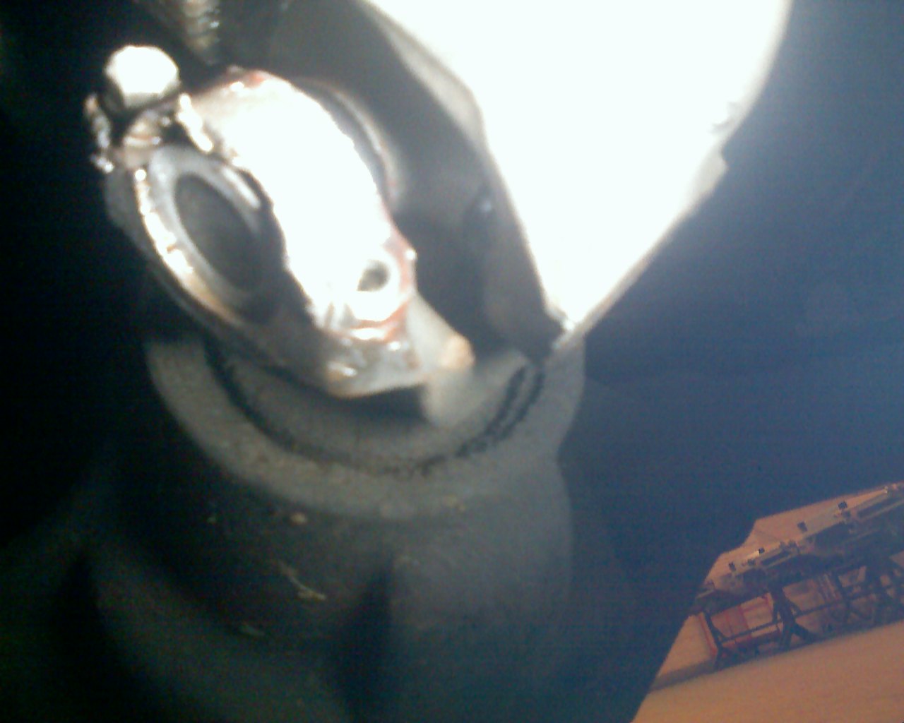

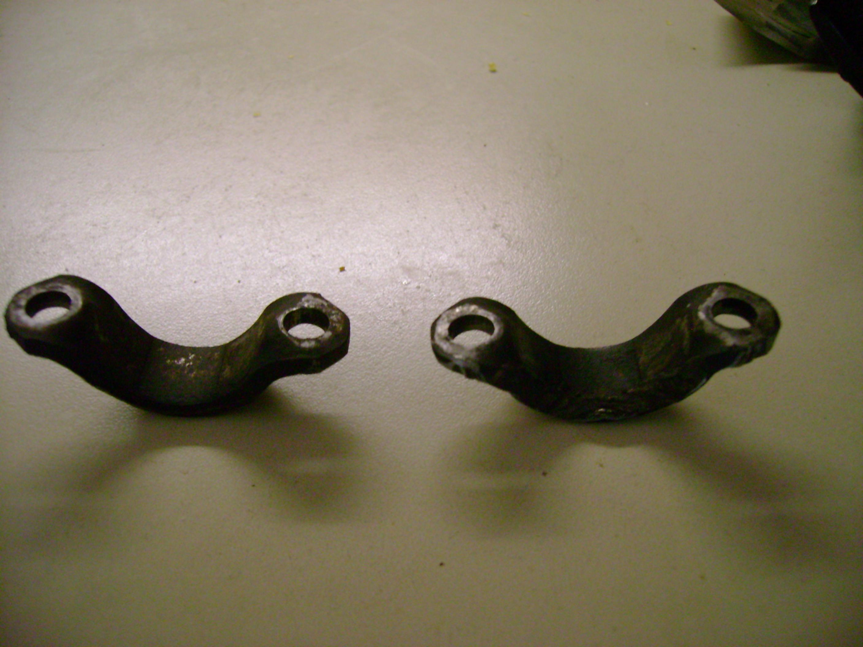

Actually figured it out, when the old u-joint failed while driving it stretched out the retainer about 2 mils which was just enough to cause it to bind and rub the drive shaft yoke causing the vibration my front end dips down up and little at highway speeds.
Compare the good one left, to the bad one right an y'all see what I mean the last pic I took w/ my crappy camera phone at work, u can kinda see how it was binding

Hmm, might be a good investment sense I'm in the market for a new set lol, the corner parts store has some generic cheapskates for about $9.00. Do you have a link or something SteelHeadz?
The one's i bought is from a Local Dealership. Napa should have them too. The only thing you will need to do is drill out the existing thread on the yoke so that the u-bolts will slide right in, then install a lock washer on each bolt and nuts. the only thing to keep in mind is the space to screw the nut behind the yoke is very minimal. Check to see if your gonna have enough room behind there before you do this..
