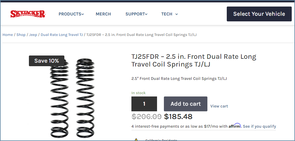

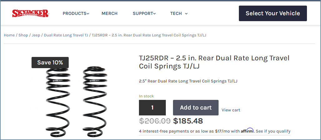

I'm thinking about getting some Skyjacker 2.5" dual rate springs. In theory, these dual rate springs should handle bumps better than the single rate Rough Country springs that I have now.
What do you guys think, are these quality springs that may soften the ride a bit? Any other brand that I should look at, in the same price range?
Skyjacker is free shipping with 15% off right now

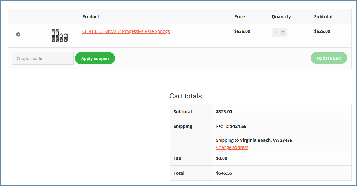

I was looking at Savvy as well - I have their control arms and love them. They are quite a bit more than the Skyjacker.
